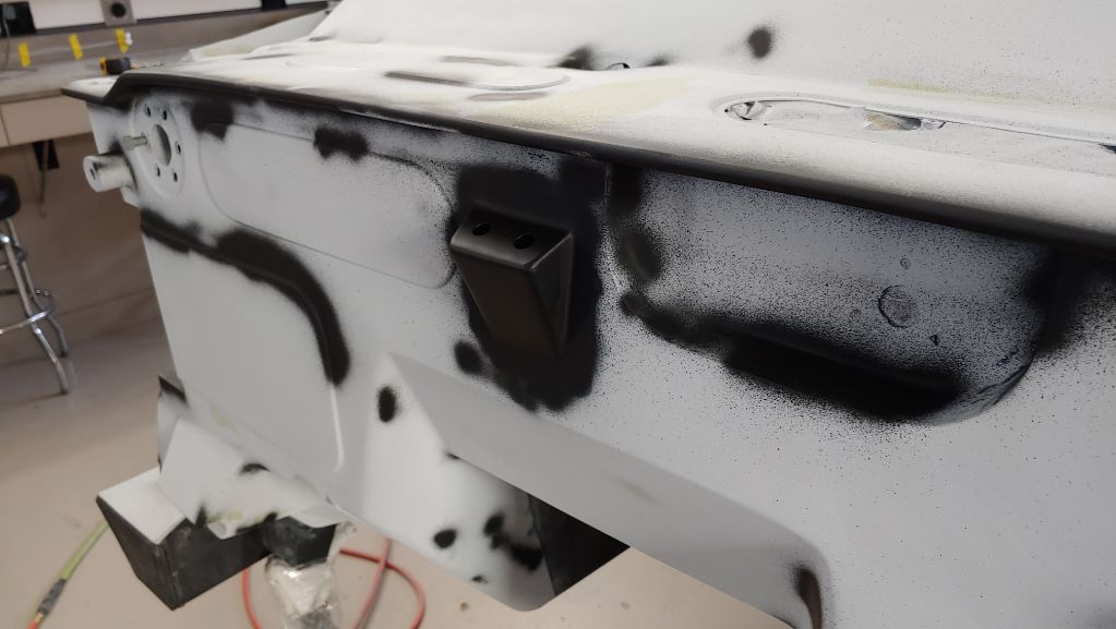

I've been struggling with those 2 stupid chimneys that I built on the firewall for the 2 fire suppression heads....the automatic head (in a previous post) is pressurized from the factory so you can't do anything to the line in order for it to penitrate the firewall perpendicular, and the hose (braided) limits the options so sort'a stuck with something sticking out from the firewall. Anyway, didn't like what I did so changed it... I think this gets closer to a clean solution.
Finished the first round of block sanding, went through to metal in a few spots so touched them up with epoxy along with the fire suppression fix.
