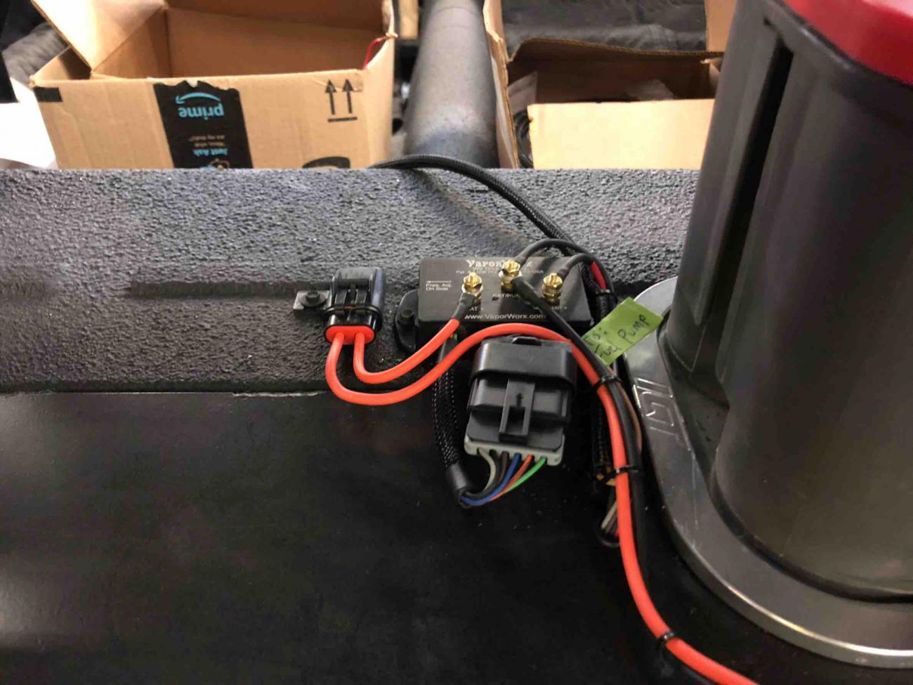

Made a trip to Eau Claire recently to meet with Kurt and check out some nice progress on the Nova. Wiring is basically finished up, but for a few items that will require mock up of center console (e.g., power window and lock switches). Kurt got the Vaporworx PWM fuel pump module mounted in the trunk (wiring is nice and tidy), along with the battery and the II Much fuel vent.

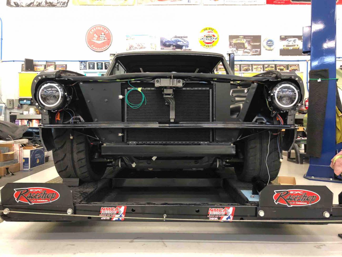

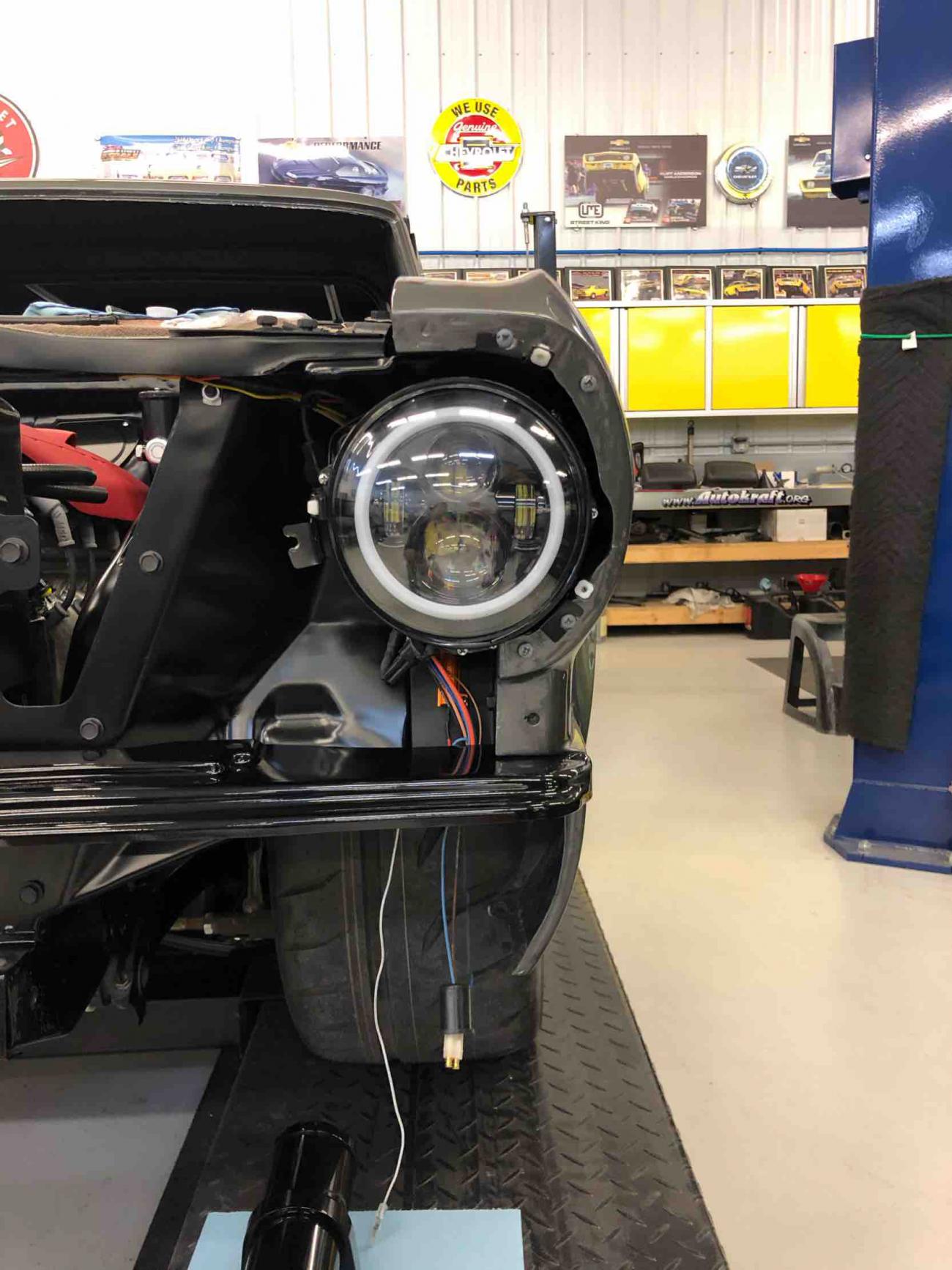

The headlights are also mounted and wired up. These headlights are LED units with halos. The halos shine white most of the time, so they serve as daytime running lights when headlights are off. When the headlights are on, I can either leave the halos on or switch them off - I have them wired to a virtual switch on the Holley pro dash. When turn signals are activated, however, the halos shine amber and blink with the turn signals. Pretty cool, and excited to see them in action.
Attachment 73198
Attachment 73199
Attachment 73200

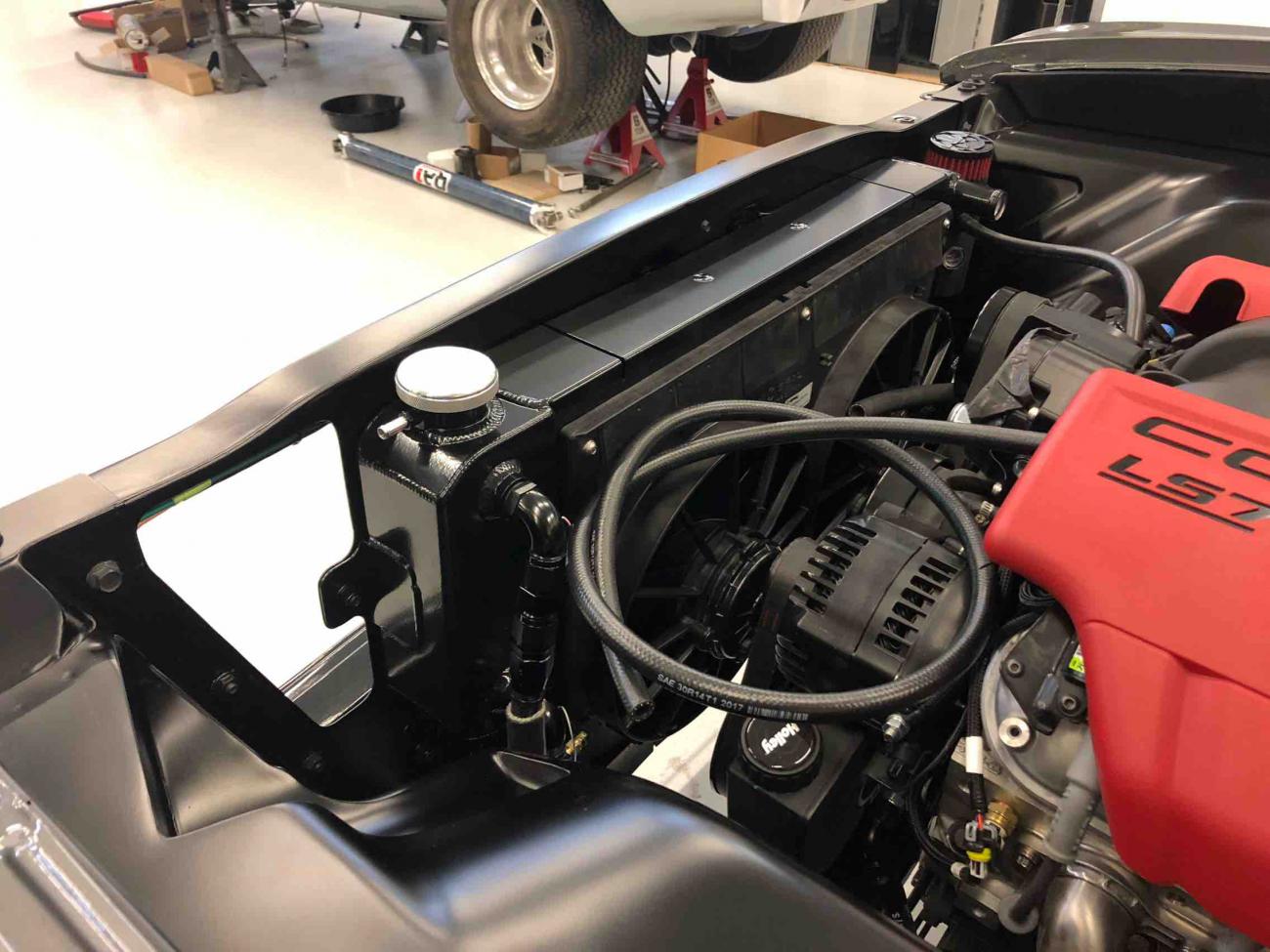

We also got the radiator back from powder coating and it turned out great! We powder coated the tanks, top, bottom and sides. The fins weren’t powder coated in traditional way, but coated in a very thin coat of similar color to ensure no degradation of thermal transmission of the fins. We still need to deal with the radiator cap. We didn’t want to coat the cap as it has a rubber gasket that we were concerned about putting in the oven as part of the curing process. Instead, we’re going to have the cap coated with Cerakote, a product similar to a powder coat, but thinner and can be air cured rather than oven cured.
Attachment 73201
Attachment 73202

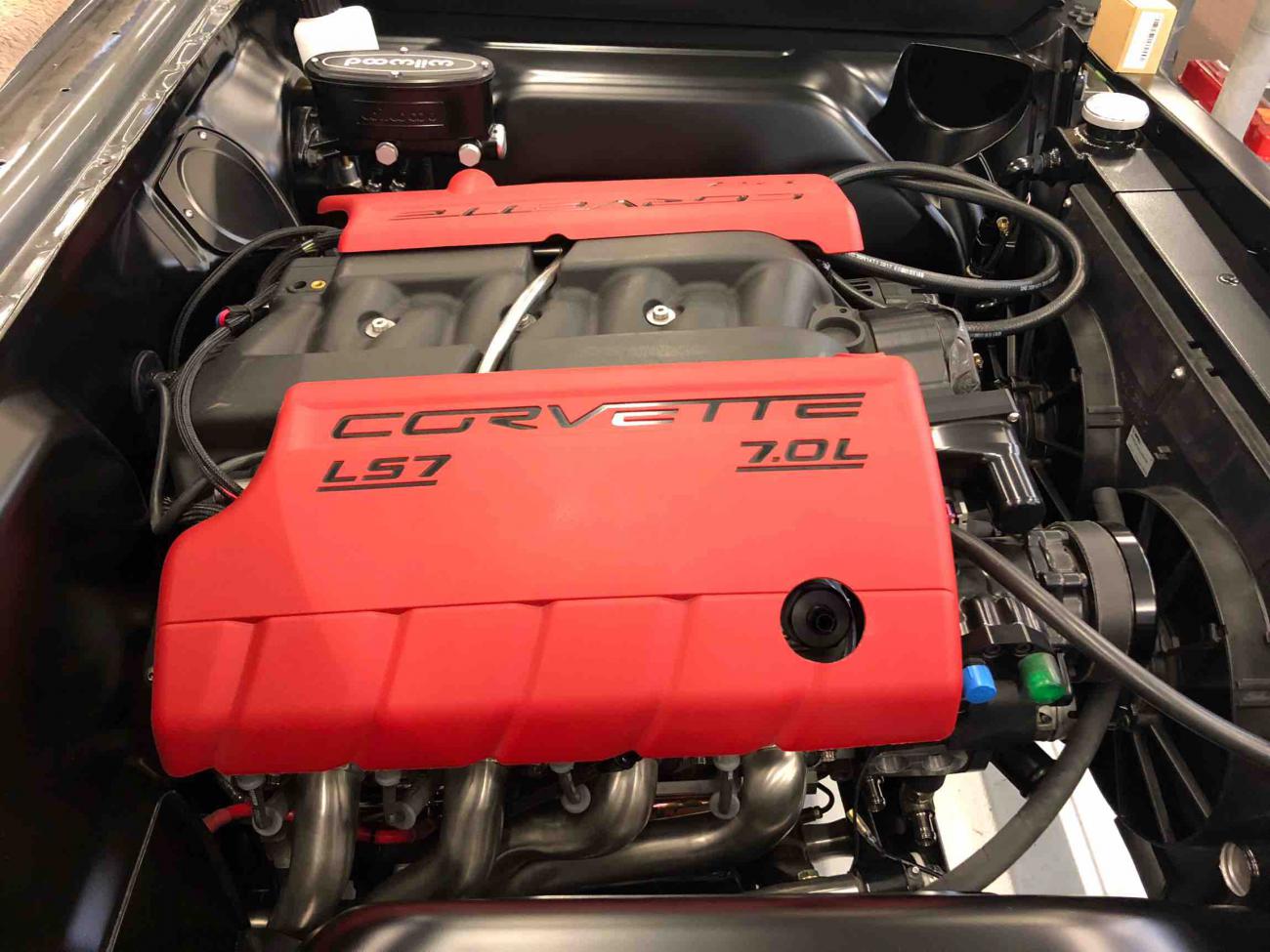

We also got the catch can mounted. Went with a Mighty Mouse catch can. Will connect via a -8AN adaptor on the valve cover oil filler. We had to modify the fuel rail cover - drilled a hole and will connect a 90 degree elbow fitting with push lock hose that will connect to the catch can. Other line out of the catch can will plug into nipple on the intake manifold.
Attachment 73203
