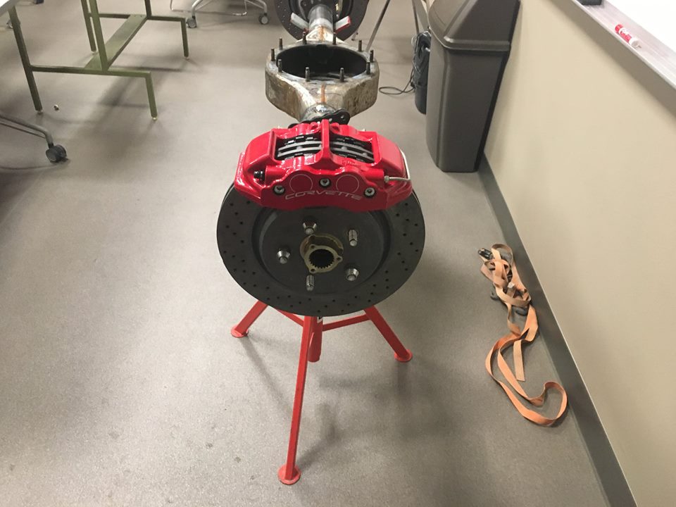

For the longest time I was having problems with how I was going to run the E-brake cables??
Then I looked at a picture of a C5 and I had that AH HA moment. The calipers are front mounted not rear DOH! That cleared that up now didn’t it?
With the calipers roughly placed in the right spot the rear end looks really good together.
You can also see the retaining plate that sandwiches all the brake components together. That is grade 5 all thread to help it all stay in one place. I just buzzed that together with the MIG and called it a day. Damn I am good aint I? Pride goeth before the fall……………
