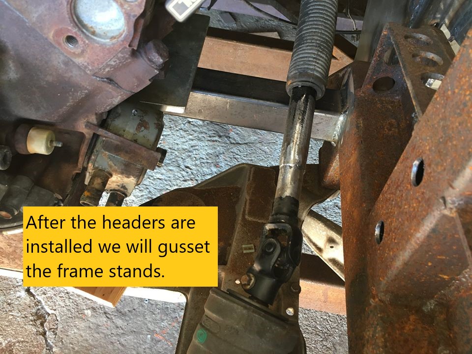

Motor mounts for a SBF are quite easy as they are a flat plate. I would have preferred to have some flexible motor mounts but with limited clearance under the cowl I have chosen solids for the engine.
https://lateral-g.net/forums/attachm...1&d=1631069574
