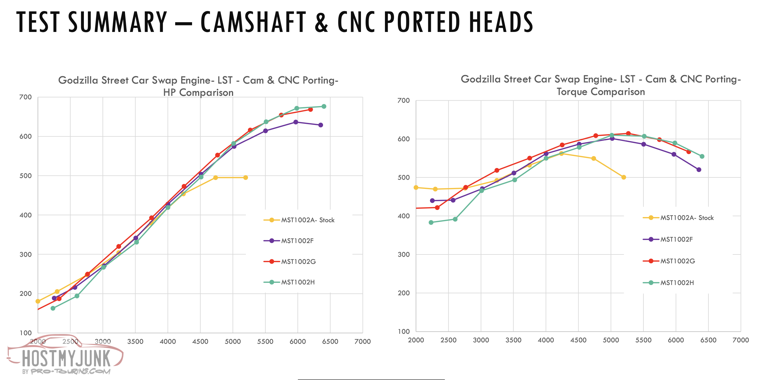

After going back and forth and exploring as many cam options that I could find, I decided to go with a cam from Mast. It is their Godzilla 7.3 HO cam and the full specs can be found here:
https://www.mastmotorsports.com/coll...lla-cam-100264
The torque and power are represented in red in the graphs above. It really seemed like the "goldielox" cam. It loses a little torque below 3000RPM, but above that point it makes more torque everywhere, including the stock cam. It doesn't make quite the peak HP numbers that the bigger, Godzilla 7.3 GT cam (green lines), but it is darn close, without giving up significant torque down low.
These numbers were generated with the CNC ported heads that I have and a stock intake manifold.
Comments and suggestions are always welcome.
