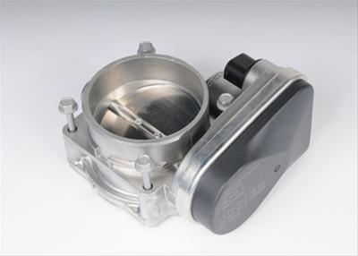

I am installing an STS-V supercharger on an LS engine. I am hoping to utilize the factory Cadillac TB so I can retain the factory intake plumbing. This is the pin out for the Cadillac TB. A connector with pig tail is available. Is it doable to wire it in place of an LS TB with wires of the same designation? an ECU has not been chosen yet so open to all options.
