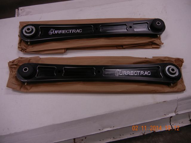

Join Date: Dec 2013
Posts: 184
Default rear control arms
started looking at the rear end today... currie currectrac upper and lower control arms.

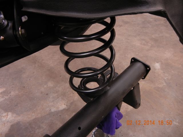

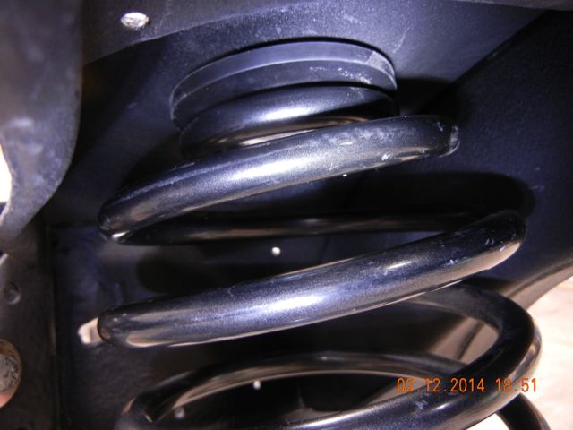

Posts: 184
Default rear suspension
lower control arms and springs are in place...
