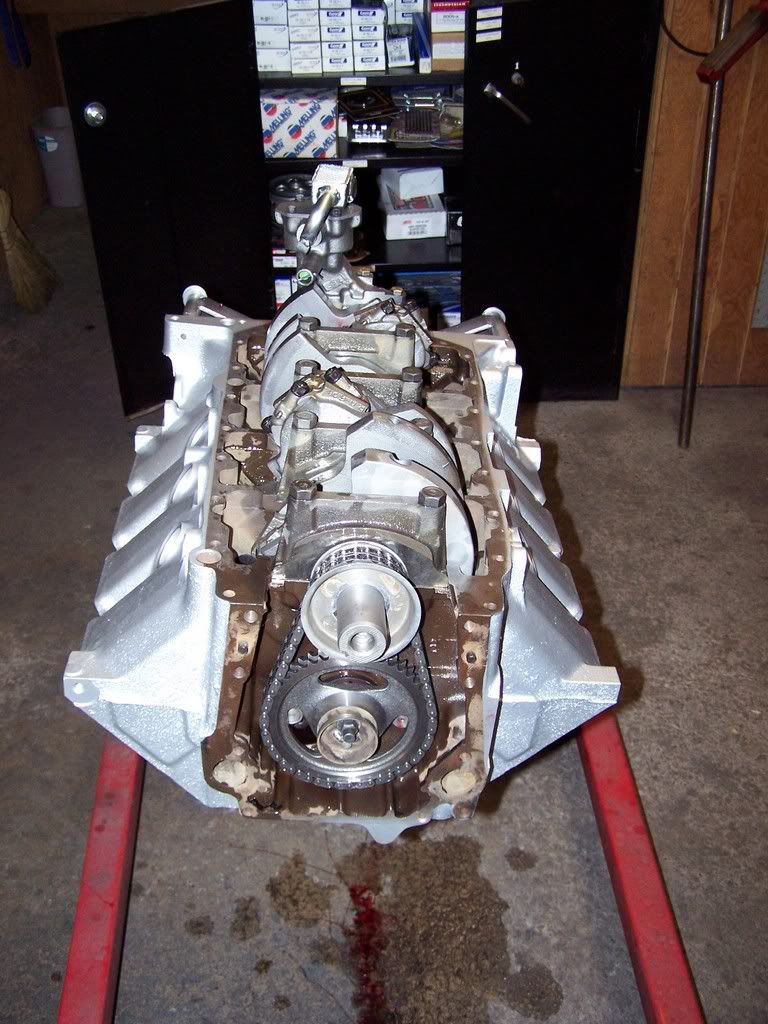

Thought I would share these, the engine has been done for a while now just waiting on upper front control arms to finish pre assembly on chassis.

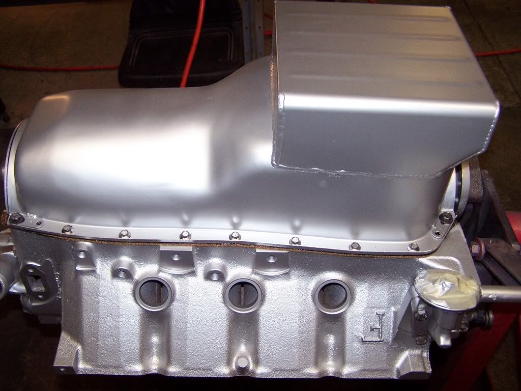

Did you baffle the oil pan?

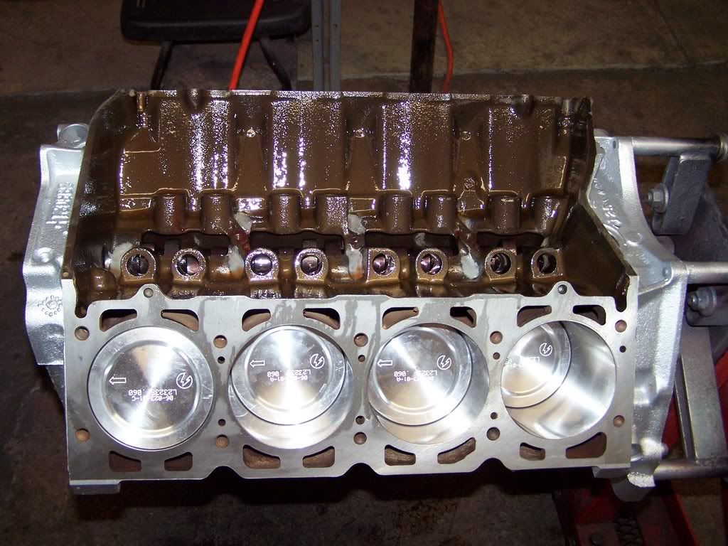

Yes, there is a baffle also a scraper, note the deck surface as well the oil return in the deck surface has been cut into the valley and the lower regions have been epoxied, the cam feeds restricted oil return added in back of lifter galley, fill has been modified to clean up the look of the olds and rear of intake baffled and cut open for evacuation, I have a couple Prochargers left over from the dyno so with the current compression height Im looking good if I decided to install one also.
