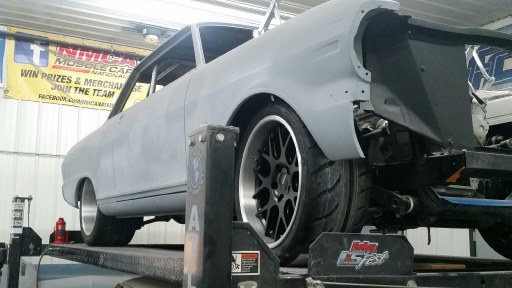

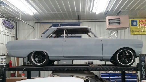

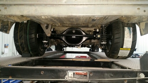

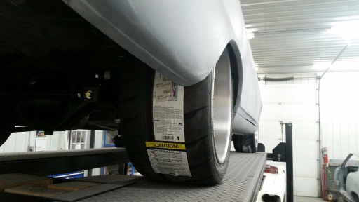

Attached are some pictures of the Chevy II with the wheels mounted - we had to get some new wheel studs and Kurt had to make a couple of minor modifications to make sure we had sufficient clearance on the rears. I think the wheels look awesome - fill up the wheel wells nicely! The car had a mock up block in it when these pictures were taken; so the front end will drop a bit when the full drivetrain is installed. I’m sure we’ll need to make some adjustments at that time to get the right stance, but I think it looks pretty good now, too!
