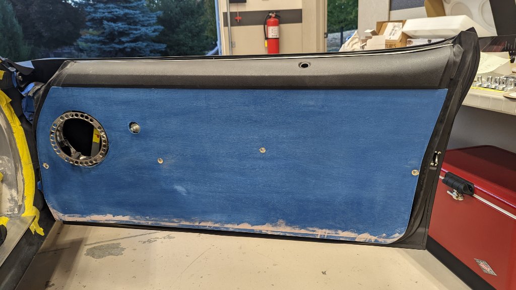

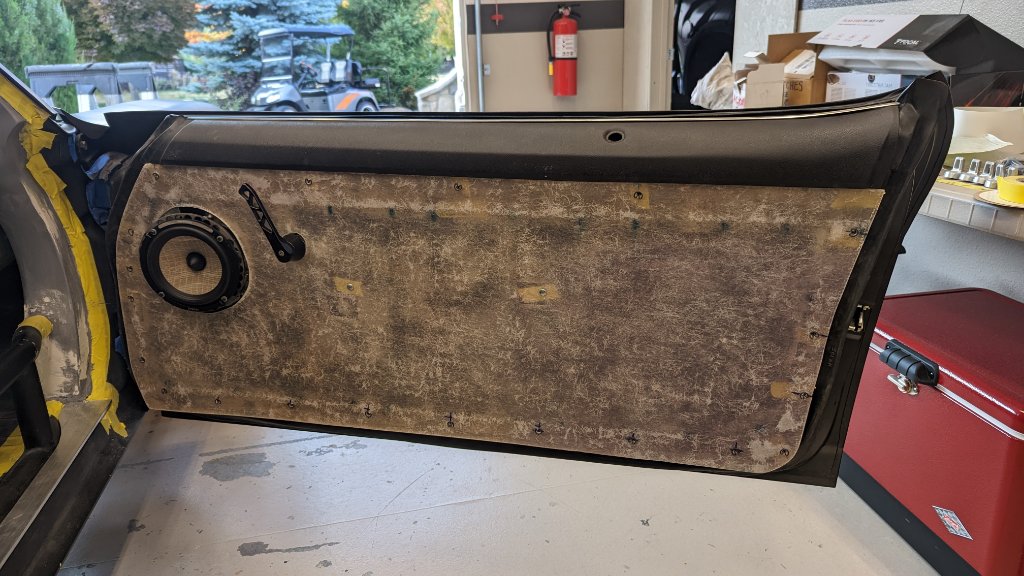

Beginning the door panels with a fiberglass base. Started with 1/4" plywood screwed down tight so it replicates the shape of the door as it curves in both directions. This will be a make-shift mold, will get removed and discarded. Painted blue as dark colors help with seeing air bubbles while laying up the 'glass.

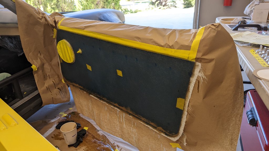

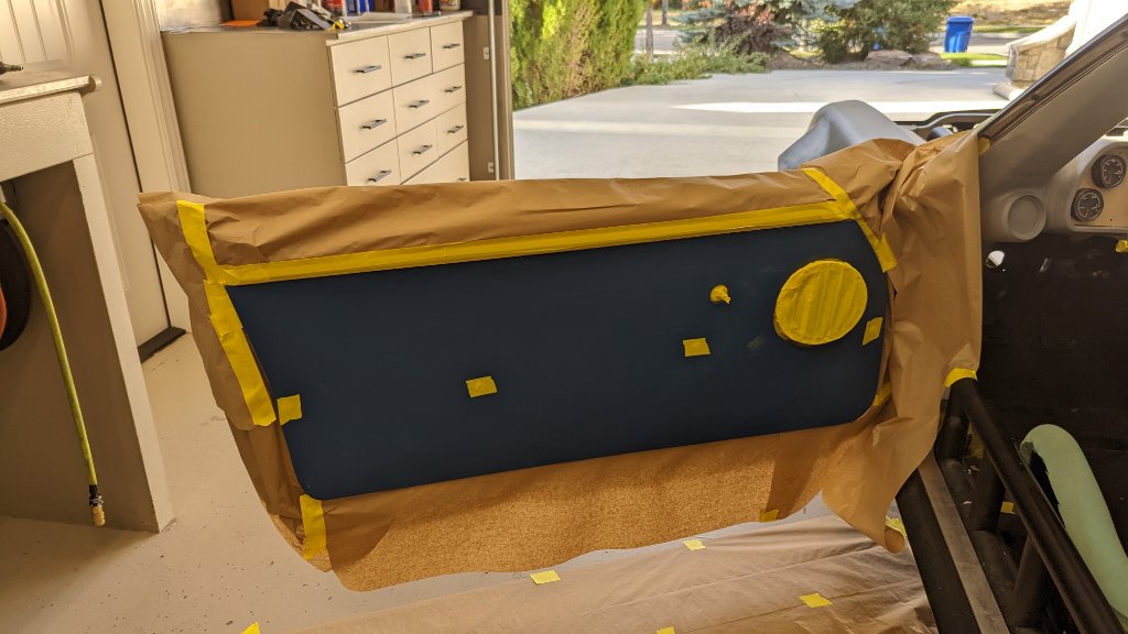

Masked off, 3 coats of release wax and 2 coats of PVA mold release.

2 layers of 1.5oz mat over the entire panel with an additional 3" wide strip of 1.5 oz. around the edges for some extra rigidity. Vinylester resin.

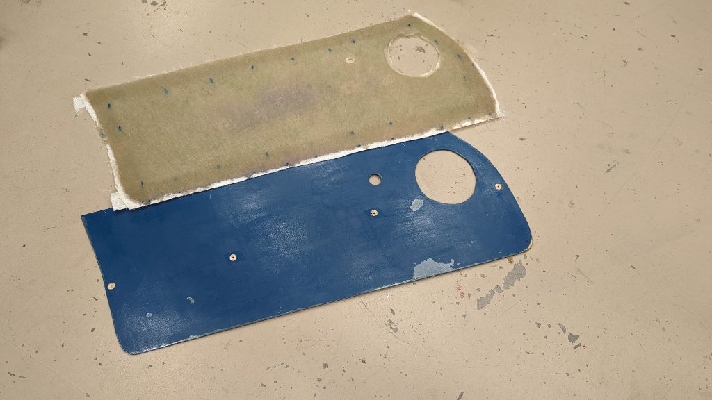

Let them cure overnight and pulled out of the car, trimmed the 'glass. Plywood(blue) discarded.

Panel clips installed. Now the fun begins!

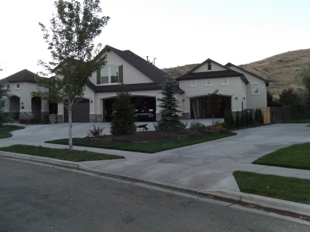

Looking great John. What area of Boise are you in? Looks like you might be using an RV garage as a shop, or do you have a dedicated shop building?

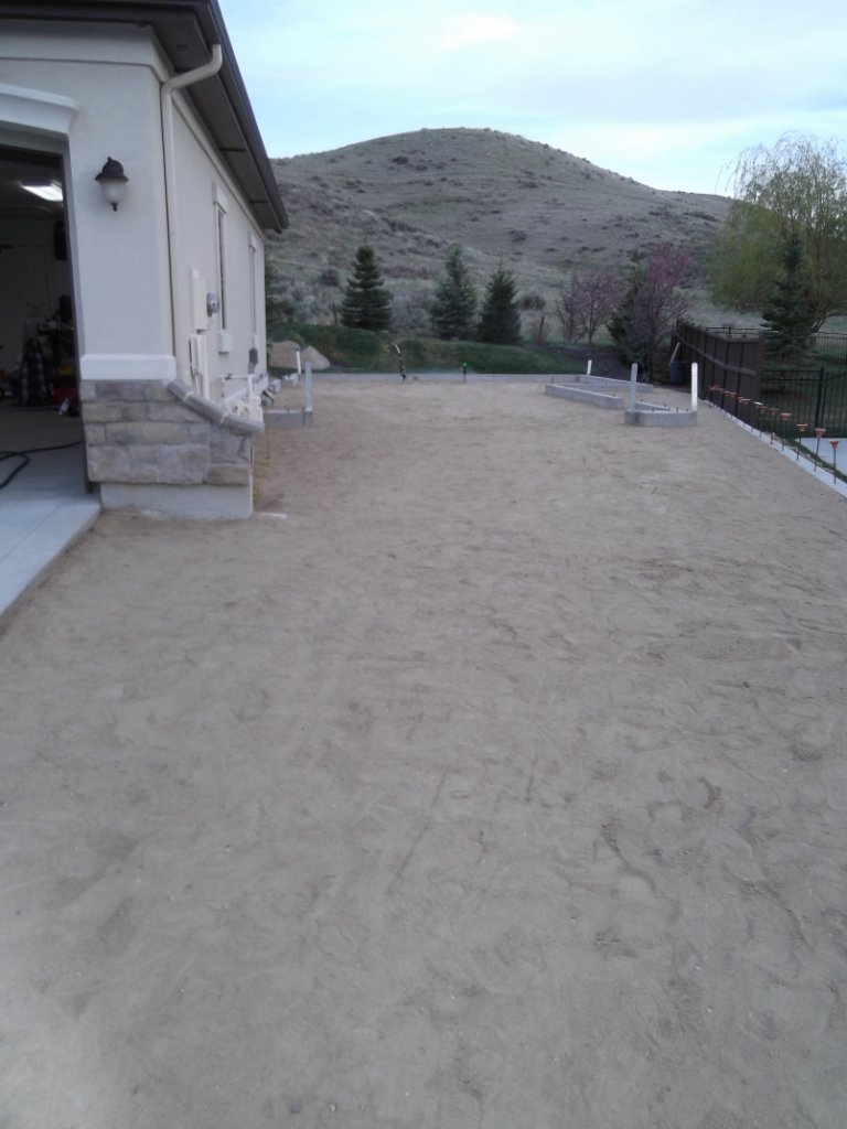

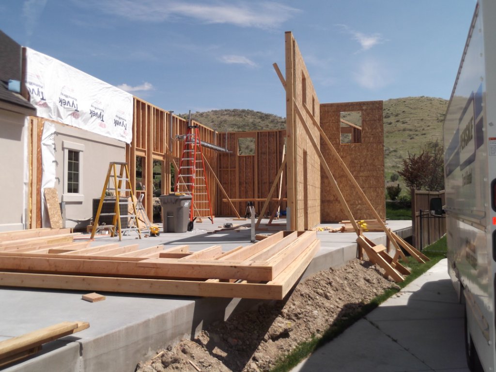

Hi Jody - Thanks! Live in an area called Hidden Springs, about 15 min from downtown Boise, you in town? coming over to help sand? Beer frig is stocked.
I built a shop next to my house back in 2013, has worked out pretty well except it could be bigger!
