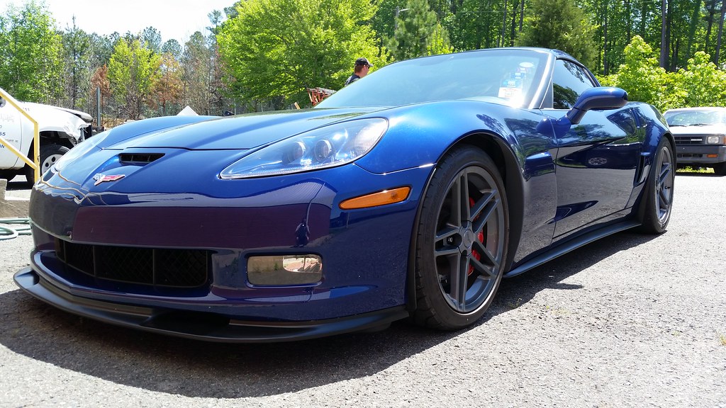

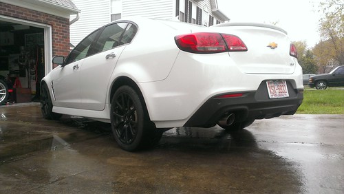

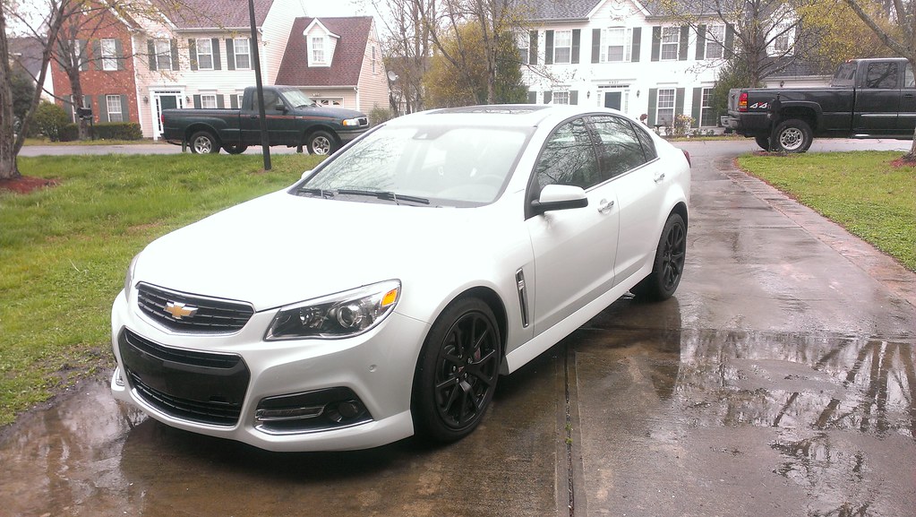

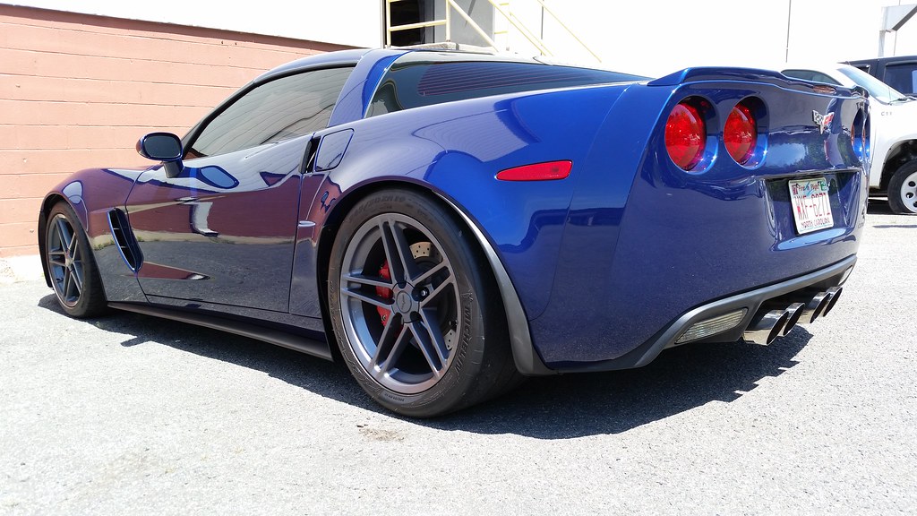

I got some daytime shots outside:
As you can see the ZR1 splitter is stupid low - I put some boards out in my gutter/curb - and I actually ended up hitting the board with the side skirt - so in trying to prevent the car from hitting - I hit my board.
So needless to say I got ride of the boards and pulled out of my driveway with no problem.
I guess thats what I get for trying to prevent some damage!
Thankfully I was going slowly and the side skirt is fine.

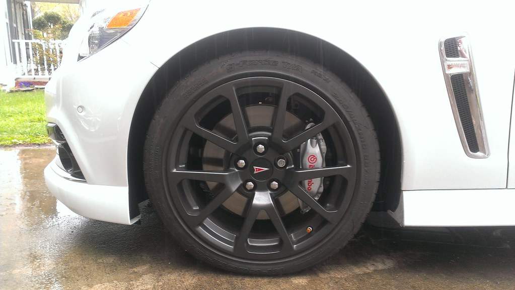

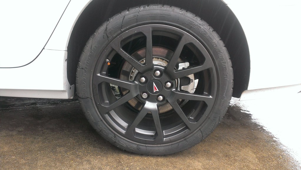

SS update:

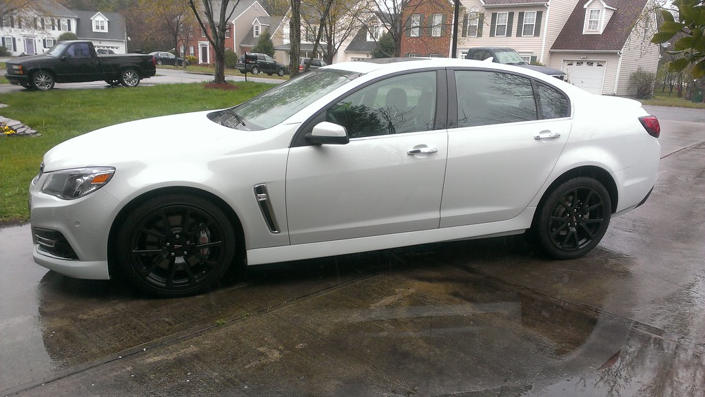

I through on my set of V2 rims that I have laying around - sorry for the rainy pics but the weather sucked her last weekend - they fit with on the SS with no issue.
As far as the TPMS sensors - haven't driven the car to know if they work or not. I know the part numbers are different.
So if I decide to go with these I will have to buy new sensors and swap them out.

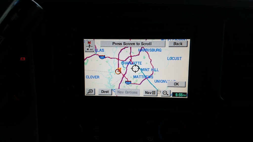

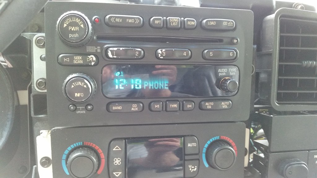

First I really wanted an OEM bluetooth to work - I have it in my SS and I love that feature.
So I found a VCIM out of a Trailblazer - put it in - and it works with the steering wheel controls.
Pic of it showing up on the radio:

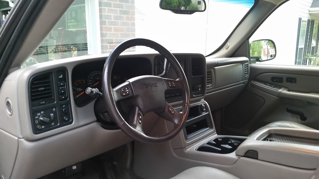

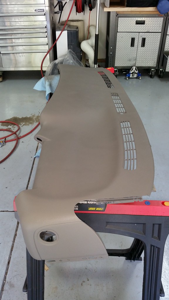

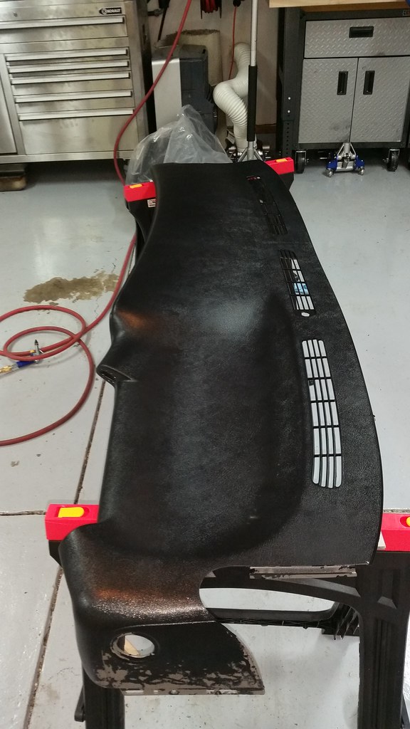

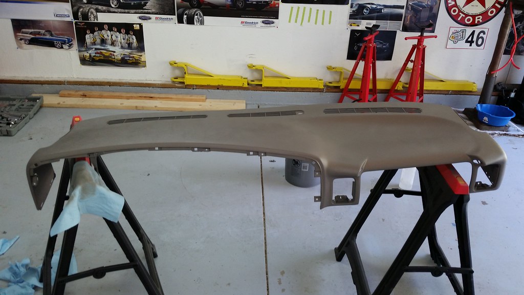

Third - since I had the dashboard out - and the paint was chipping up - I asked my neighbor to borrow his power washer. I used his power washer to blow all of the paint off the dash. It did a great job at removing the paint.
So I had to find some paint to match the interior - after taking a gamble I had ordered the SEM paint code that matched the Very Dark Grey Pewter interior - but when I brought in my fuse panel cover - it didnt match at all.
Turns out that I have the Medium Dark Grey Pewter Interior.
So I ordered SEM 17163 from my local O'reillys. They where able to get it next day.
I used SEM's cleaining and prep system steps.
So I ordered there SEM Soap, SEM plastic and leather prep spray, and finally there SEM Adhesion Promoter.
The paint went easily - and I am pretty impressed with the final product.

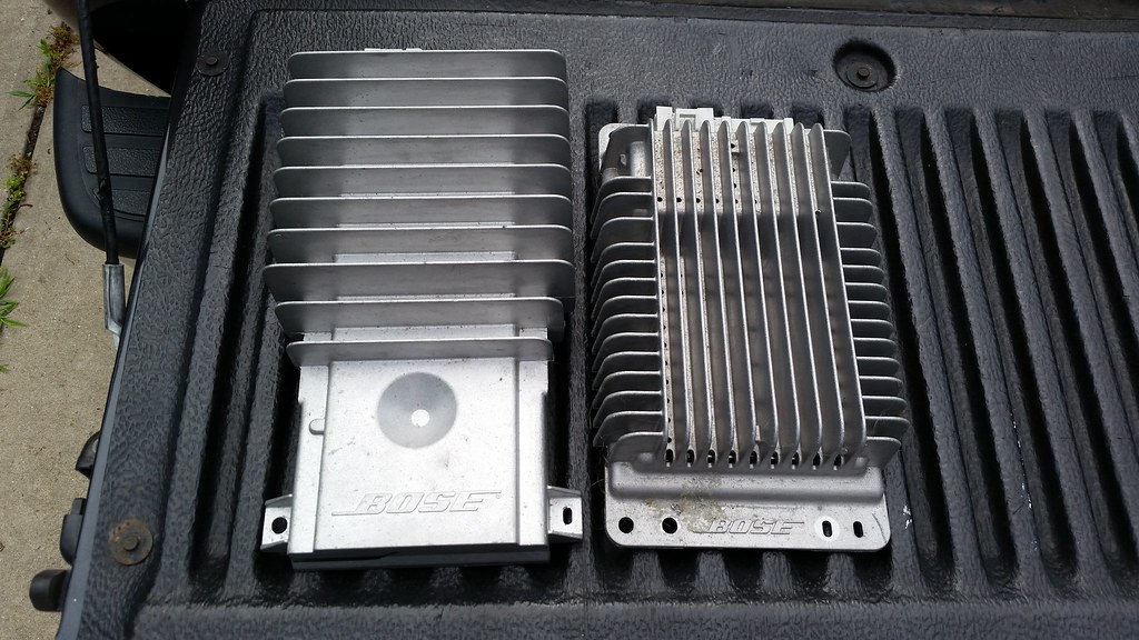

Fourth - since I had everything torn apart - I decided to improve the factory radio - looking on Ebay - the price for the upgraded Bose amp and the factory touch screen navigation has fallen a bunch - I got both the amp and the Nav radio for less then $300 - and they are factory pieces not to this truck but within the GM Truck/SUV family.
So after repinning the Bose harness - I got everything put back together and finally finished up my interior mods/upgrades!

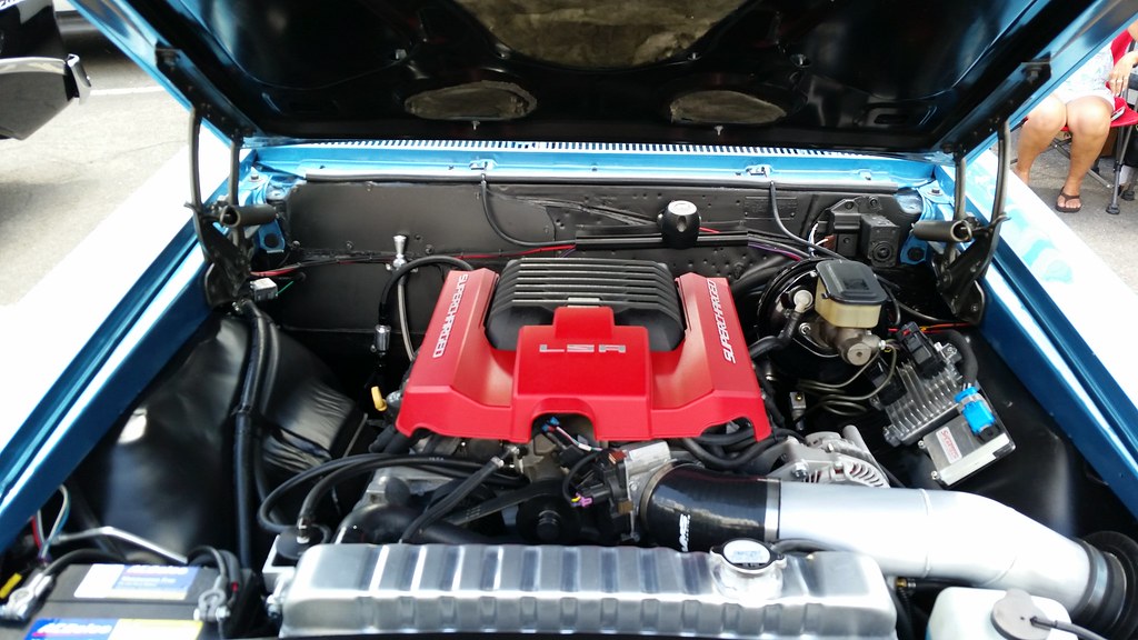

We then went to Zmax Dragway in Concord, NC - and saw some cool cars there. Saw Ken's LSA powered Chevelle and Mark Stielow's old project car that he built a year or two ago.

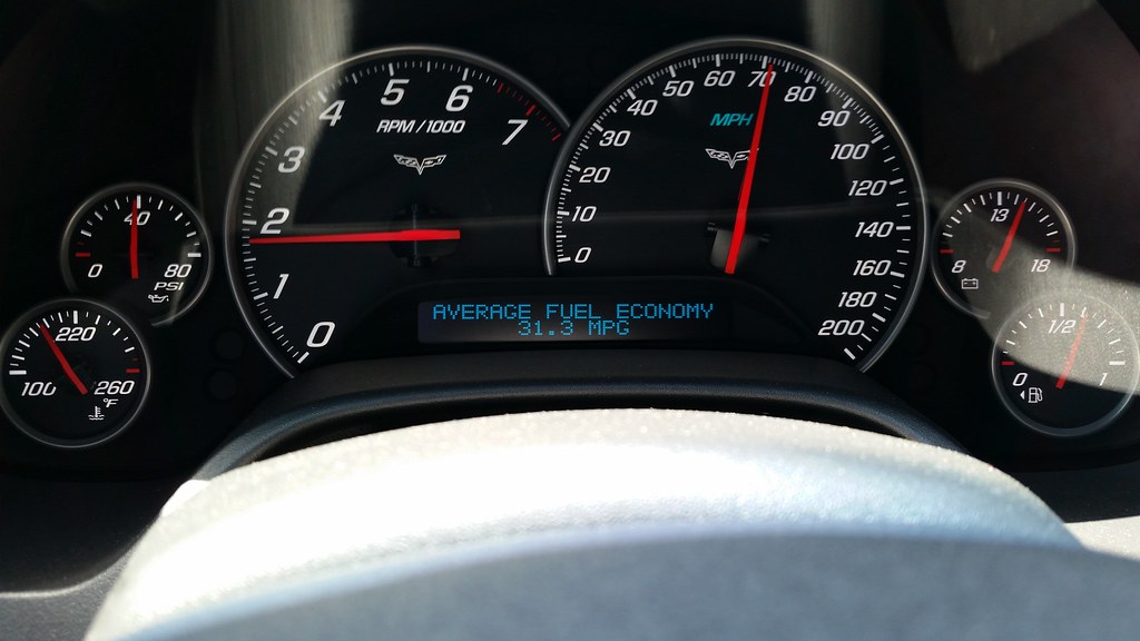

Here is my gas Mileage average - not bad for > 500 hp:

This was the first extended road trip for my built up LSx motor in the Vette - the car got over 32 mpg on the highway when I was easy on it.

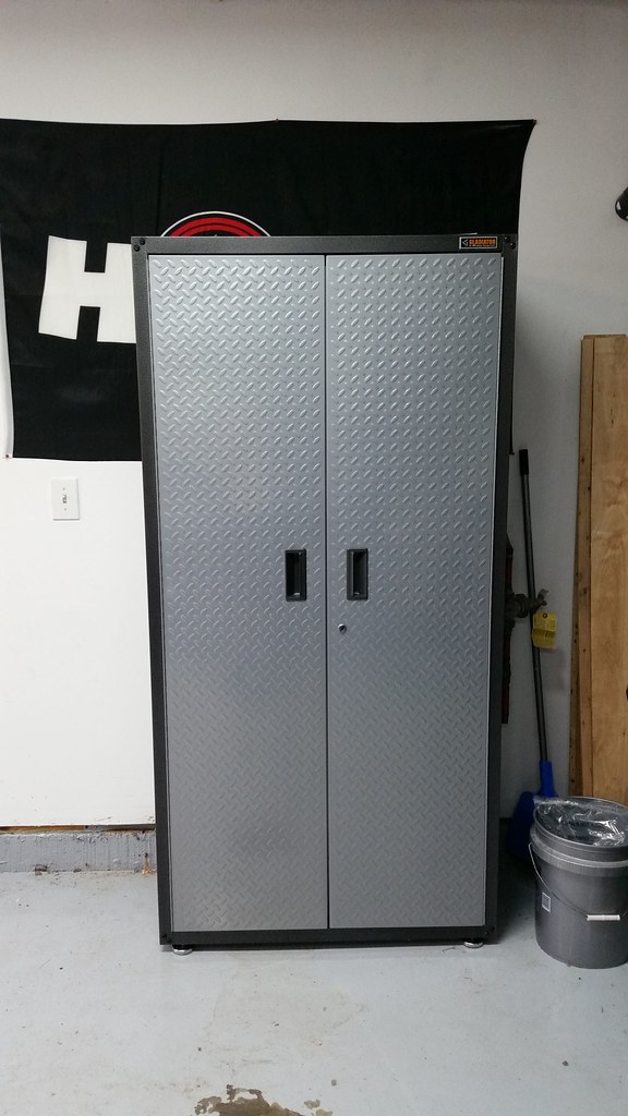

I picked up a Gladiator stand up cabinet that is 36x72x18. It is there RTA series and was pretty easy to put together.
I got this on sale for Fathers Day - put it together, and got some tools, and other junk up off of the floor/my work bench!

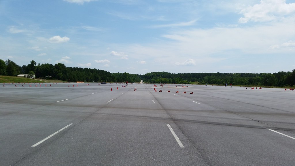

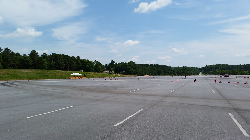

Second - I went autocrossing with the local SCCA chapter down at the Michelin Tire Proving Grounds in Laurens SC.
It kind of sucked getting up at 5am for the 2 hour drive to get out there - there proving grounds are in the middle of no where, but it was well worth it and had a ton of fun.
We autocrossed on there "Black Lake" - its a flat perfectly paved facility that had very little elevation change.
Here where my runs:
