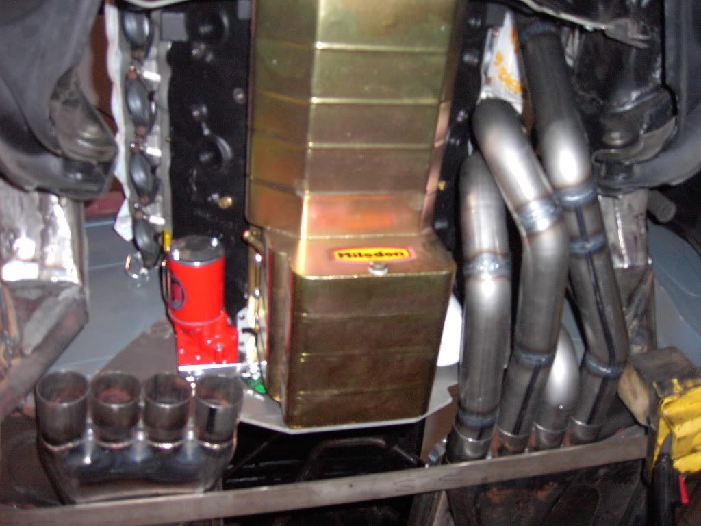

Next the car was stripped of its old cage and the new one was started. A perimeter frame was slid inside the rockers, and almost all but a small section of front frame was removed. Here are a few pics of the work while it was being done.

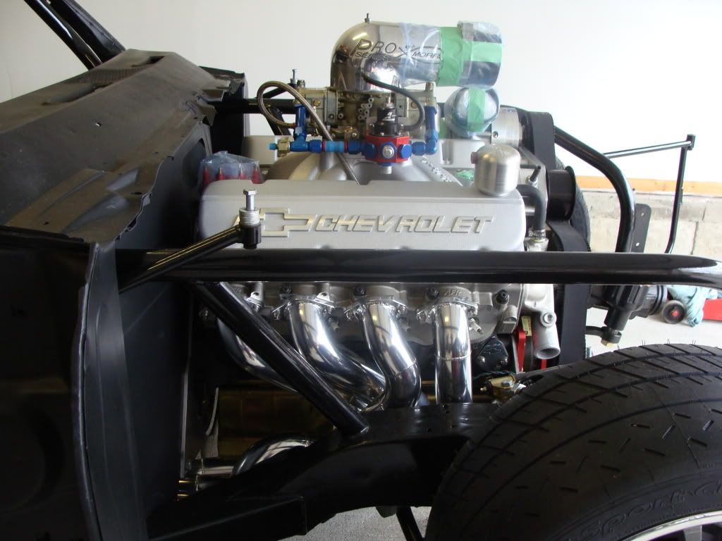

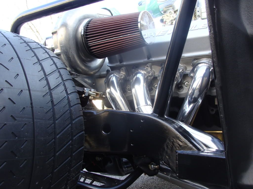

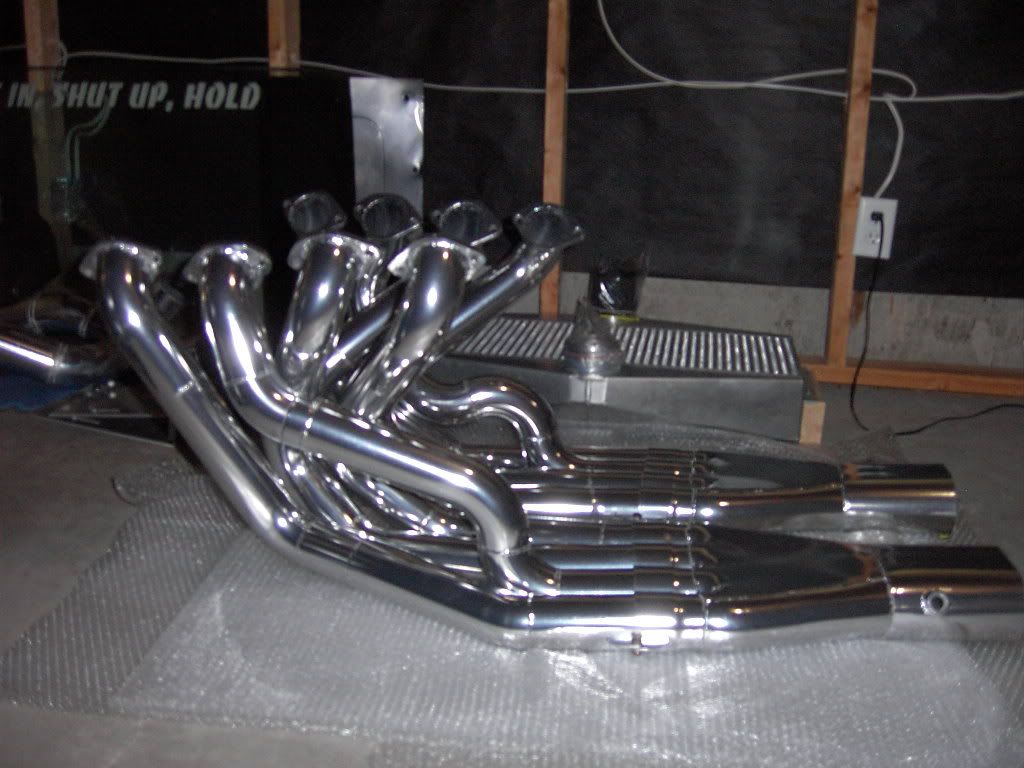

While it was still in the chassis shop I had them build me a set of 2 1/2" x 5" headers. The 5" collector is made flat to keep as much ground clearance as I can.
After I got it home I had them coated.
A couple shots of them in the car
