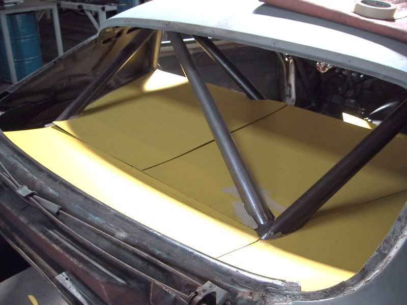

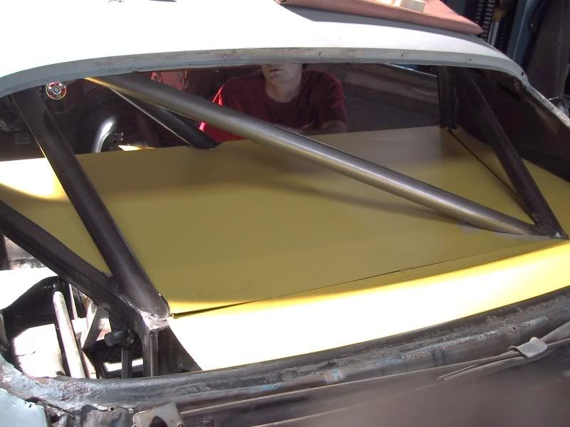

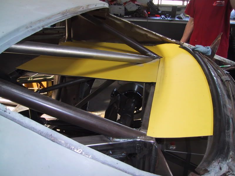

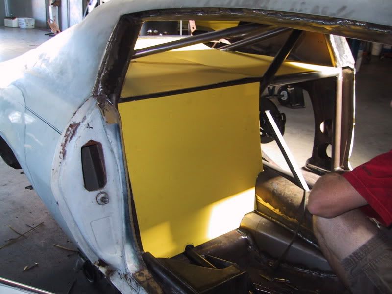

Here are some update photos showing the templates being made with cardboard material for the aluminum paneling at Maier Racing. It is too bad all the custom work on the rear suspension gets covered up.
