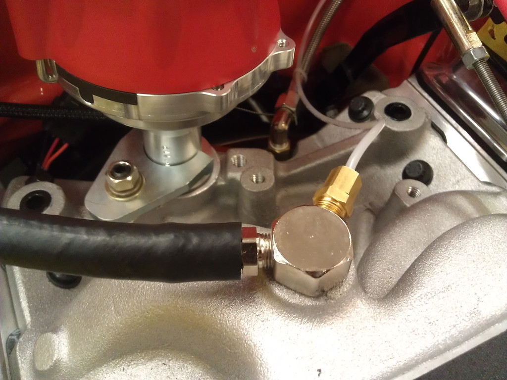

Is there a port on your manifold you can access?
My carb doesn't have any ports so.......
I'm not running power brakes so one line is the PCV and the other is a vacuum gauge. I bought that routing hub at Summit, they have single, double and possibly triple port versions.
