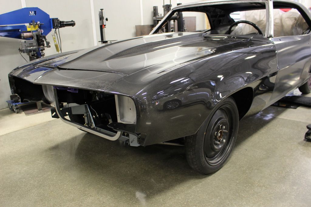

Now that is a cool picture.
Originally Posted by CamaroAJ View Post
My Anvil fenders will be here tomorrow, so I went ahead and assembled the car lol

Thanks guys. I've got more parts on order and making good progress on it. I'm really looking forward to getting this car done and driving it.
