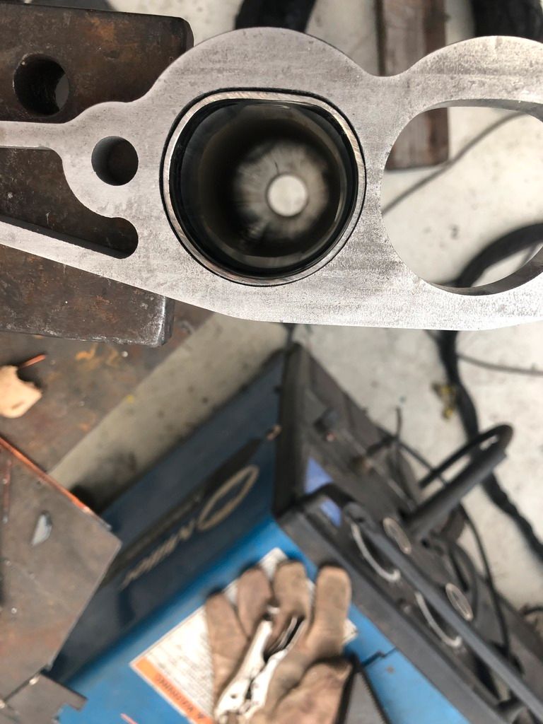

Started back on it, time to build headers. Everything about this is going to be a fight for space.
I want the turbo's high enough to drain (don't want to mess with a sump, another pump, check valves, etc), but far enough back to help with weight distribution.
This leaves me very little options for mounting, so a pocket in the firewall is my only option. This will necessitate cold side plumbing in the cowl, and water-to-air intercoolers behind the dash.

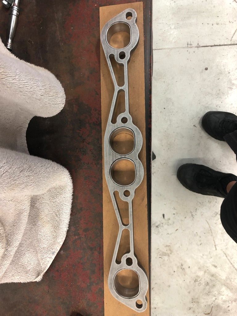

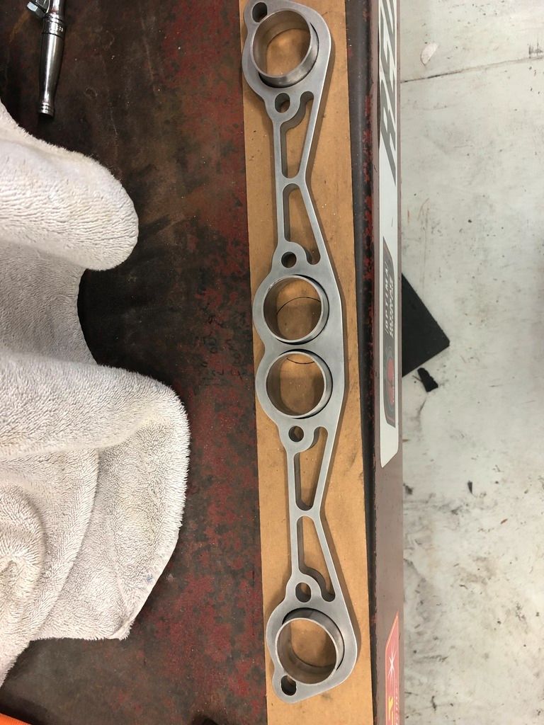

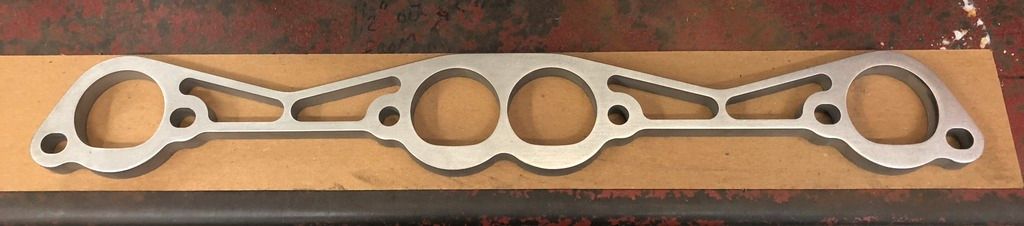

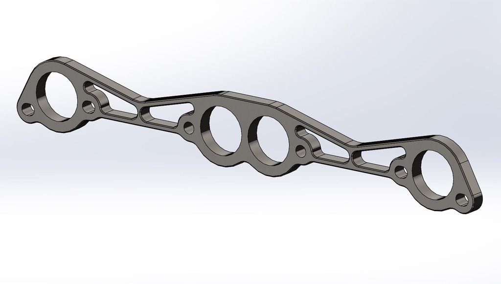

The first hurdle is going to be the long (for a turbo application) tube headers. Okay, second hurdle, first is this is a Mopar that no one makes a flange for. I sent Aaron Oberle the measurements and an idea of how I wanted them and he responded with a very trick file:
Couple of tweaks back and forth and ready to be made. Dropped off some 1/2" 304SS to the water jet guy and got these:

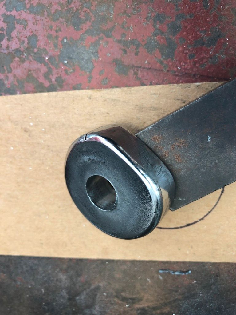

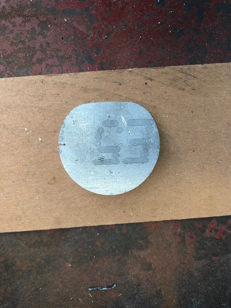

I grabbed my scrap when I picked up the flanges because I had an idea...

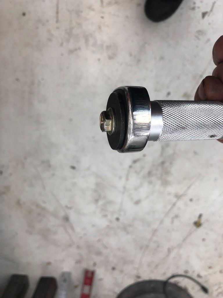

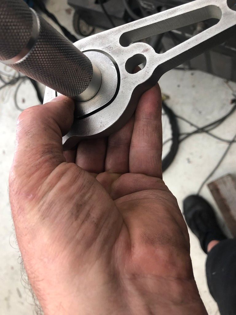

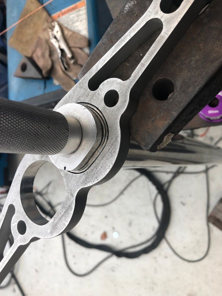

This slug is a perfect match to the port profile, and will make a nice forming tool. I reduced it's perimeter by about 0.050" to account for tubing wall thickness, rounded the edge that gets driven into the tube, and polished to keep it from grabbing. Drilled a hole (calibrated eyeball must be off center) and added a handle to have something to beat on!

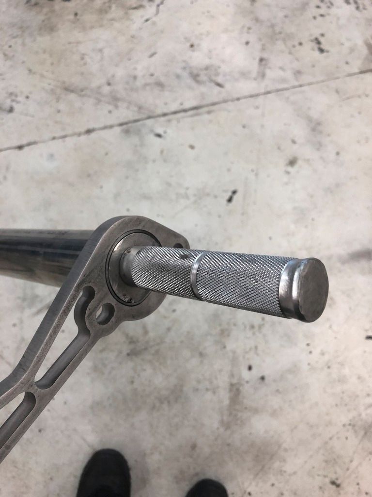

I formed the tube, slid it in the flange and formed it again:

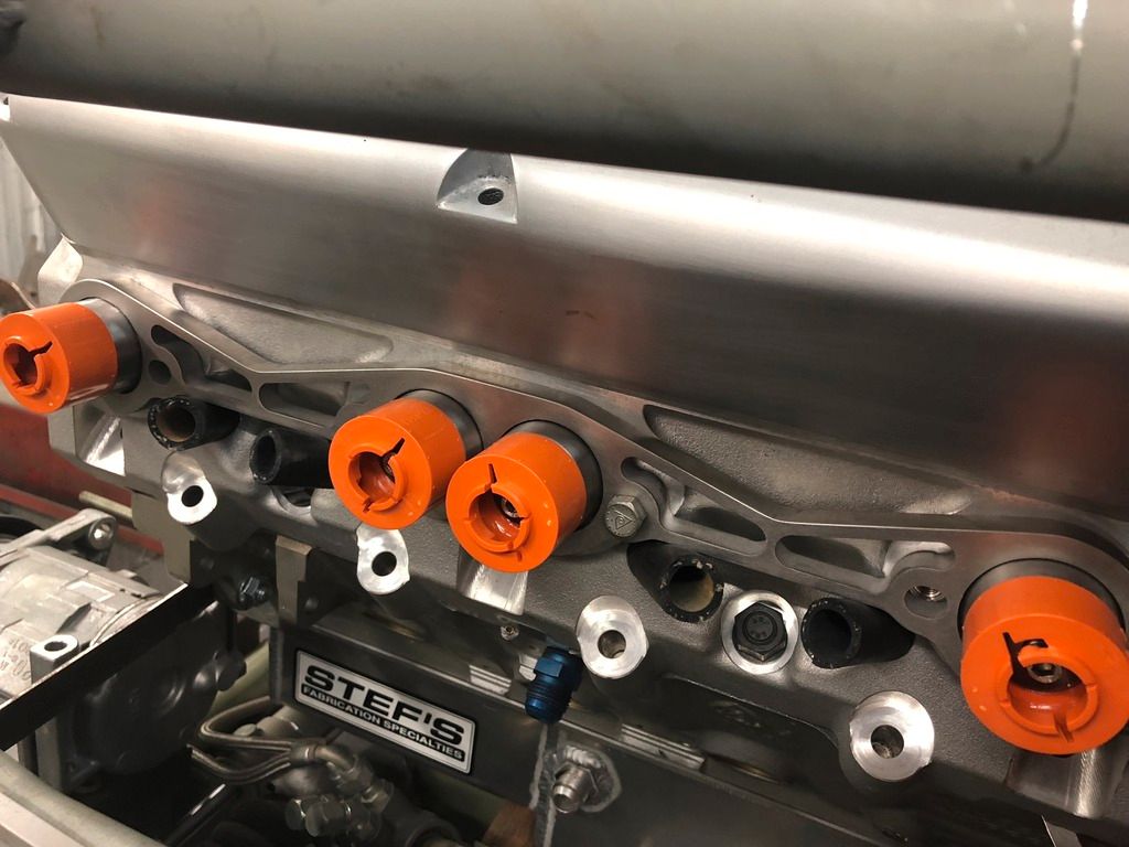

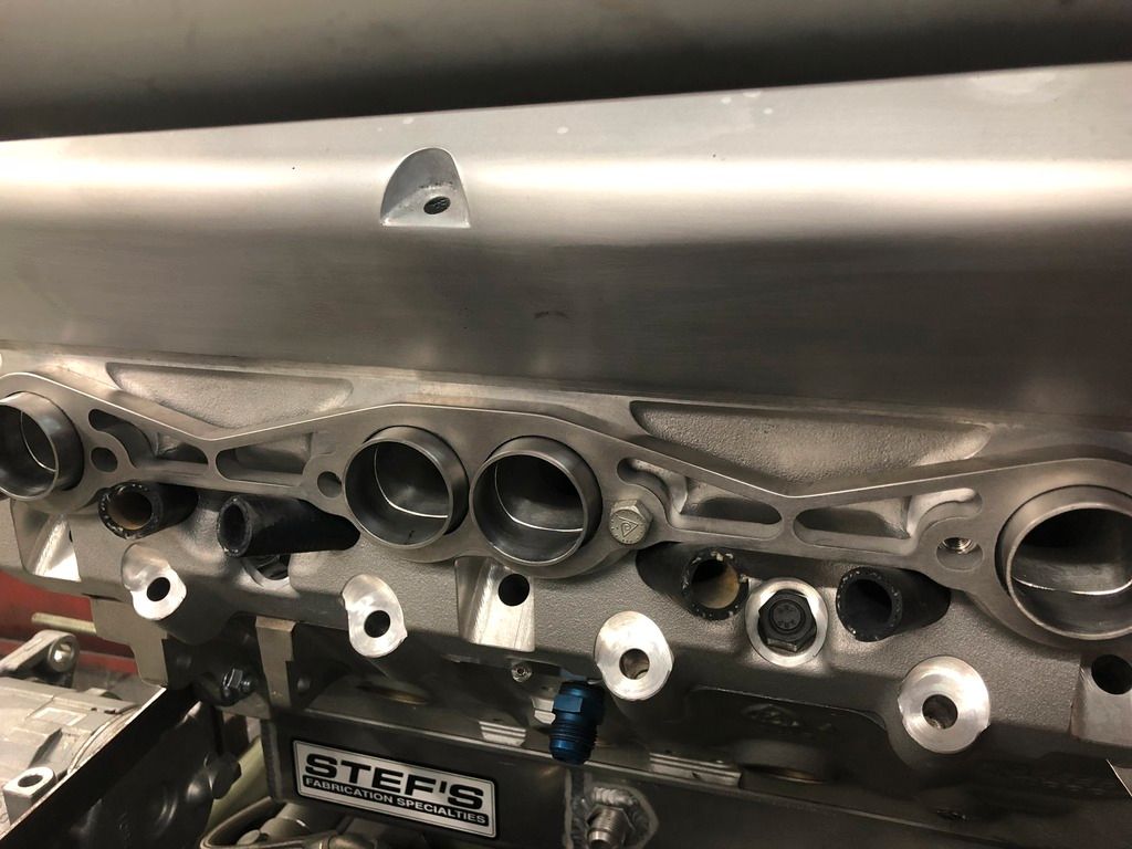

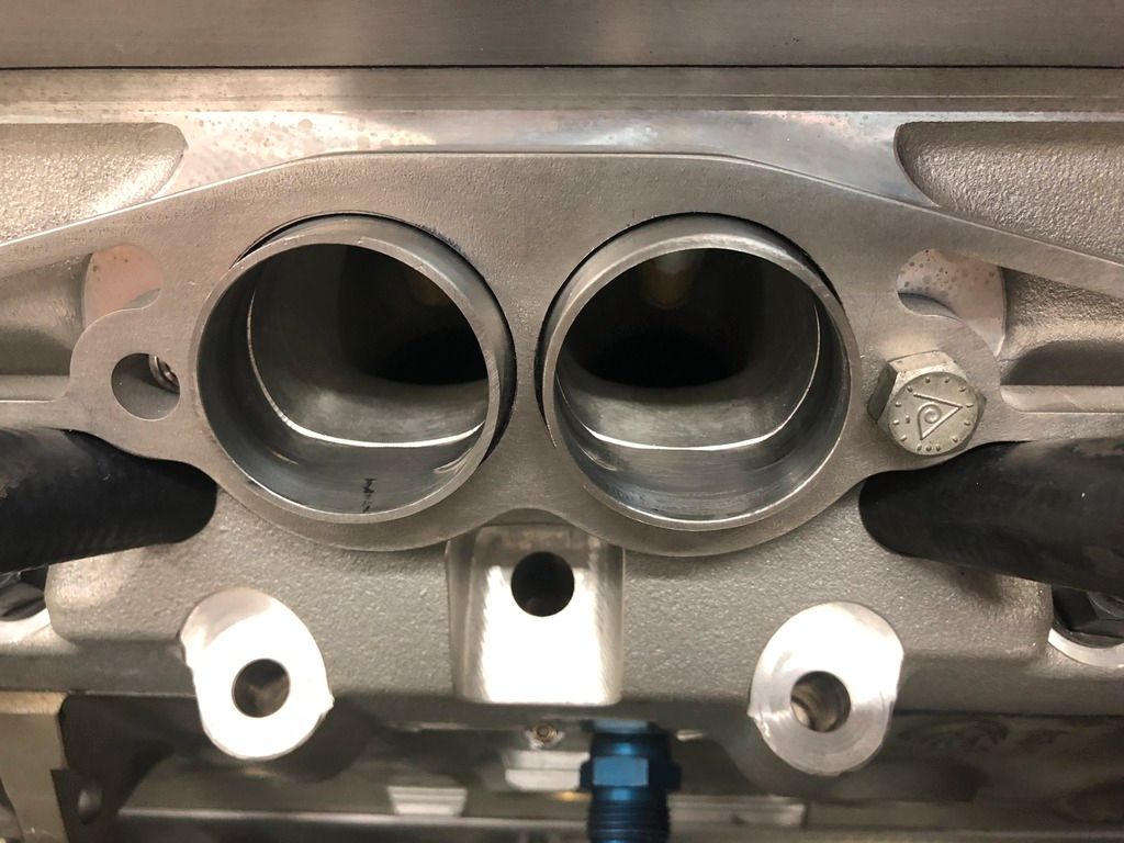

Pretty happy with the transition:

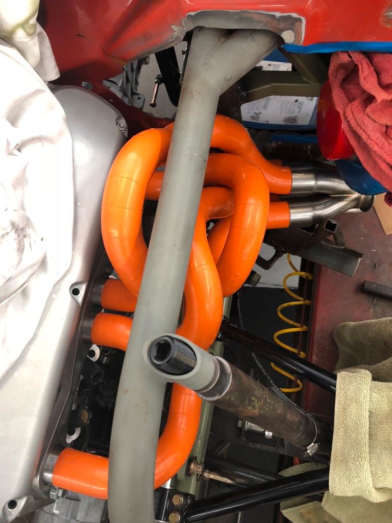

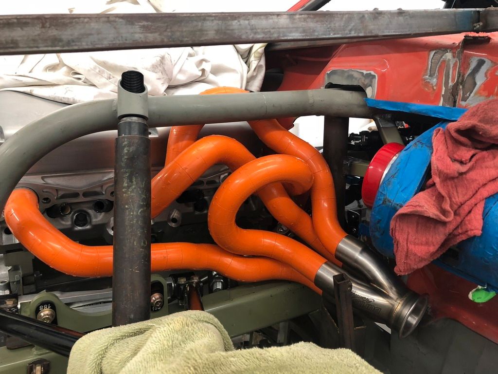

Thought I would give the ICE kit a try and see if it made the job any easier. I've always built 321 SS headers by first mocking them up from steel and then transfer to stainless. Just too expensive to screw up a 321 SS tube.
My space is so tight, seemed like a great time to try it:
So the easy part...need to have spark plug access, be able to remove the valve covers, clear a 335 tire at full lock, clear the coil over, clear the steering linkage, and last but not least, run equal length, long (for a turbo) primary tubes, using only 3" circle bends, that exit between the tire and firewall to mate to the turbo. I've laid this out at least 5 times, so going to give the kit an A on time savings. I stopped caring what it looked like and just concerned with everything clearing and primaries the same length. This is the first example of when all that came together, not the prettiest layout, but meets the "design criteria"!
