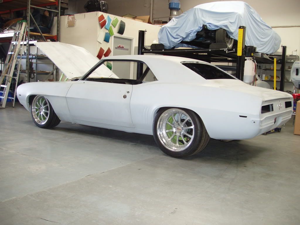

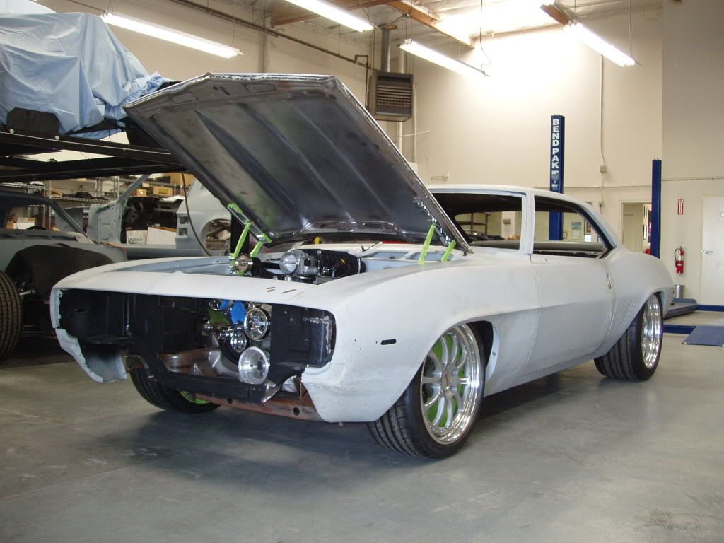

This is what a 69 looks like with a 2 inch stretch & mini tub with no frame notching on 345 30 19's... We have not done this yet to a 69s front fenders on any of the cars here @ the shop.. You wanna be the first!?!??! I have two project 69's that I will sell one of them.. you can pick one & we get started & keep enjoy open tracking the one you have now!!

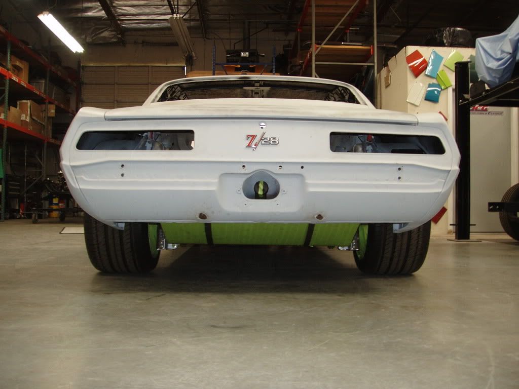

the rear quarters on a 69 already bulge out some from factory I can't imagine another 2 inches without doing the same to the front to keep it looking proportional. Do you have a shot of what it looks like from the front looking back?
What does it do the the rear bumper fitting? also what does it to the rear spoiler fitting? On the 70 camaro it has to effect the 3 piece spoiler.

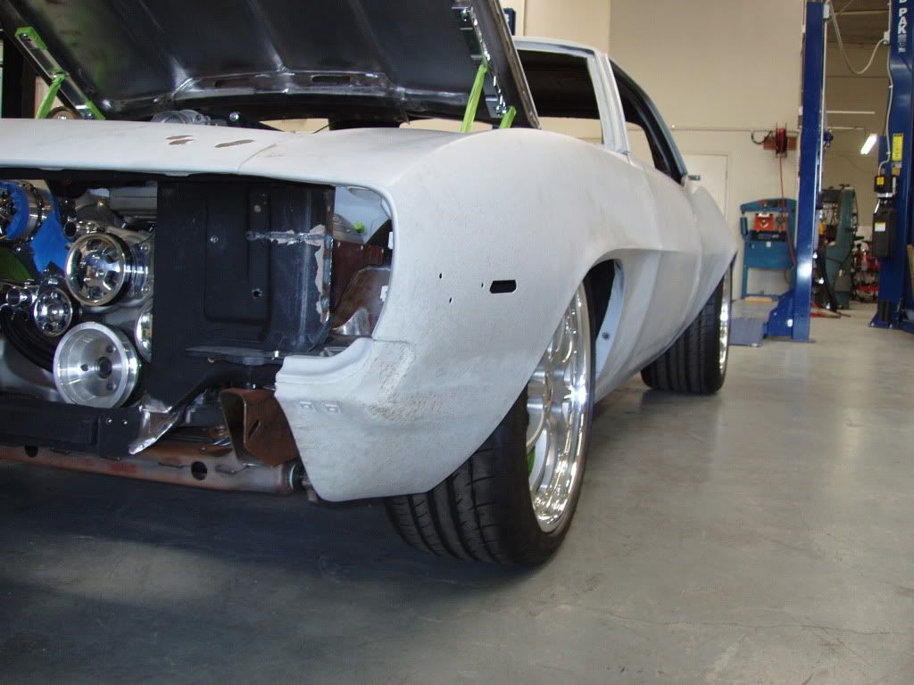

The 69 lines in my opinion are the best of the first gen Camaro.. they have bulge to them that makes them stand apart.. I wanted to stretch the front fenders but the customer liked it with only a rear stretch.. Here is a pic I have of the front view..
The bumper bolted right up.. Have not installed a spolier yet but I think we should not any problems.. It is hard to explain how the rear of the qtr & upper did not move much when we stretched the qtrs.. on 67 & 68 we have had to cut the bumper to fit but I think we found a way to keep from doing that modification.. have not moved further than what you see in the pics for 70's so I can't tell what it will do to a 3 pcs spoiler
