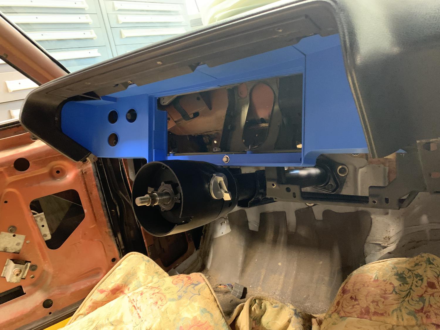

We need the actual height, width, thickness, and corner radius of the Holley 12.3 Pro Dash screen if anyone can help.
We've asked Holley Tech a couple of times and they only provide the body dimensions for a cutout.
We are in the process of 3D printing a dash and the screen needs to recess into that dash.

https://www.holley.com/support/fuel_..._3in_pro_dash/
Cad files on this page.

I just wanted to say the CAD files were a BIG help. Our test print and "fit-check" 3D print of the Cuda' dash.
Thanks! I just don't know why our discussions with Holley Tech couldn't point us to the files......

Wow, that looks great! Thanks to our members for the help.
If you decide to make an extra and wanna sell one let me know I need one for me ‘70 Cuda also. Thanks.

I'll ask - I know that each of the 4 pieces require over 30 hours of print time. So the compensation may be quite a lot. He is, right now, printing the PETG final pieces. The Holley display came in and the test fit was perfect.
