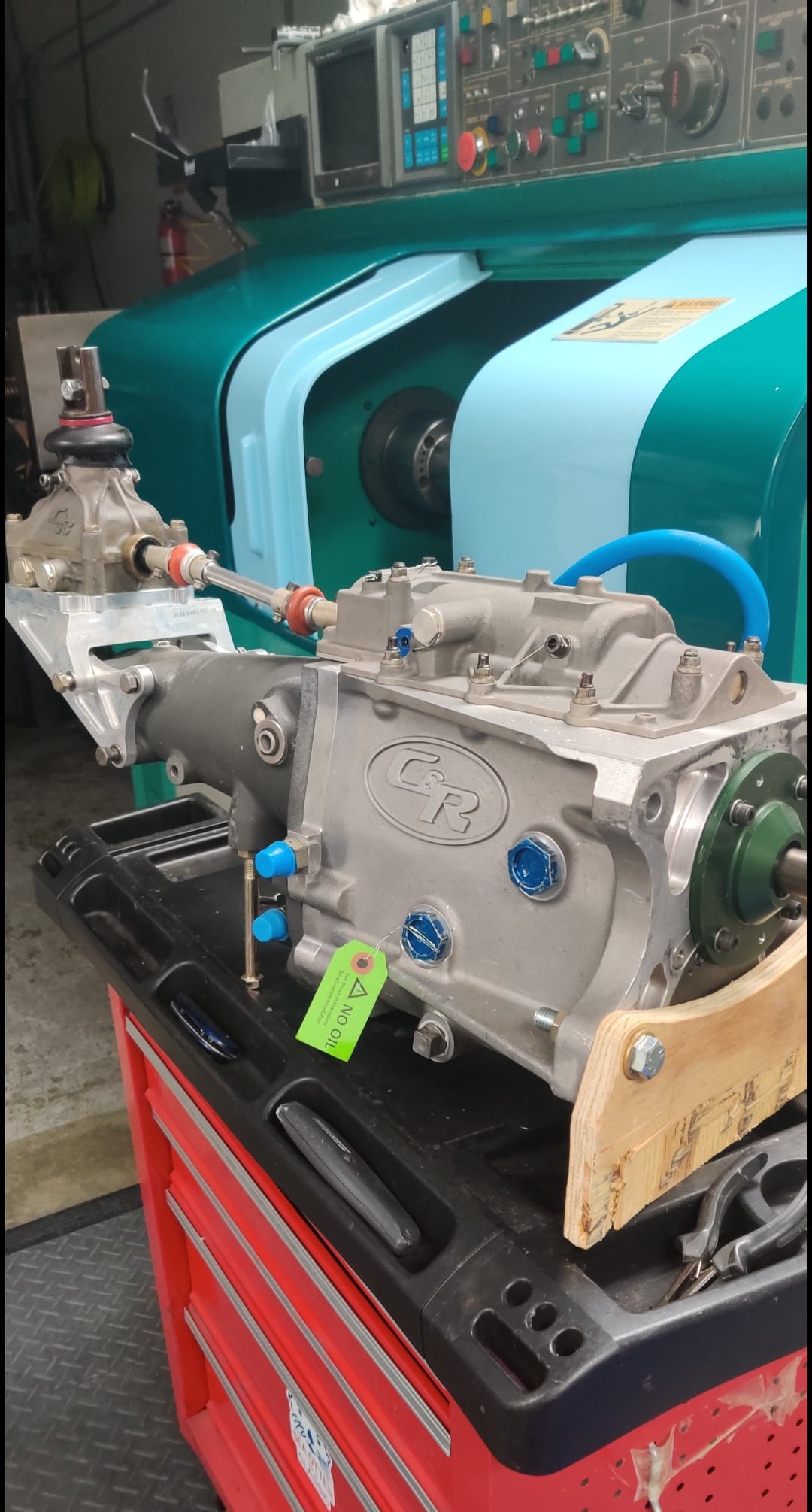

Couple more. Decided to go DBW to compliment the ECU and its capabilities. using a unit from EFI hardware (uses a bosch DBW unit encased in a nice aluminum housing) The long term plan will be a 6 speed air shifted sequential but that is a little pricey so for now the 4 speed is going in. Plan on using a strain gage in the shifter for flat upshifts.
