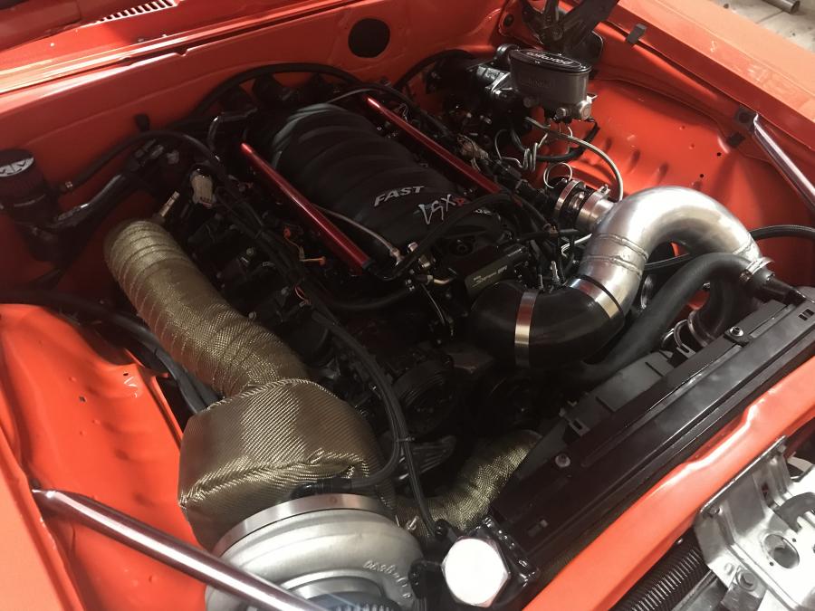

I am looking for pictures of first gen Camaros with the hooker LS turbo manifolds. I have some on order and would like to see setups and fitment if anybody has used these on their project.

Are you talking about the cast manifolds with the cross over under the transmission? If that's the case, the cast driver's side manifold will not work on a first gen Camaro. You can get just the passenger side manifold and do a different cast manifolds on the driver's side and a custom cross over.

Yes I am talking about the cast set, does the passenger side hit the steering box I would think there's room for clearance.

Yes, the driver's side hits the steering box, unless you are in Australia...

Since the hooker manifold won't fit on driver side does anybody know a ls manifold that will fit on the driver side of a 69 Camaro

Just wanted to post an update I was able to make this work with the f body manifold on driver side Iíve posted pictures. This is mountinga. S480 turbo and still using having power steering and a/c

Nice work! I can't wait to drive my turbo Chevelle hopefully this year....

So you went with an F body manifold on the driver side? What year? Can you show us pictures of that fitting? Did you still use the hooker manifold on the passenger side?

My guess is the driver's side is 4th gen F-body, but it would be nice to get a confirmation.

Very nice. If I might ask what front accessory drive kit\system did you utilize?
