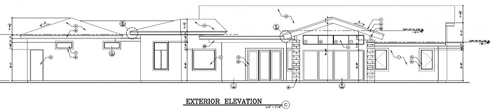

Here is the rear elevation and the site plan. The great room has a 15' ceiling and the slider is 8' tall by 16' wide with 4 windows above it. We also have a nice slider off the dining room. We left the last .25 acre natural as I don't want to have to maintain it or pay to landscape it. 3/4 acre is PLENTY in the desert. I still have the flexibility to use it later as I'm installing a view fence. Who knows, I may end up putting a casita or shop back there someday. It's zoned for horses, but I have no desire. We set the house well back from the street to give it a nice deep set back and width from the street. The finished floor is higher than I thought so the house is built up pretty high to help or view and curb appeal. The negative is I now need to bring in over 20 loads of dirt to level out the front and back. I wanted to use my native soil for the foundation. We hope to get some free dirt from pool contractors, etc..
