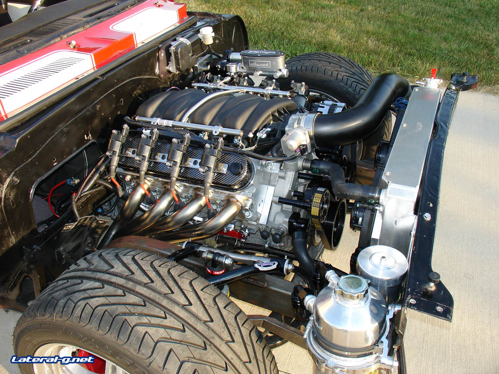

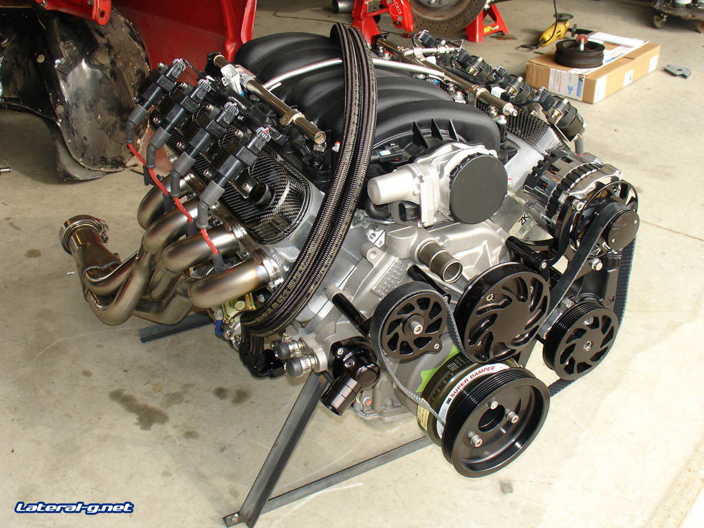

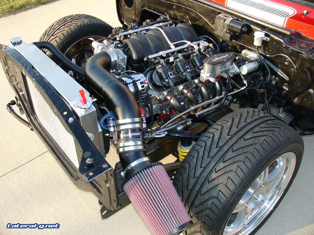

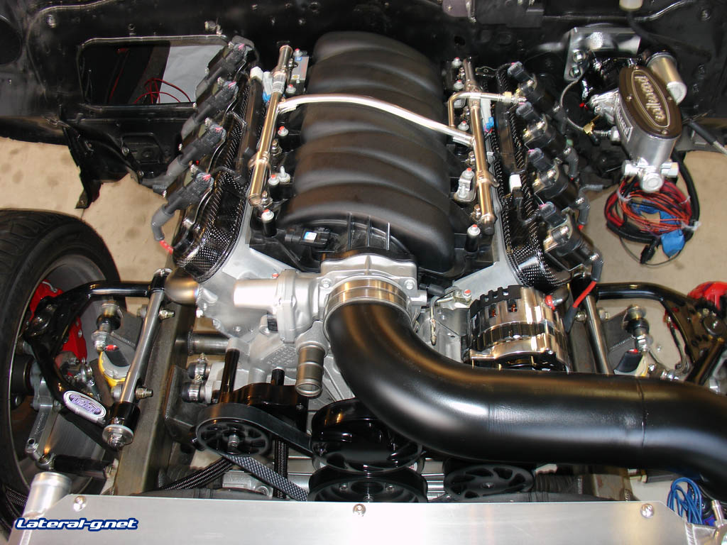

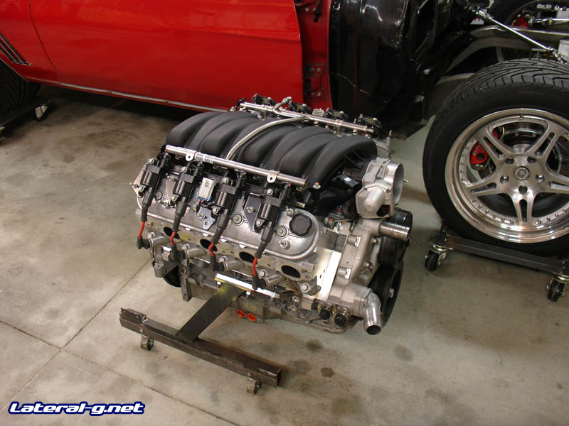

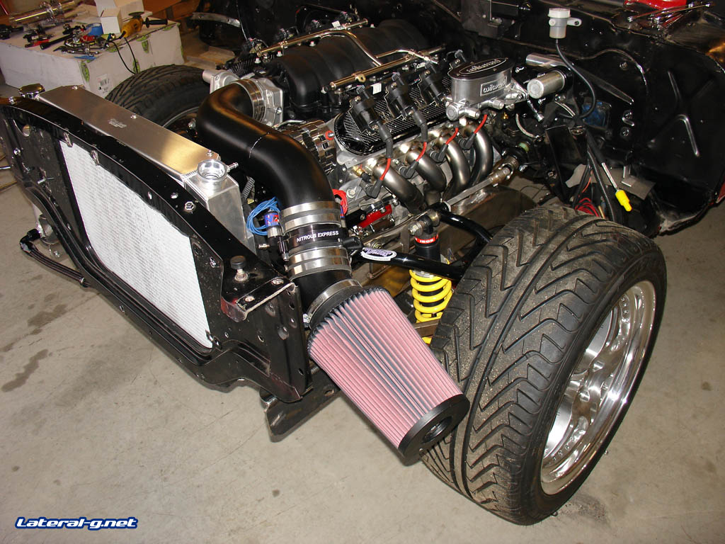

The motor is completely finished and ready to fire.  Just need to finish up the power steering and Hydroboost plumbing as well as the fuel line.
Highslide JS Highslide JS Highslide JS Highslide JS Highslide JS Highslide JS Highslide JS Highslide JS Highslide JS Highslide JS Highslide JS Highslide JS Highslide JS Highslide JS Highslide JS

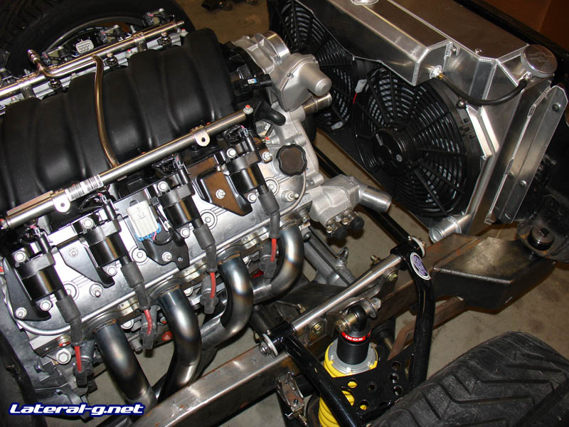

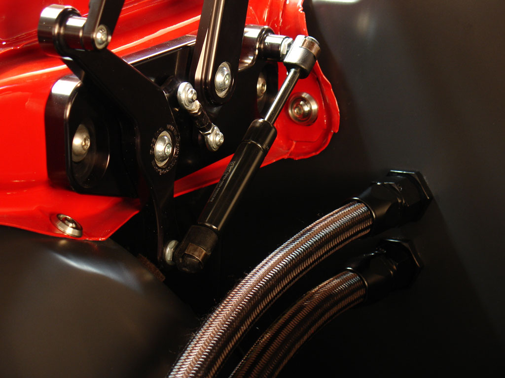

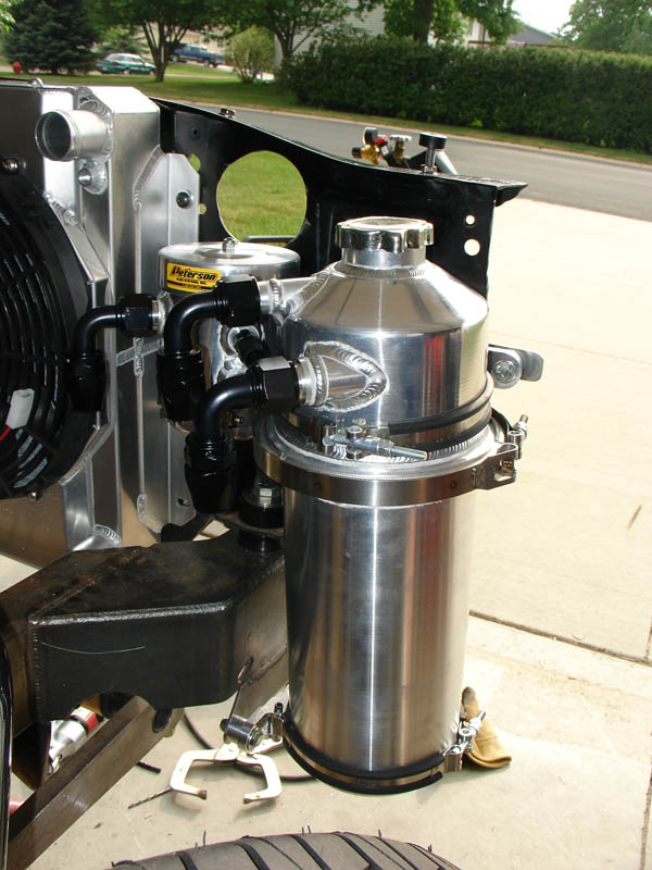

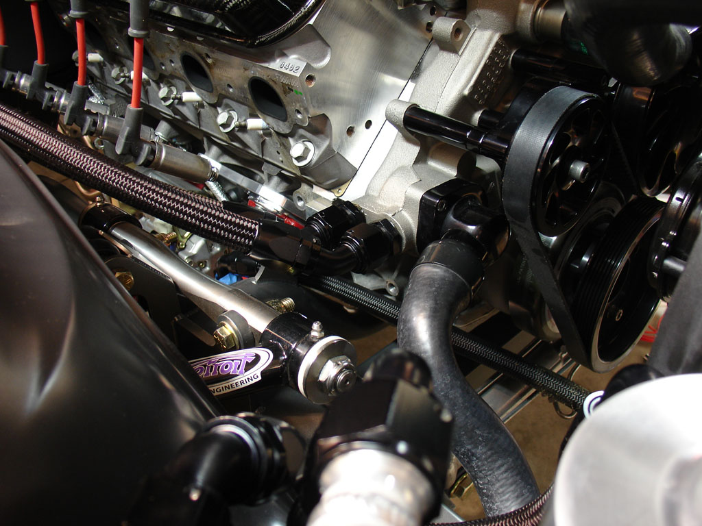

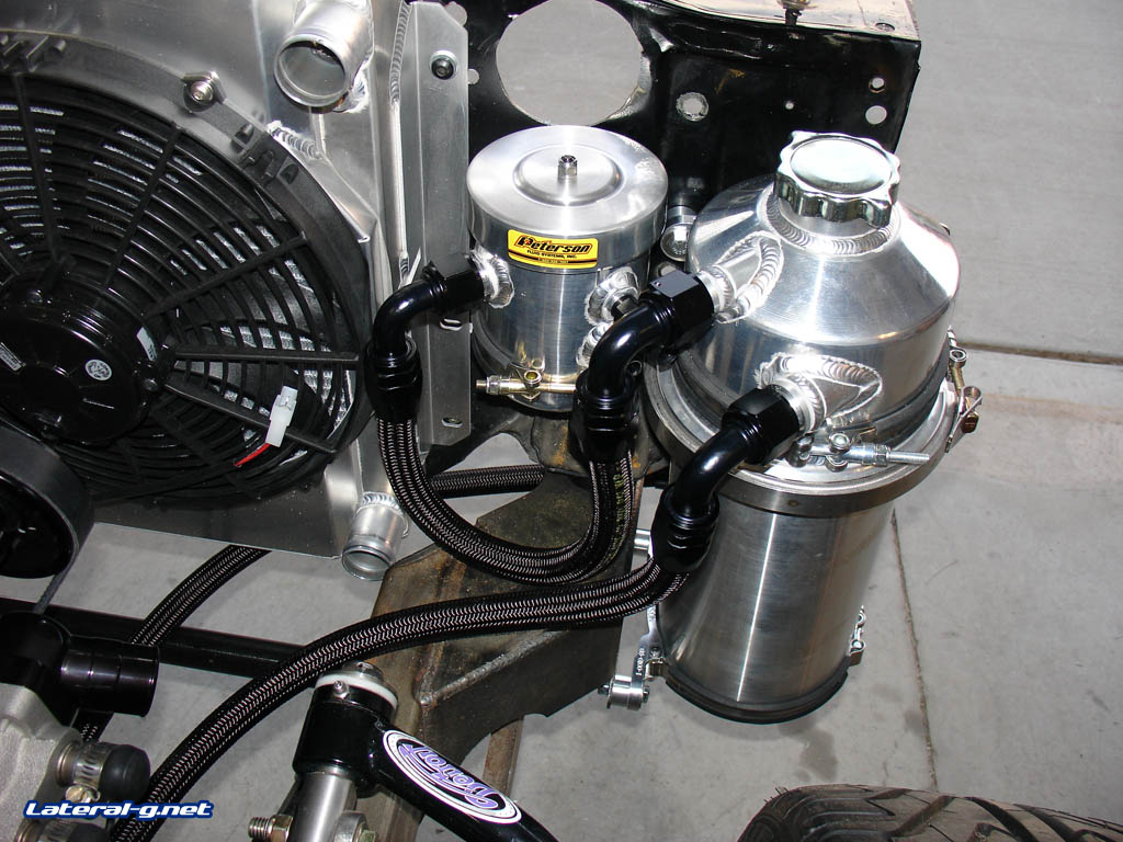

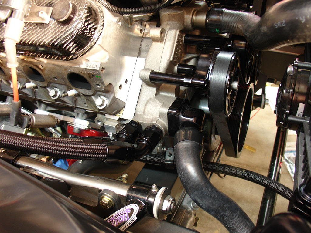

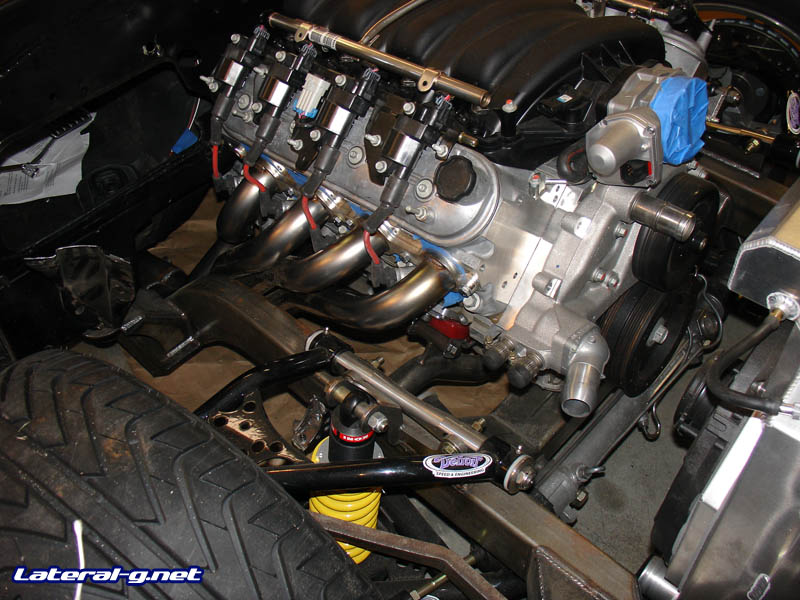

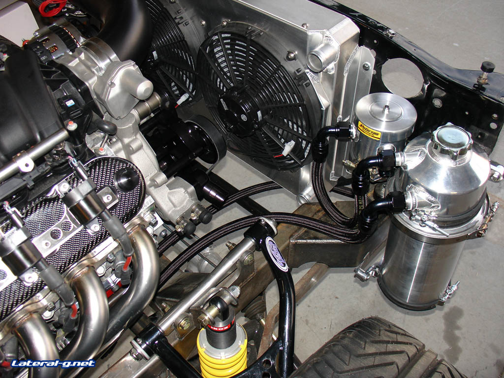

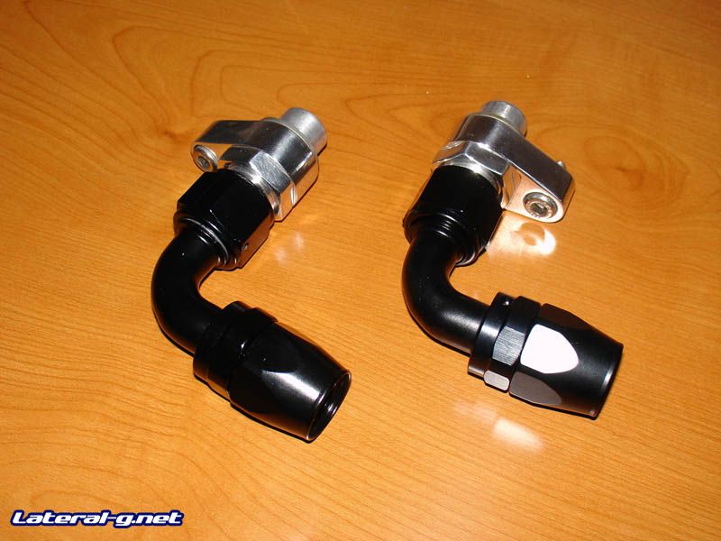

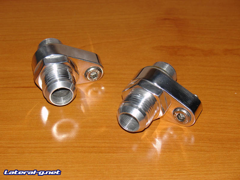

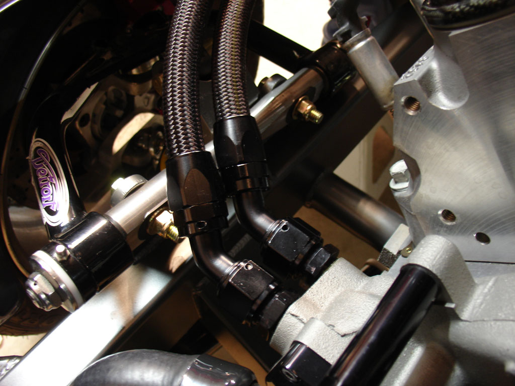

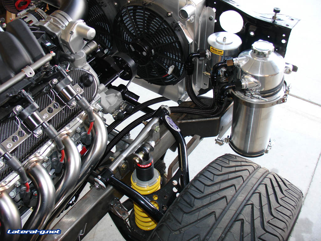

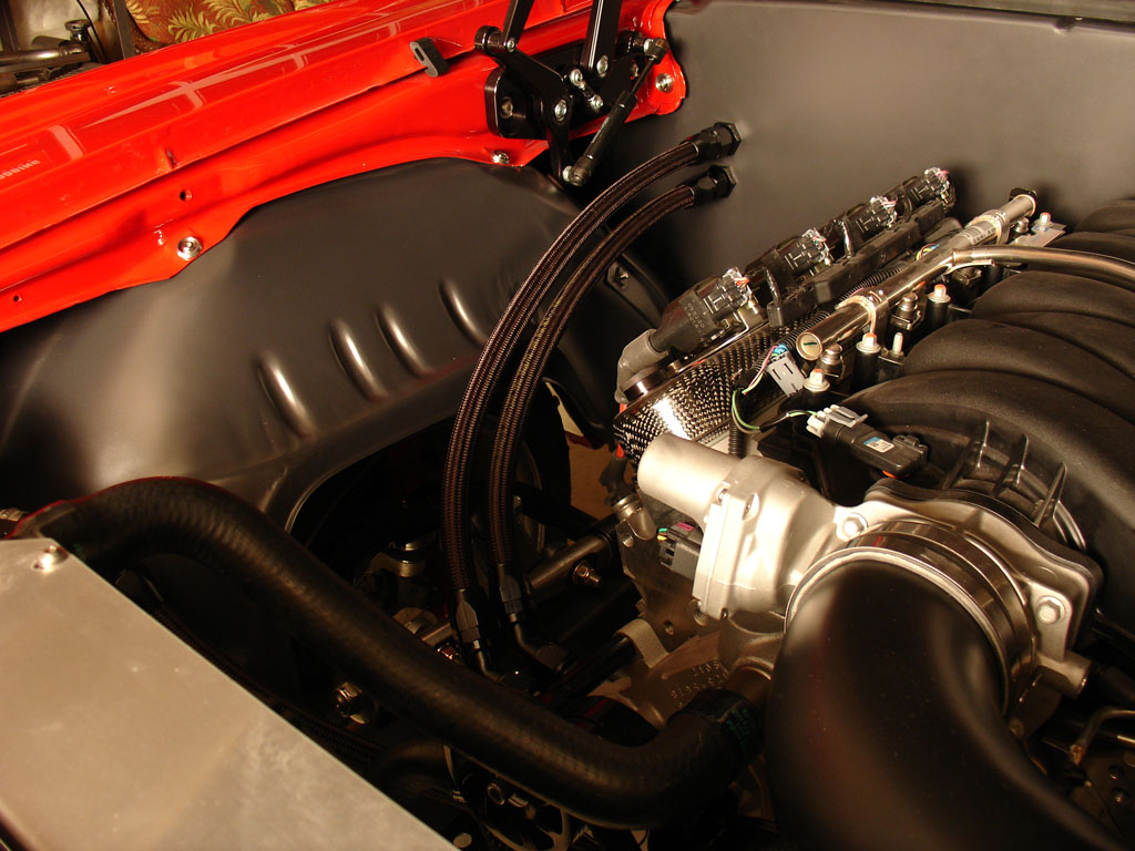

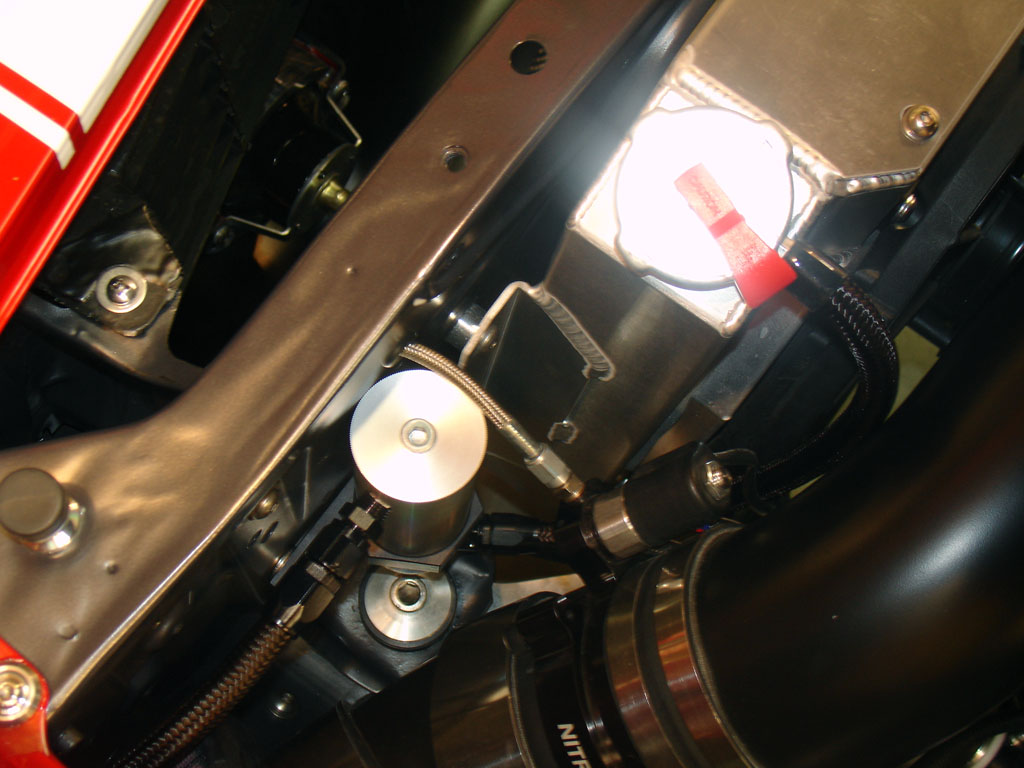

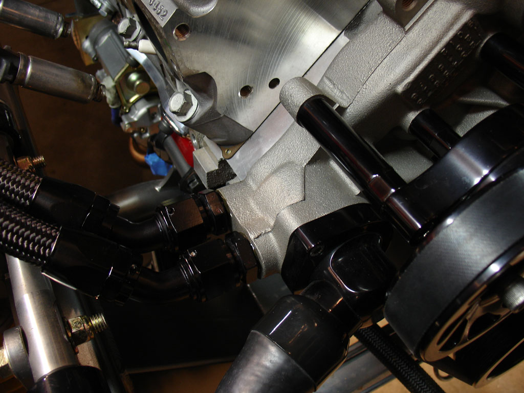

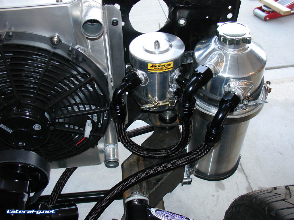

I drilled and tapped the water pump to 1/2" NPT and ran -12 lines through the firewall.

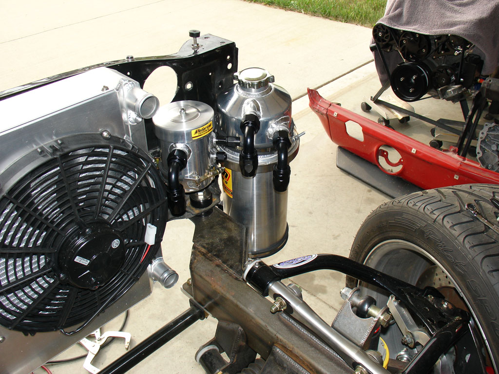

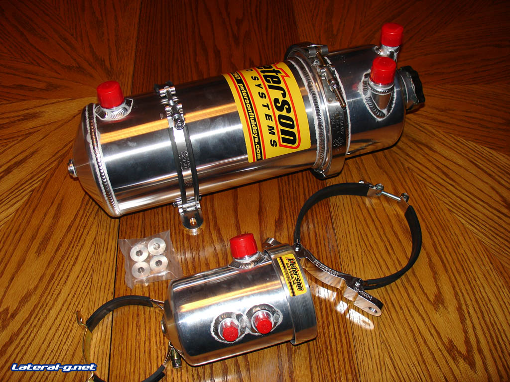

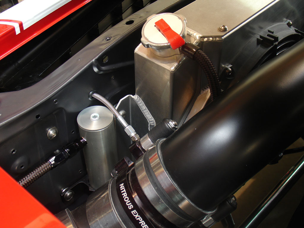

I used a Mike Norris Motorsports catch can as a coolant recover tank.

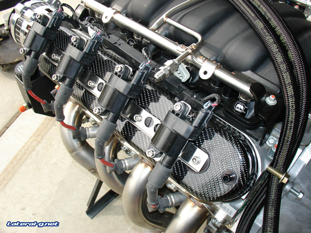

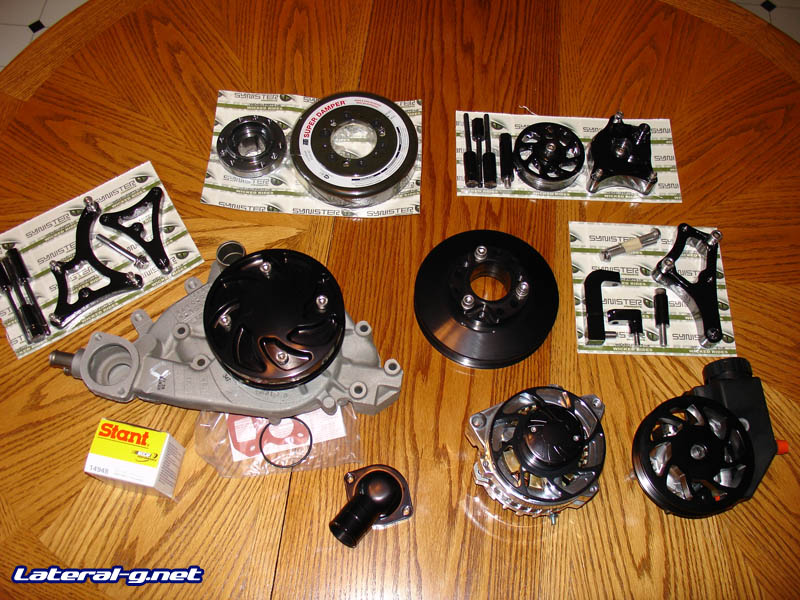

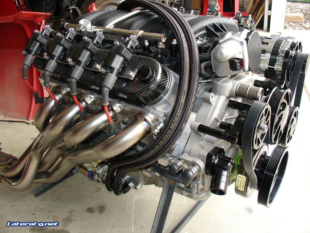

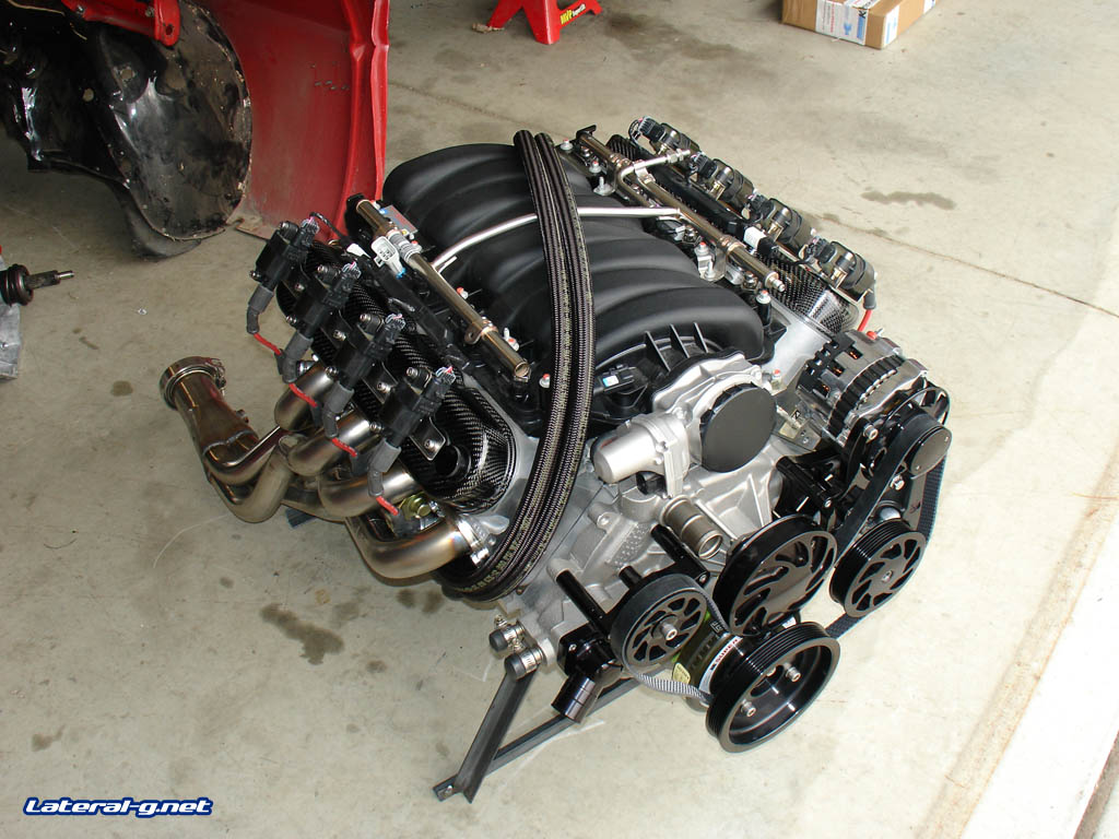

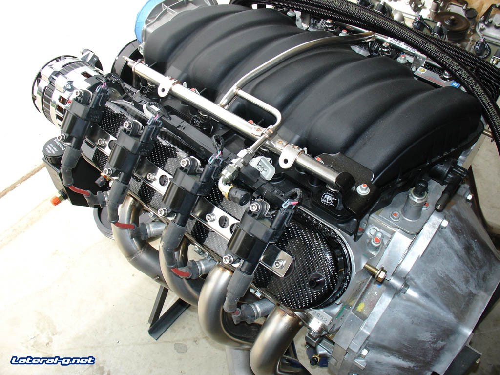

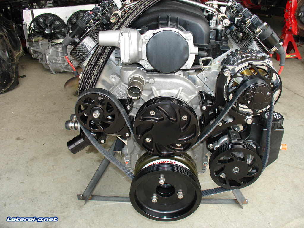

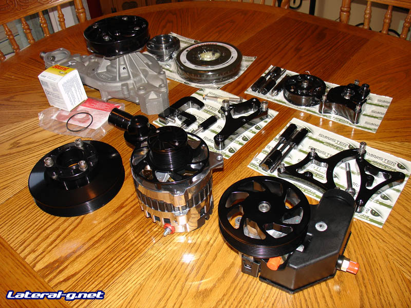

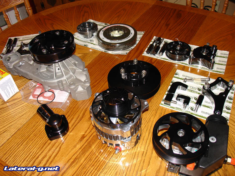

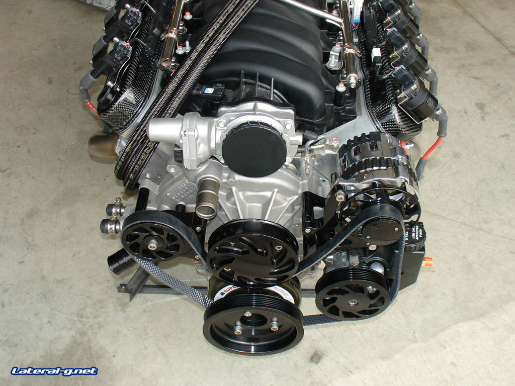

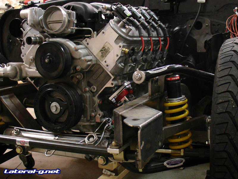

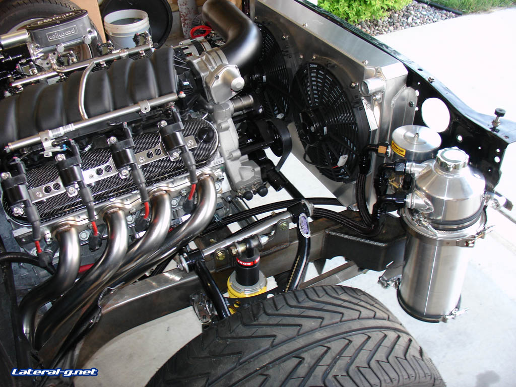

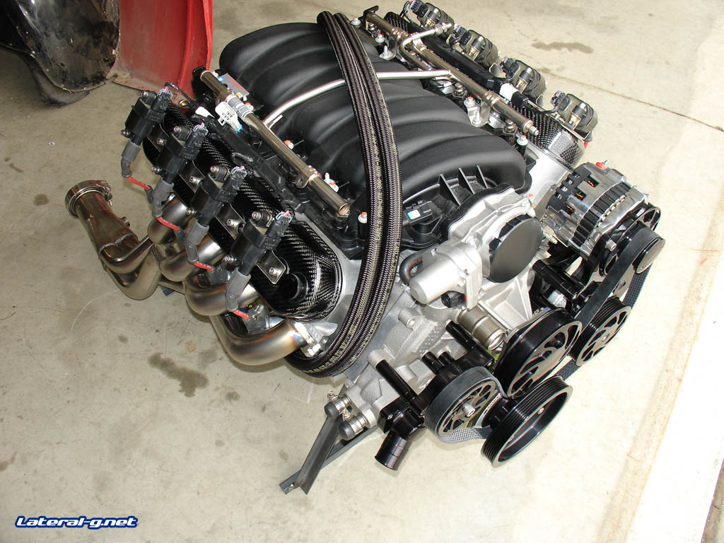

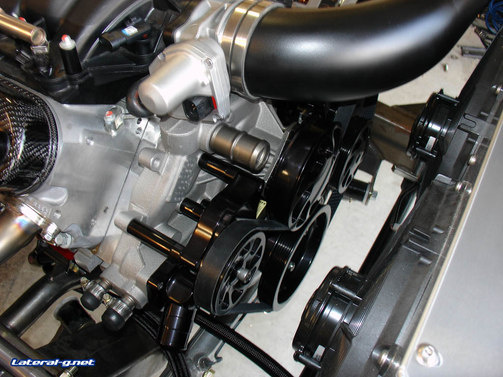

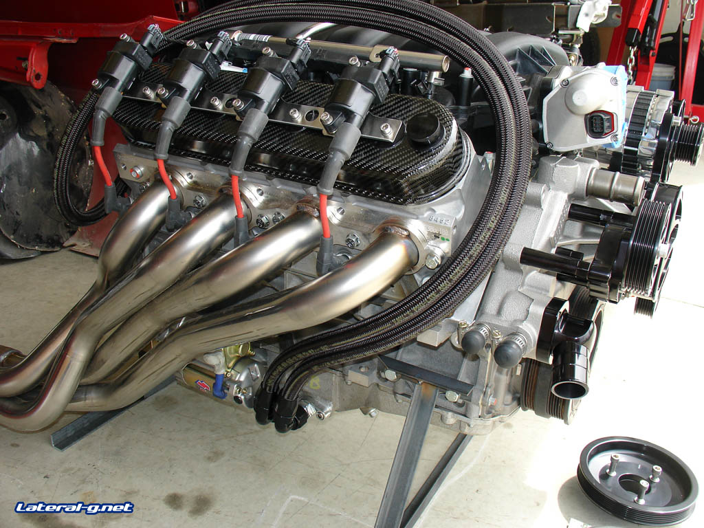

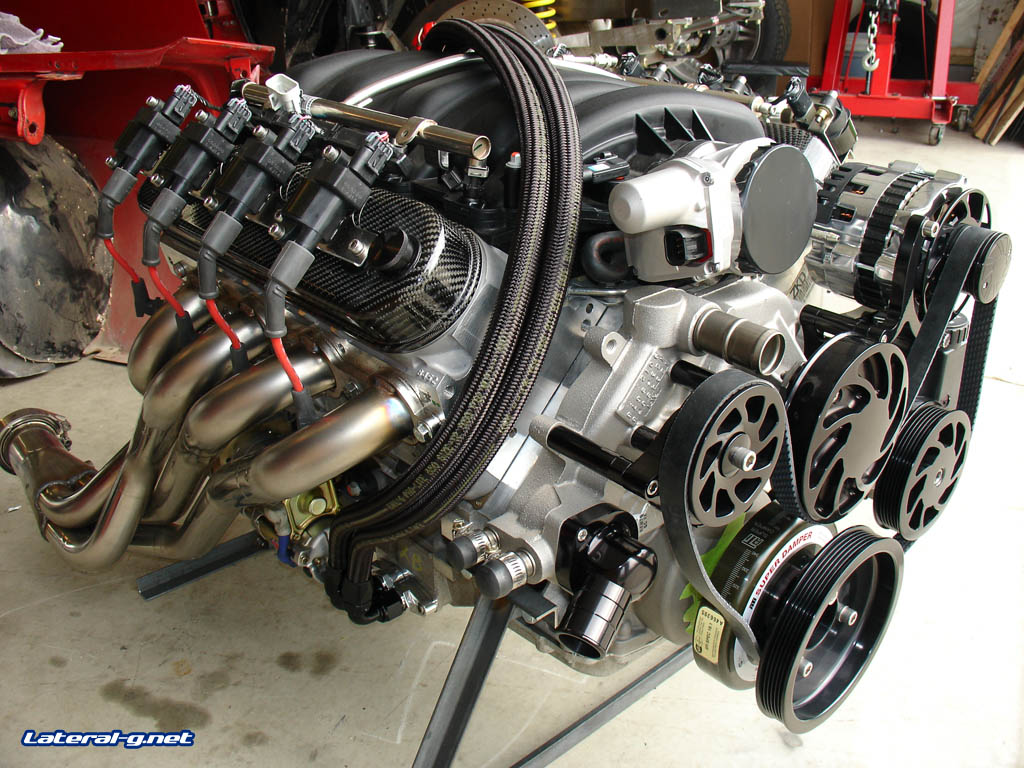

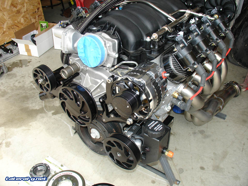

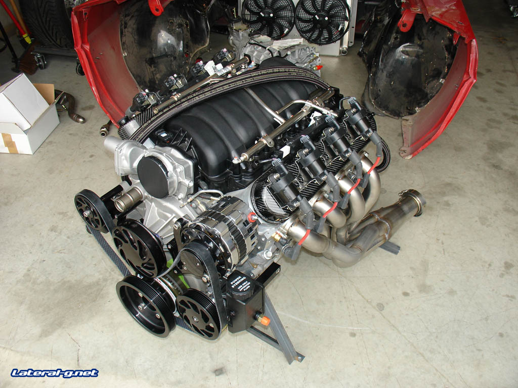

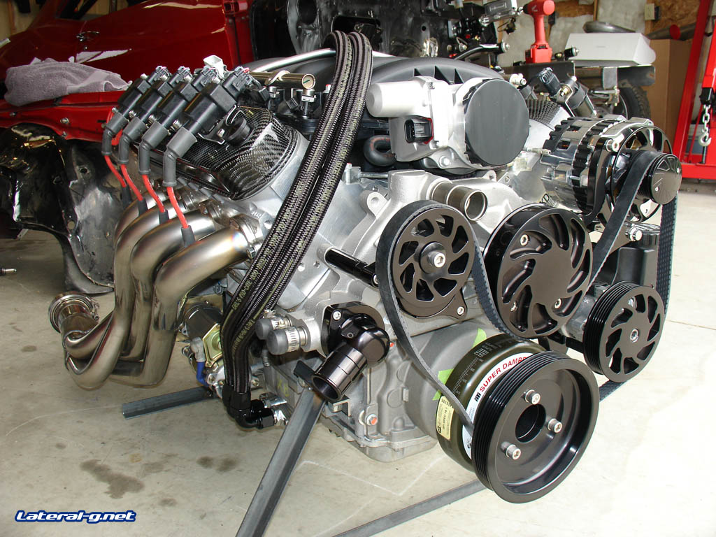

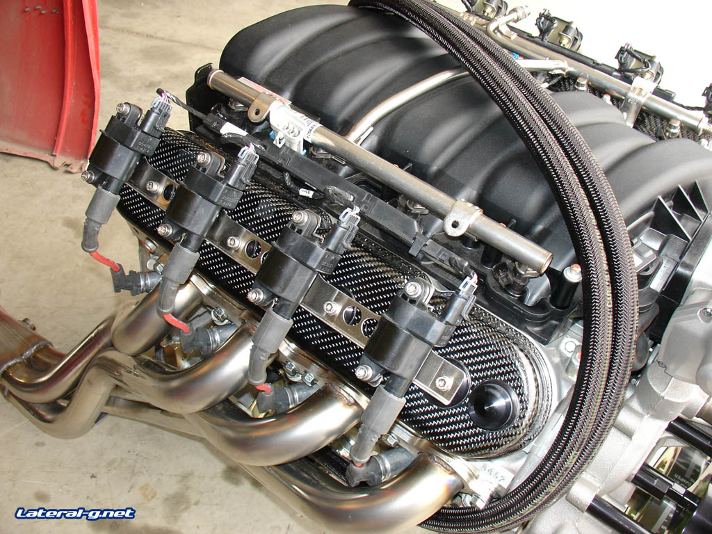

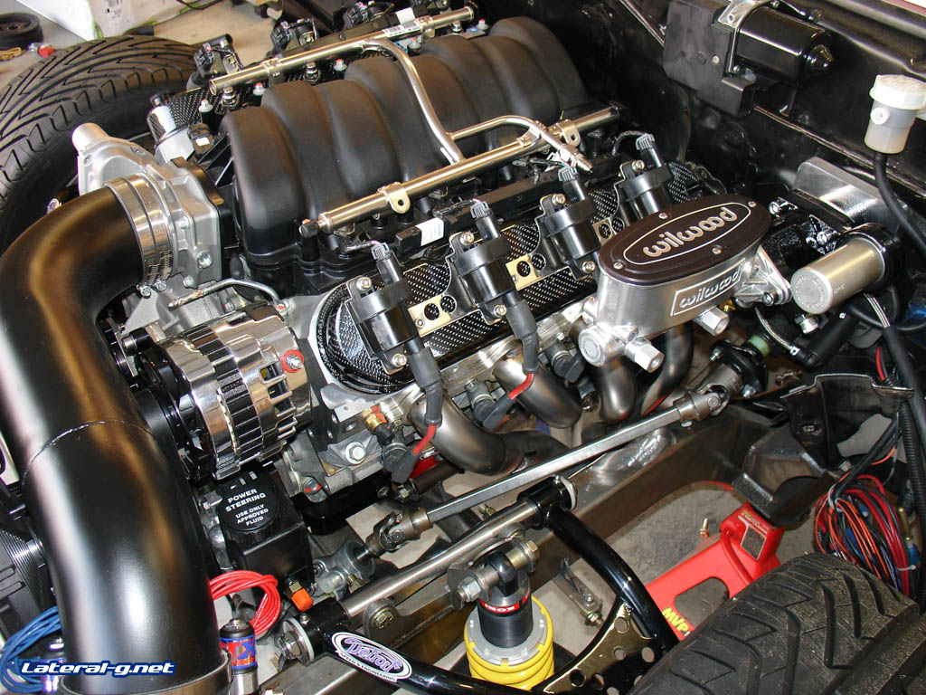

Latest eye candy, Carbon Fiber Valve Covers and a front accessory drive system anodized black from Synister Products.  The parts are nothing short of amazing.  Pictures don't do them justice.  In some of these pics, the balancer isn't installed yet.
Highslide JS Highslide JS Highslide JS Highslide JS Highslide JS Highslide JS Highslide JS Highslide JS Highslide JS Highslide JS Highslide JS Highslide JS Highslide JS Highslide JS Highslide JS Highslide JS Highslide JS Highslide JS Highslide JS Highslide JSHighslide JS Highslide JS Highslide JS Highslide JS Highslide JS

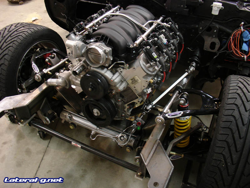

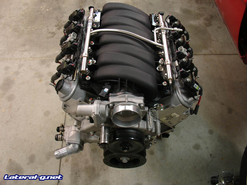

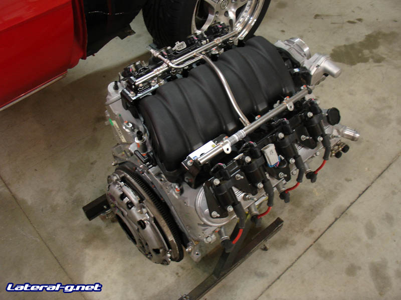

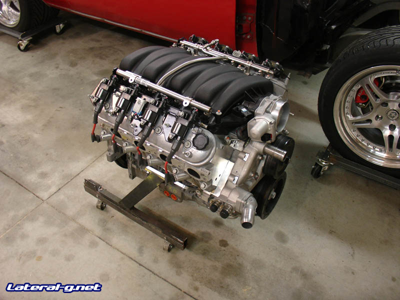

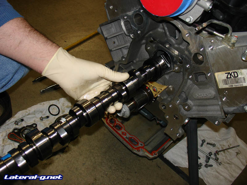

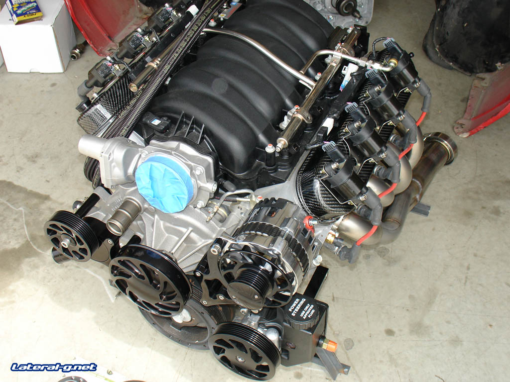

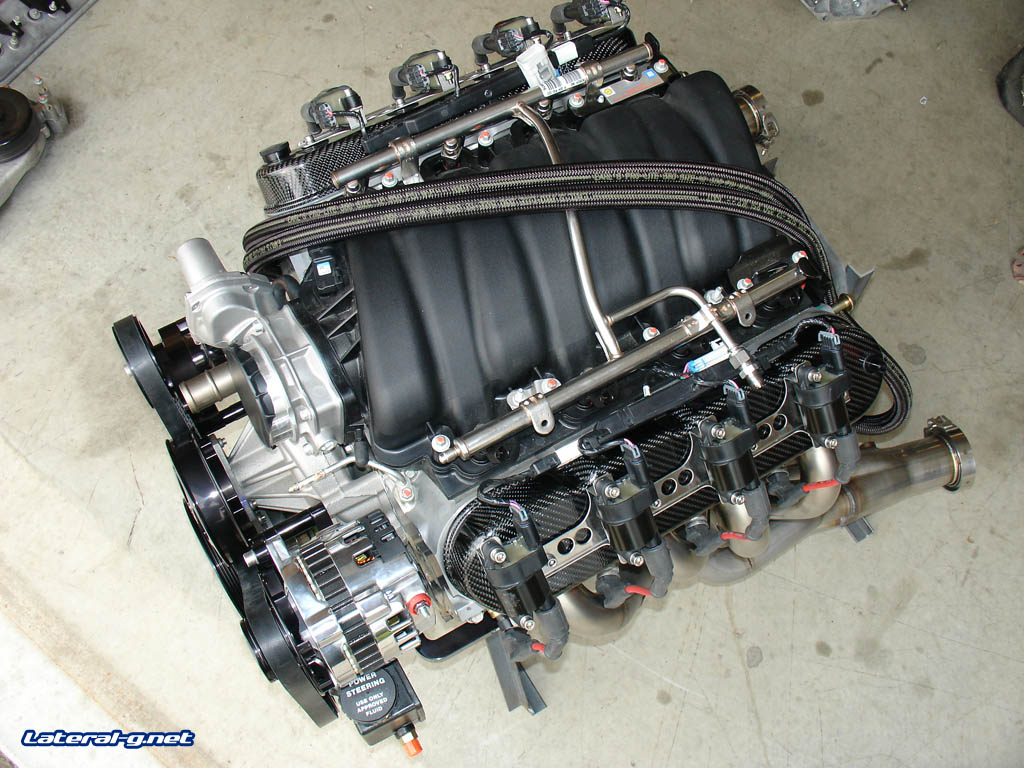

LS7 with a few extra goodies which include a cam from Katech which will put it at 600hp and 575 ft/lbs tq.  More details and information about the install, including header fitment, oil pan clearance, dry sump plumbing, etc, coming soon.

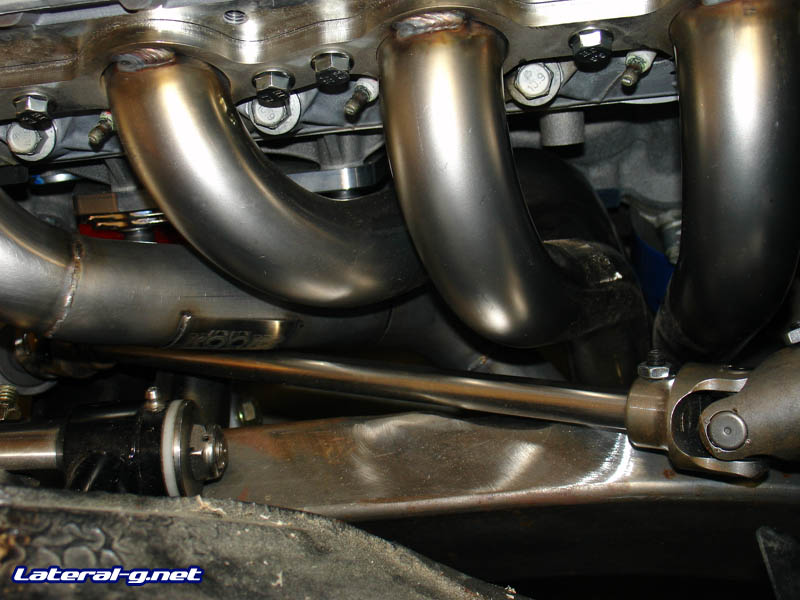

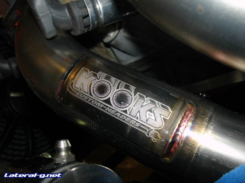

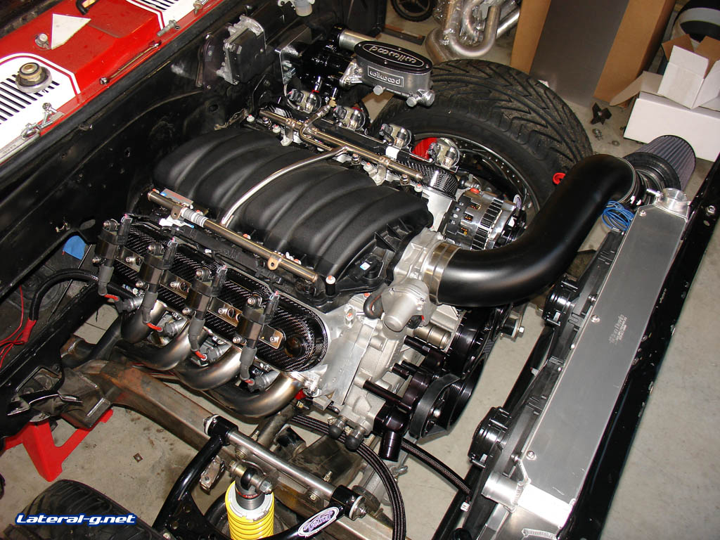

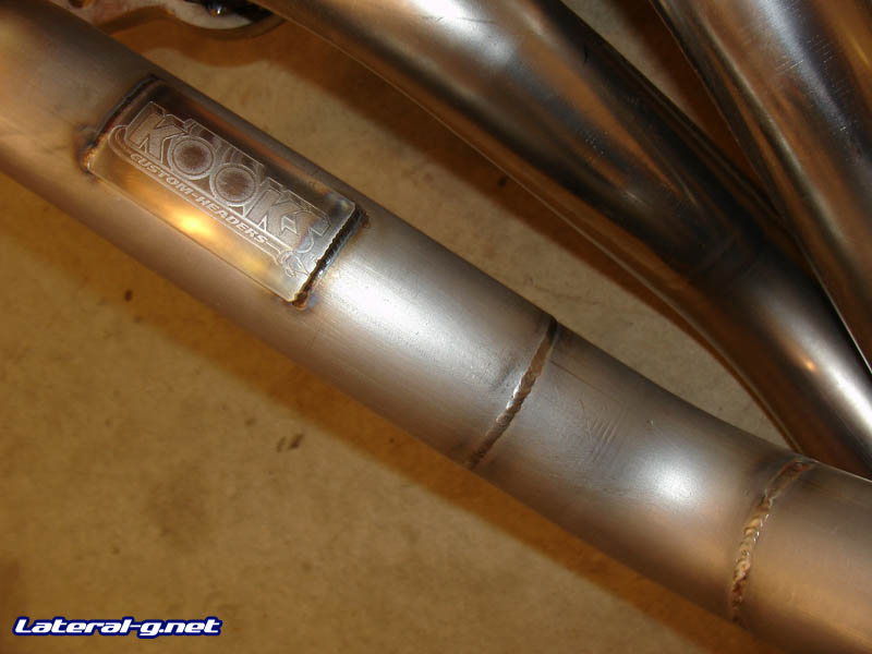

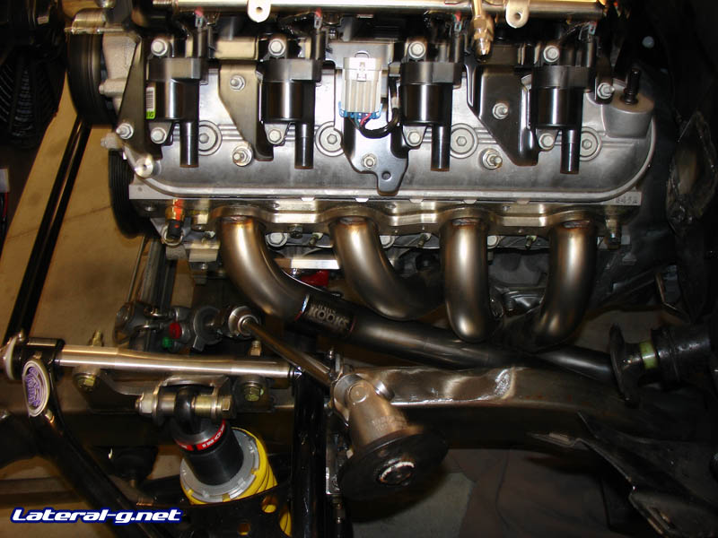

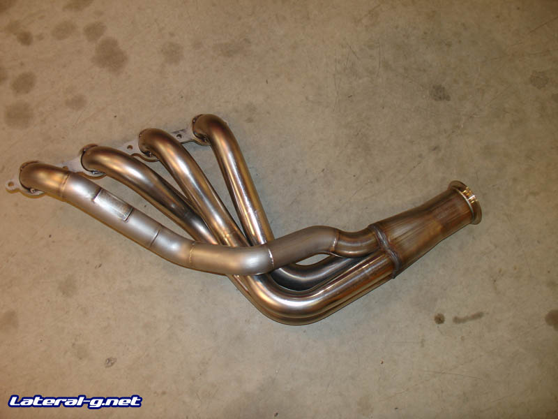

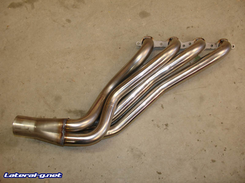

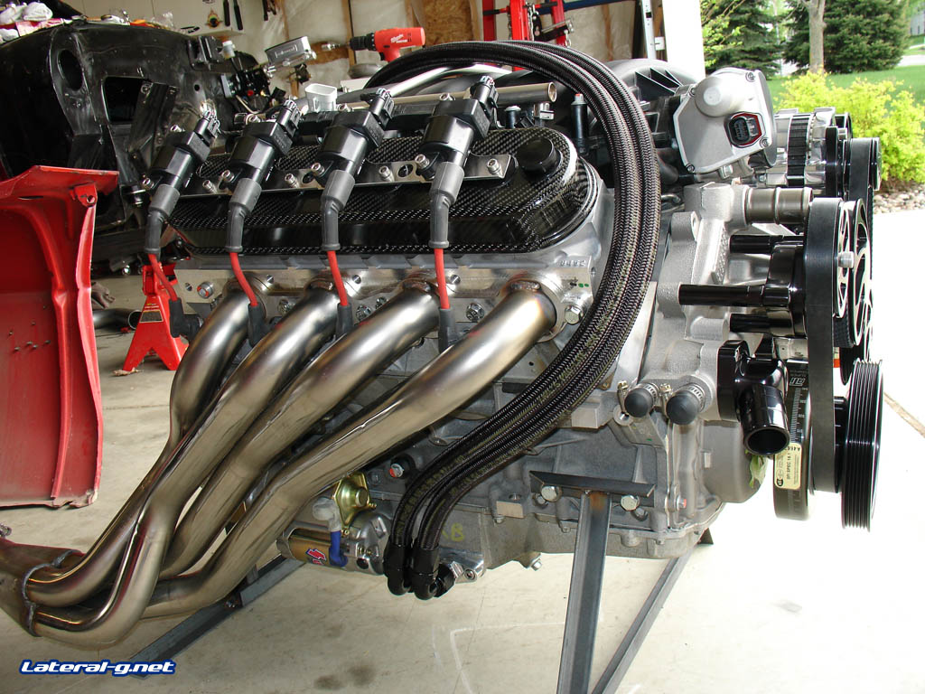

Headers from Kook's Custom Headers.  They are 304 stainless steel, 1 7/8" primaries with 3" venturi collectors.  They have the LS7 flange and are made specifically to work with the unique exhaust port shape of the LS7.

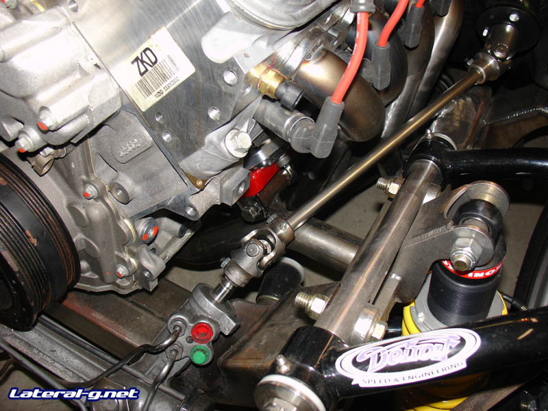

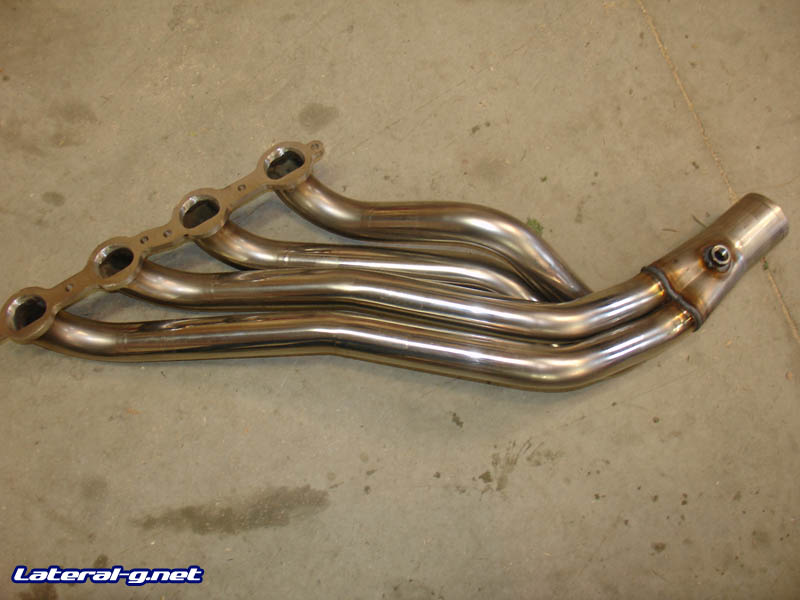

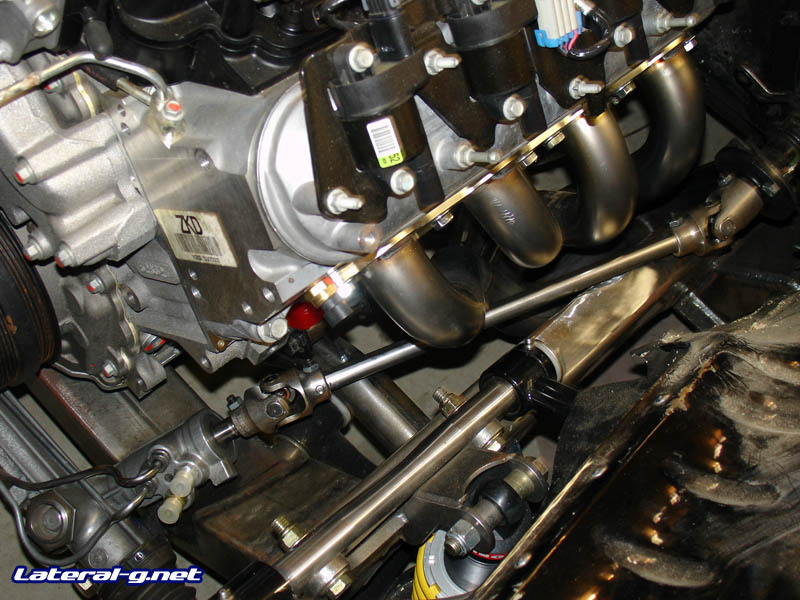

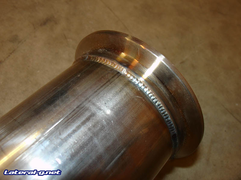

There was an issue with the steering shaft and the number one primary, so I sent the Kooks Headers to Stenod Performance to have it moved.  As long as they were there, I had them install a set of V-band collector flanges.  They did a fantastic job!

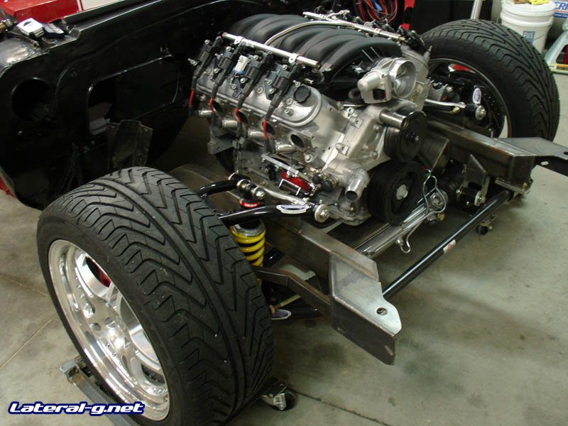

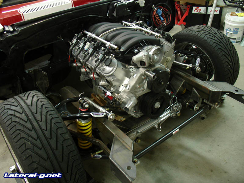

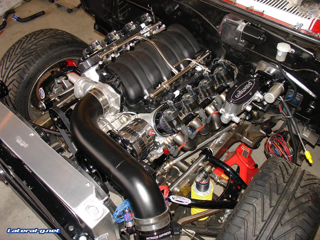

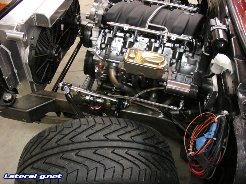

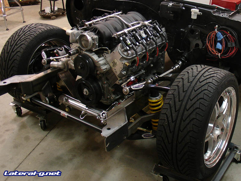

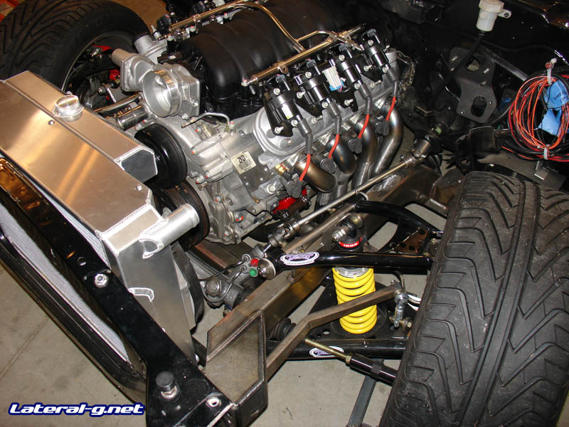

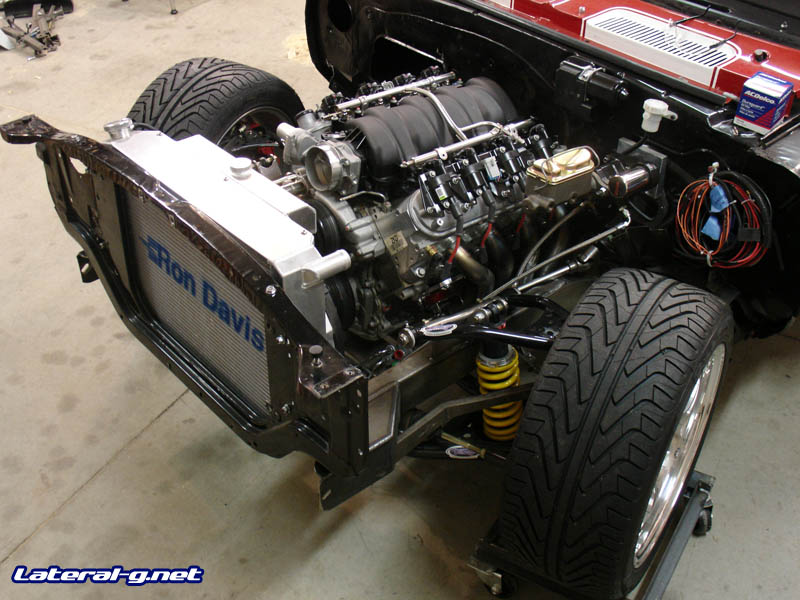

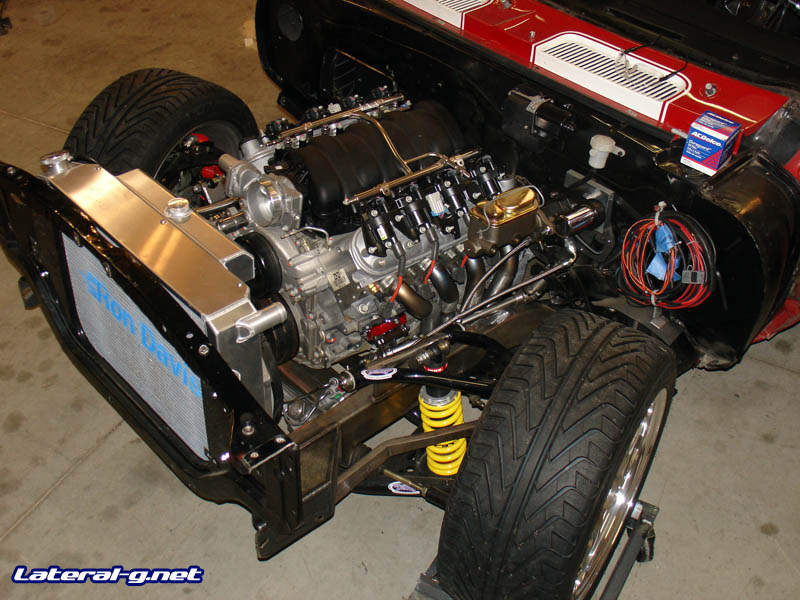

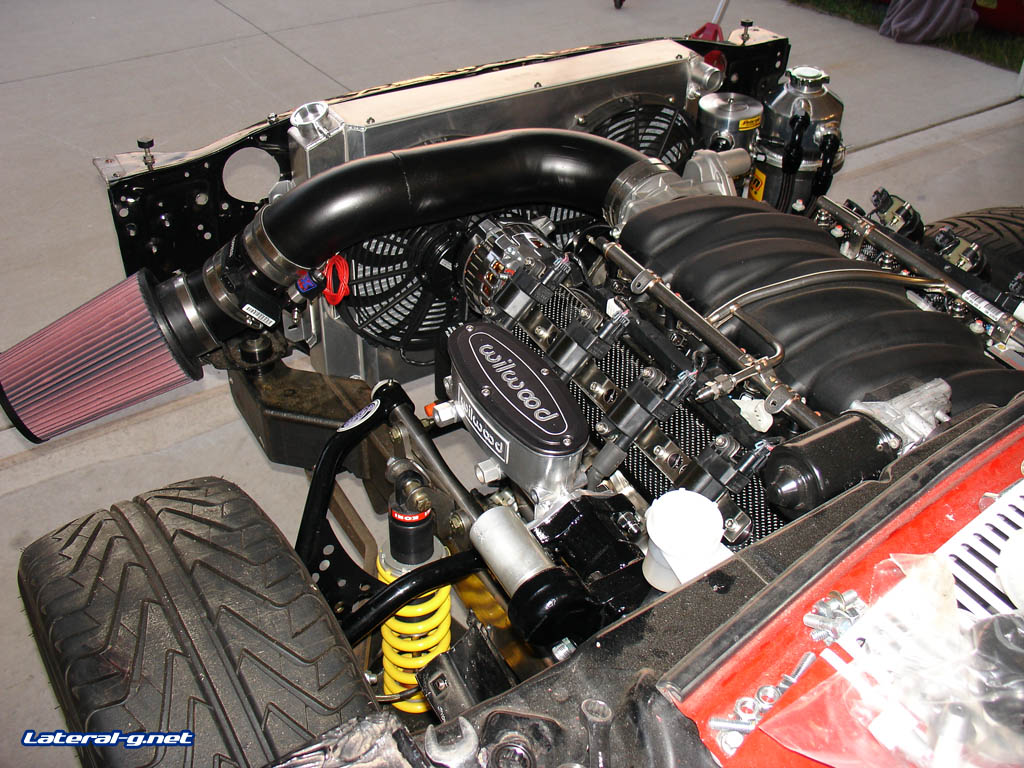

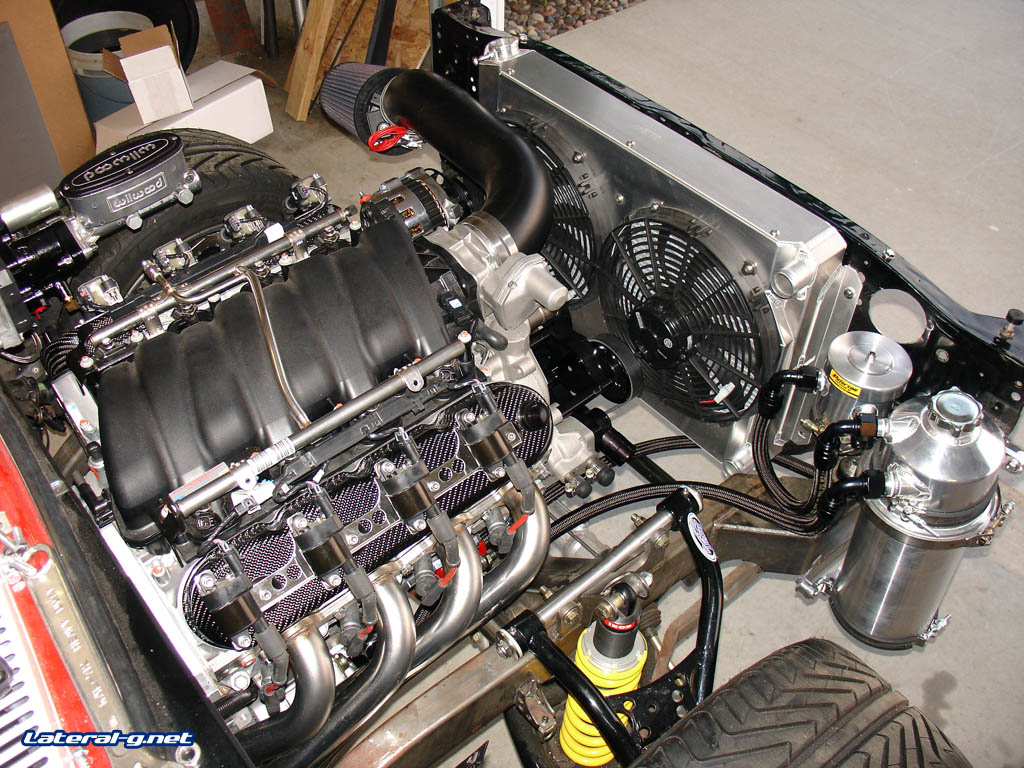

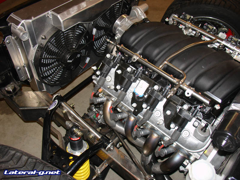

Motor in with the Rockland Standard T56, Ron Davis Radiator, AutoKraft Race Cars and Restorations adapter mounts, etc.  Starting to feel like a car again.

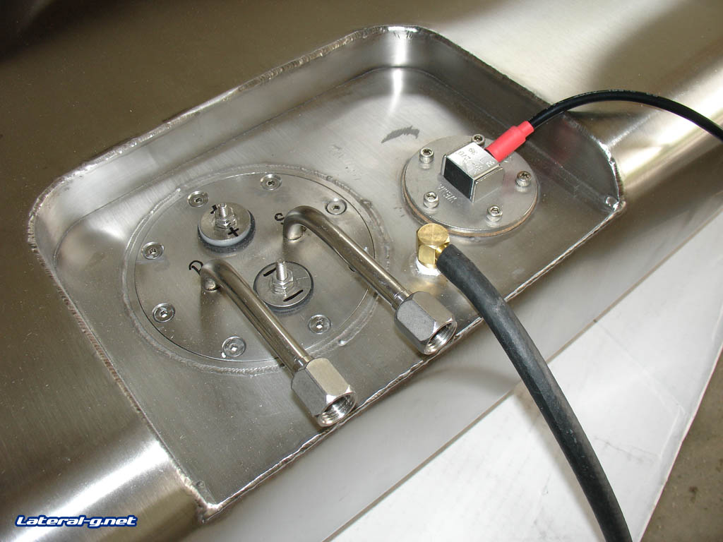

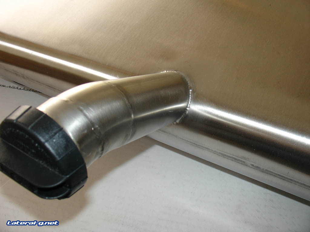

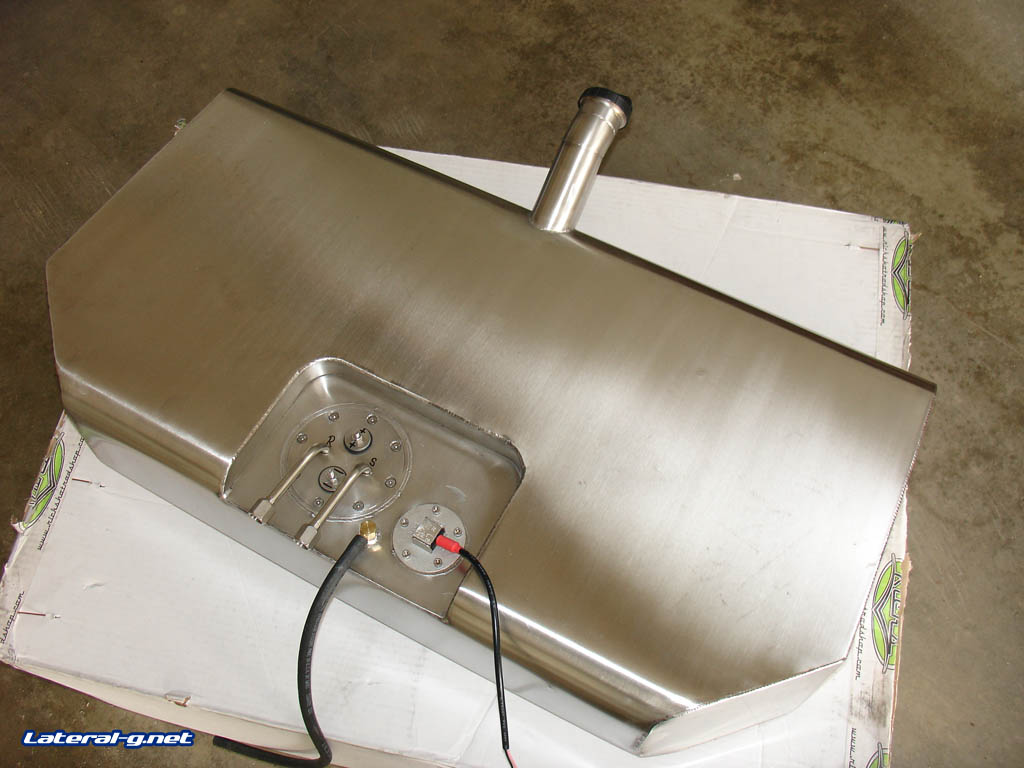

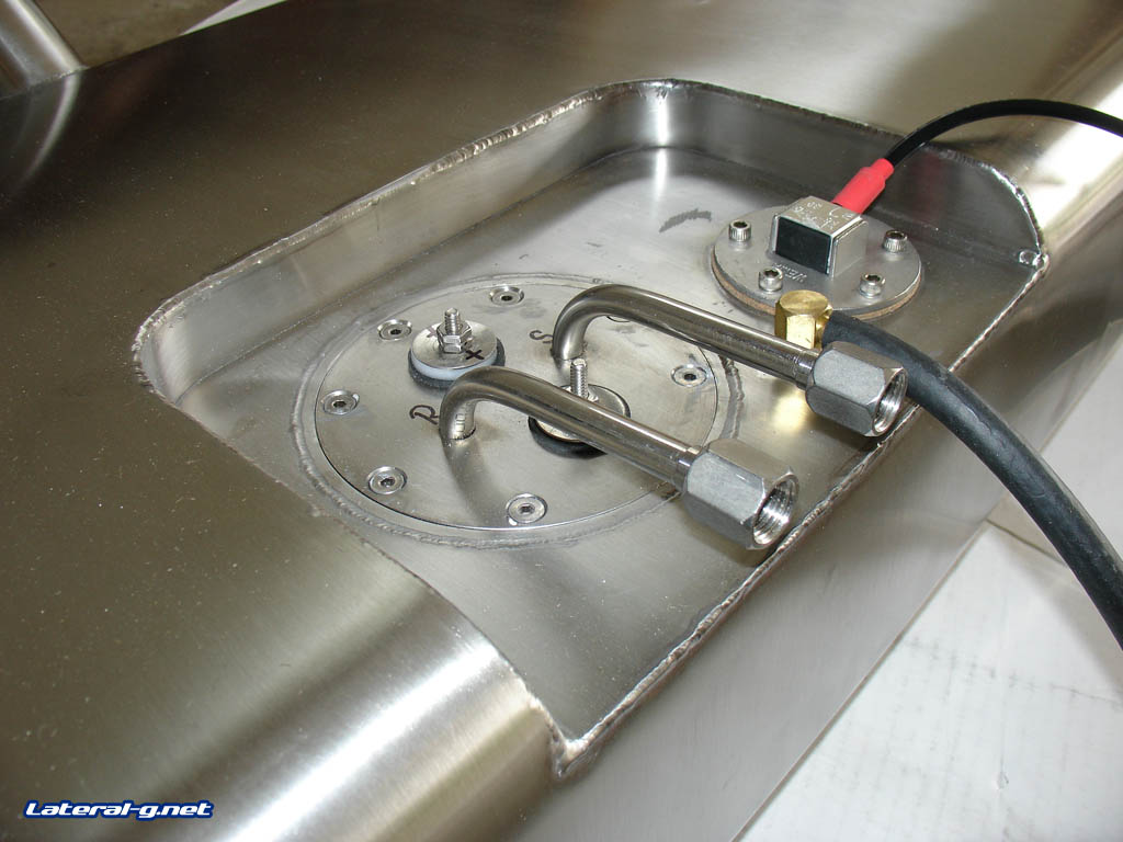

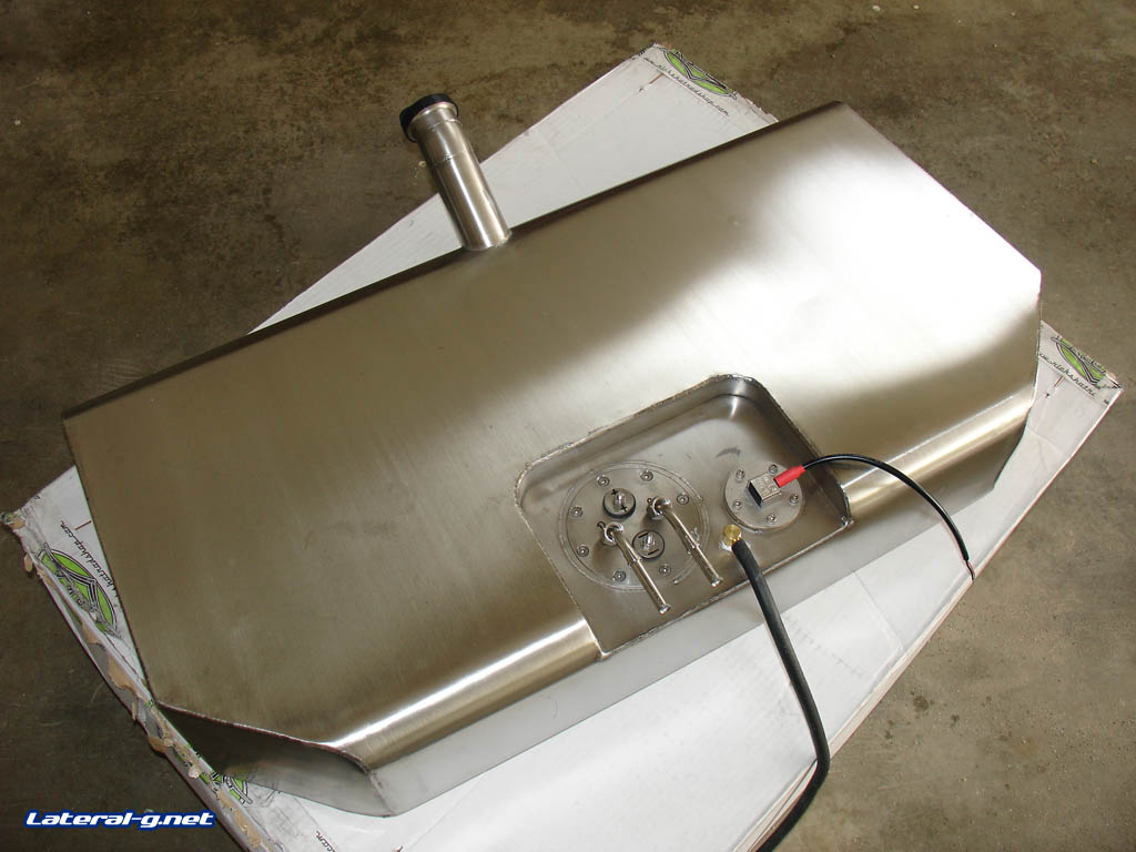

Custom stainless steel EFI fuel tank from Rick's Hot Rod Shop.  It has a Walbro 255 in tank pump, a GM 0-90 ohm sending unit, and has the corners beveled for extra clearance for getting the 3" tailpipes over the DSE Quadra-Link.

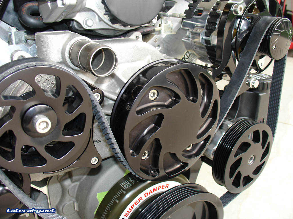

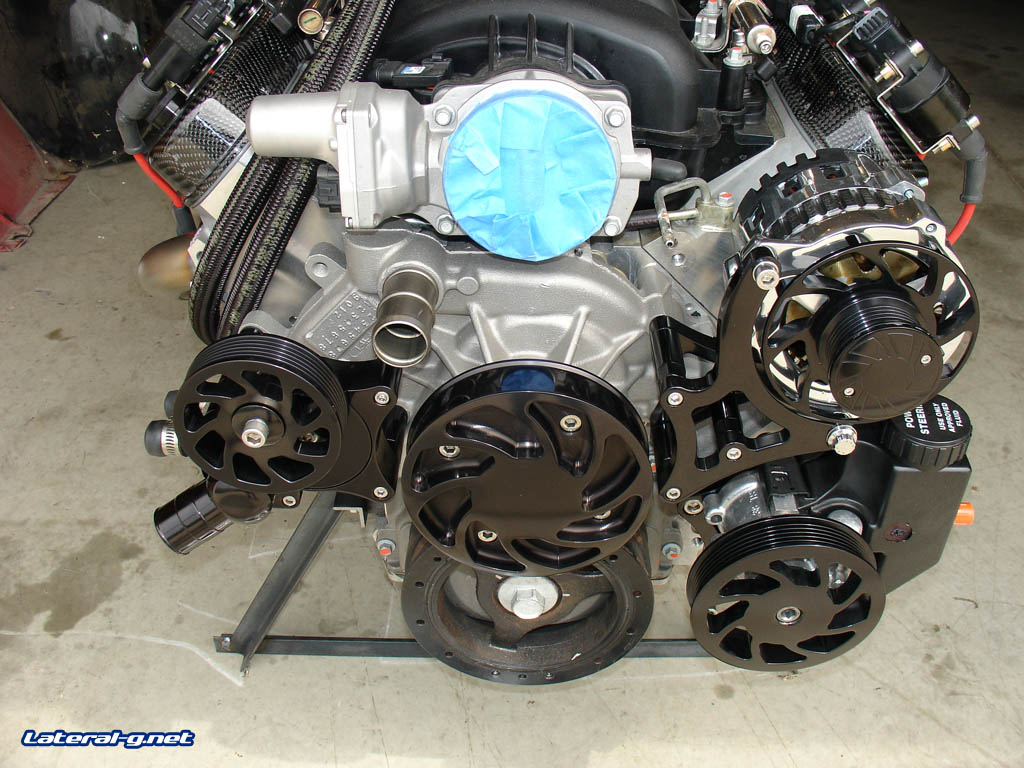

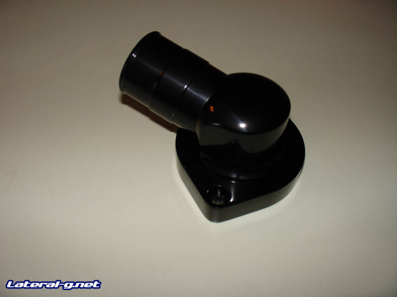

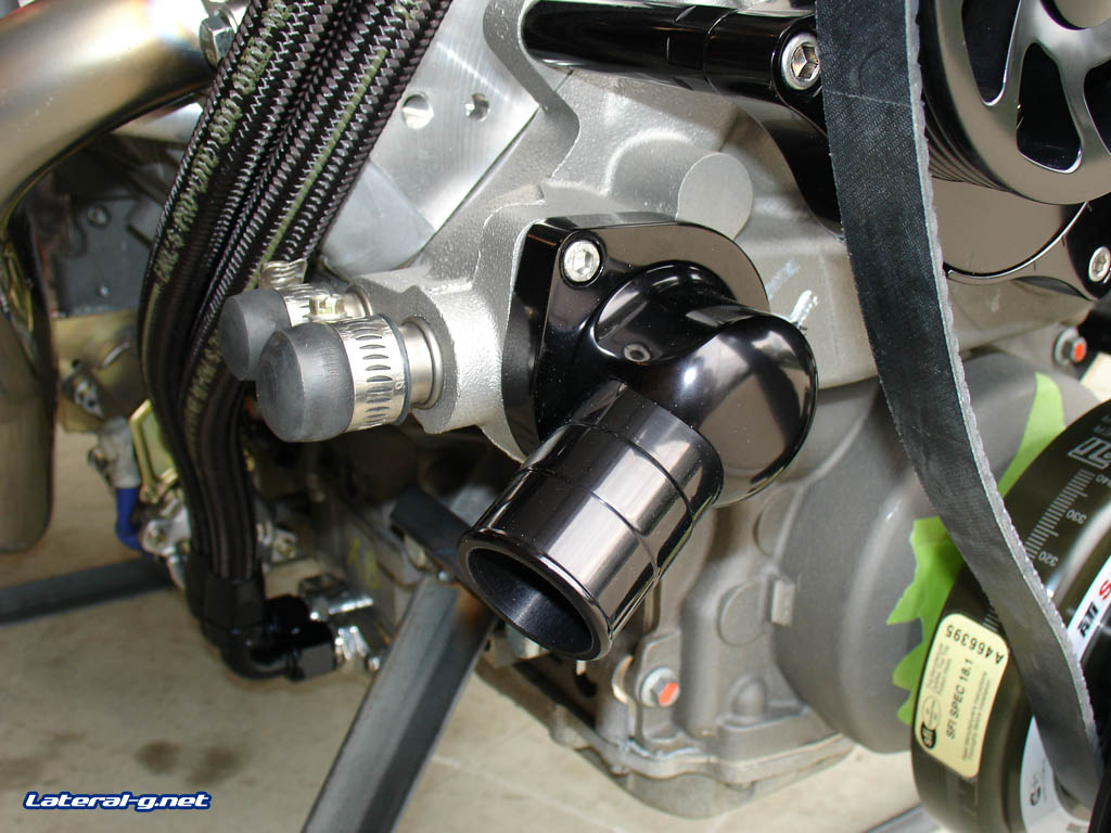

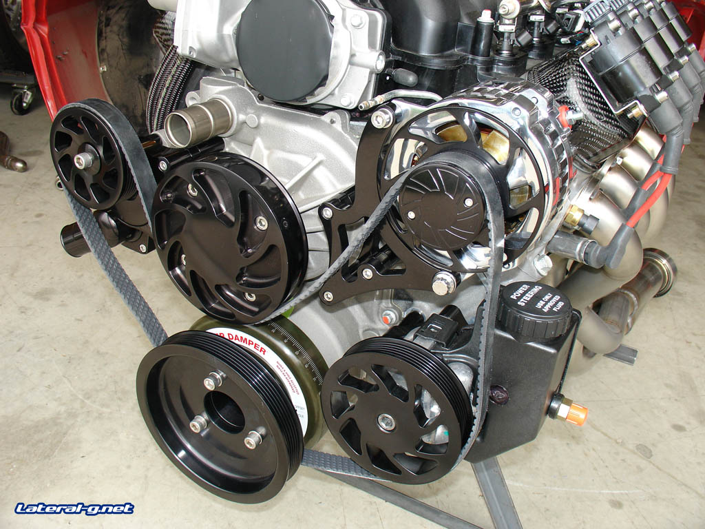

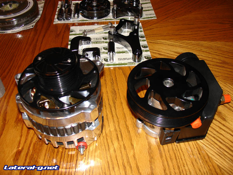

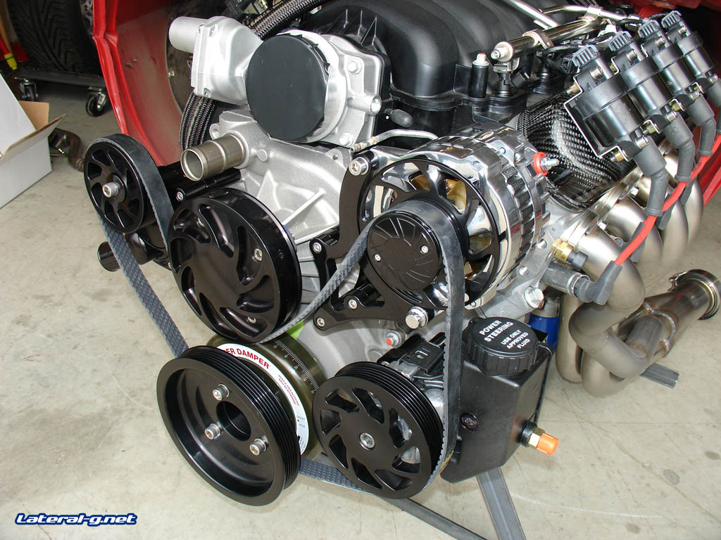

Front accessory drive from Synister Products.  All brackets and pulleys were anodized black, as well as the billet thermostat housing.  No A/C.

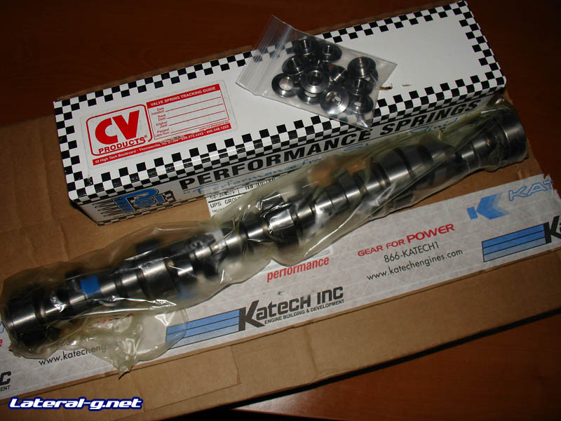

Katech cam, springs and titanium retainers, they claim it makes 600hp and 575 ft-lbs of torque.  We will be finding out when we see what kind of mph it runs in the quarter.

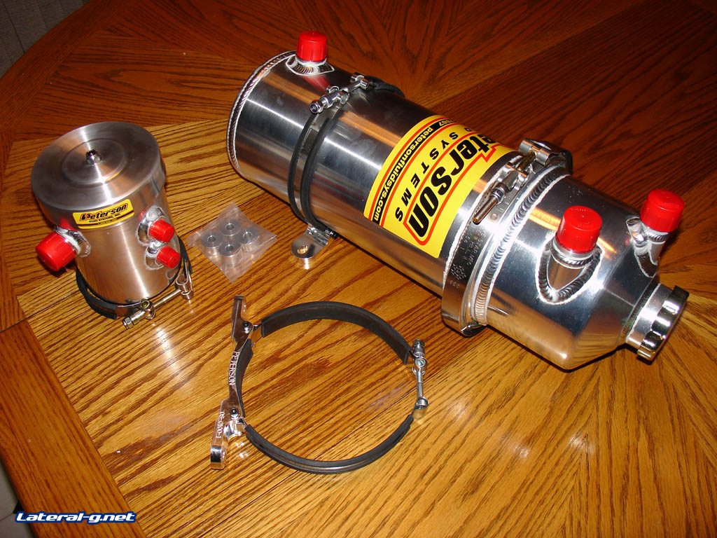

Dry sump tank and breather

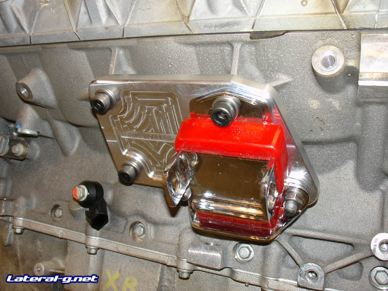

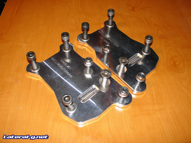

LSx motor mount adapter plates from Autokraft Race Cars and Restorations.

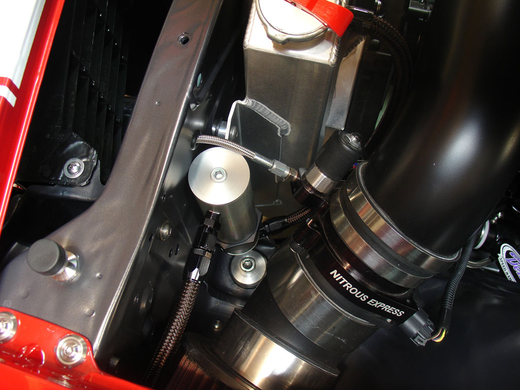

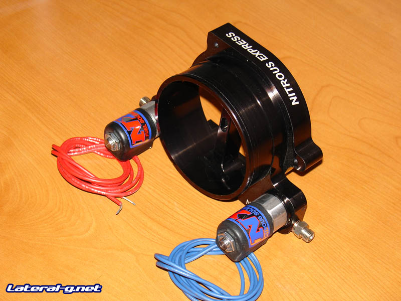

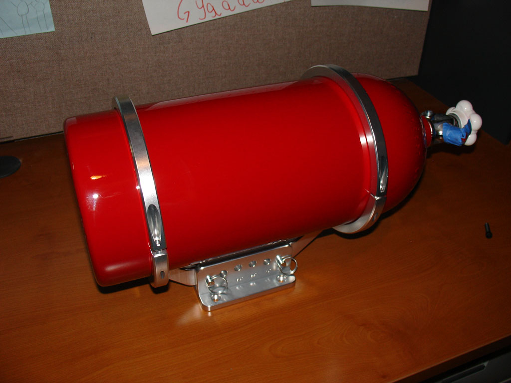

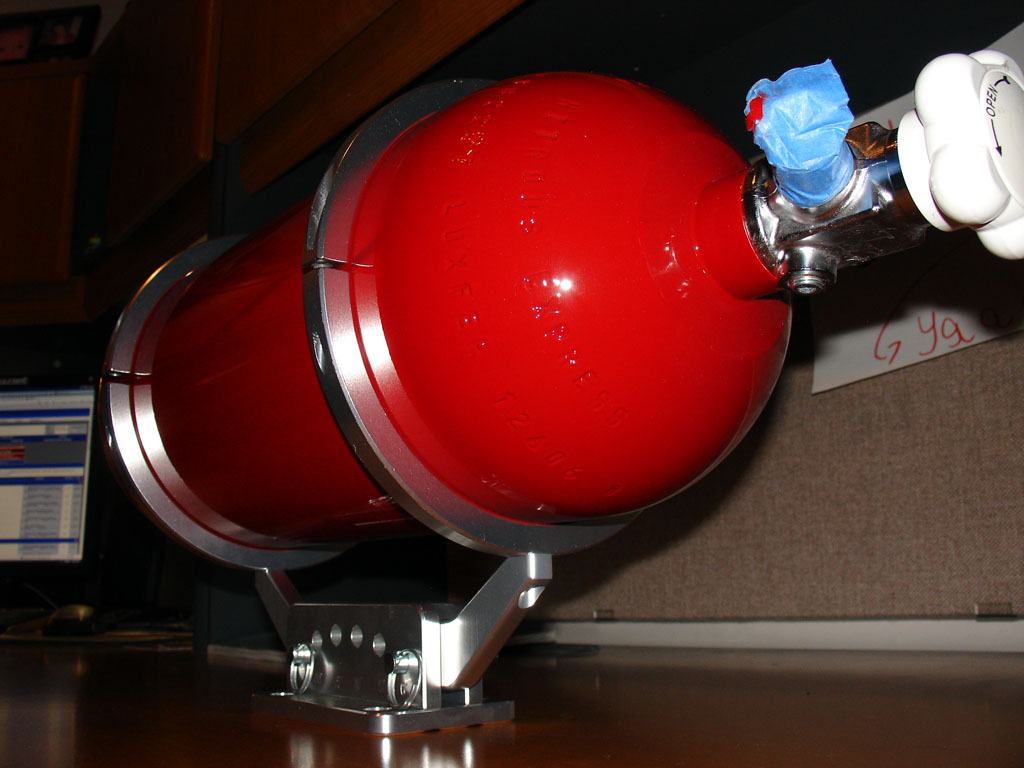

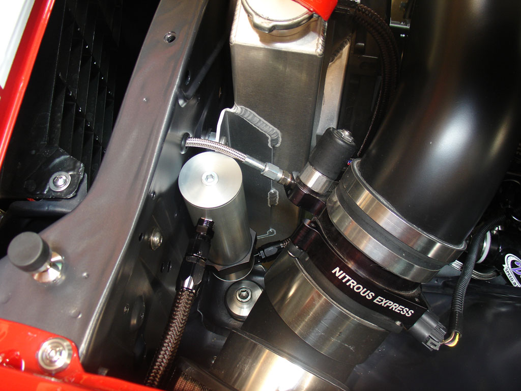

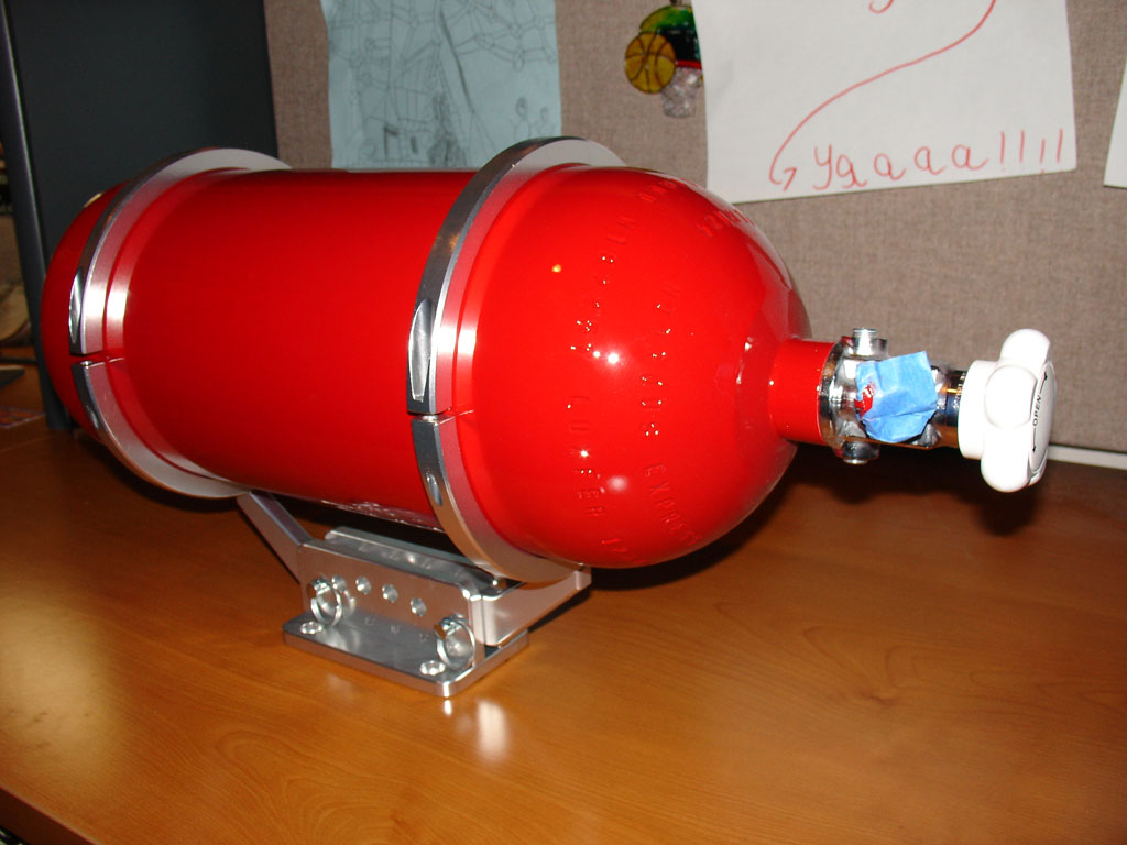

I'm installing a compete Nitrous Express system for the throttle by wire.  Here's a picture of the trick MAF housing with integrated solenoids as well as the bottle painted body color and billet bottle bracket.

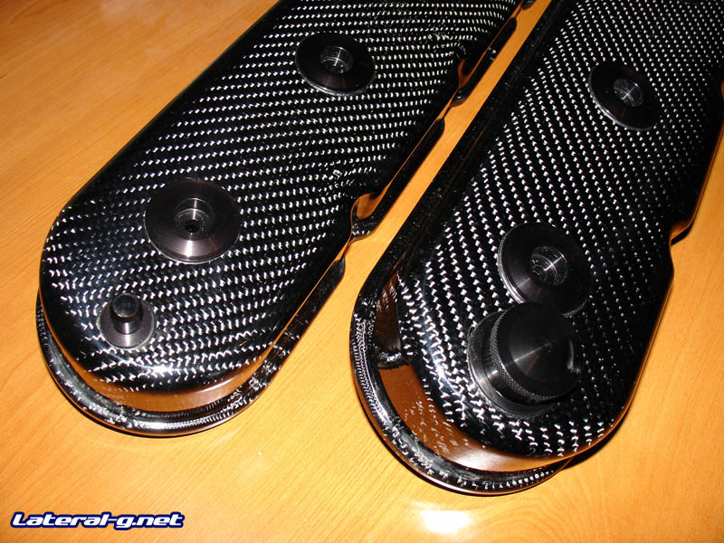

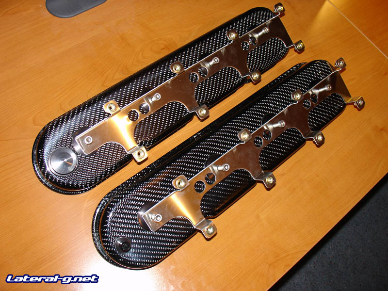

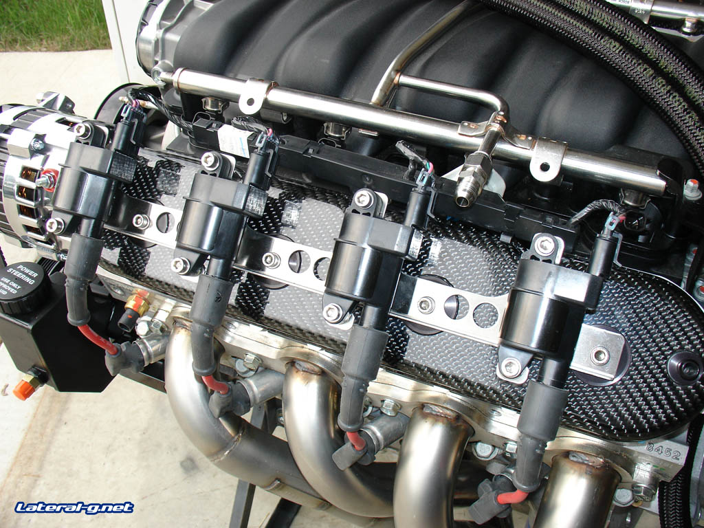

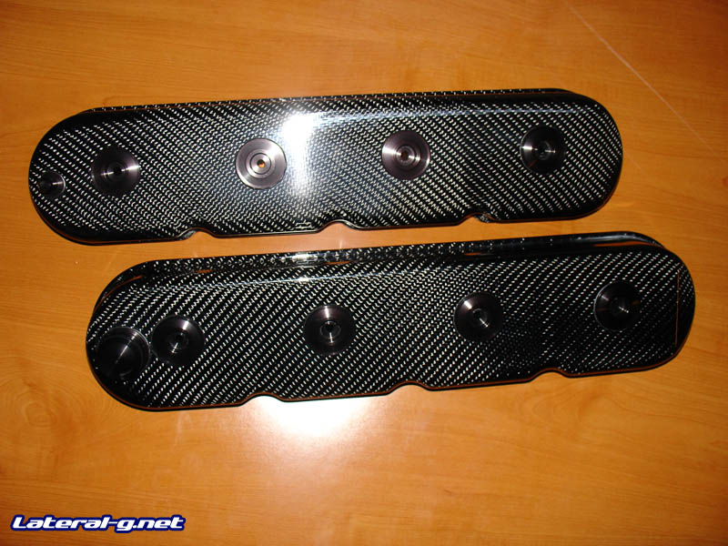

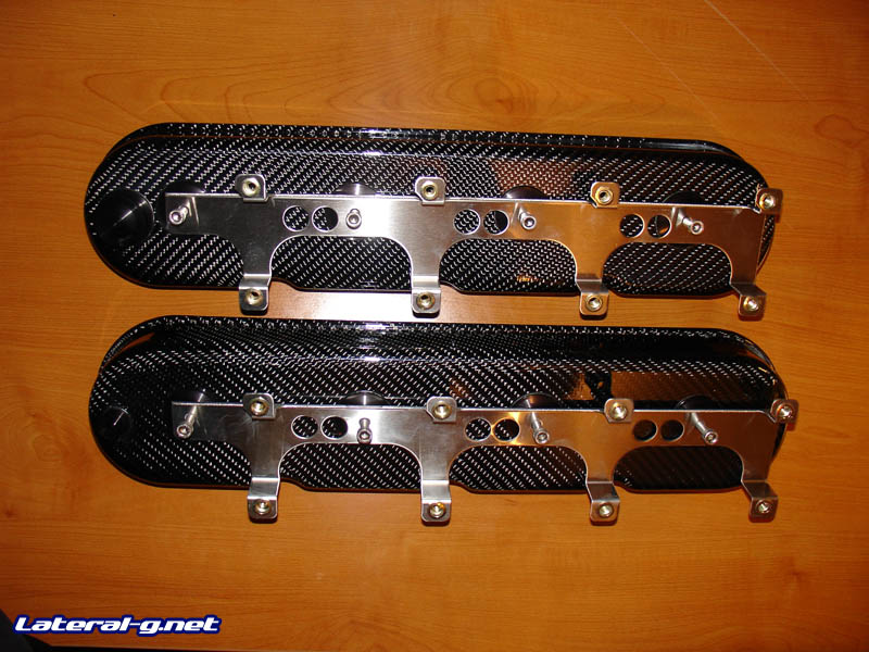

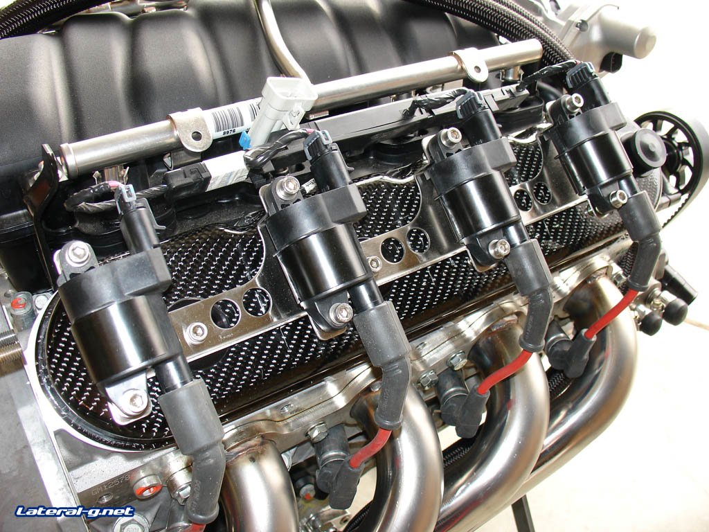

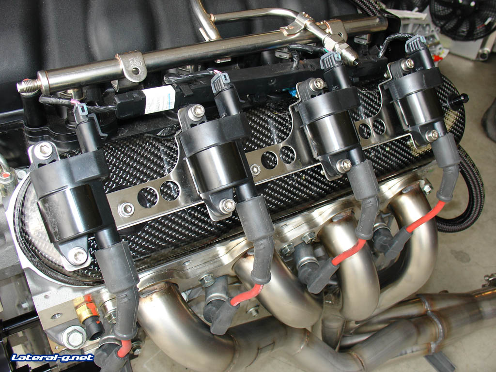

Here are a few pictures of my new set of valve covers and stainless steel coil racks from CarbonFiberValveCovers.com   They are simply amazing.  Pictures don't do these justisce.  The quality and craftsmanship is fantastic.
