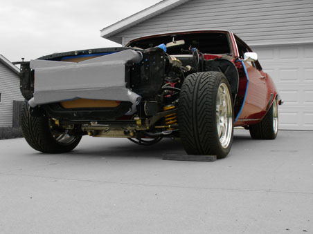

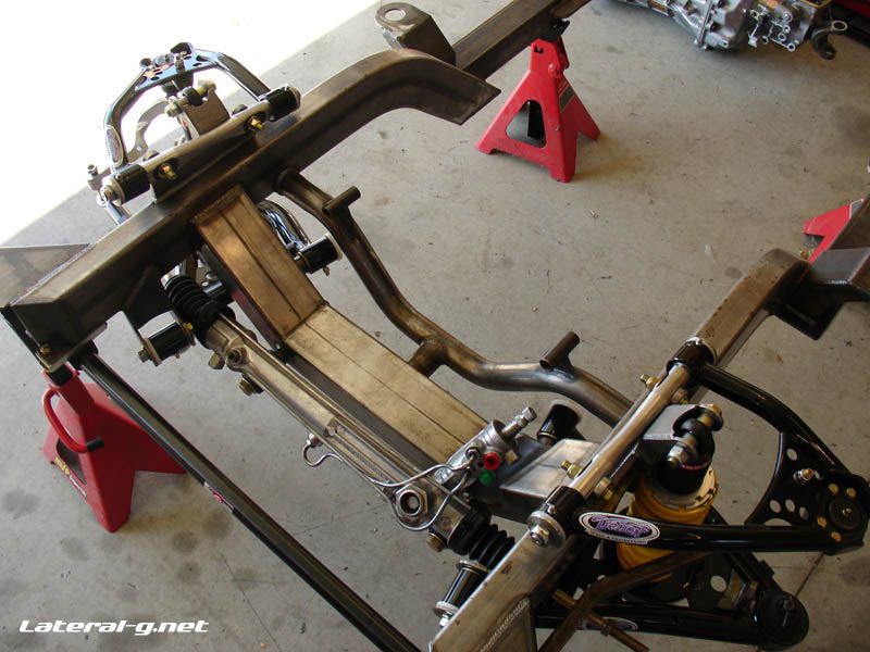

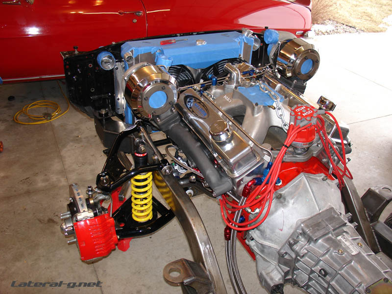

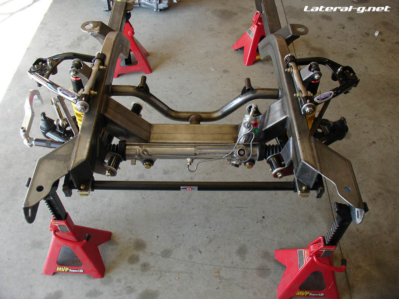

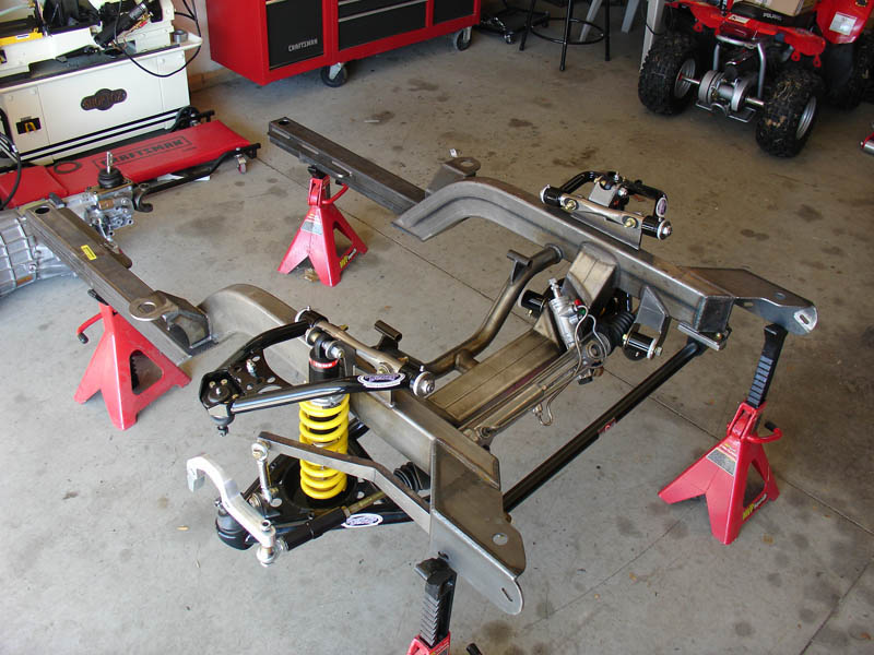

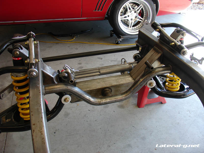

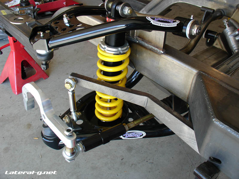

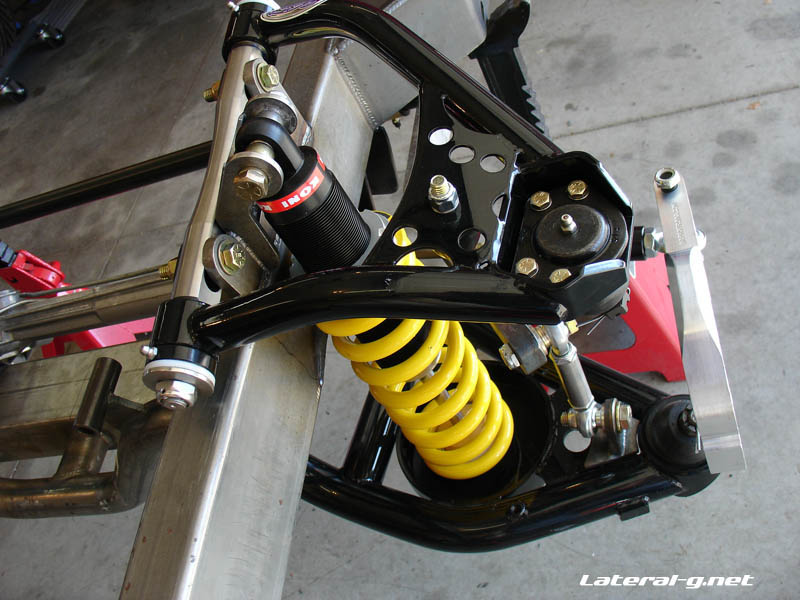

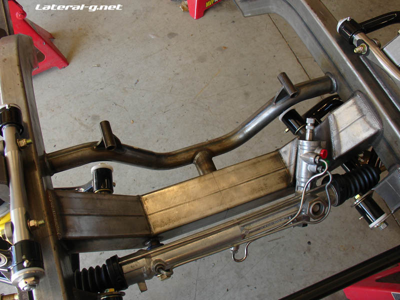

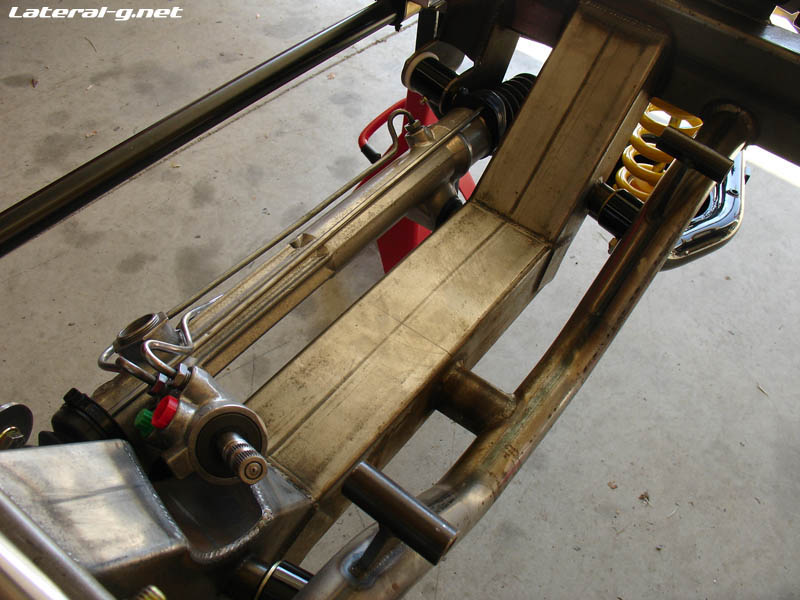

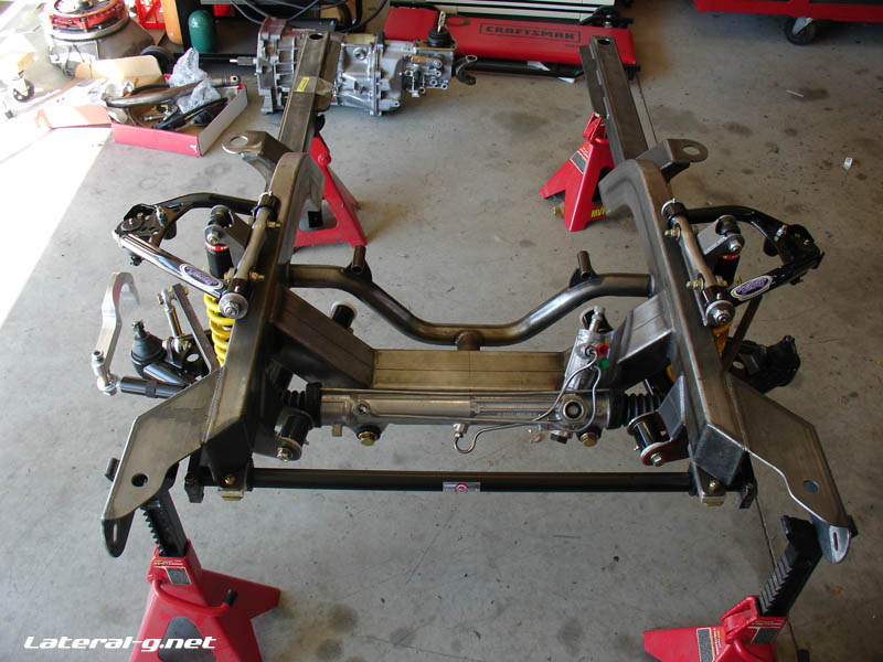

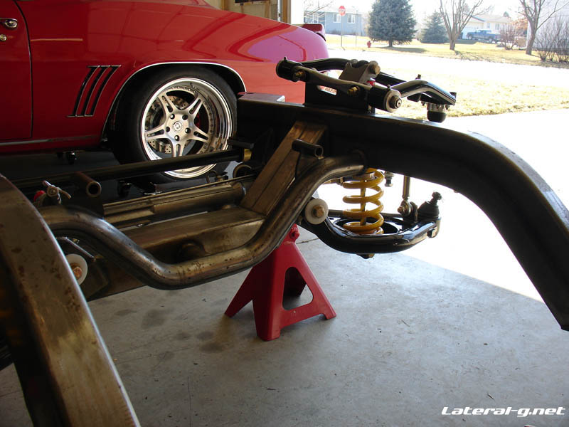

                                     The front suspension is setup on a Wayne
                                    Due subframe.  It uses Detroit Speed

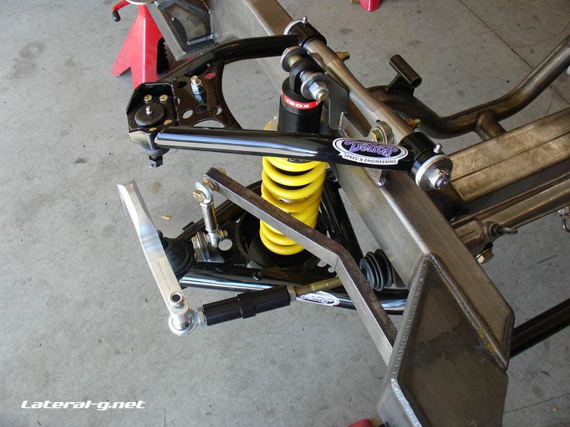

                                    Upper and Lower control arms, Detroit Speed

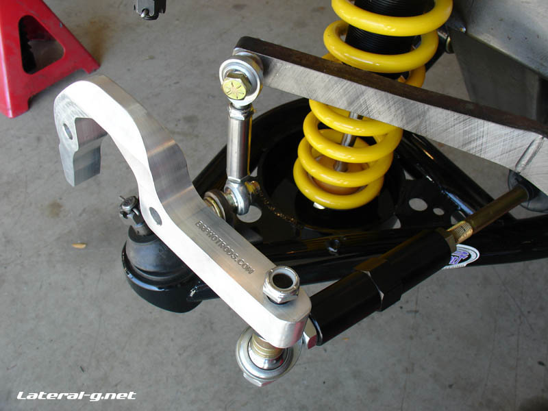

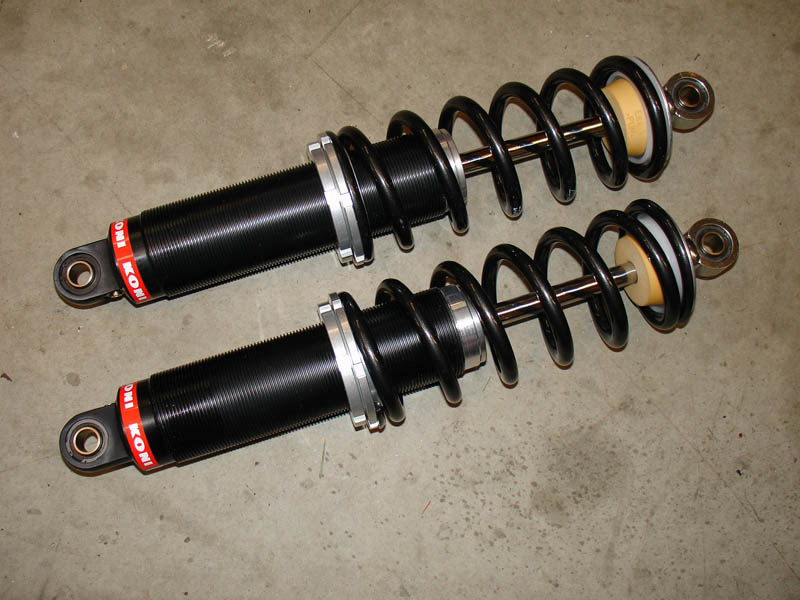

                                    adjustable Koni coilovers, Phil Brewer
                                    billet steering arms, Baer Trackers, AGR

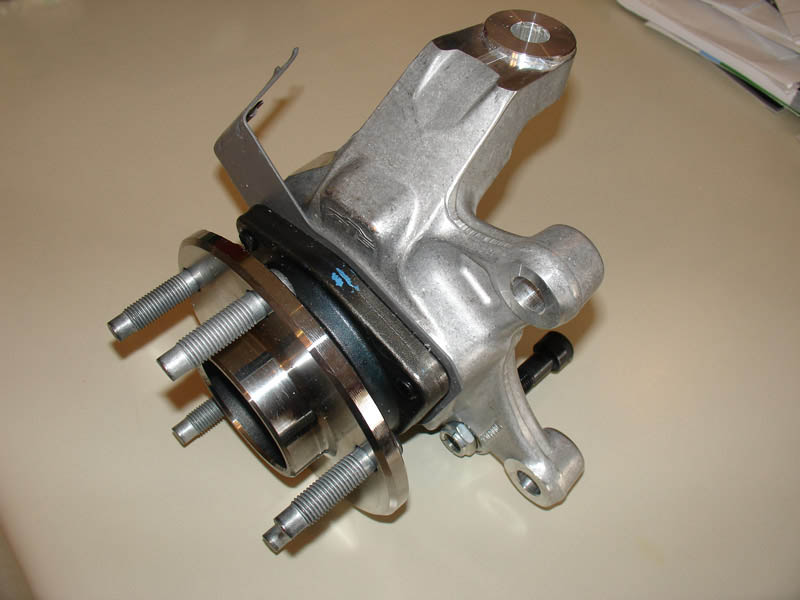

                                    power rack, Speedway sway bar, and American
                                    Touring Specialties forged spindles that use

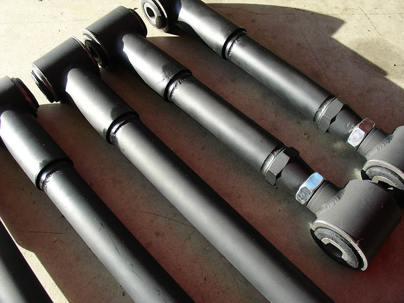

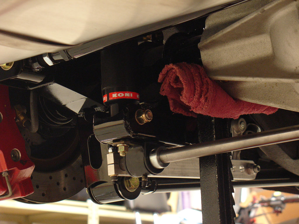

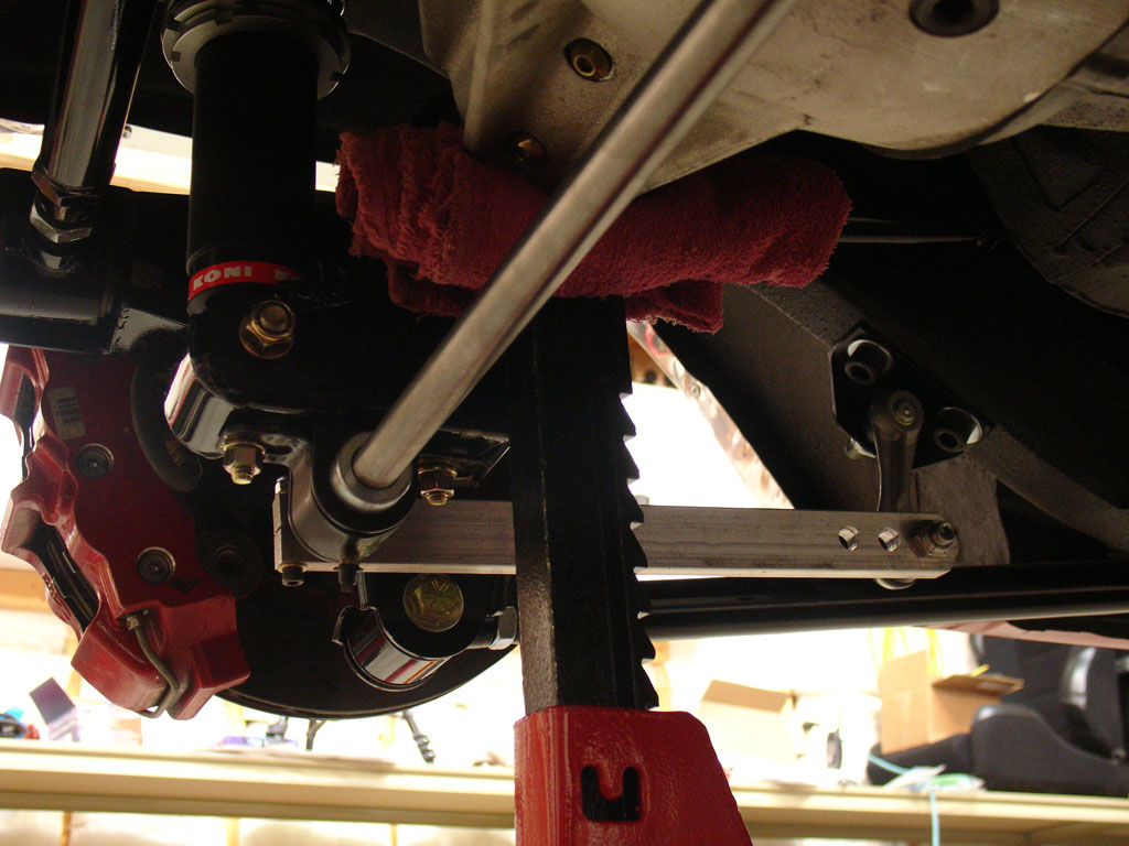

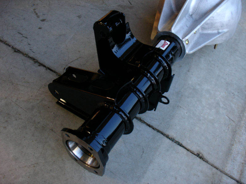

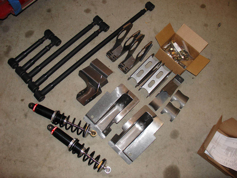

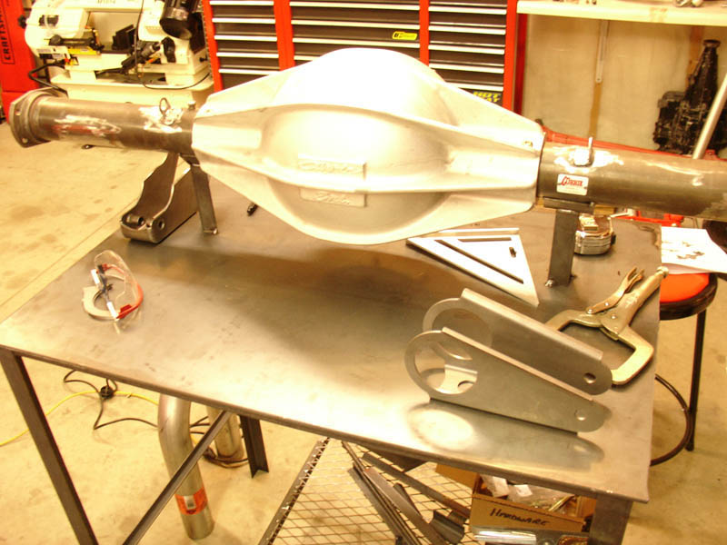

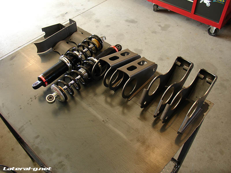

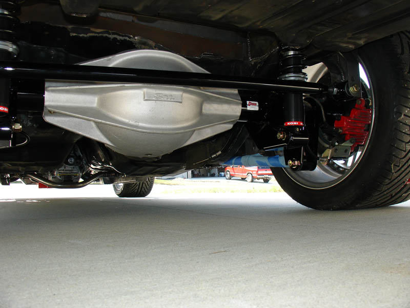

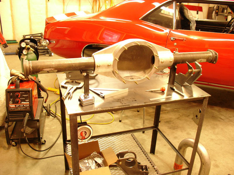

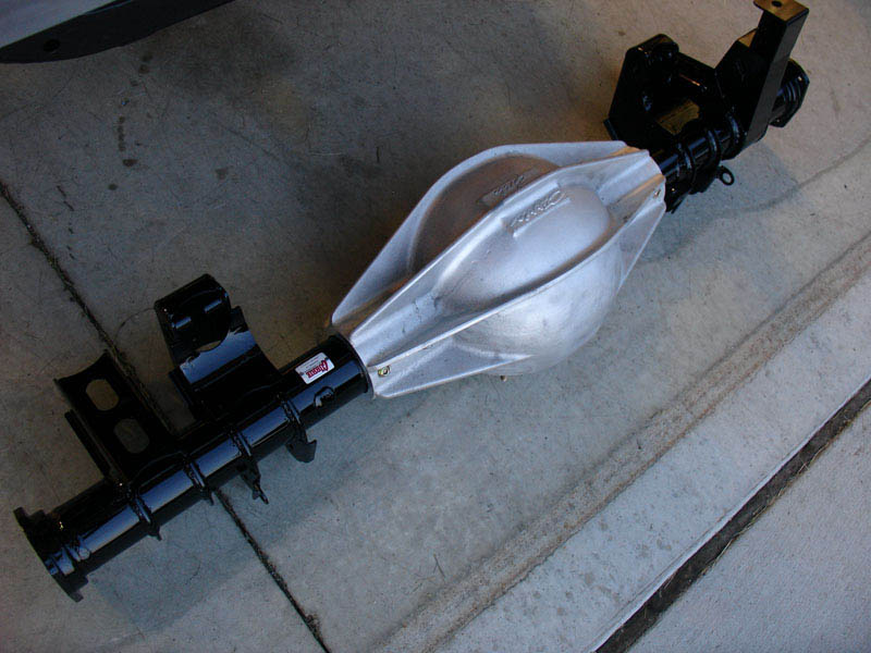

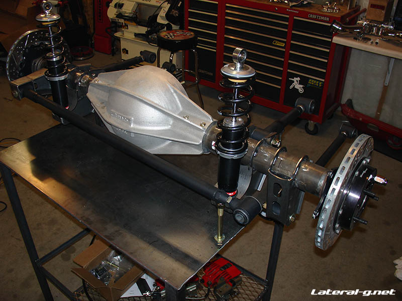

                                    C5 bearings. The rear suspension is the Quadralink

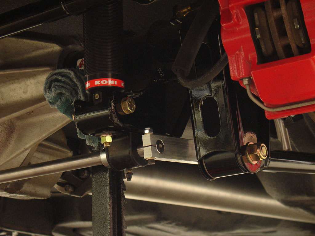

                                    from Detroit Speed.  Is has an
                                    adjustable panhard bar and adjustable Koni

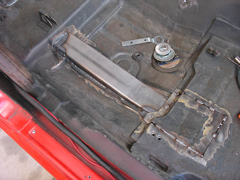

                                    coilovers. The subframe connectors are Detroit
                                    Speed.

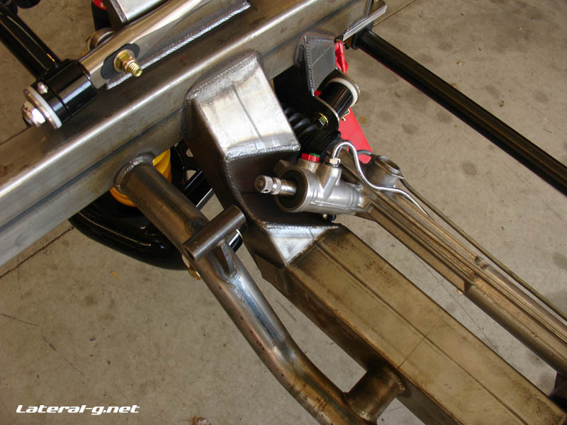

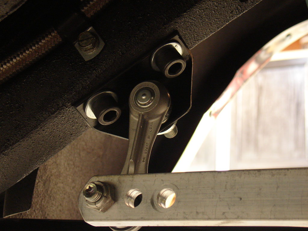

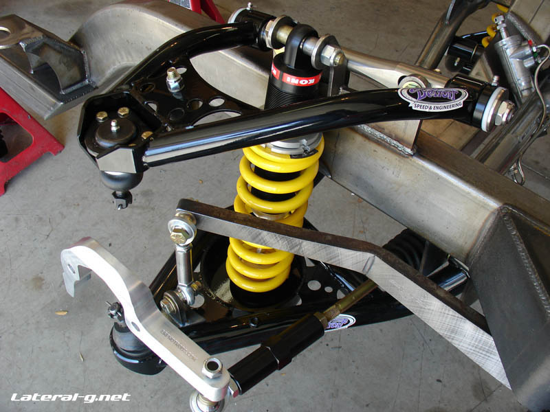

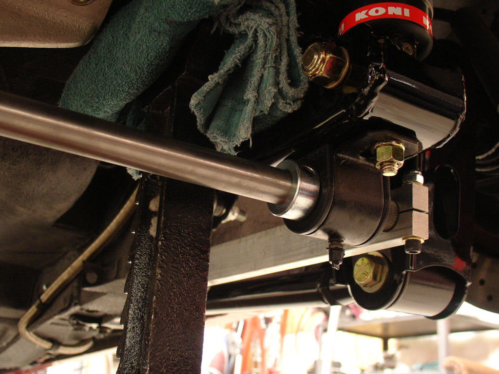

		                            Dialing out bump steer.

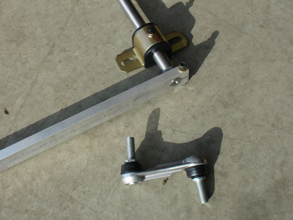

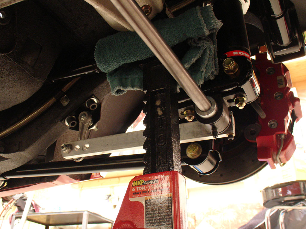

		                            ATS splined sway bar.  I made brackets
                                    that mount to the frame rails and drilled
                                    multiple holes in the sway bar arms for
                                    adjustability.
