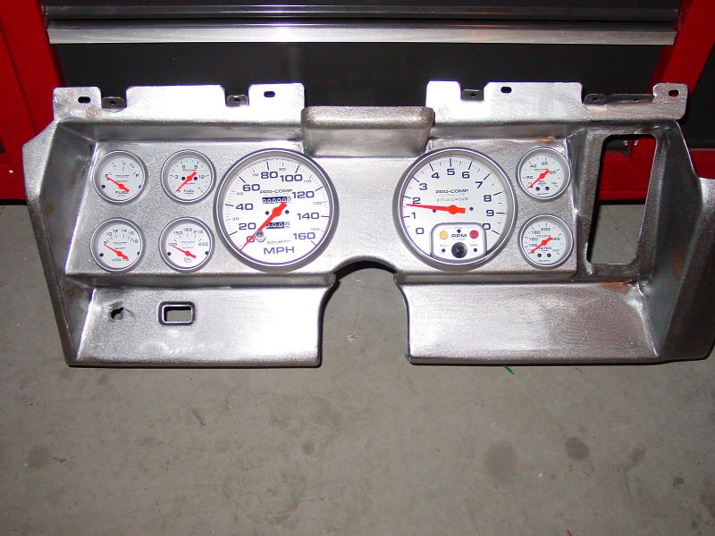

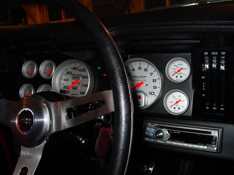

This is my
Detroit Speed and
Engineering dash insert. I
got it without any holes for the gauges or
radio pre-cut. I knew that I wanted to use
5" speedo and tach, as well as six 2 1/16"
gauges. To do the initial layout to see how
everything worked together and the spacing
that I would need, I created my own actual
size paper gauge templates with a photo
editor. I printed them then cut them out.
You can see how it was going to come
together in the picture below. Once I was
confident that's how it should look, I used
digital calipers and a compass to locate the
centers for the holes, horizontal and
vertical alignment, as well as consistent
spacing between all gauges. I knew it had
to be perfect, as any little imperfection
would be staring me in the face every time I
would be behind the wheel. |

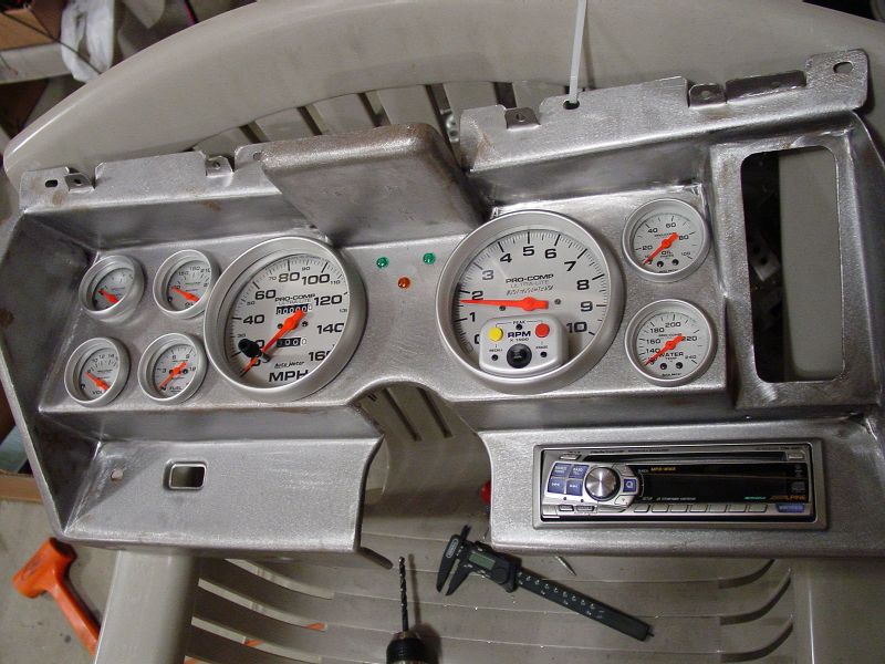

I
kept the stock heater, headlight and wiper
controls. For turn signal indicators, high
beam and parking brake warning lights, I
used panel mount 12V LEDs. The only issue I
had is that in the size and style I wanted,
blue is not available. I had to settle for
orange. Mounted in the horizontal area,
above the headlight switch, are two barely
visible flush mount rocker switches. One is
for the Spal fan manual override, and the
other toggles a 12V relay for the Mallory
Comp 250 fuel pump. |

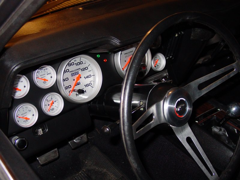

The dash came in bare metal with
some deep scratches from the prep at DS&E. I used a tiny amount of filler
to clean them up. After hand sanding the entire assembly, I shot it with
a self-etching primer. I then took it to a friend that shot it in a
booth, having him match it to the satin finish of the rest of the dash. |

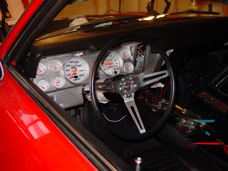

The radio is a Alpine CD/mp3
player. I chose it largely due to the fact that it has a silver bezel and
silver face to match the AutoMeter Pro Comp Ultra-Lite gauges. The fact
that it's an Alpine doesn't hurt either. I fabricated the the harness for
the eight gauges, four indicator lights, and radio using Molex connecters,
soldering every connection. |

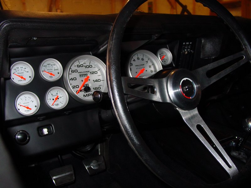

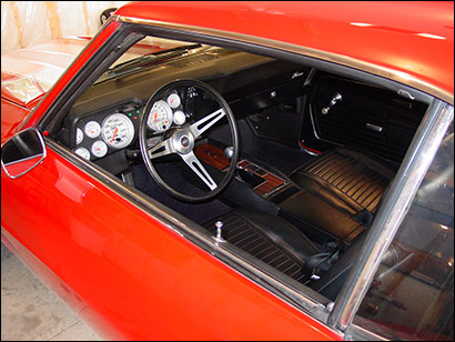

Overall, I couldn't be happier
with the results. If I had to guess, I'd say I have well
over 20 hours in it from layout, executing, prepping, painting, and
wiring. |
