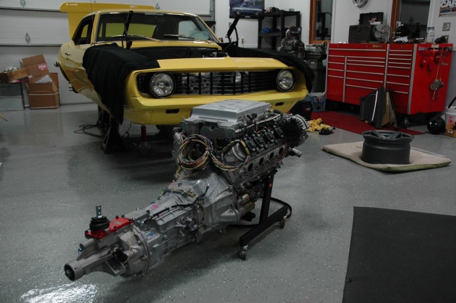

Some updates: As part of the rebuild, JA is getting all new wiring. Ryan started making the new engine/trans harness.

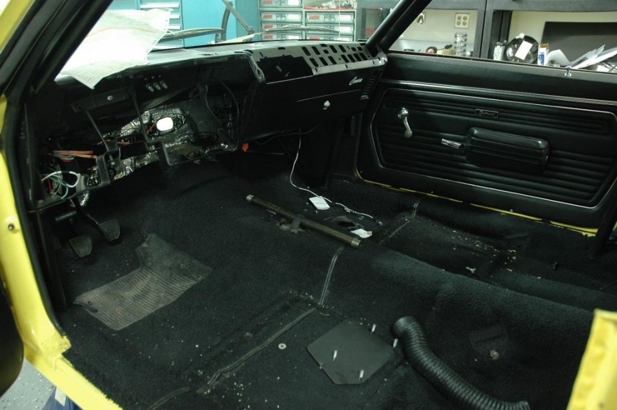

The interior will also be refurbished. The steel pipe on top of the trans tunnel is holding up the trans through the shifter opening using a nylon ratchet strap. The original trans crossmember was removed with the old subframe. A new crossmember (built into the floor) will be fabricated like was used on Hellfire.

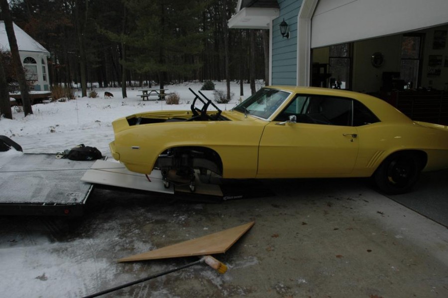

I think I saw this trailer loading method before on History Channel Egyptian pyramid building episode.

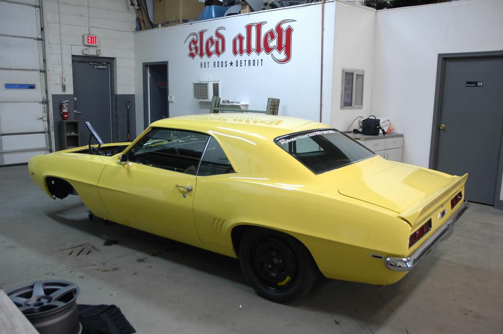

Sled Alley will be fabricating the new trans crossmember, new radiator and intercooler and ECM mounts as well as relocating the drysump tank.
DSC_3241

Thomson finished the short block so we will swap of the top end and the engine will be ready. Bran has the same engine in his Vette and on E-85 it cleared over 1000 HP.
