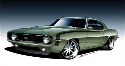

Orion, Jon LaRue's Twin Turbo 69 Camaro                      Built by Marquez Design & Fabrication
Complete Specs
