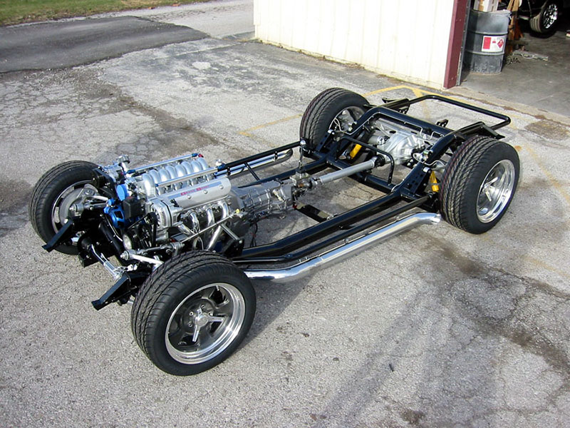

'96 Corvette front and rear suspension.
Aldan coil-over front shocks, ZR-1 rear shocks.
Dana 44 w/3.45:1 gear.
13" front and 12" rear '96 corvette brakes w/Powerslot rotors and
carbon-ceramic pads.

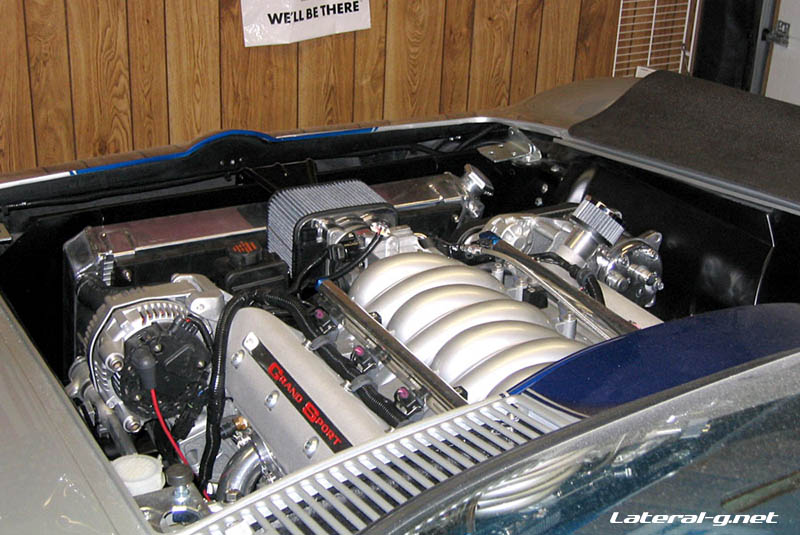

2002 LS1 modified with Stage 2 Patriot LS6 heads w/dual springs, custom ground Comp cam, hardened pushrods, ported oil pump, LS6 intake, billet fuel rails, MTI billet throttle body, LS2 coils, Meziere electric water pump, Katech valve covers & tensioner, underdrive pulley...
6-speed manual transmission.
Speartech modified wiring harness.
Custom radiator by Alumrad.
Halibrand Wheels w/Goodyear Eagle F1, fronts are 17x8 245/45-17, rears are 18x10.5 295/45-18.
