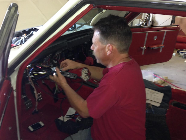

This week my buddy Jeff Allison is on the show to talk about how he diagnosed the problems, what the big worries were, and (in the end) how simple the fix was.It turns out that the coils on the right side cylinder bank were reversed (so Coil #was trying to fire cylinder #2, Coil #6 was trying to fire cylinder #4, etc.) and that the three wires to the camshaft sensor were criss-crossed in the engine harness. Once those two problems were corrected, she fired up on the first try!
