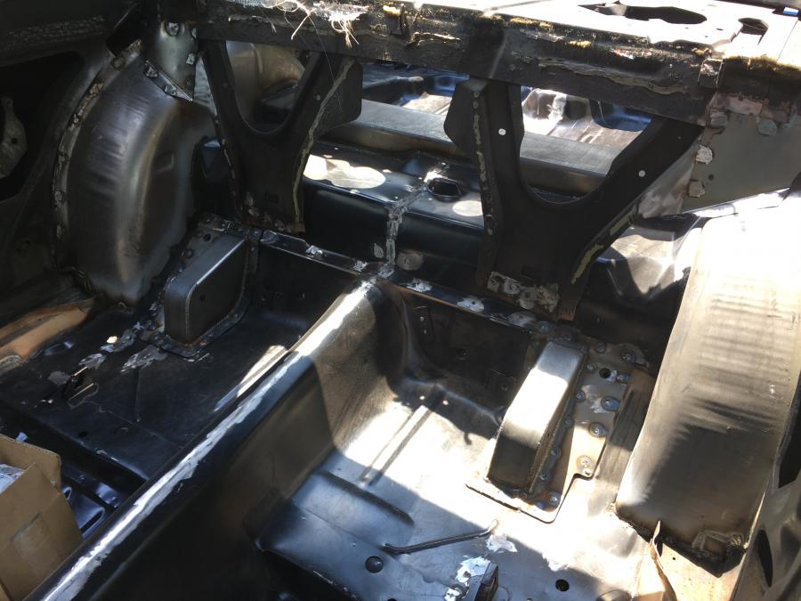

Trunk area complete...ready to install the DSE Quadralink parts...will have to have the rear tail panel murdered out to cover up where the paint lifted from welding the trunk pan to the rear tail panel. Always liked that look anyway but had to bring the paint line down lower than what it would've been from the factory...at least it's still hidden by the bumper.

Quadralink pockets and rear coil-over crossmember installed...

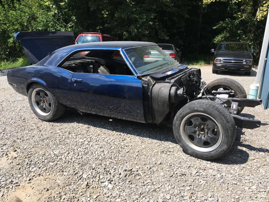

Got it home, jacked up and began stripping all the stuff off that I wouldn't be using again....which was basically everything!

Love this pic for some reason! This is the same place/position this thing would stay in for the next 6 months...to this very day, actually, although not for much longer but I'll get to that part later.
