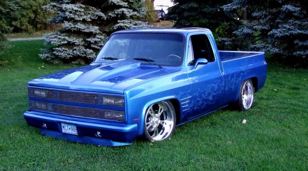

here are a couple shots of blue steel that I built years ago sold it at barret jackson 2007.

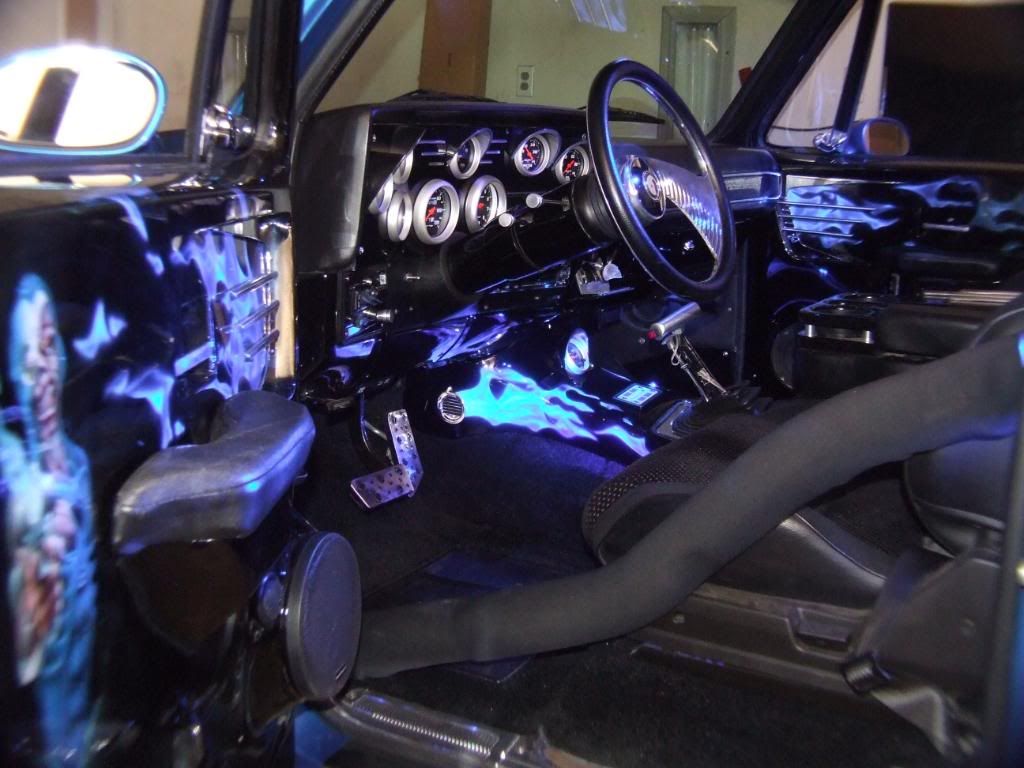

interior shot with led. lights
finished and used as my daily driver

Awesome build Eric. I looked at your site and could not find the specs on the tires/wheels. What are the sizes and back space?

the fronts were 20x8 245/45/20 with 4"back spacing the rears I used a ford 9" out of a granada it was like 5"narrower than stock. I welded two sets of wheel houses together for a tub. the rears were 20x 12 with 315/35x20 I can't remember the back spacing.hope this helps. just loaded some build picts on photobucket if you want to see more details.

That helps a lot. I keep running in to those 315's and love the look. Not sure if I am ready to cut my bed to accommodate a set, but I do like that look.
