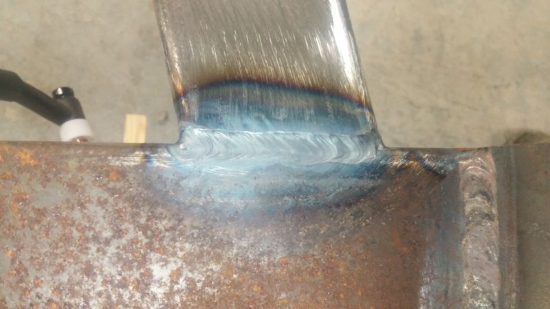

redss86 03-17-2015 09:07 AM
Made some welds on my frame last night. First time welding in about 6 months. Used 1/16 ceriated with 1/16 er70s6, 140 amps max. First to were ok, last two look good to me. Let me hear your thoughts.http://i71.photobucket.com/albums/i1...315_215607.jpg
http://i71.photobucket.com/albums/i1...315_215629.jpg
http://i71.photobucket.com/albums/i1...315_222813.jpg
http://i71.photobucket.com/albums/i1...315_222823.jpg
Here is what I am welding in (the short brace in front of the xmember).
http://i71.photobucket.com/albums/i1...315_222846.jpg
http://i71.photobucket.com/albums/i1...601_134414.jpg
GregWeld 03-17-2015 10:20 AM
Last two look very good - keep going!

GregWeld 03-17-2015 10:32 AM

redss86 03-17-2015 12:56 PM
Originally Posted by GregWeld (Post 598957)
Personally I think your choice of 1/16th tungsten is too small for the job you're working on - I'd be using 3/32nd... with the same size filler material. Your HAZ (heat affected zone) is pretty wide - and that's due to slow travel speeds (typical of "newbs"). That's not a disrespectful name btw.
I thought the same thing, but decided to give it a try. That was going off the Miller welding app suggested sizes and settings. I do think I will switch back to 3/32 electrode on the remaining sides. Still gotta figure out how to get into the tight angle to weld it. Any suggestions?
I have been tig welding off and on for about 12 yrs now, but only do it at home on my own stuff and some side odd and ends.

9. I repeat myself..,
PREP is everything.., Keep it CLEAN.
10. Please reply.., I want to help..,
572Camaro 07-18-2018 02:34 PM
OOPS..,
Please use 3/32" tungsten 2% thoriated.
rixtrix1 07-18-2018 05:21 PM
Originally Posted by 572Camaro (Post 680420)
OOPS..,
I only have 2% lanthenated right now, but I work next door to a welding supply shop and get a discount through work. Furick gas lense and clear cup works fantastic.
Space cadet on the tensile strength vs alloy numbers. I do have some lower strength I've used on body work as it's easier to hammerweld or grind. Perhaps the lower alloy creates a better bridge between the other steels.
jarhead 02-11-2019 02:08 PM
I decided I needed to come back and read this, and watch some videos.
Will be practicing on 18-20 gauge sheet metal scraps. I want to work on my Torino cowl after I learn from my mistakes, it won't be seen but I want to do a good job. I've already repaired some of it with MIG.
I was just at the local welding supply to get argon (92CF). He reccomended, and I bought.
*70S-6 filler 1/16X36 here pounds.
* 2% cerriated tungsten in 1/16 and 3/32, I bought one of each.
My family gave me the HTP-221 for Christmas, and it has an assortment of gas lenses, none of which are clear. It has a 17 torch and the standard lenses, etc.
The question is did I buy the correct supplies to get started burning coupons?
Thanks!
