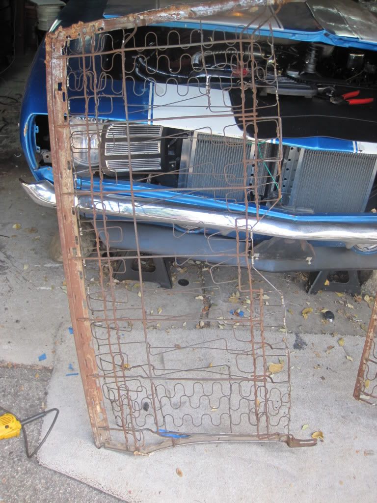

Still plunking away. Took a TIG Welding class and narrowed rear seat frames. Used the instructions found in this thread as a baseline:
https://lateral-g.net/forums/showthread.php4?t=28606
This is what I started with:
http://i328.photobucket.com/albums/l...tFrames002.jpg

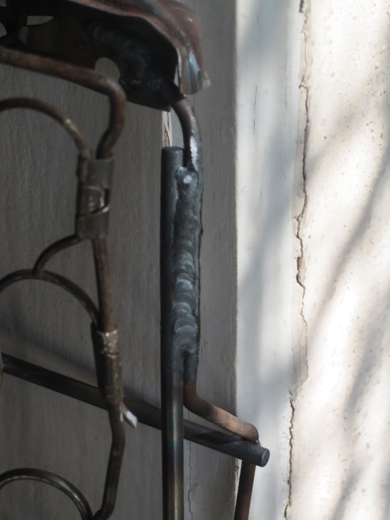

Ended up touching up all the spot welds since some of them looked pretty shakey. Also added a few extra bars for reinforcement as well. Now the frame is nice and solid.
One of the welds:
http://i328.photobucket.com/albums/l...tFrames003.jpg

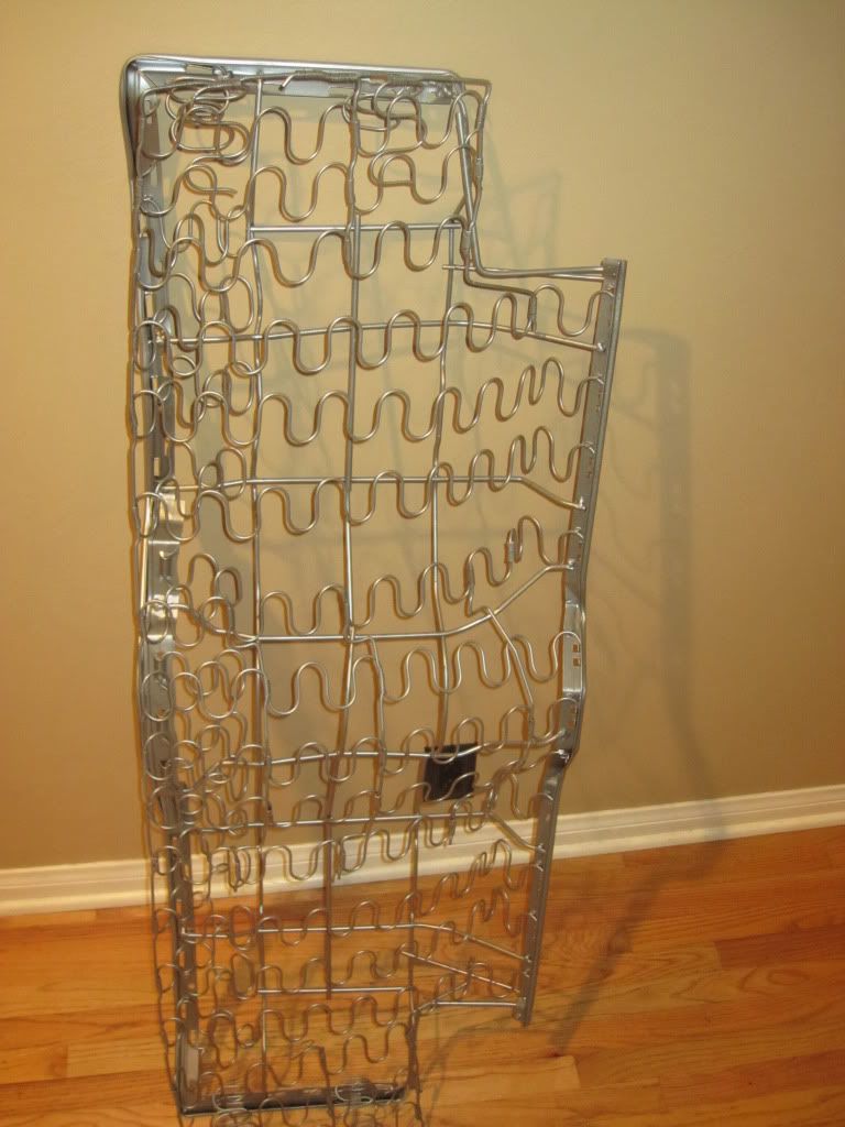

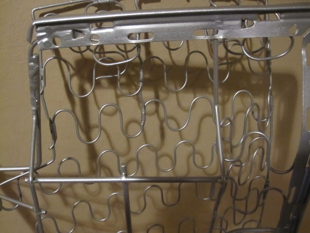

Powder Coated:
http://i328.photobucket.com/albums/l...tFrames005.jpg
http://i328.photobucket.com/albums/l...tFrames006.jpg

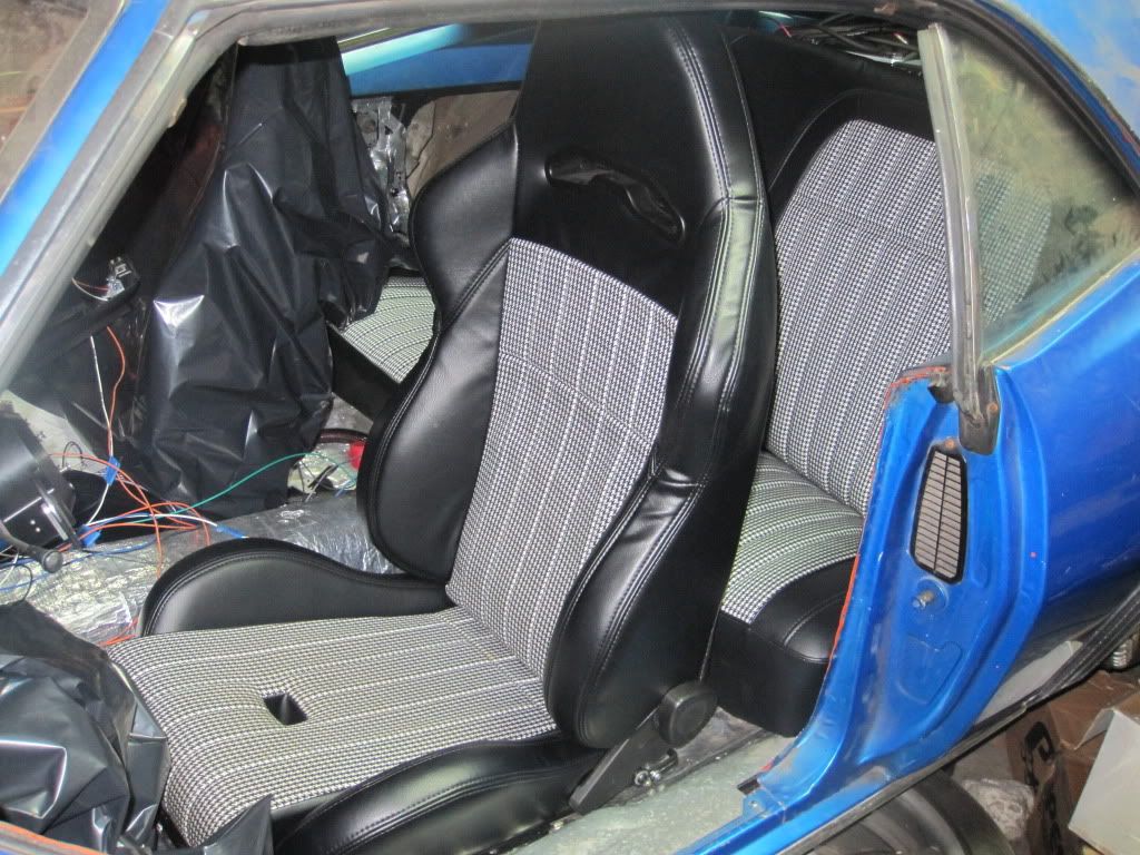

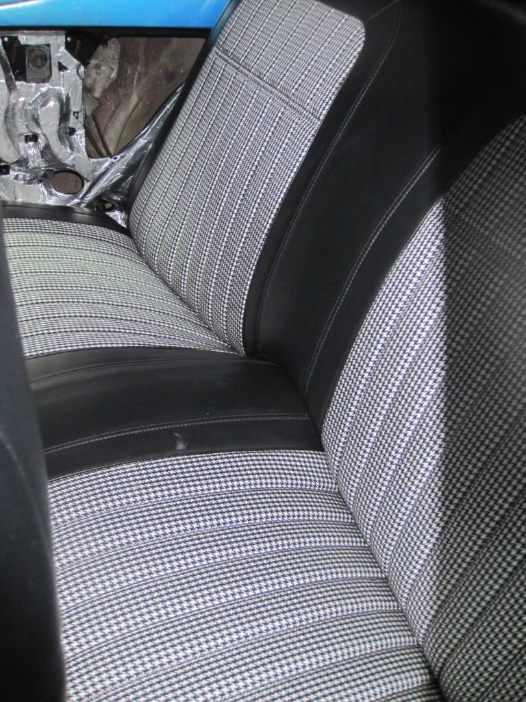

In the car with Arizen Racing seats (front) and matching rear cover:
http://i328.photobucket.com/albums/l...arseats003.jpg
http://i328.photobucket.com/albums/l...arseats002.jpg

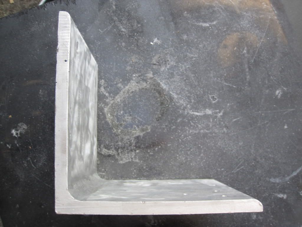

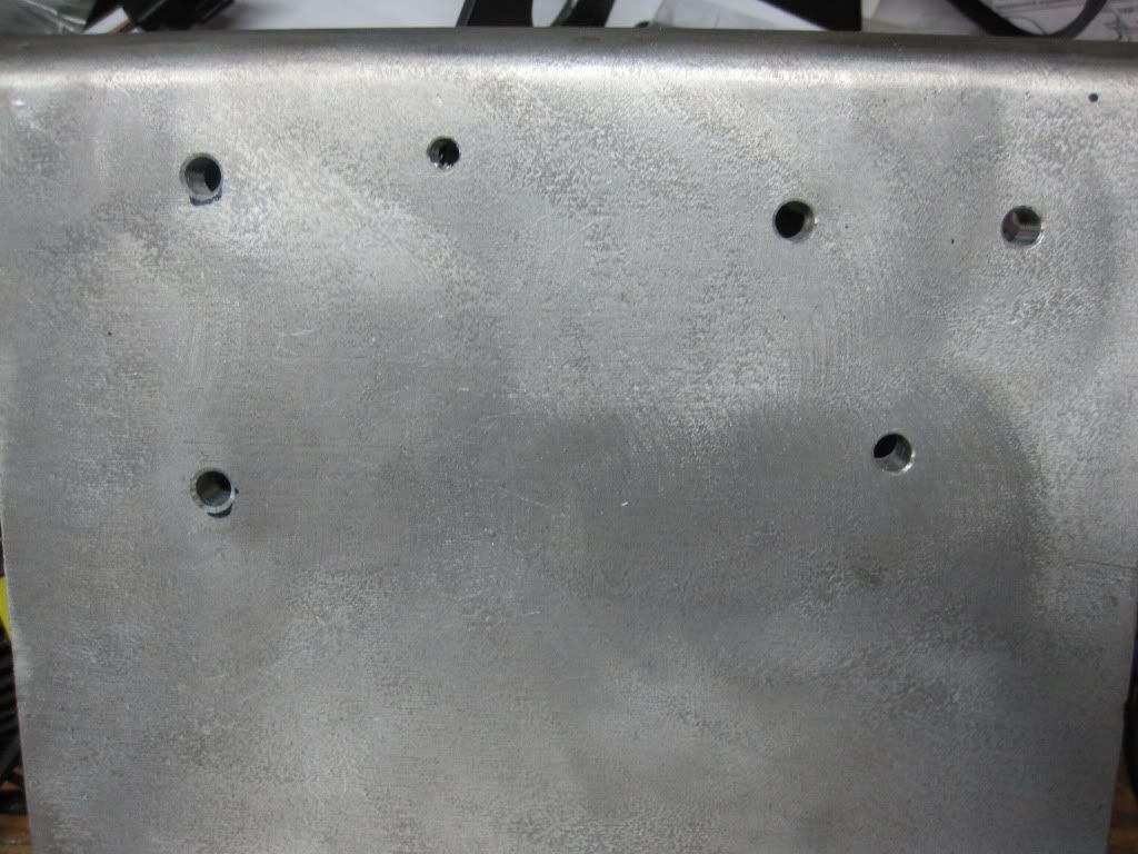

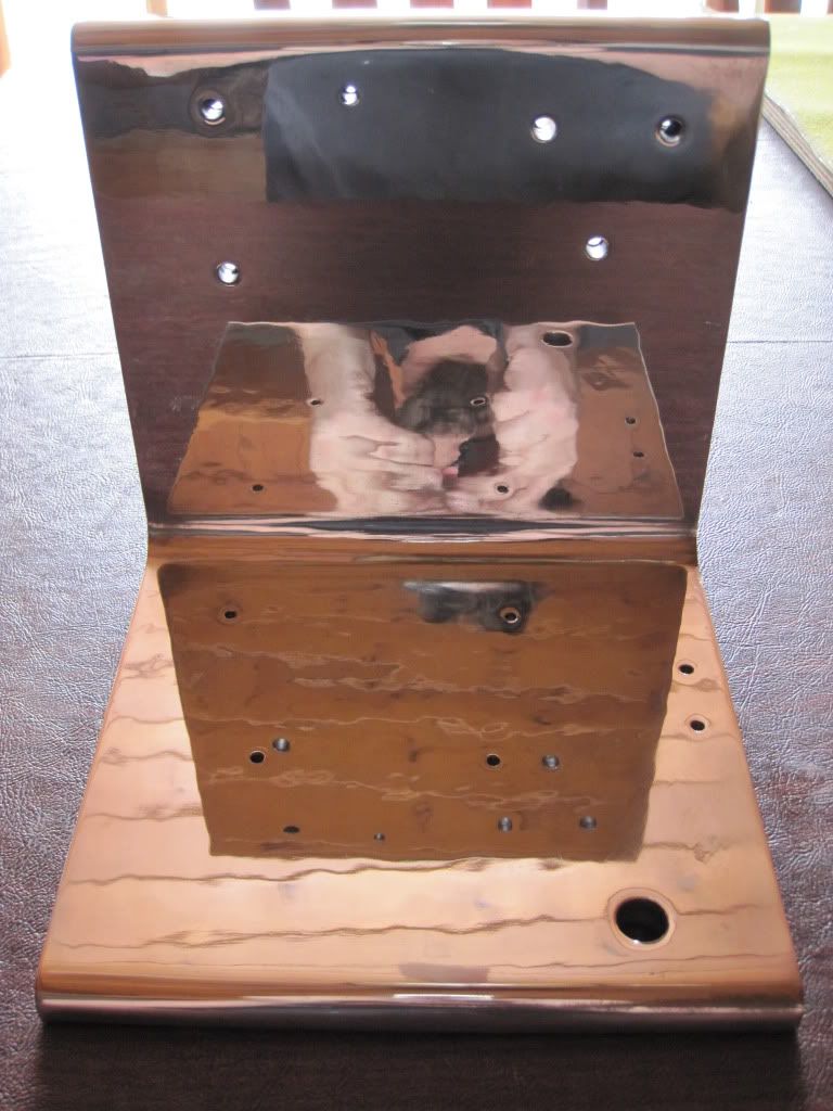

Decided with all this time to polish this 4" aluminum "L" bracket that I am using to mount fuses, cut off switch etc to in the trunk. This is what I started with:
http://i328.photobucket.com/albums/l...Bracket003.jpg
http://i328.photobucket.com/albums/l...Bracket001.jpg
And ended with:
http://i328.photobucket.com/albums/l...Bracket006.jpg
  1. Used a flat disc set of grinding pads in 60/80/120 on my air die grinder.
  2. 180 emery cloth down to about 600 or so.
  3. Back with 300 wet sanding down to 2000 grit.
  4. Switched to coarse rubbing compound with dual action sander with a coarse bonnet, then to medium and fine (bonnet + compound)
  5. Ended up getting the finest microfiber cloth I could find and used Mother's Billet polish by hand to put the final finish on.
Got to the point where I was putting more scratches in than I was taking off so I basically called it quits then. Spent way too much time on it but never had tried polishing aluminum like this. Ended up having it powder coated, which dulled the finish a bit but it is now pretty durable, hardly anyone but me will every see it anyways.
