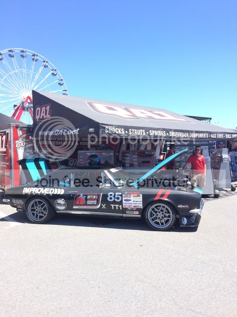

Also, on the way to NJ I was fortunate enough to have the car on display in the QA1 booth at Cruisn' Ocean City. My car rides on all QA1 suspension and it was fun talking with customers about suspensions when they came through the booth. I even met several people that recognized the car and said they have read the whole build thread! wow, that's a lot! Thanks to Eric and the QA1 team for hosting me Thursday and Friday! Look for me in the QA1 booth in the fall at LSFest!

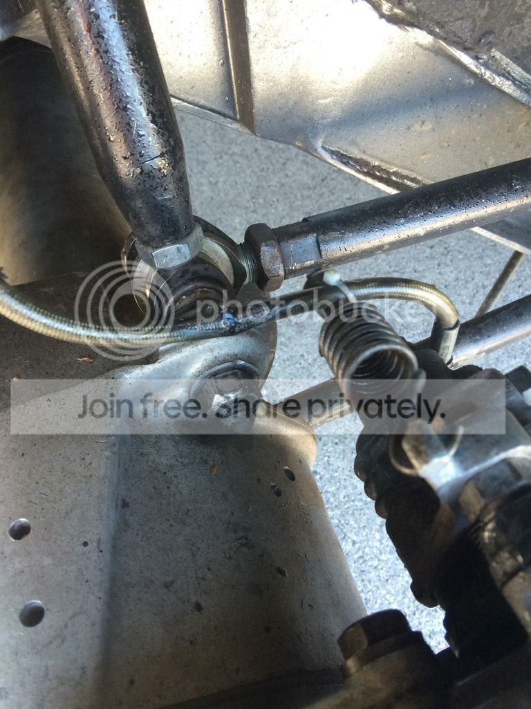

Build-It-Break-it 08-04-2016 09:25 AM
I can't imagine losing a brake line while on the course.I'm glad you and your car are safe. What caused the failure? Brand?
Ahmad
Beach Cruiser 08-04-2016 10:53 AM
It had rubbed the inside of the wheel at one point before I zip tied it back. It didn't look damaged but apparently it was. I was almost at a complete stop when it popped so no harm. I did lose the brakes at VIR one time at 120MPH! the seat is still brown!

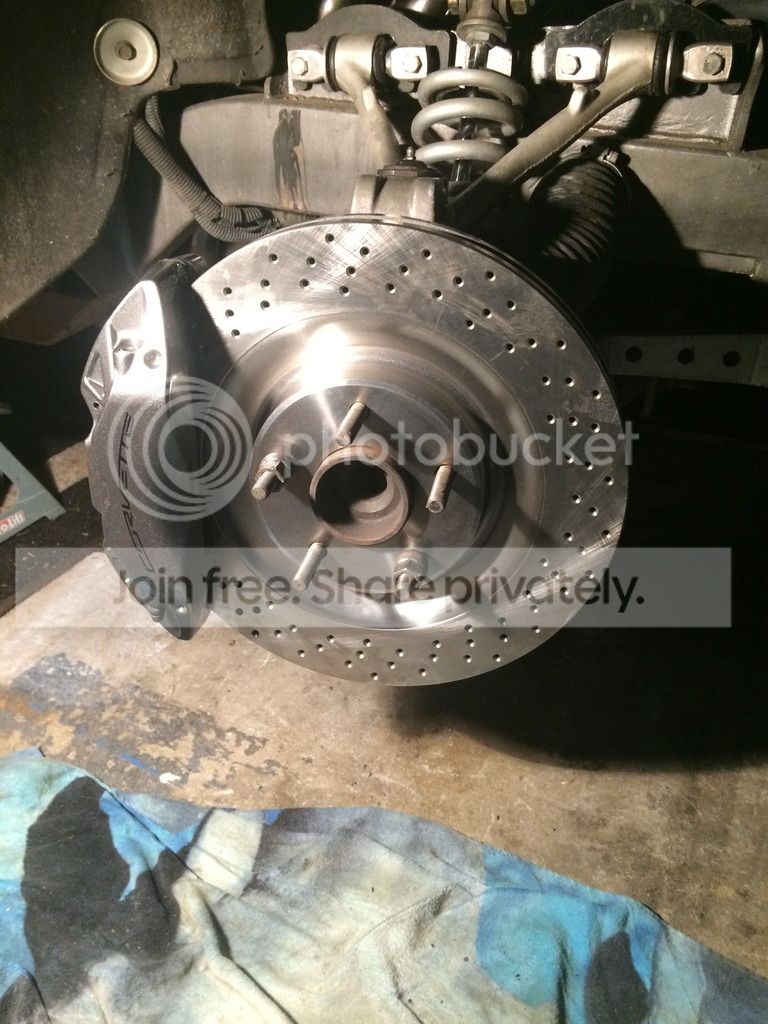

Winter Update! First off, I took most of the winter off to save money and work on other "Domestic" projects and I took a little R&R to drive down to Dayton for the Rolex 24. But now the Camaro is back in the cross hairs. I picked up the rotating assembly for the new motor today from Va Speed and was talking brakes when they said I have this brand new take off set of C7 Calipers for an insane deal! I asked could I take them back to the house to see if they bolted to my Spindle. Well yes they do! Brake upgrade on the Horizon! I also scored a Dana 44 rear end this week! wow, Karma is being good to me for a change! More to come... Stay tuned!

samckitt 02-07-2017 08:20 AM
Just an opinion, but it looks like the caliper is too far outward....?
Beach Cruiser 02-07-2017 08:51 AM
that's a c5 rotor and yes it's too small. the caliper does clear the wheel, not sure if I can make it work all the interwebs say that it's spaced out too far, still digging through all the info.
Efi69Cam 02-07-2017 05:33 PM
C6 Z51 rotors are 13.4" vs 12.8" for the C5/ base C6 if that helps.
sebtarta 02-08-2017 04:49 AM
Yup, you need the C6 Z51 rotors. I have a set brand new ACDelco if you want them. PM if interested.
Car will stop WAAAAY different with the new brakes. But pads is where it is at though.
Beach Cruiser 02-08-2017 04:55 AM
These are C7 Calipers bolted on to a C5 spindle, have you actually done the swap?
sebtarta 02-08-2017 05:05 AM
So sorry, not enough coffee in the system yet. For some reason I read C6 Sport calipers! NO idea how. I have not done that swap on C7 caliper to C5 spindle, but I found this
Beach Cruiser 02-08-2017 05:07 AM
yeah, I read that too, not very encouraging
Beach Cruiser 02-08-2017 03:07 PM
C6 Grandsport Rotor seems to be legit. Caliper fits, wheel fits, looks like pads will work. hmmm... I may be on to a retrofit kit for all the C5/C6 guys!

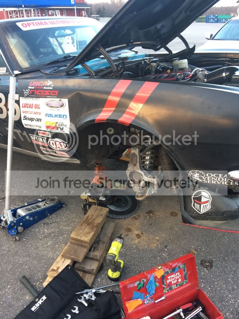

Sorry I haven't posted in a while, I've been really busy on the car since race season started. I took the car to the track the first weekend in March and had a little issue with the Hub. This is before I did any brake swapping, the car was in it's old form with the C5 Brakes. First let me say the car was an absolute beast on the track! Fastest its ever been. According to my GPS and backed up with an RPM calculator I was topping out around 168 mph on the front and back stretches of VIR! That's rolling! The new gear is just a tad steep for VIR as I'm on the rev limiter just before the brake zones on both straights. A 3:33 or similar may be in the works later this summer.
Later in the day I went out for a ridealong and on the 1st lap going into a hard left hander, boom! then I lost steering and brakes and was headed off the track! Thank god it was only about a 45 mph corner! I'll let the pictures tell the story! I'll post up the fix in another update. Spoiler the car is all back together bigger better stronger and I'll be headed to NOLA next weekend for an Optima event.

sebtarta 04-14-2017 06:32 AM
:goggles:
WOW! Glad you and the passenger were ok though. I bet a bit of poo came out as well, lol.
Amazing how things break in the most weird locations, yet I bet a lot of stress has been applied on that section of the hub. Cannot wait for the updates!
