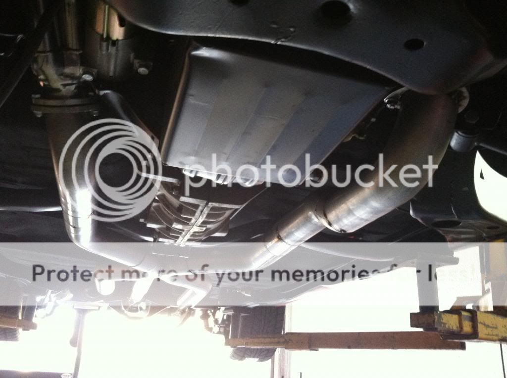

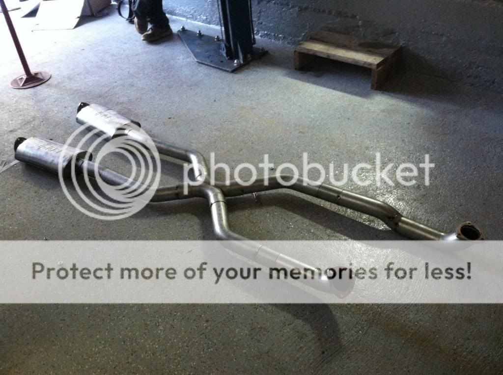

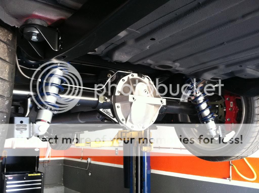

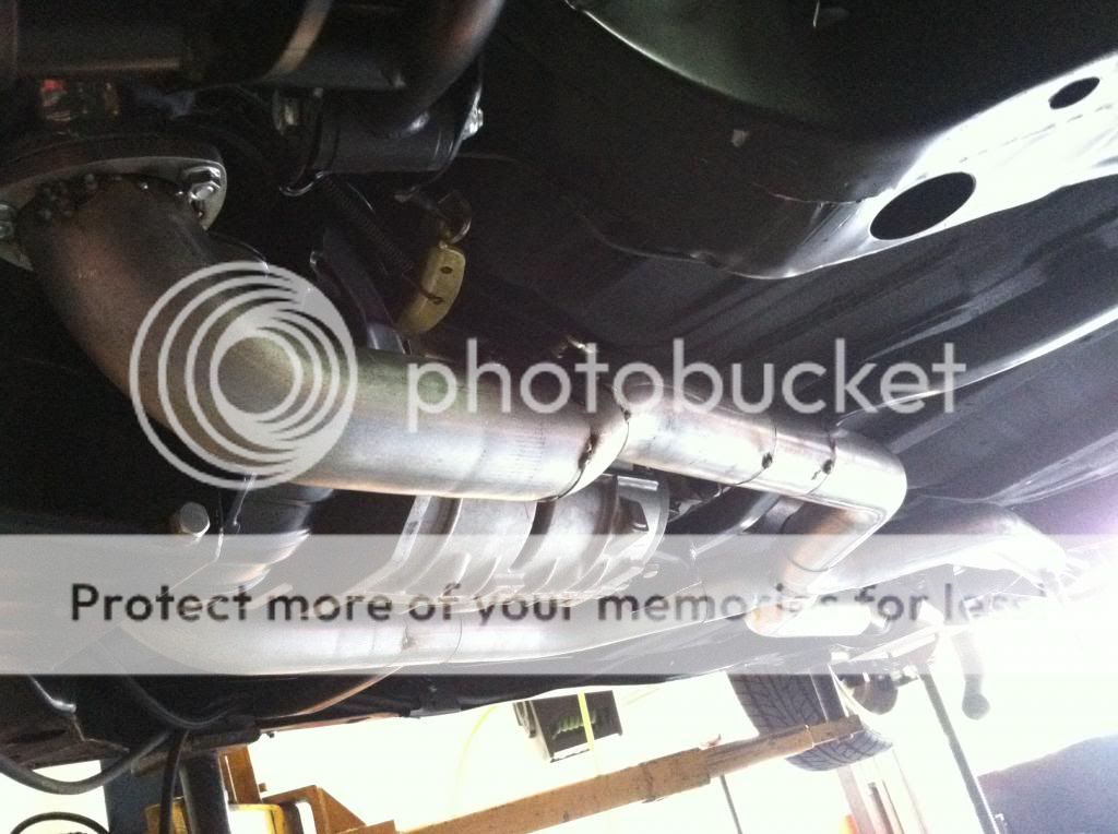

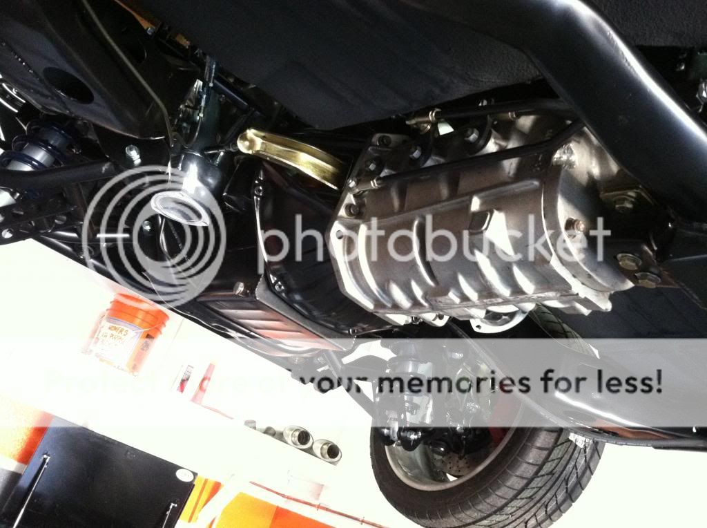

Thanks Wayne! The clear is hardened up now so I'll start another polishing round to finish it up. Here's what we finished last weekend. We got the two post up at our house so we tried our hand at the exhaust game. It's really tough, but we finished it up. It's headed to the ceramic coating shop this week. We used 4 mandrels, a Summit X pipe, Flowmaster mandrel tailpipes, and Borla XR-1s with 16 inch cases. I think i's gonna sound really crisp so now I'm on the hunt for the EFI. I also posted a pic of the plumbing I'm using. It's Aeromotive line without stainless braid. It's amazing and super easy to use. I'm hooked.
Off to the shop at home.
http://i394.photobucket.com/albums/p...ps9b786f4c.jpg
The rear all done. It's upper tight getting 3 inch up and over this pocket.
http://i394.photobucket.com/albums/p...ps3aaca0bc.jpg
Funky perpendicular driver's side header spout.
http://i394.photobucket.com/albums/p...psc52ac7fa.jpg
http://i394.photobucket.com/albums/p...ps49b6c496.jpg
http://i394.photobucket.com/albums/p...psc2dbd330.jpg
http://i394.photobucket.com/albums/p...ps281c60c2.jpg
http://i394.photobucket.com/albums/p...ps0f700ddc.jpg
http://i394.photobucket.com/albums/p...ps6f603490.jpg

Thanks everyone! Yeah summer cruising is right around the corner for us. The interior is gonna be a huge bill so the savings game is on. I gotta get the EFI dialed in and get this thing fired. looks like I also need a steel gear for the dizzy before we make sounds.

Dave, real nice exhaust work and LOVE the plumbing!!!! Lookin racey... I have to get out of my garage and come see it. Great job man.

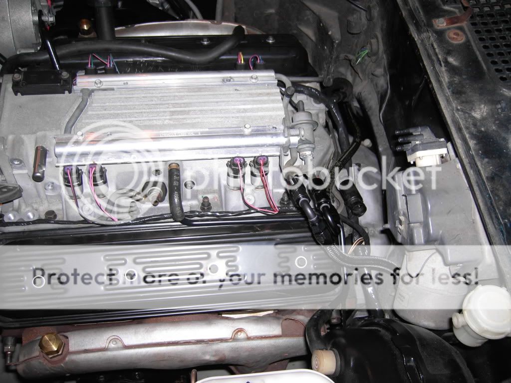

Looks great! Really like the colors you've chosen on everything. I do have a suggestion though. Change the routing on the vacuum line for the booster. You can bend a hard line that drops off the manifold and bends around the valve cover in order to get over to the booster. I think that would help show off the valve cover better.
Here's what I did on my car for reference.
Is there room to get a sway bar mounted in there?
Sweet setup!
