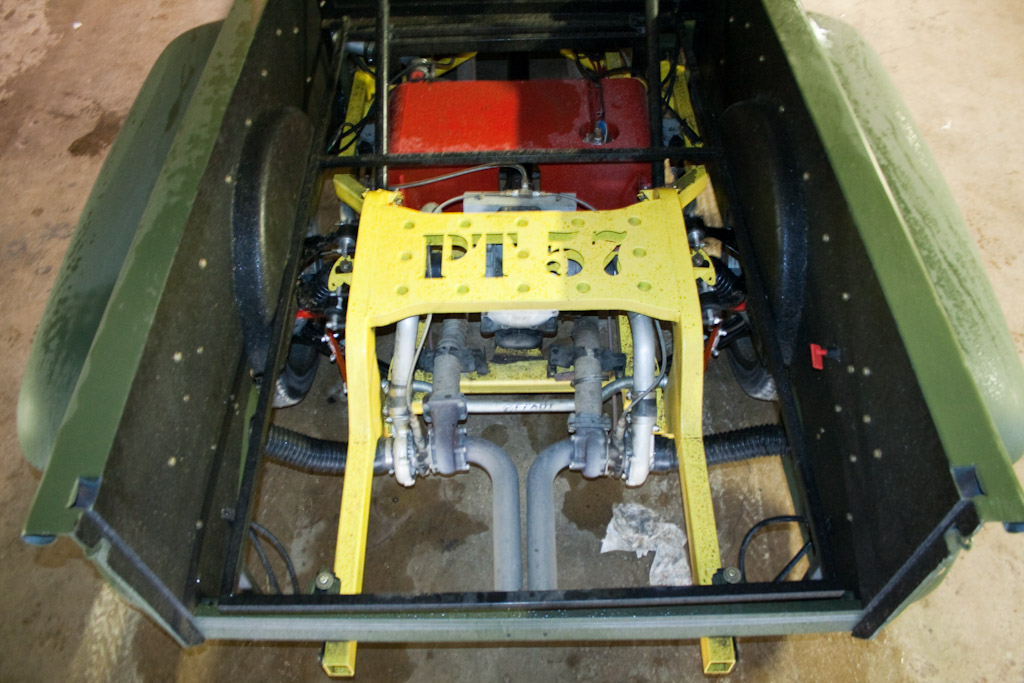

Looking good. I am curious because I know nothing about turbo set ups but is there any power loss having the turbos so far away from the motor?
No, really thats the only down side but there are tons of advantages that you get from putting them out back.
Consider all the back pressure your taking off the turbo's compressor wheel by having a tiny short exit out of the car after the compressor. A normal car is required to spin its turbo then push the gas trough the rest of the exhaust tubing and normally a muffler or resonator at that point do to harmonic amplification in the pipes. That's all back pressure right on the compressor that will cause lag in a turbo system. If all that room and positive pressure is in front of compressor then the turbine will be quicker to respond and spool.
Yes the STS system has to push the air all the way back up front but thats about the only down side. Consider all this too.
1)The air coming into the compressor is much colder taken from the back of the car where there is almost no heat.
2) No pressure drop due to large restrictive inter-cooler. (No IC on this car and I'm going to take the one off my 57 soon)
3) Colder IAT's (My PT-57 was showing +5 degrees from ambient on the dyno)
4) Heat, Turbos operate 400 colder than traditional turbos, motor runs cooler since your not adding another hot object(s) under the hood.
5) Cast manifolds are the best thing you can have on a stock CID motor because the keep the heat in the system.
6) Weight, Face it these cars need a little more weight on the back and a Flowmaster weighs almost the same as a turbo.
7) Driveability, Turbos don't spool unless you stand on it and keep the RPM's up. Crazy cams and blowers are always there. You can easily daily drive a properly tuned 1000+ HP Turbos cars because the boost is variable.

Don't get me wrong, its no cake walk. You need fully plan the car's driveline to make it work. If you do that then you'll be fine. Read STS's website, and a few turbo books, Maximum Boost by Corky Bell is a good one and know how your engine management works so you can safely tune your car. I don't have a dyno at the shop so it a bit of a long process but I can feel the power getting there on the PT-57.
Originally Posted by Kendall Burleson (Post 254247)
You should be working, your lunch break was much too long for you to explain all that stuff.You have 323 days until SEMA.:rofl::rofl:
Sorry Kendall I was out playing in the rain.
Its funny to roll on the gas in 5th gear at 55 (1750 RPM's) and listen to the turbos snap those 345's loose under the car.
