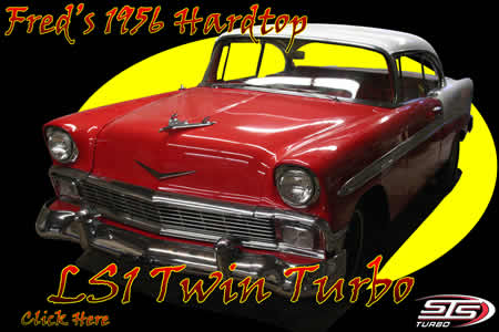

Here’s a fun project we’ve just started here at Hot Rod Jim’s.
Fred’s 1956 came to him as pretty nice car but after selling his C5 Corvette the Old 350 and power glide just didn’t impress him anymore nor did he really trust it any more. We’re first outfitting this 56 with our Stage 2 Rolling Chassis so we can toss some custom tweaks to the frame for the turbos. With the corvette suspension this car will now have power rack and pinion steering, all wheel disk brakes, QA1 coil over shocks, IRS suspension and our front sway bar upgrade. To Power the new chassis we were looking for power without breaking the bank. So we started with an LS1 and T56 from a 2000 Camaro. For less than 4,000.00 we now have a LS motor, T56 transmission, pulleys with power steering pump and AC compressor, a wiring harness we can rebuild and some exhaust components to start with. Fred wanted about 500 HP and he was looking at LS7’s and LS3’s but once you got the 5,000.00 motor now your looking at a custom harness for at least 1,000.00, 1,500.00-2,500.00 in pulleys and you still don’t have a transmission flywheel or clutch. So we’re going to huff a little more power in this bad boy with a custom STS Twin Turbo System pushing 5-7 PSI and giving us about 500 at the rear wheels and we’ll also get better gas mileage too, 28+ on the highway.
Some photos of Freds 56. We’ll be going to pick the car up and bring it back to Hot Rod Jim’s so we can swap it over and re wire the car.
Here’s Fred’s Chassis as it would be delivered to a customer who ordered our TriFive Stage 2 Rolling Chassis with Fred's LS1 and T56 sitting in it already.
