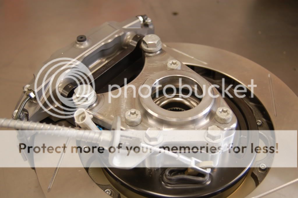

Originally Posted by chicane (Post 387619)
No. What Mark actual has, started with a conversation that he and I had at the 2009 (or 2010) Optima Ultimate Street Car gig post SEMA. He went an even more simplified route... but it's also a limiting route to solve his particular issues with the ABS. I was going the same route when I initially started this endeavor... however, there were some other issues with the more simplified design that have been addressed and are now part of the basic product design of the final product. I felt like having a part with limitations, would just be another band-aid.
Both ideas do the job... it's just that one allows options that the other will never have as they are not built into the basic design from it's inception.
Mine is different but simular. I remember the conversation but lost your contact information. I designed and built my own system to solve my ABS issue.
http://i439.photobucket.com/albums/q...e/DSC_3871.jpg
http://i439.photobucket.com/albums/q...e/DSCN0185.jpg
http://i439.photobucket.com/albums/q...e/DSC_3858.jpg
http://i439.photobucket.com/albums/q...e/DSC_3452.jpg
I'm also using a ZR-1 bearing and making a axle shaft that stub shaft on the end of it. Mine is a two part system. A steel part that welds to the axle tube and a aluminum spacer.
This system fixed my biggest rear axle problems.
  • Brake Knock Back
  • Rear axle leaking
  • ABS signal faults
  • Robust parking brake
After I did this my ABS signals were rock soild and it worked flawlessly at OUSCI this year.
Your kit looks nice. I wish you would of had it last year it would have saved me a lot of time...:lateral:
