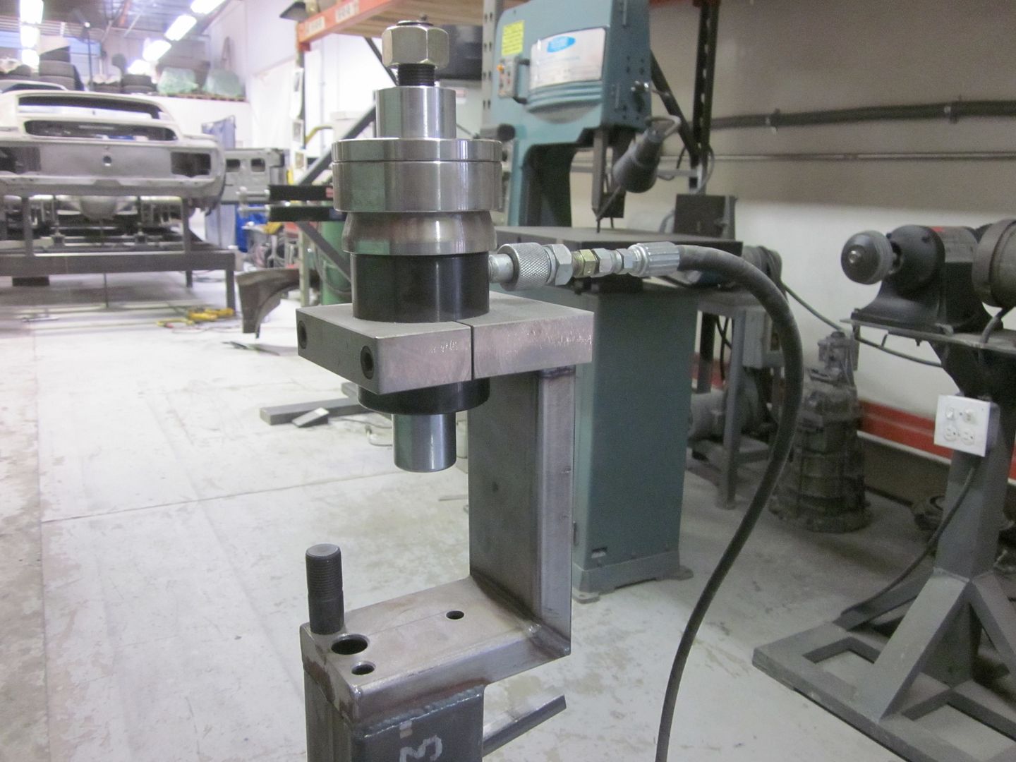

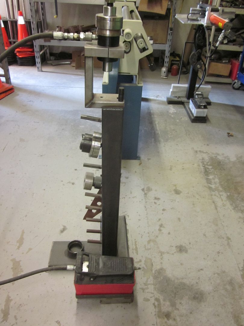

Here is the one I bought.. It is a JMR Portable Punch.. We machined a collet to hold it on a stand & fab'ed a quick stand.. I can remove it off the stand & work in a car if necessary.. works great up to 14 gage metal..
http://i1015.photobucket.com/albums/...n/IMG_2043.jpg
http://i1015.photobucket.com/albums/...n/IMG_2044.jpg
