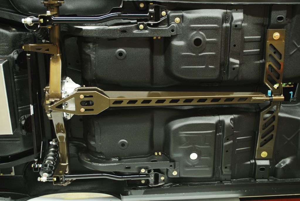

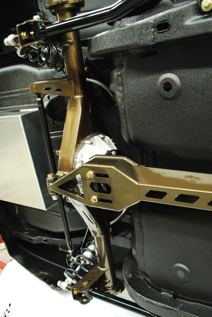

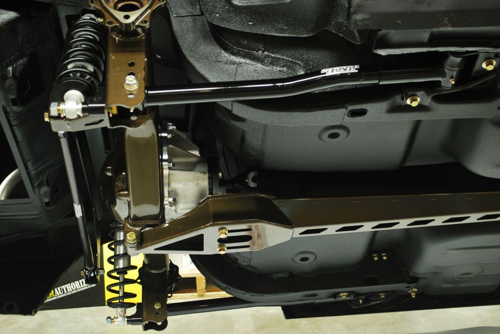

Here are some new pictures of the parts finished and installed.
The Torque arm is virtually the same as what we have for the First Gen Camaro, so the performance proven, same install , No floor cutting. if you are planning on running a 335/345 rear tire you will have to mini tub obviously, but that is IT. NO other modifications to the frame, trunk floor, back seat. Only the shock X member needs to be welded in.
There is plenty of room for 3" exhaust over the axle.
This is our new Second Gen Test car, it has the Chicane 9" floater rear in it as well as the StreetFighter front subframe.
I will have some ride height pictures next week.

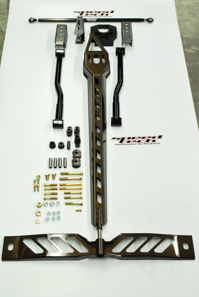

Here is the basic kit shown with everything that comes in the kit.

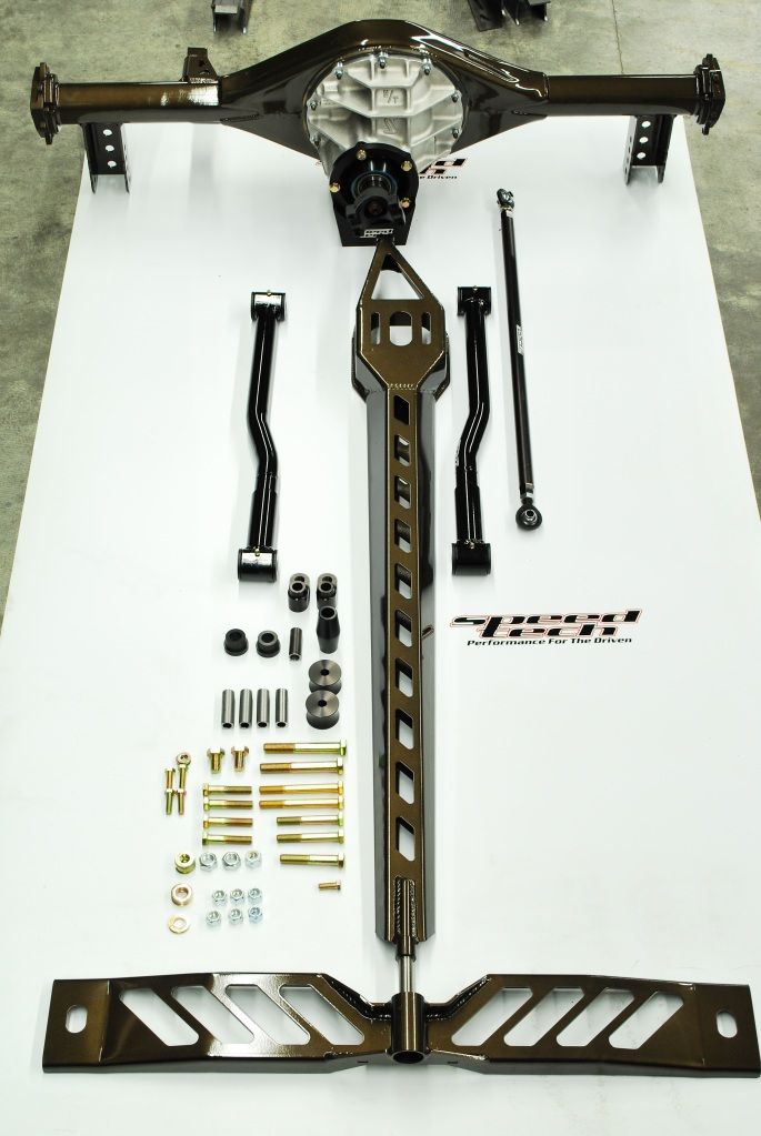

And here shown with the Chicane 9" it is also available with a standard 9" aswell.
