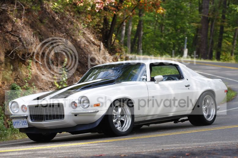

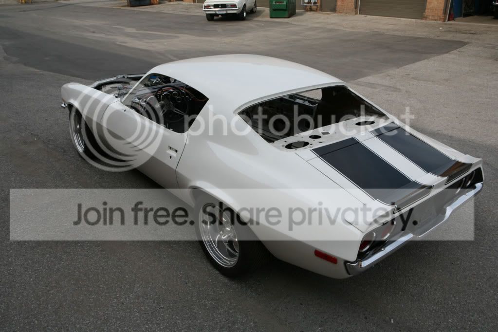

We did a 1 1/2" stretch on the White 72RS that allowed us to tuck the rear down without issues (315X18 no mini-tube on springs).... If you look closely the mid-body line flares from the door to the wheel well opening and the whole quarter is the stretched out ...
Makes room for a wider stance and provides room for extra clearance you're looking for....
http://i997.photobucket.com/albums/a.../project3a.jpg
http://i997.photobucket.com/albums/a...S/72RSRear.jpg

Unfortunately we really did a poor job of photo documenting that portion of the build I'm sorry.... I know it required a lot of patience and really is great for the clearance...
I am considering taking a splash off these quarters for an upcoming one piece composite Camaro shell that I'll commence building in the Spring all things equal...

Albert, those are great shots. That is the kind of info I'm looking for. This is tubbed so the rear is more of a fender clearance issue to get the wheels out far enough so that it doesn't have that pro-street look. :-)
The front is a whole other conundrum...
