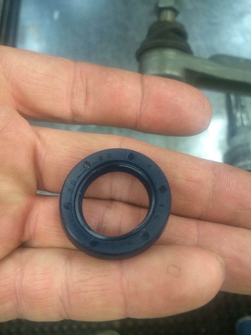

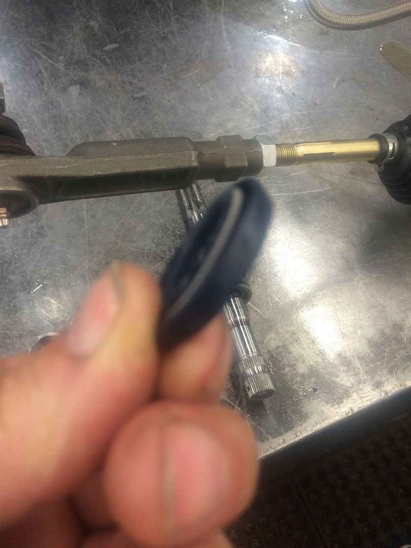

Well just found out I did the same thing! Crossed my lines too. I have to contact DSE tomorrow and find out what I can do if they sell a seal kit or what? And to top it all off I got a Dyno appointment Friday!
Vegas69 06-14-2015 03:32 PM
I had to replace the rack back in 10 when I popped mine. I don't think I could locate a repair kit.
Grnova 06-14-2015 07:16 PM
Well here is what I found. The rack is not broke but I did find a blown out seal. I will try to find a replacement tomorrow.
http://i300.photobucket.com/albums/n...psr9md5ju8.jpg
http://i300.photobucket.com/albums/n...pskohubgf3.jpg
http://i300.photobucket.com/albums/n...psyupqhjxv.jpg
