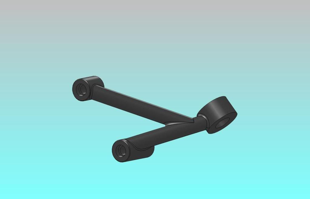

Here is another part that I am working on.. Always have hated modifying the original 2nd gen spindles to fit aftermarket brakes.. So we are making our own spindle..
http://i1015.photobucket.com/albums/...LE4Default.jpg
Looks like a forging to me! Are you making these univeral enough to mount all brands of calipers????
--Eric
Cris@JCG 07-27-2010 10:53 AM
You caught that one Eric!
The spindle is designed as a forging.. It will be out of steel.. Right now it will use a stock Wilwood Camaro hub with a W6 Wilwood caliper.. I have it all designed & layed out but waiting to machine the first set.. The future is to use Impala custom hub with the large bearings.. Caliper brackets can be made to fit different calipers applications.. The steeing arms will be fabricated for different adjustments to the suspension mounting points..
http://i1015.photobucket.com/albums/...RRING-ARM4.jpg
--Eric
71RS/SS396 07-27-2010 11:11 AM
Will the spindle and hub combo increase the track width? That is another negative to most of the aftermarket brake set-ups I've seen. It's hard enough with the stock track width to fit much tire on these cars if they are lowered.
Cris@JCG 07-27-2010 11:20 AM
No.. I can control hub to spindle placement @ this point.. Right now it sits about 3/8 in towards the spindle.. Lowers the car about 1 inch.. & a couple of other things that I will not disclose till prototypes are machined & fitted
At this time I am only making one set.. maybe two.. I don't know if I would take it any farther machining a set for my car.. Forging is expensive!! I could always sand cast like they did the orignals.. But $$$ for tooling is always a BIG factor!!

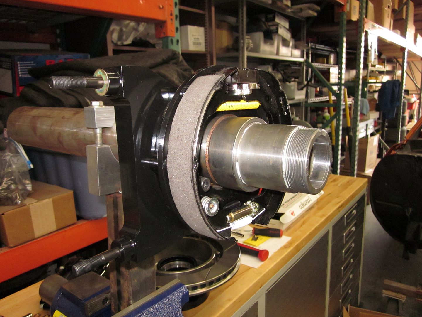

Cris@JCG 08-19-2010 01:16 PM
JCG/Speeedway Floater rear end
Got parts machined this week.. close to have the parking brake system work .. We will be using a radial mount Super Lite Wilwood caliper & 12.88 dia x .810 thk rotor.. Keeping rotational weight down..
http://i1015.photobucket.com/albums/...n/IMG_0336.jpg

Cris@JCG 08-31-2010 07:57 PM
Wilwood rear brakes
We finally got all the parts mocked up for the parking brake system for the floater rear-end.. Looks like the brakes on my dually!! :D
http://i1015.photobucket.com/albums/...n/IMG_0366.jpg
http://i1015.photobucket.com/albums/...n/IMG_0367.jpg

Payton King 09-01-2010 05:46 AM
Very nice work
I bet there is no machine time in that. LOL
Are you using the Billet Super lights narrow calipers that take the 1.1 rotor?
I am almost afraid to ask how much to duplicate the hat....but I will?
Cris@JCG 09-01-2010 07:30 AM
We used as many off the shelf items from Wilwood... The calipers are Billet SL & the rotor is 1.10 thk..
With all the components I used ... You can go up to a W4A caliper & 14.25 rotor.. The final set up on my car will be .810 thk with 12.88 diameter... 1.12 or 1.25 on the bore size... Don't want all the rotational weight..
The hat is an off shelf item that has no bolt circle machined to it.. We took care of that & machined the flange to weld on the axle tube.. Cost on the hat ?? @ this time..
This whole set up is sitting on 1 degree of negitive camber!!
http://i1015.photobucket.com/albums/...n/IMG_0368.jpg

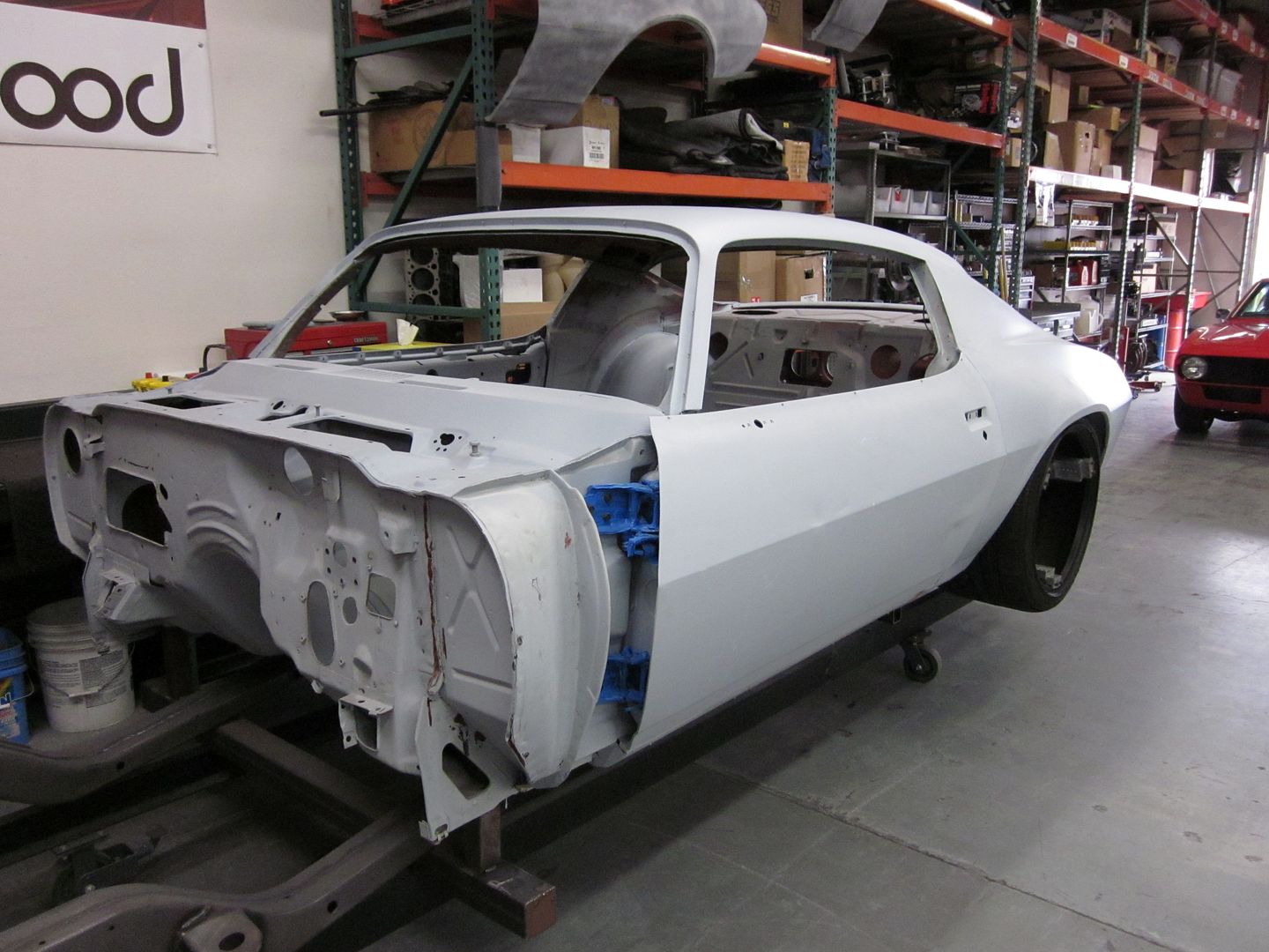

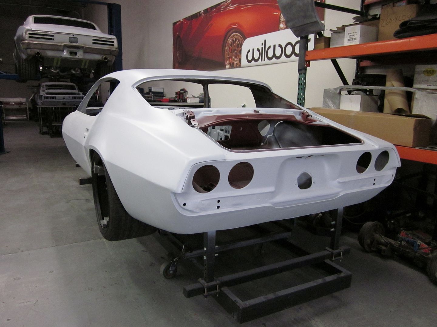

Cris@JCG 09-18-2010 08:59 AM
Stretch Completed!
I never thought we would get to work on my car with everything I got going on in the shop.. but we found some time to finish all the work the fab work on the rear of the car... We completed the qtr stretch & am very happy with the out come.. mini tubs are complete.. I was not going to do anything with the rear bumper but could not help myself.. We ended up re-doing the whole tail panel to fit the bumper.. We kept the bumper in stock configuration & just re-worked all the sheet metal...
Next steps are the firewall & rear suspension..
http://i1015.photobucket.com/albums/...n/IMG_0440.jpg
http://i1015.photobucket.com/albums/...n/IMG_0441.jpg

Cris@JCG 09-19-2010 02:02 PM
it is only in DTM primer.. we still need t oget the doors gapped & do the body work on the shell..
Mary's car is coming along but not as fast as I would like it too.. But hoping to get paint on it this week.
Originally Posted by awr68 (Post 306418)
Very cool! Nice to see it in primer...stretch turned out great! Lot's of cool projects under the knife over there! How's Mary's car coming along?
Out getting media blasted with the rest of the front sheet metal..
