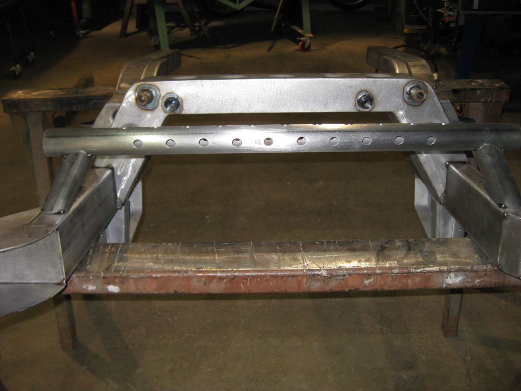

exwestracer 02-09-2013 08:15 AM
Nice piece, Scott!
Sorry if this is a stupid question, but are you using a curved sway bar arm? I ask because the bar tube seems pretty close to the height of the LCA mounts.
http://i1104.photobucket.com/albums/...vellexv011.jpg
Any pics of the bar "mocked" up in there with the end links, etc?
coolwelder62 02-09-2013 10:38 AM
The center of the sway bar is 1.25 higher than the LCA mount center.And I bent the splined sway bar arm so there is no binding with 1/2 rod end links.
exwestracer 02-09-2013 11:11 AM
Ah. Are you using a M/F heim set up for the end link?

coolwelder62 02-09-2013 04:30 PM
Yes, 1/2 male & 1/2 female heim w/cone spacer's.I will find you a close up photo.:thumbsup:

Jay Hilliard 02-18-2013 04:43 AM
Scott...subframe looks great. Kevin...awesome job on the welding. What is the tab in front of the A-arm bracket used for?
coolwelder62 02-18-2013 05:24 AM
Originally Posted by Jay Hilliard (Post 465482)
Scott...subframe looks great. Kevin...awesome job on the welding. What is the tabe in front of the A-arm bracket used for?
:thankyou: Jay,The tab is for Kevin's lower baybar mounting point.:thumbsup:

BBC71Nova 02-18-2013 07:10 AM
This is a good looking frame. Kinda glad I've still got the OEM sub since I have more options by waiting. The punch/flare would go great with the look I'm after. :)
Couple questions...
1. Is the hub-to-hub dimension of this setup the same as OEM? Trying to understand what, if anything, is to be considered when it comes to wheel/tire fitment. A little narrower than my current setup would be added benefit with my setup.
2. Will there be tabs front and rear of the LCA mounting locations to put them in double-shear?
coolwelder62 02-18-2013 08:46 AM
Originally Posted by Sieg (Post 465488)
Exceptional welds! What welder was that little rug-rat using?
Miller Matic 252 /.035 wire,75/25gas.
Couple questions...
Hub face w/o rotors is 60.5.The LCA will be in double shear.The rear lower brackets are finished just not in the photo.We are still working the frt bracket to hold the LCA and the rack & pinion bolts also in double shear.:thumbsup: In a few days Kevin should have frame all finished up and assembled for everyone too see the final product.
