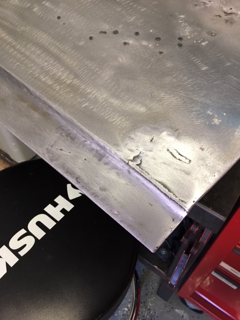

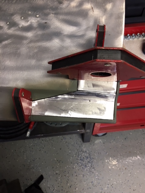

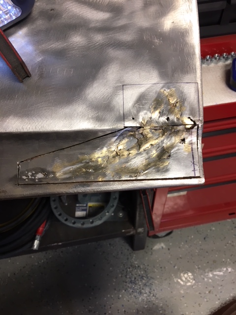

Anyway, I've been chipping along as I could. I had a bad spot on the second door that I cut out and replaced.
https://lateral-g.net/forums/attachm...1&d=1534426217
I just finished the majority of the bodywork on the second door and sprayed it with etch primer this week. With the doors set aside, I'll begin work to get the body in etch primer before I begin the body work on it.

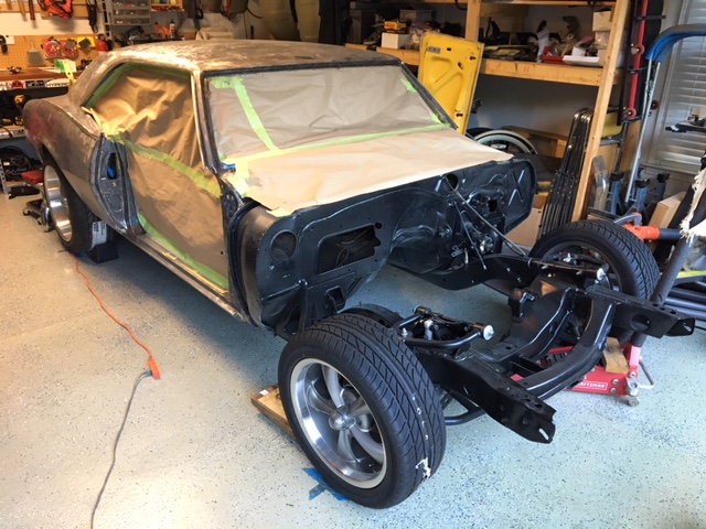

I got the doors hung and gapped, along with the fenders. Still have to tweak the header panel, valance, hood and install the grille. It's starting to look like a car again though...
I have to shorten the aluminum DSE core support bushings. The front end is mocked up with wood pieces that are about 1/4" shorter than the DSE bushings. Have to find someone with a lathe for that though.

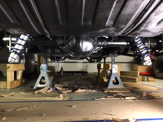

Got the Ridetech 4-link brackets welded on the 8.5" 10 bolt and got the rear suspension wrapped up. It's dirty, but I rolled it out since the sun was out and snapped a few photos with the new wheel/tires.
