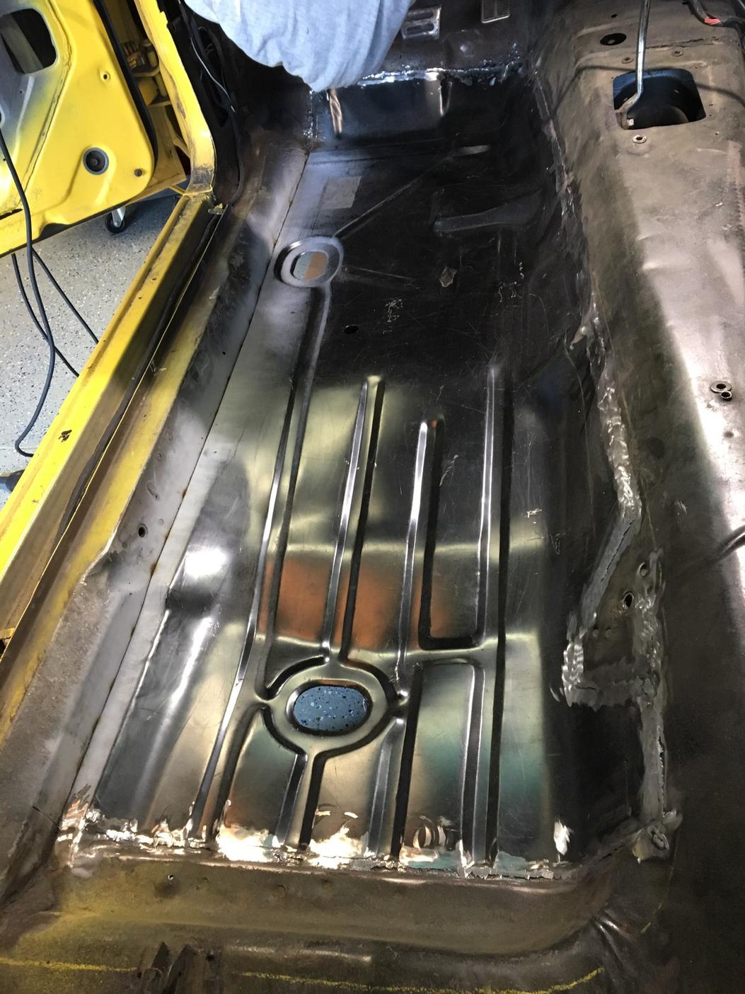

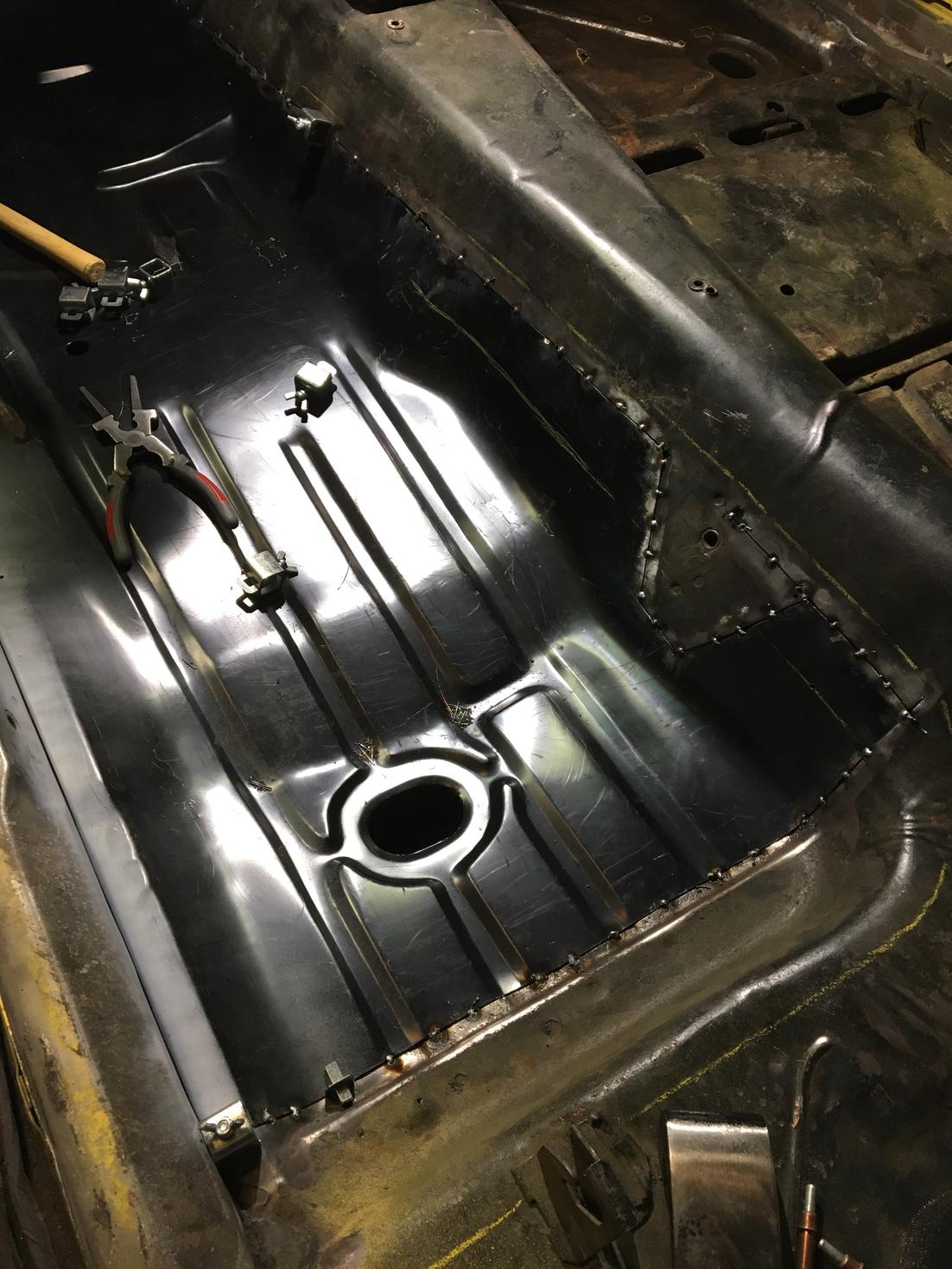

Finally got the factory spot welds removed. Trimmed the old and new floor pans to fit as tightly as I could.
Then started tacking the new pan in. Took a handful of tacks to get the welder settings where I needed them. Trying to take my time and not overheat/warp as I go.

I got the driver's floor pan and seat brace/bracket welded in.

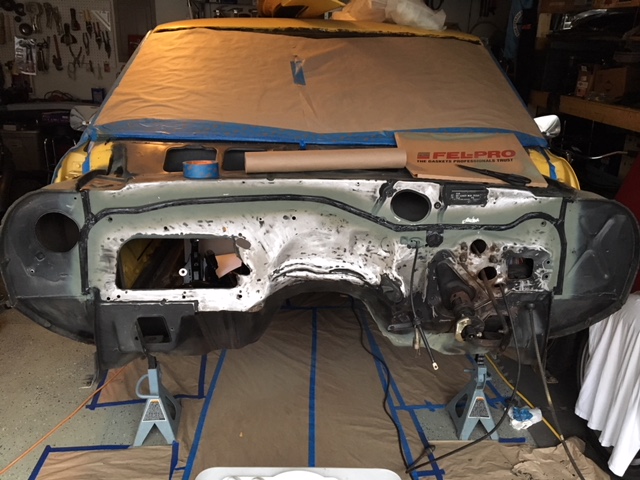

I got the front clip removed. The radiator support was in pretty good condition. There's a crack and a bit of rust in one of the lower corners that will need some attention. The driver's fender and fender extension look pretty good. The passenger fender has some rust at the lower body mount area along with a decent amount of bondo at the front inner corner. The top of the passenger fender extension where it meets the fender is full of bondo also.
The blower fan box and heater core came out easy. Also got some miscellaneous trim and other items removed.

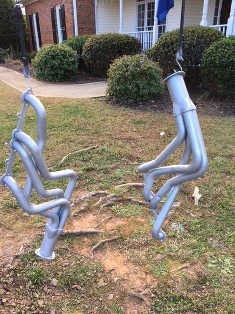

I got the subframe pulled and pressure washed after soaking it in Simple Green. I wire brushed some of the seams on the underside and started welding them up. There's still too much crap in the creases and pores of the metal because the welds were coming out very porous. I'm going to have it media blasted. Once that's done, I'll heat the seams with a torch and try to burn the remaining crap out. I also trimmed the factory shock tower mounts in preparation for the Chicane coilover mounts.
The headers were covered in rust. I sanded, cleaned and painted them and they turned out pretty well.
Before and after header photos.

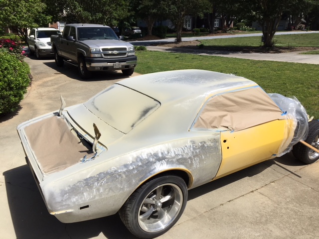

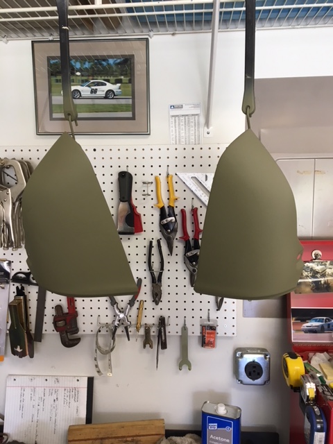

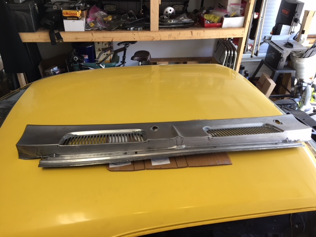

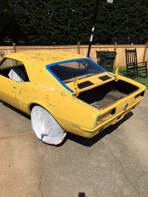

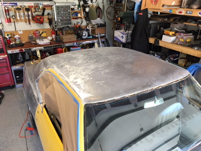

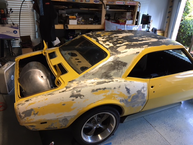

Been chipping away at the mundane stuff as time allows.
The rear end is painted. The axle bearings/seals and pinion seal were replaced. Started the Wilwood brake install.
The subframe is painted and ready to reinstall.
Cleaned, sanded, re-seam sealed the firewall. I don't have a current photo, but it's been primed and painted
The majority of my time has been spent on my back...scraping, sanding, priming, seam sealing, and painting the underbody. Not glorious, but it needed it for sure.
I've "massaged" the rear tub area so the Ridetech 4-link cradle fits nicely now.
Daniel
