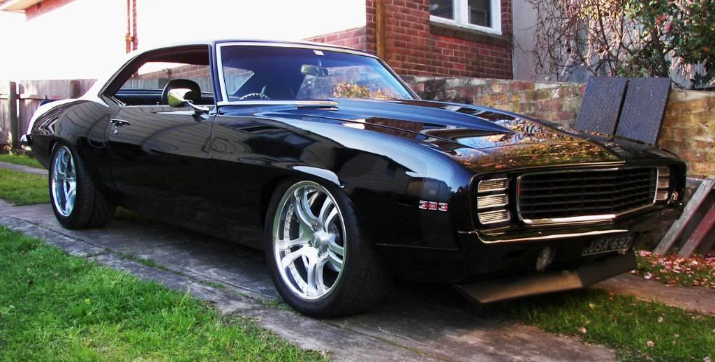

thanx guys ! im in australia hence the right hand drive conversion. :yes:
http://i221.photobucket.com/albums/d...EPT2010001.jpg
http://i221.photobucket.com/albums/d...EPT2010006.jpg
http://i221.photobucket.com/albums/d...accckkk008.jpg

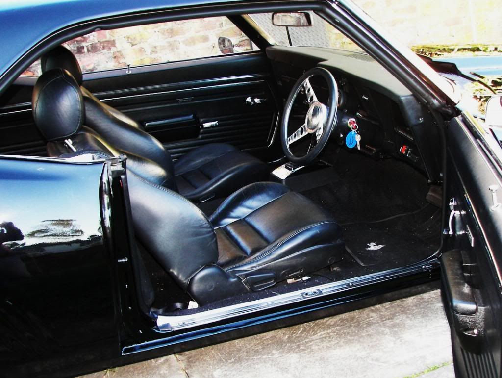

Beautiful! Love the injection. What seats are you using?
6D9 Matt 07-07-2011 07:29 PM
Man that is awesome... love the faint/ghost hockey stripes!
The stance is just awesome too... VERY beautiful camaro. :thumbsup:

usa-69z 07-11-2011 03:20 AM
the seats are electric leather mazda 626 seats. 98 model i think .

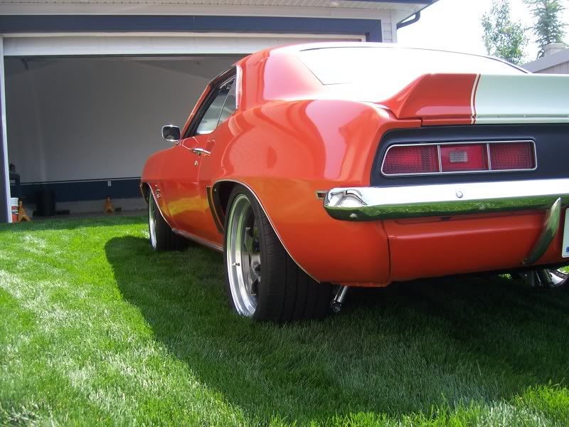

I am running Fikse 18x10 rears with 5 5/8" Backspace (275-40-18). Stock sheet metal, no problems with 2" lowering on 4 link.

Fikse Wheels 07-19-2011 03:02 PM
Yep, an 18 X 10.0" should fit on the back of a '69 with no rolling of quarter panels needed, with the proper backspacing, like so.

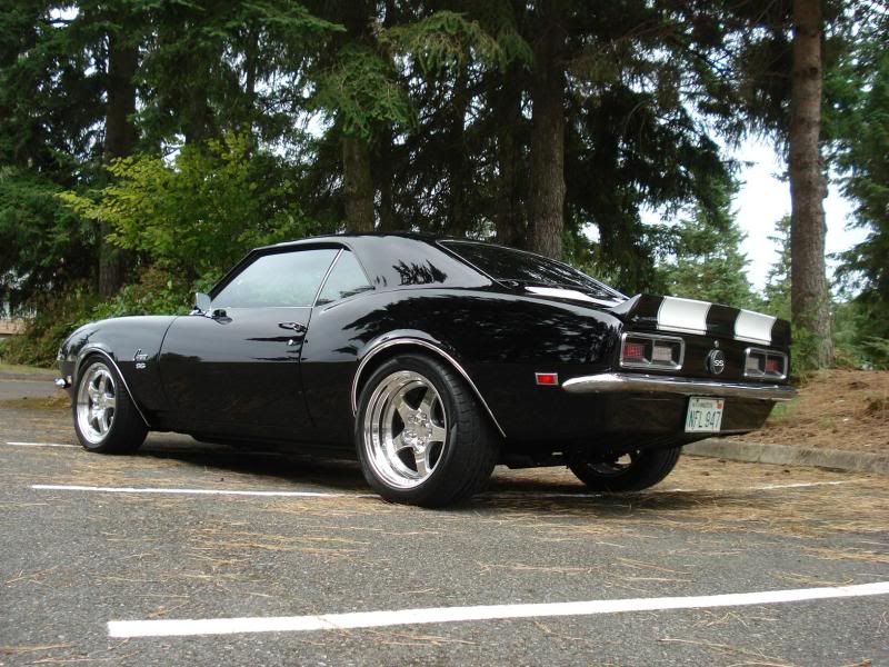

We can even fit an 18 X 10.0" on the back of a '67-68 with a little bit of massaging (this one ran a 295 rear tire too)
