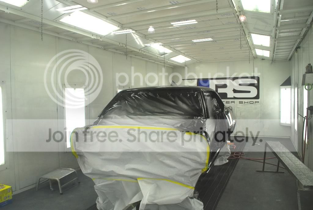

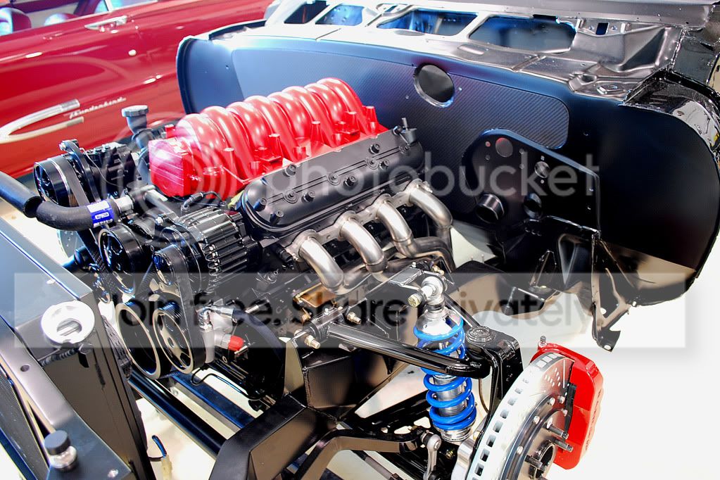

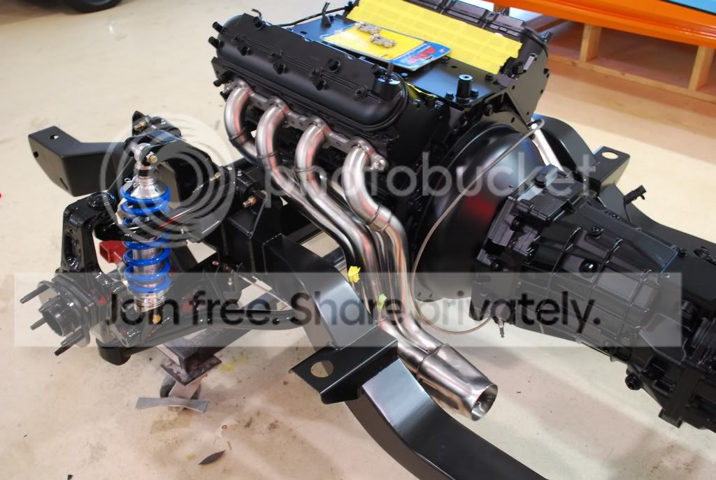

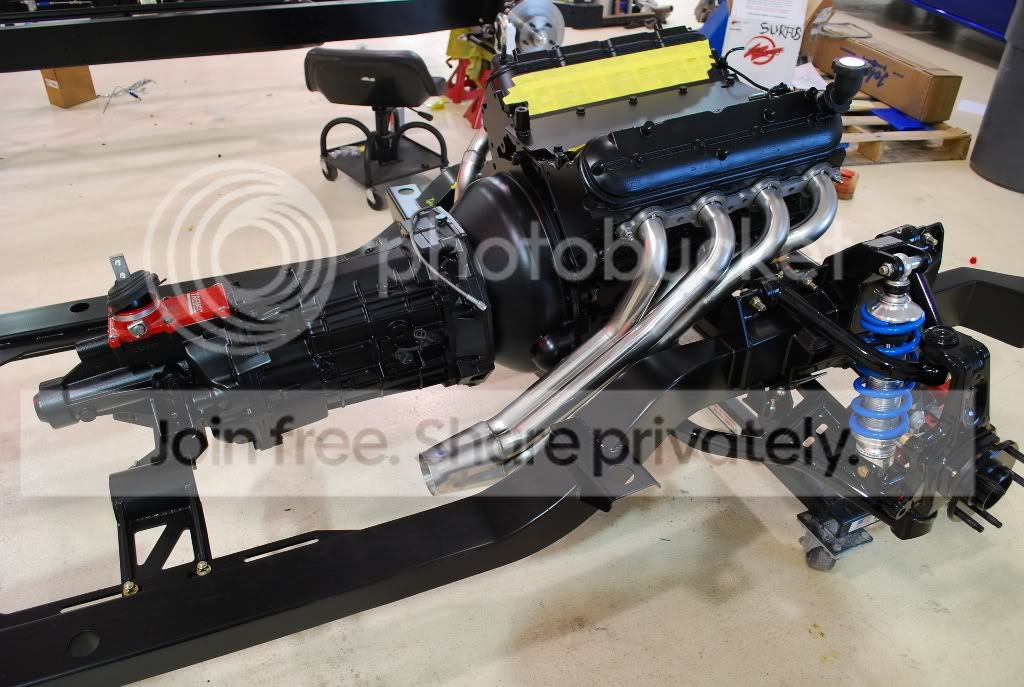

Moving ahead with the chassis assembly. Motor has been painted and installed with our new stainless headers. Brakes should be here from Baer in the next few days and then the chassis assembly will be complete.
http://i563.photobucket.com/albums/s...ture222054.jpg
http://i563.photobucket.com/albums/s...ture222052.jpg

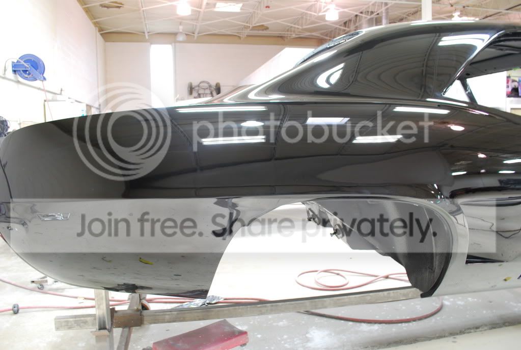

The body is being sprayed today as well. This is the last of the parts to paint, so this thing should start going bak together and looking like a car again here really soon.

Is that a step header on the drivers side? Just curious why its different than the other side?
Looks great though :D
RS-Chris 03-02-2012 06:27 AM
Thanks for the comments! -
The header has a step on that side for manufacturing purposes. The passenger side has less back to back bends than the drivers side (which has to clear steering etc.) so is easier to do in one piece.

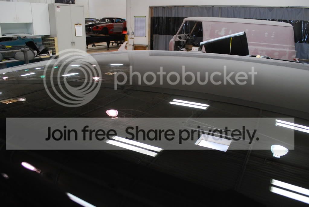

RS-Chris 03-14-2012 02:01 PM

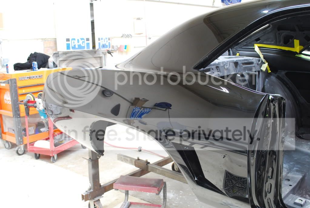

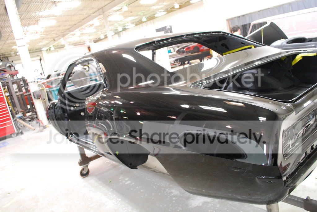

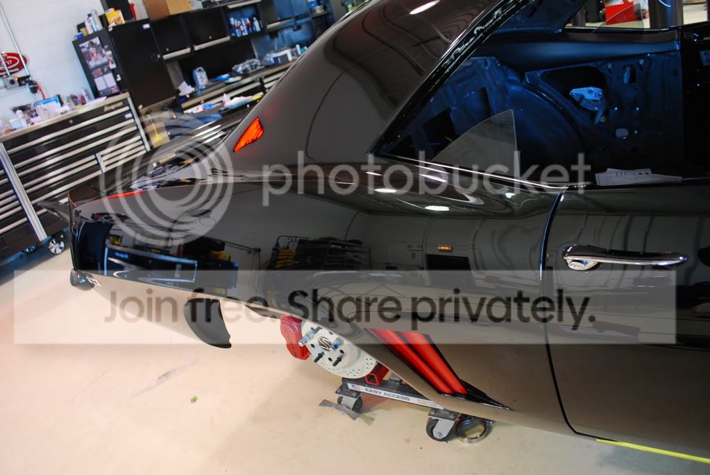

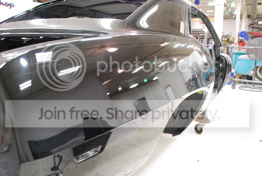

A quick update with a couple more recent shots of the paintwork:
http://i563.photobucket.com/albums/s...ture222294.jpg
http://i563.photobucket.com/albums/s...ture222296.jpg
http://i563.photobucket.com/albums/s...o/DSC_0012.jpg
http://i563.photobucket.com/albums/s...DSC_0017-1.jpg
http://i563.photobucket.com/albums/s...DSC_0019-1.jpg
tones2SS 03-14-2012 05:25 PM
Wow, mirror finish. Great job guys.

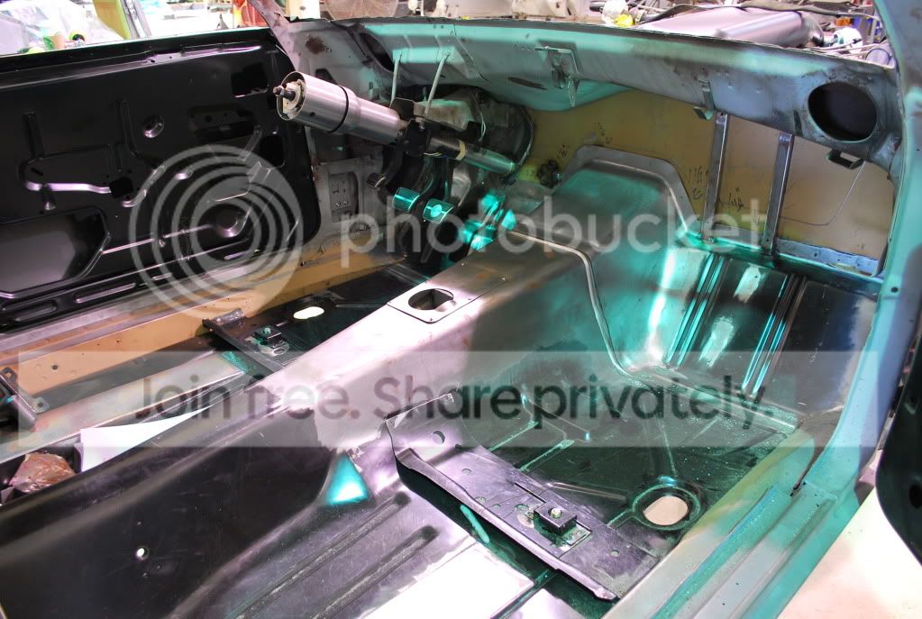

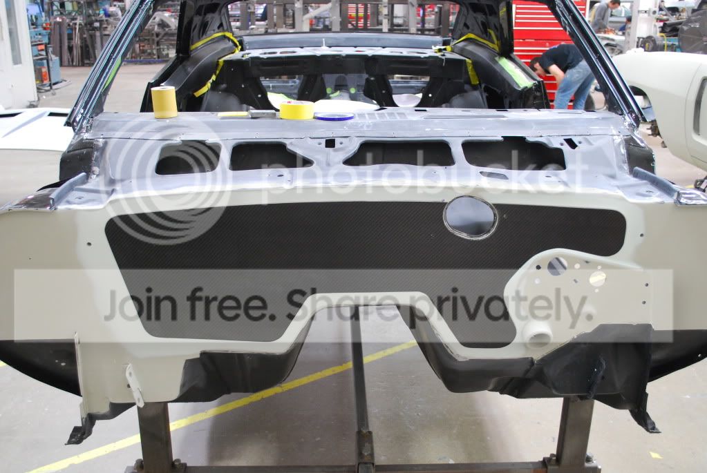

Originally Posted by Roadster Shop (Post 364646)
Hi, I was curious, when you smoothed the firewall are you leaving the existing firewall in place and simply welding in a piece of 18 gauge (I assume) sheet metal over the top, or do you cut out the old and weld in the new?
Thanks in advance, Chris
RS-Chris 03-16-2012 07:57 AM

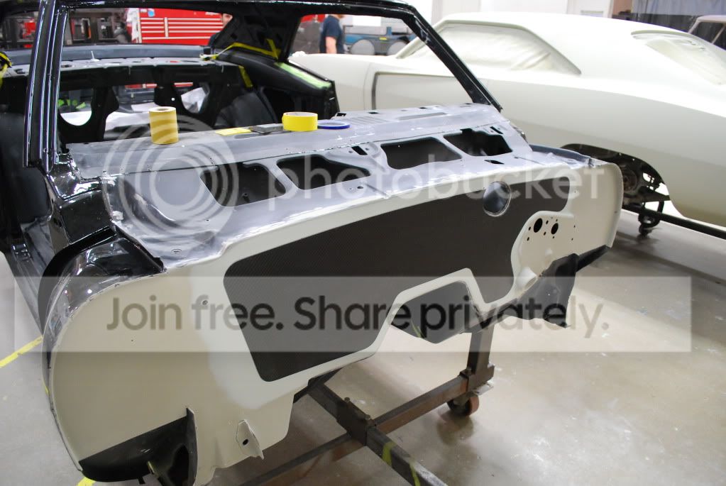

Chris -
I found a pic that should give you an idea: the old firewall is braced then cut, leaving a lip from the previous area which is then integrated with the overlaying new piece.
Hope that helps.
http://i563.photobucket.com/albums/s...cture20704.jpg

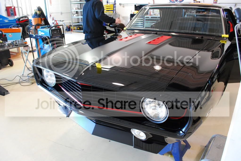

RS-Chris 04-02-2012 01:20 PM
Originally Posted by fbm37 (Post 402349)
I'm sure they have a special "Roadster Shop" gun that lays it down that slick...,Surely
It's actually a special setting on the bake cycle in the booth...it just comes out like that. :D

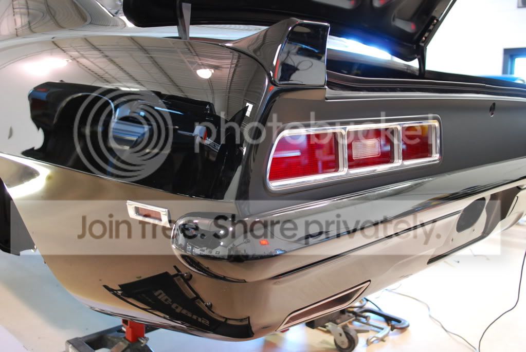

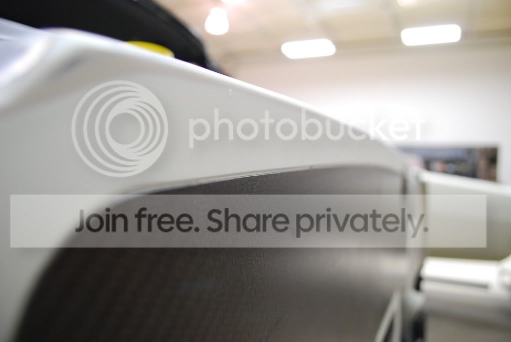

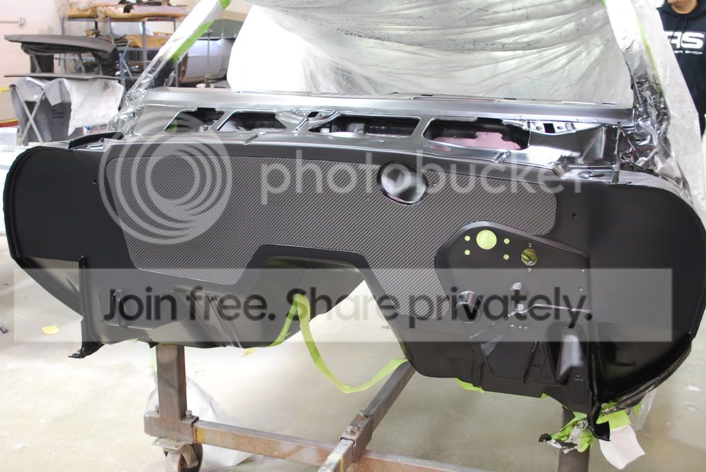

RS-Chris 04-02-2012 01:25 PM
A couple of updates for this '69.
Decided to add a splash of carbon fiber. The c/f will tie in with a couple of elements we have planned for the interior.
http://i563.photobucket.com/albums/s...ture222412.jpg
http://i563.photobucket.com/albums/s...ture222413.jpg
http://i563.photobucket.com/albums/s...ture222415.jpg

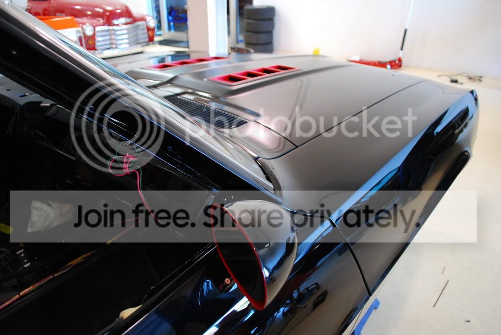

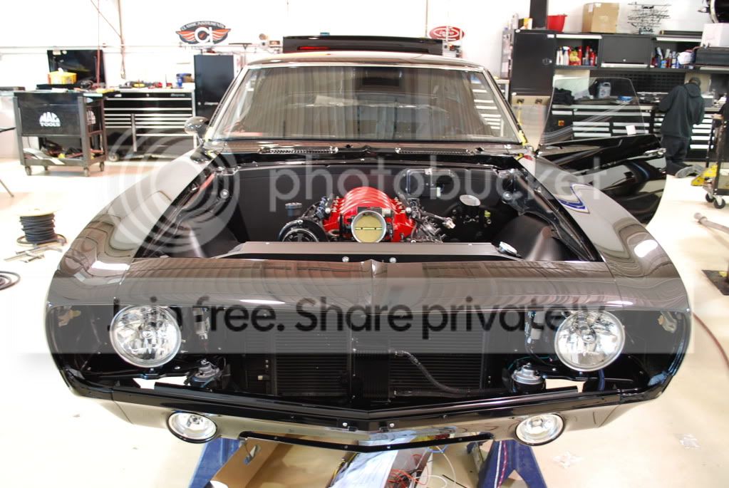

Body and chassis are together with the beginnings of some more red accents planned for under the hood:
http://i563.photobucket.com/albums/s...ture222537.jpg
http://i563.photobucket.com/albums/s...ture222554.jpg
http://i563.photobucket.com/albums/s...ture222555.jpg

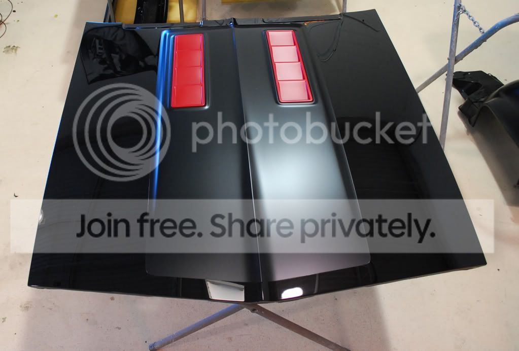

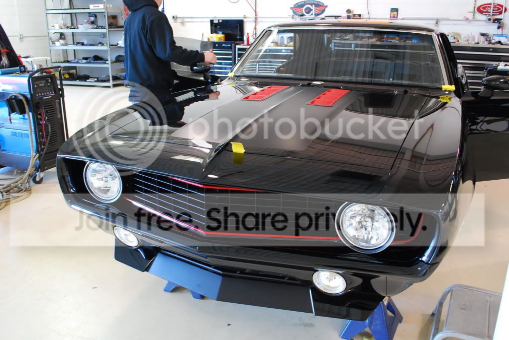

RS-Chris 04-06-2012 02:04 PM

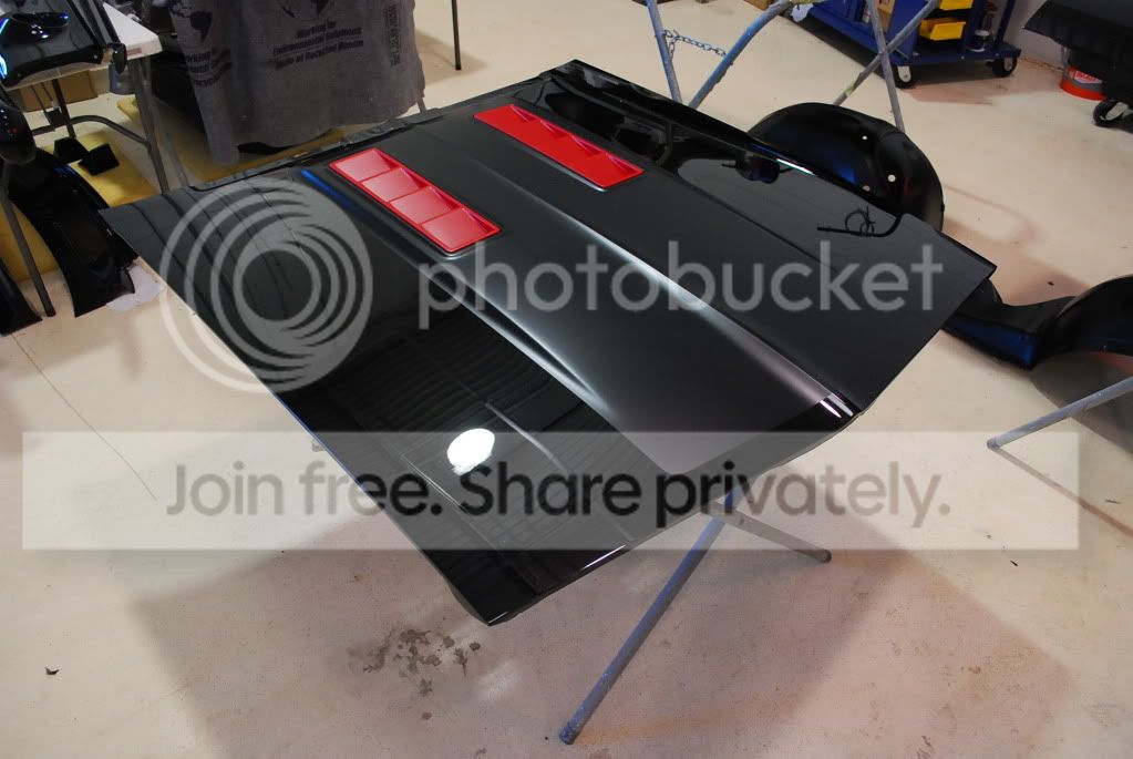

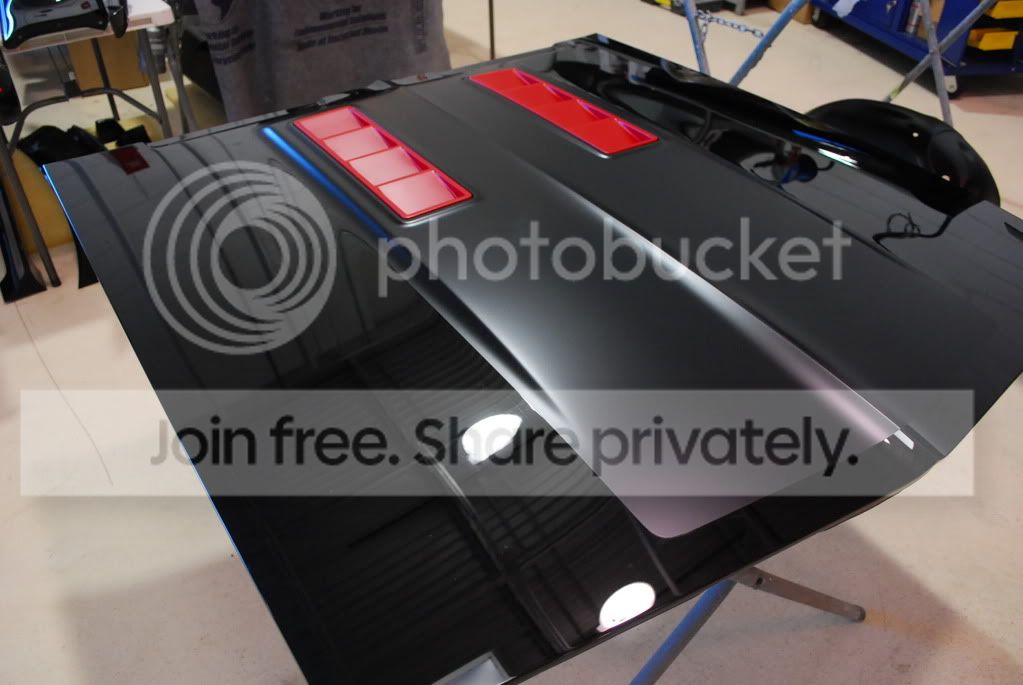

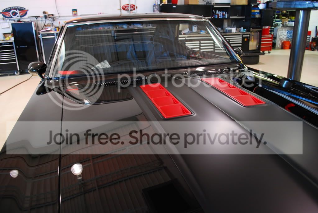

Hood pics!
http://i563.photobucket.com/albums/s...ture222717.jpg
http://i563.photobucket.com/albums/s...ture222710.jpg
http://i563.photobucket.com/albums/s...ture222708.jpg

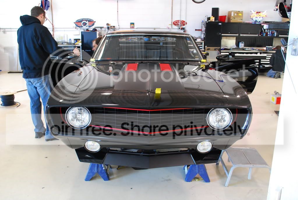

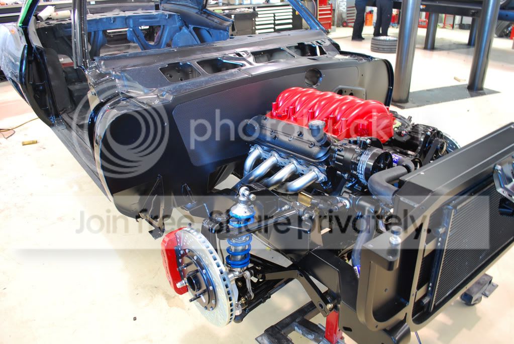

RS-Chris 04-27-2012 09:32 AM

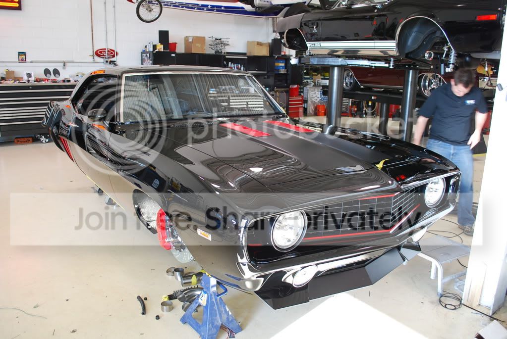

Some pics of the assembly as it all comes together!
http://i563.photobucket.com/albums/s...o/DSC_0204.jpg
http://i563.photobucket.com/albums/s...o/DSC_0139.jpg
http://i563.photobucket.com/albums/s...o/DSC_0070.jpg
http://i563.photobucket.com/albums/s...o/DSC_0208.jpg
http://i563.photobucket.com/albums/s...f/DSC_0175.jpg
http://i563.photobucket.com/albums/s...o/DSC_0202.jpg
http://i563.photobucket.com/albums/s...DSC_0013-1.jpg
http://i563.photobucket.com/albums/s...o/DSC_0008.jpg
http://i563.photobucket.com/albums/s...o/DSC_0006.jpg
