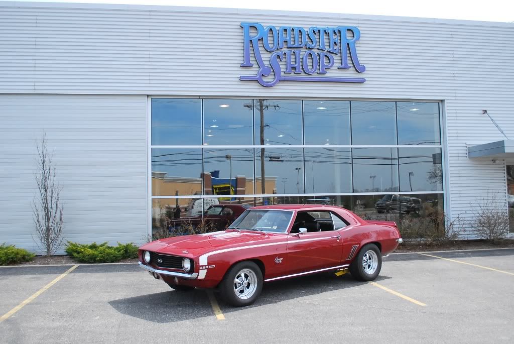

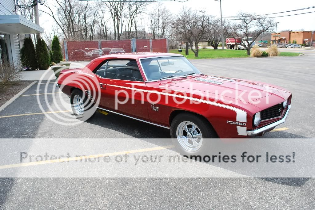

Here is a 69 Camaro that we started a few months back for a local customer. He brought in a driver quality car and wanted to really take it to the next level. Unhappy with the ride, the power, the interior, or exterior, the plan was for a complete overhaul to bring the car up to today's standards. Not a full blown track car, but something that he could drive across country comfortably and still be in contention at local auto-X events.
Still in the planning phase on a lot of things, but here are the basics to get started.
Roadster Shop Fast Track Chassis System
14" Wilwoods
D/A Afco coilovers
550-600 HP LS3
T-56 Magnum trans
18's and 20's
Several subtle body mods
All black with matte black and red accents
Original car

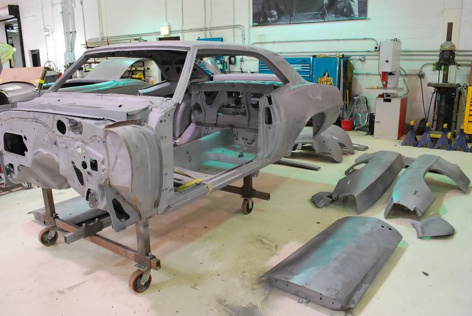

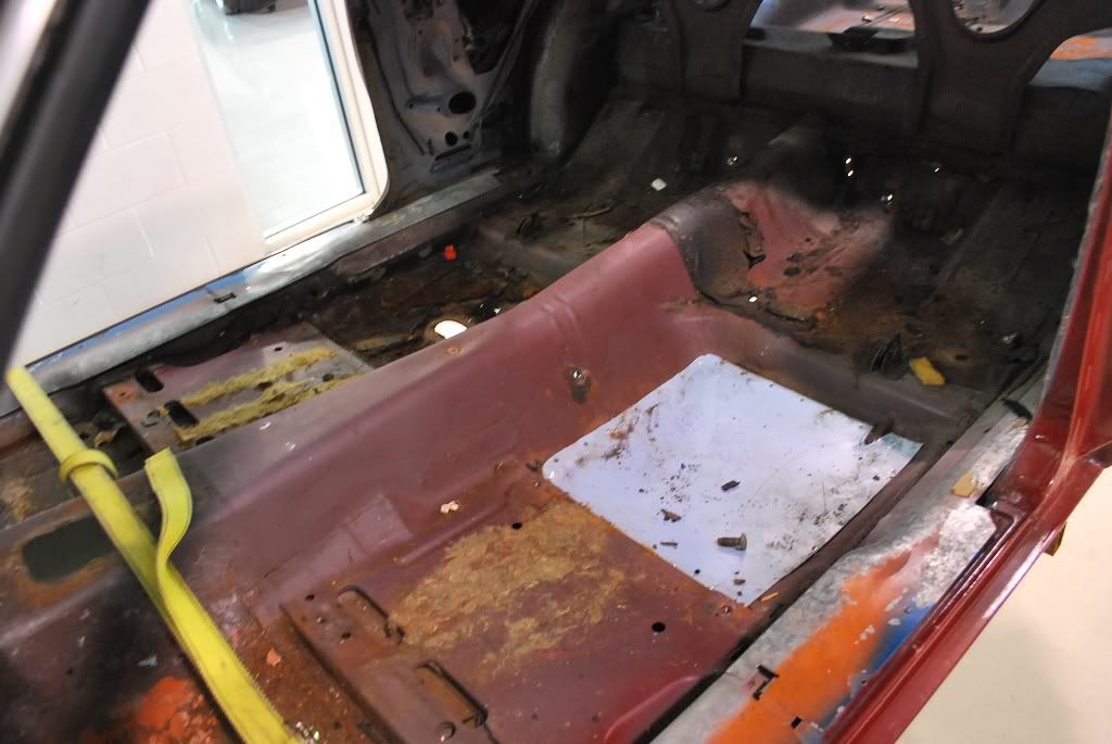

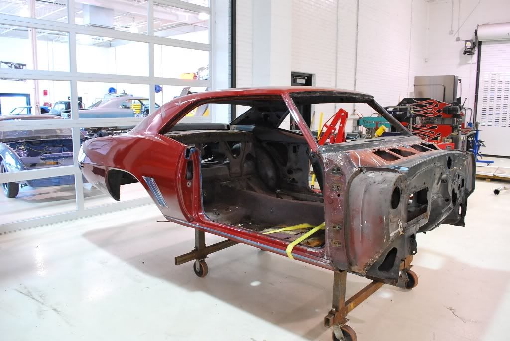

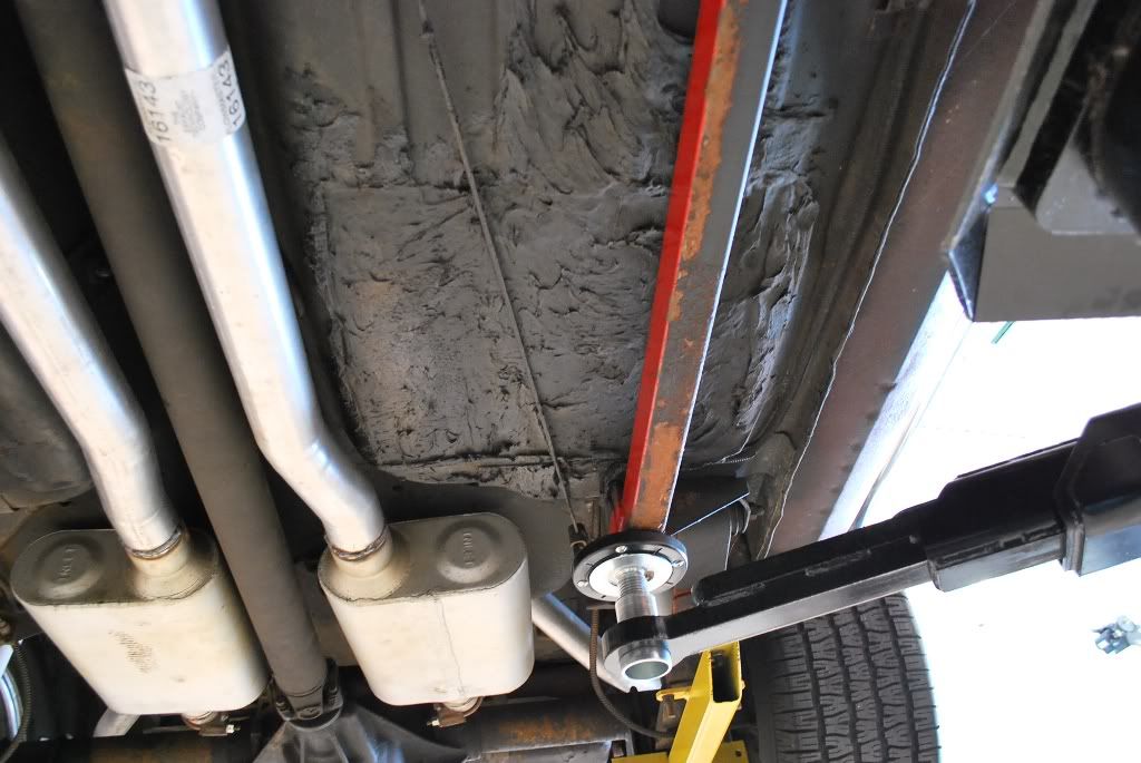

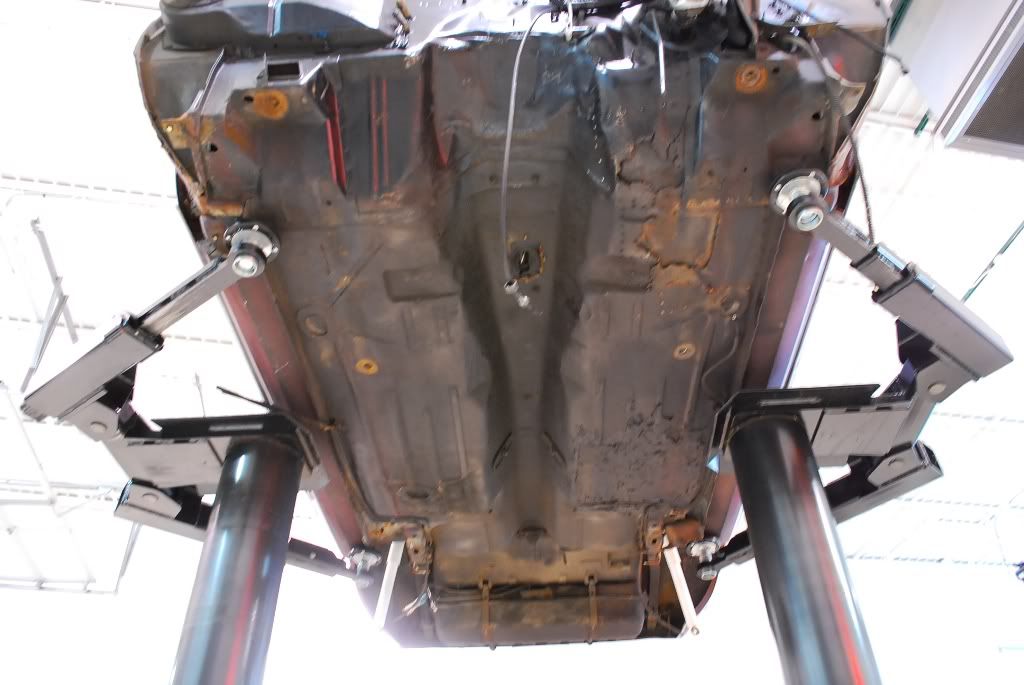

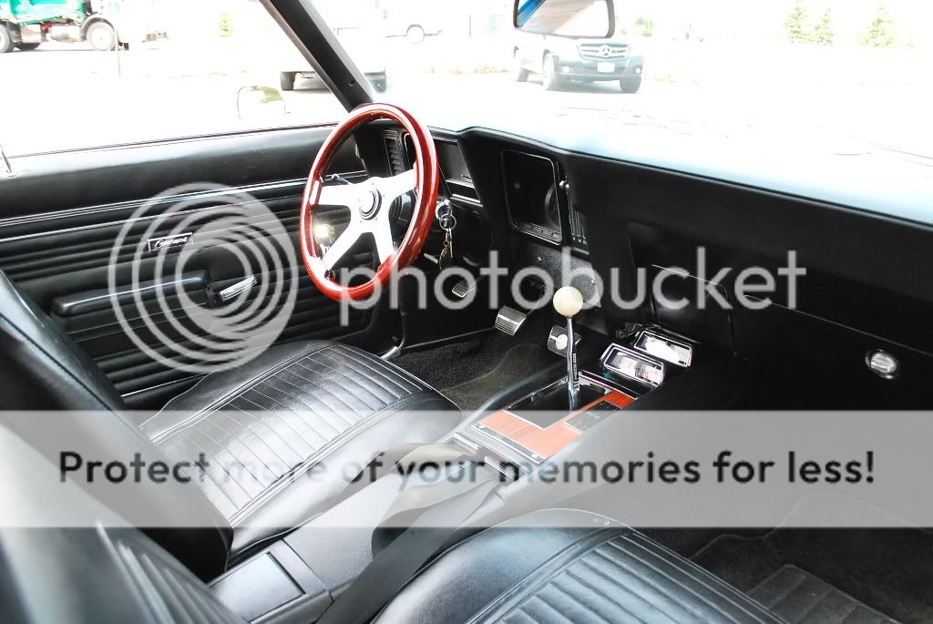

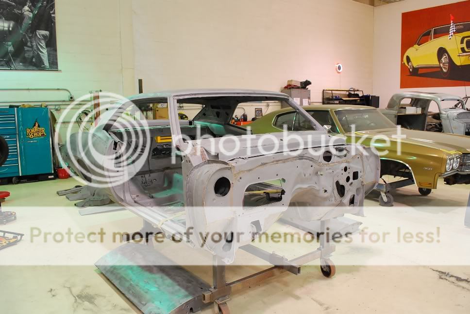

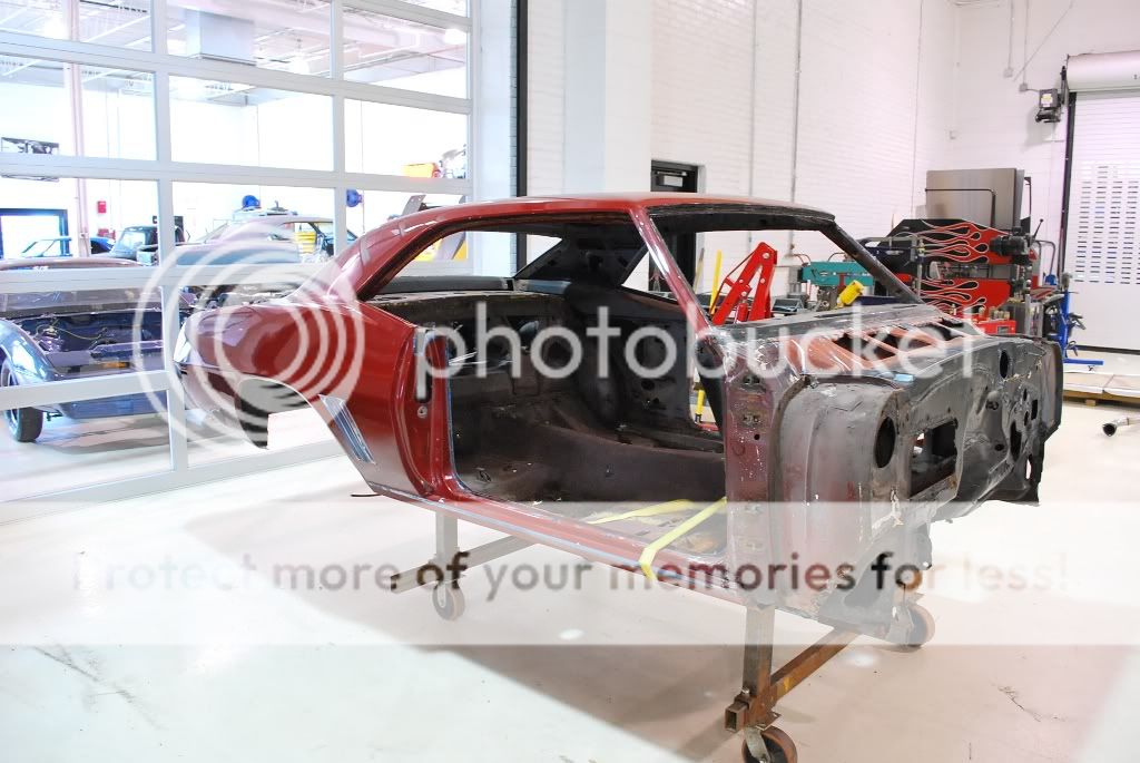

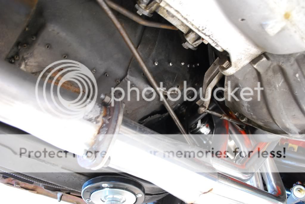

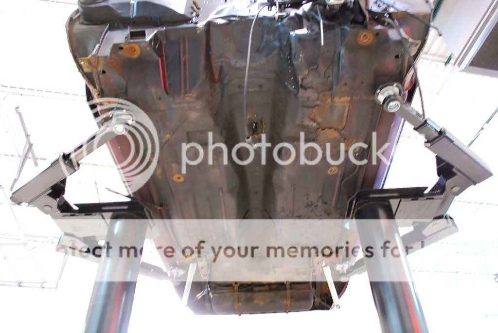

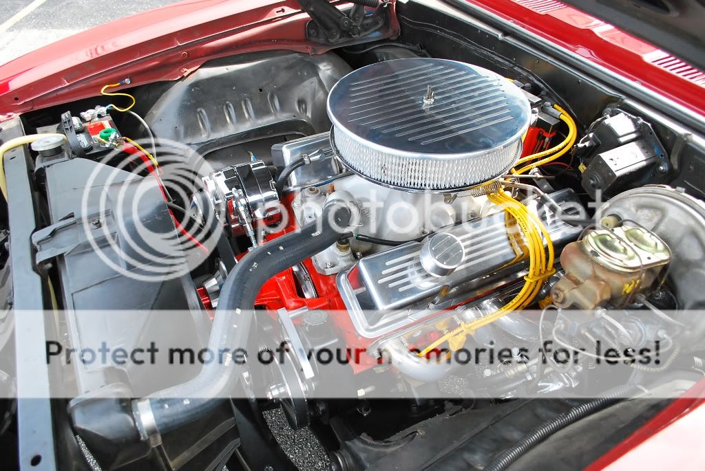

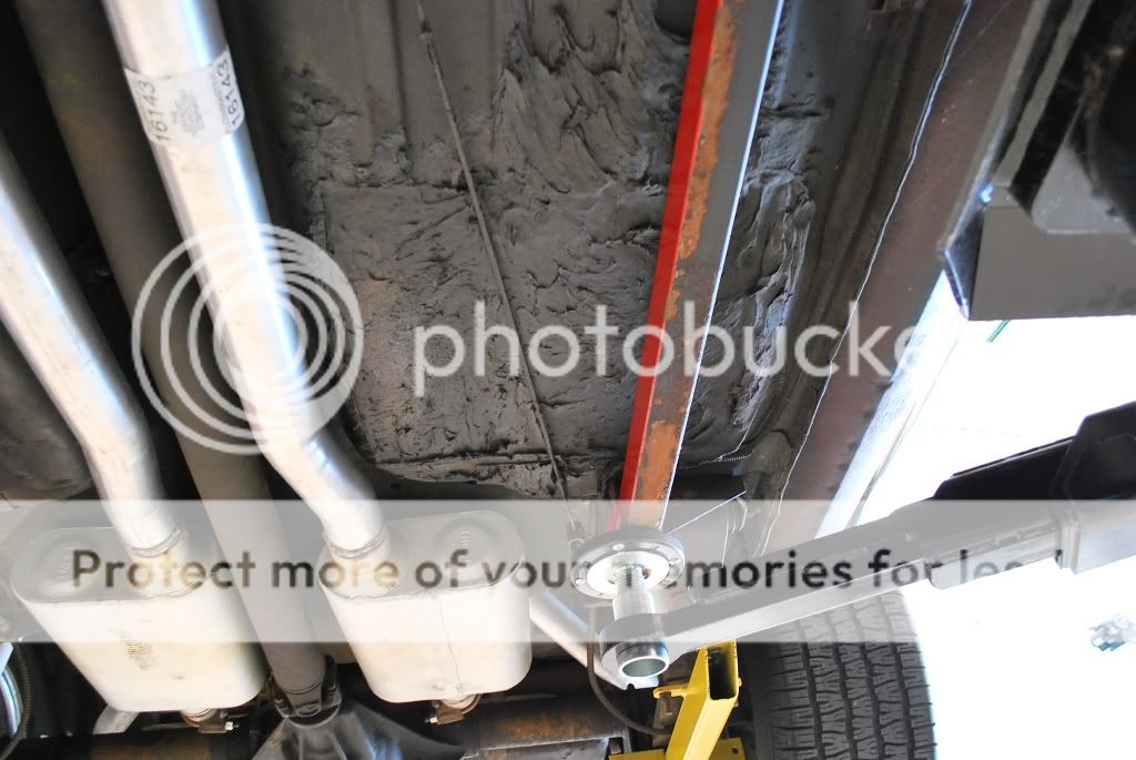

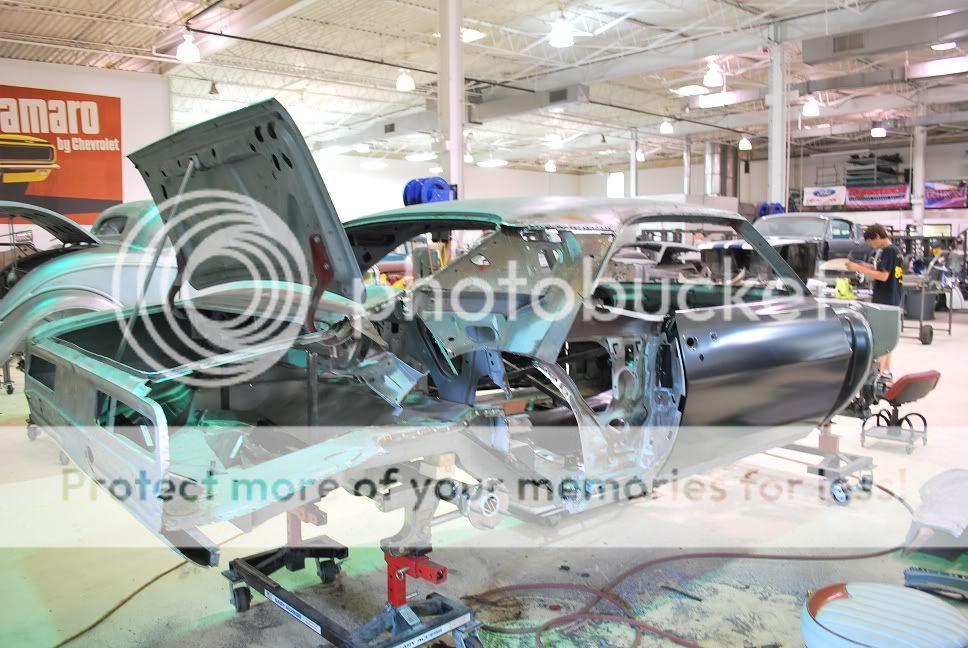

Disassembly revealed a few surprises:
Off to be media blasted

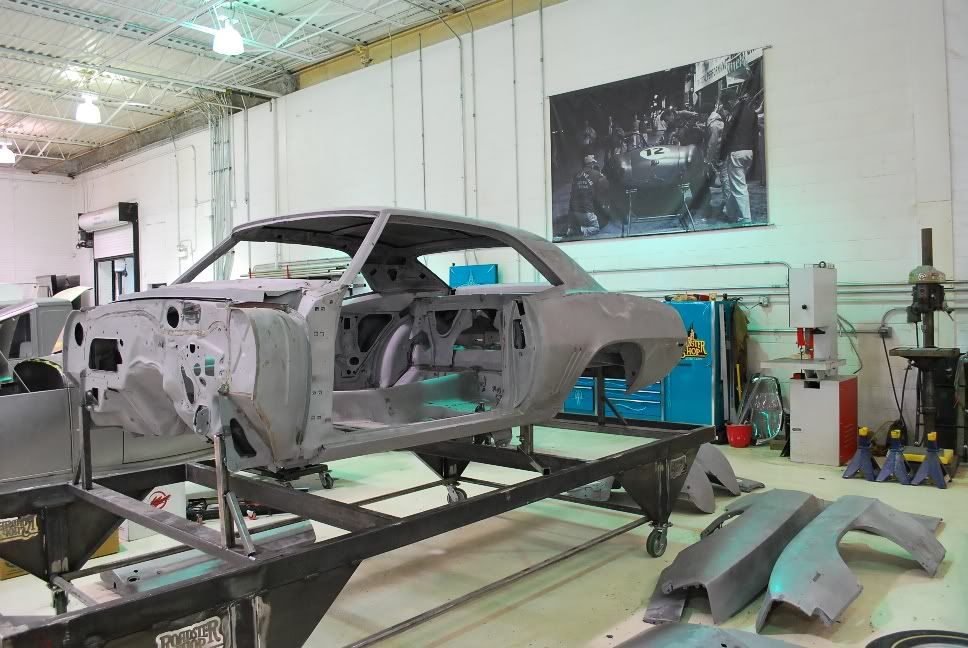

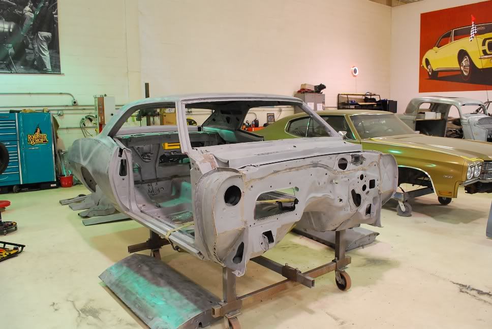

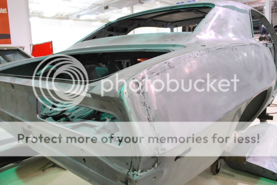

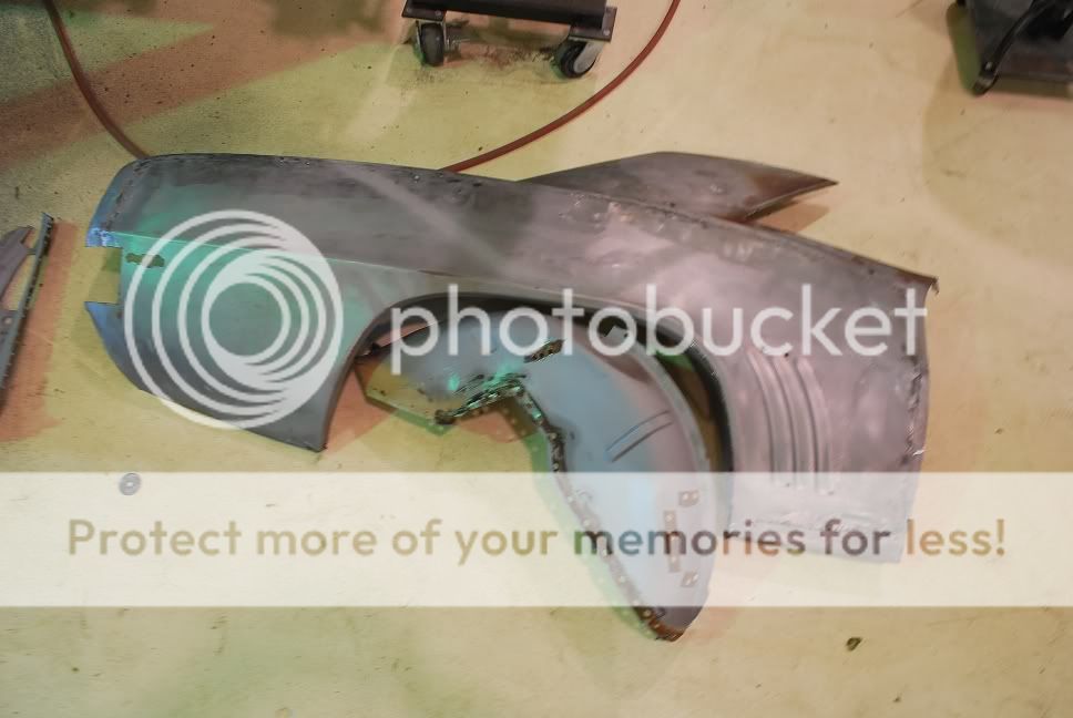

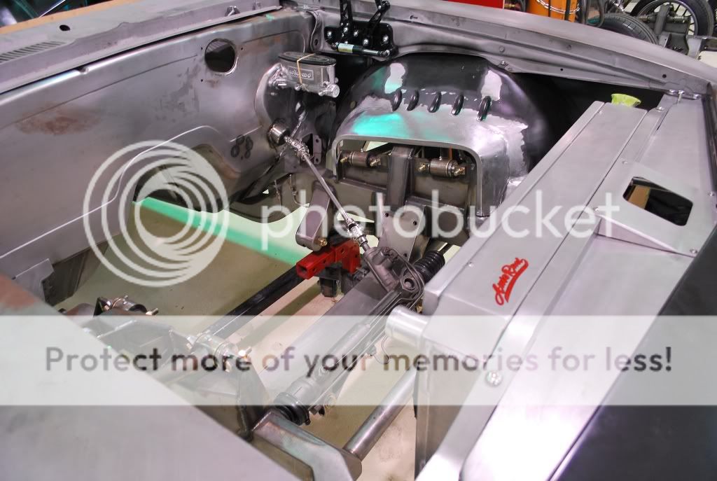

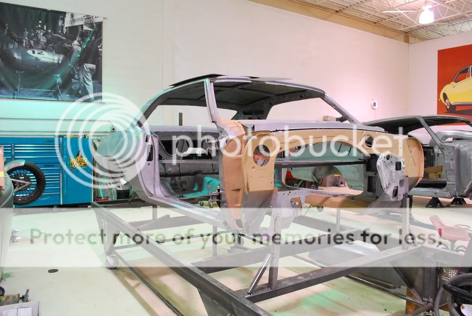

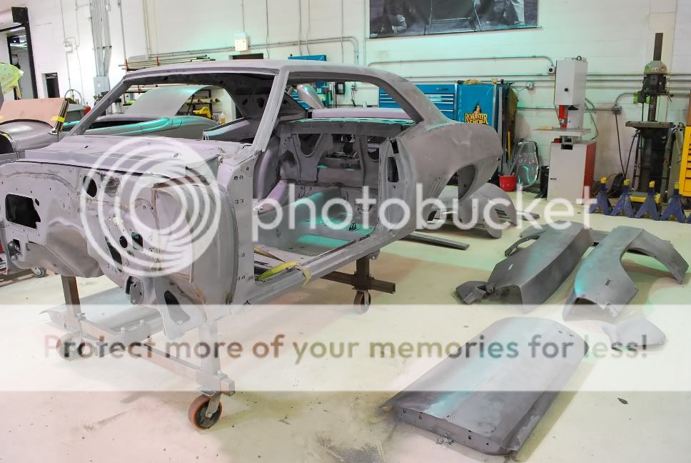

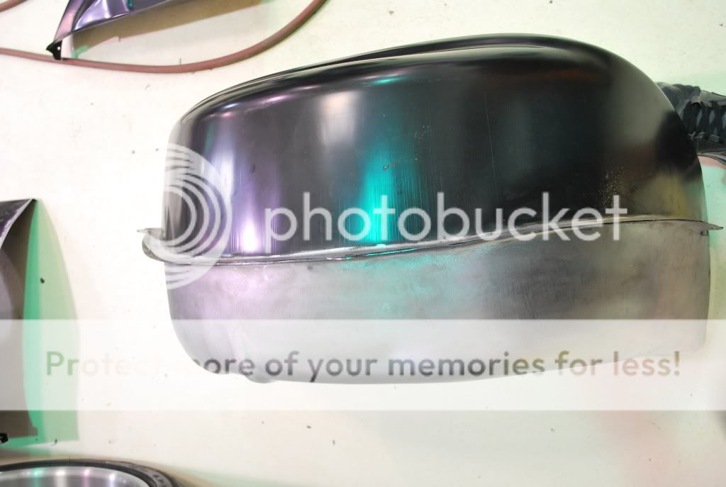

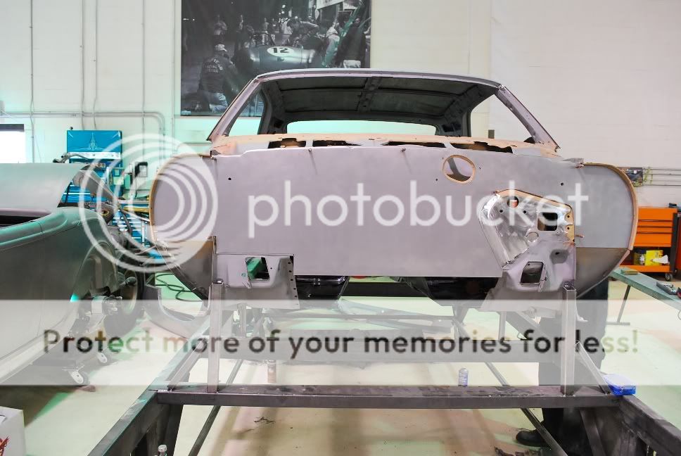

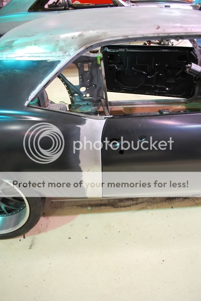

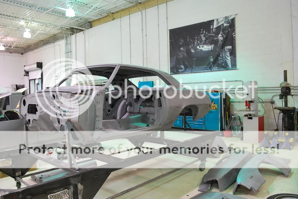

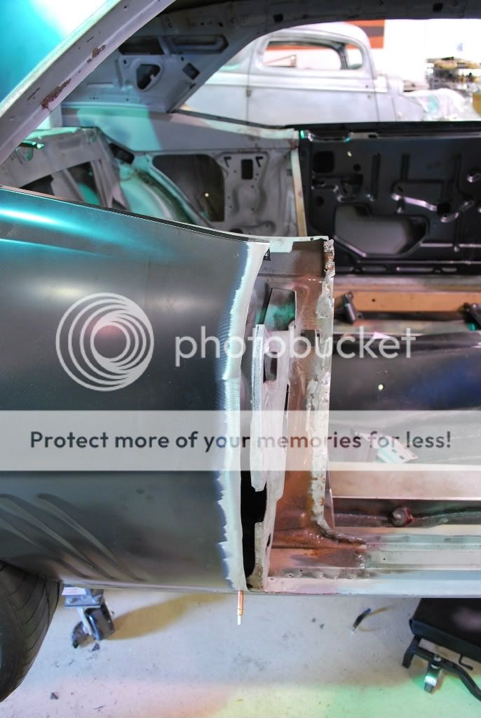

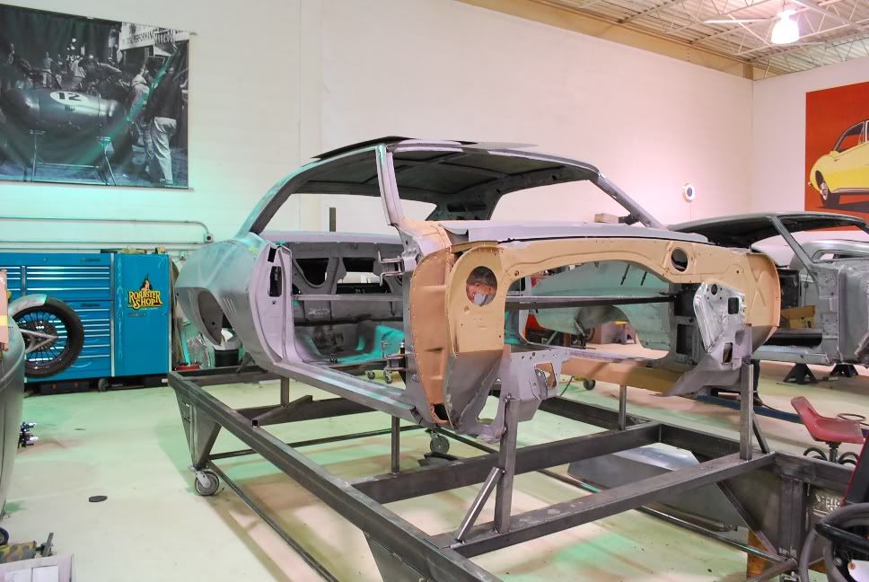

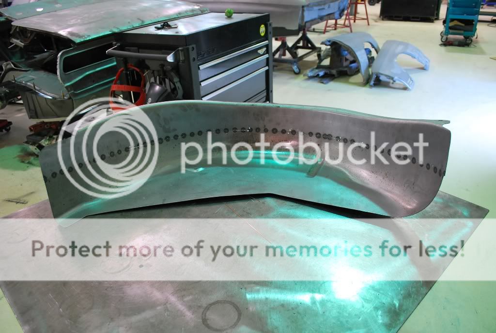

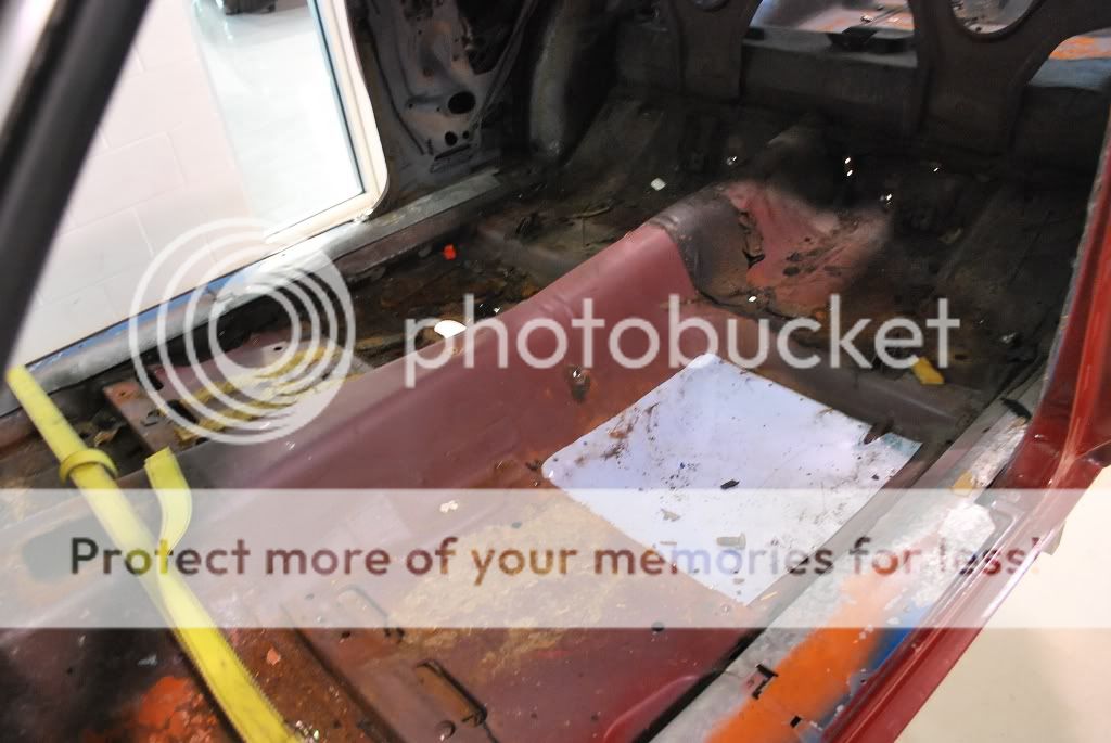

The body ended up in worse condition than we had originally thought. It was not horrible, but not great. Some one had patched the floors and did a custom quarter panel installation on both sides. The doors and fenders had some previous work as well. The car now needed floors, quarters, door skins, and lower fenders.
The body was then squared and fixtured and the panel repair began.
Floor and firewall were cut out to begin repairs.

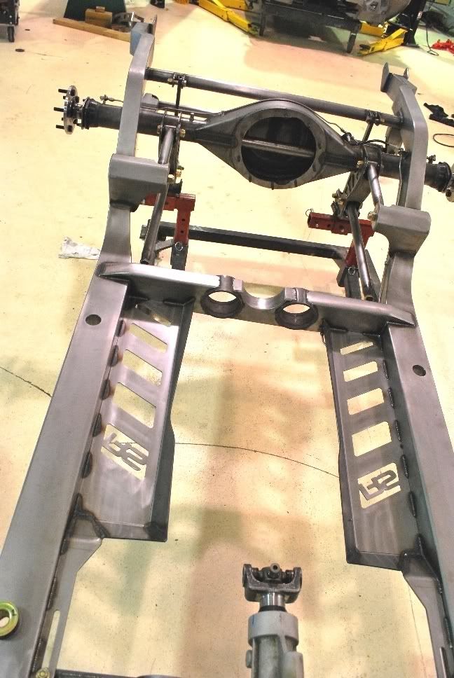

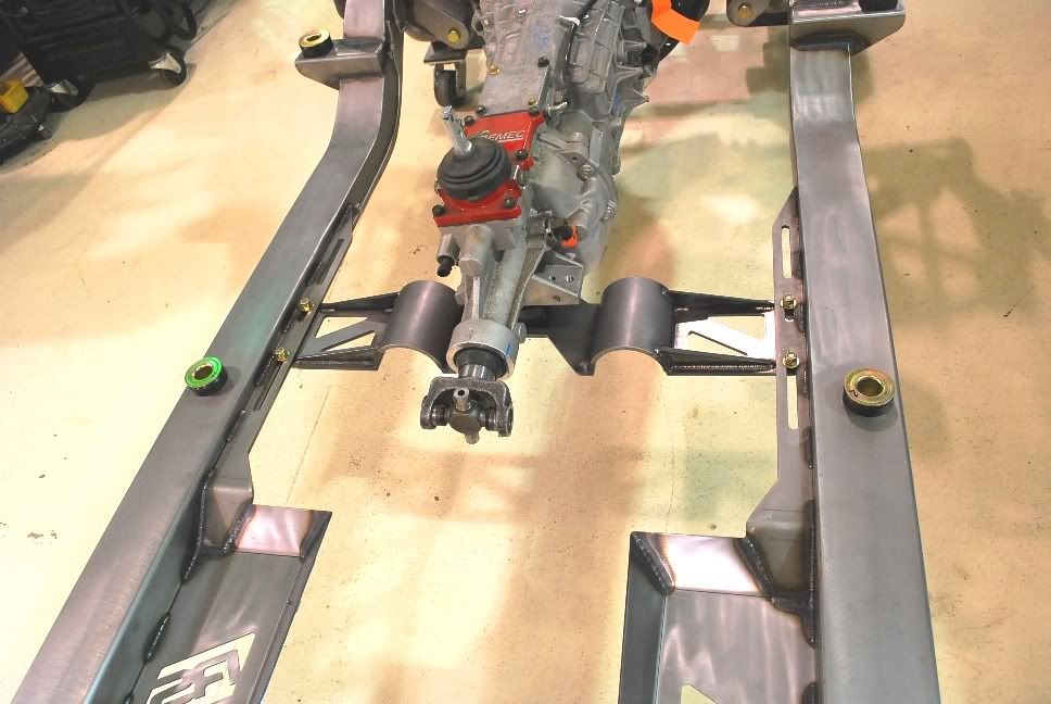

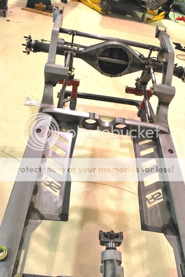

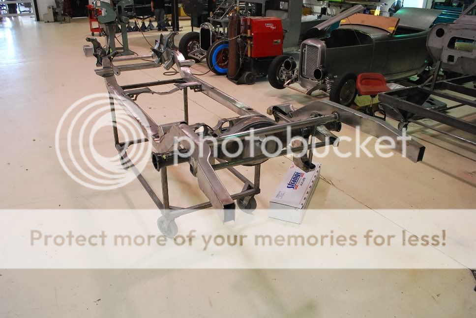

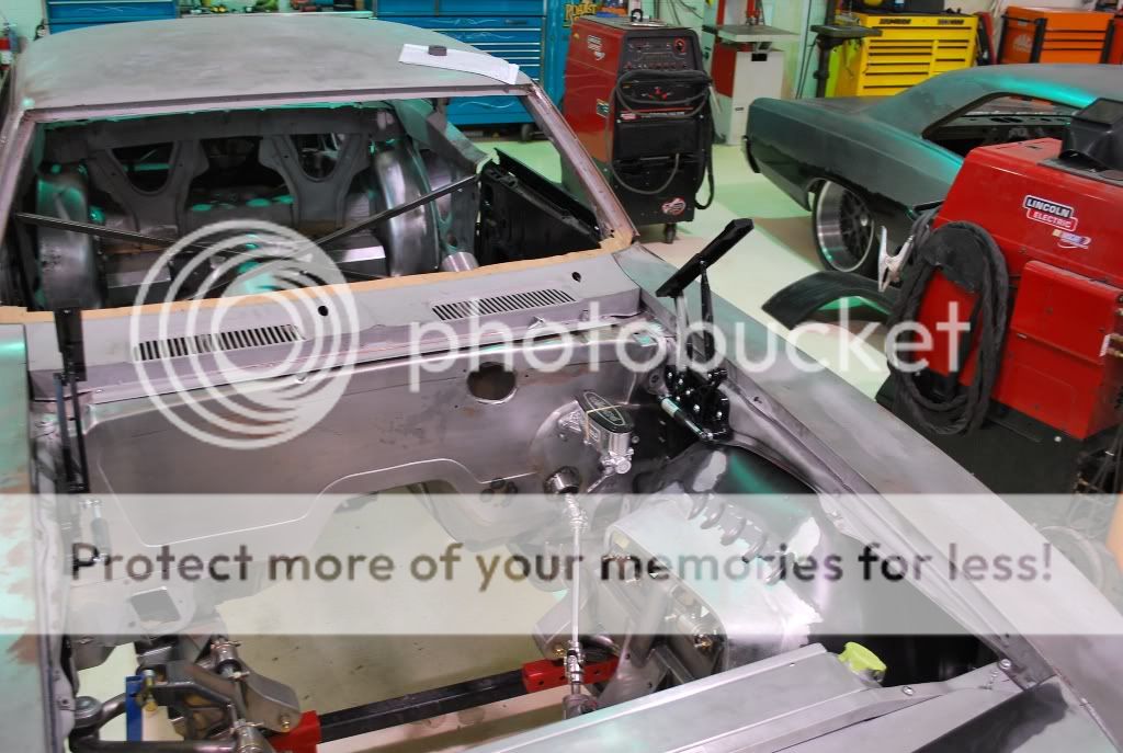

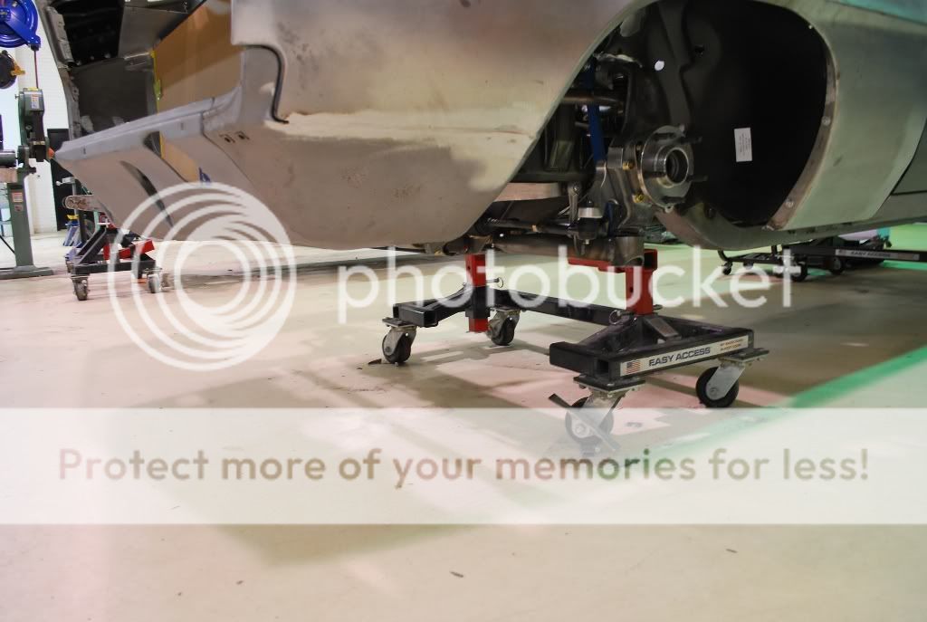

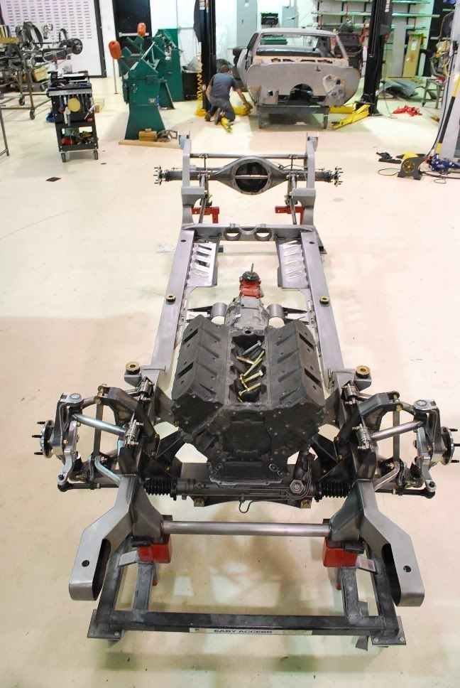

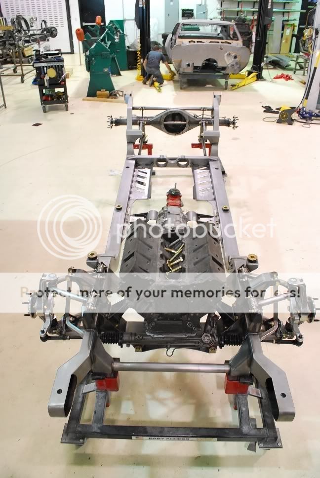

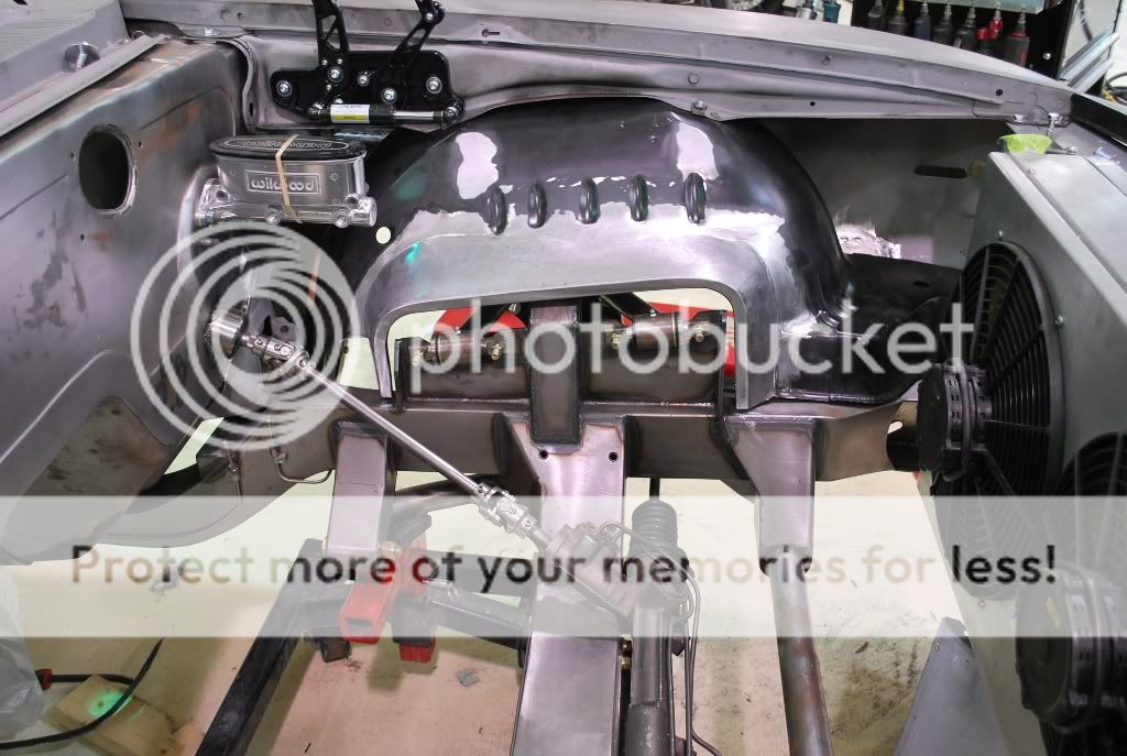

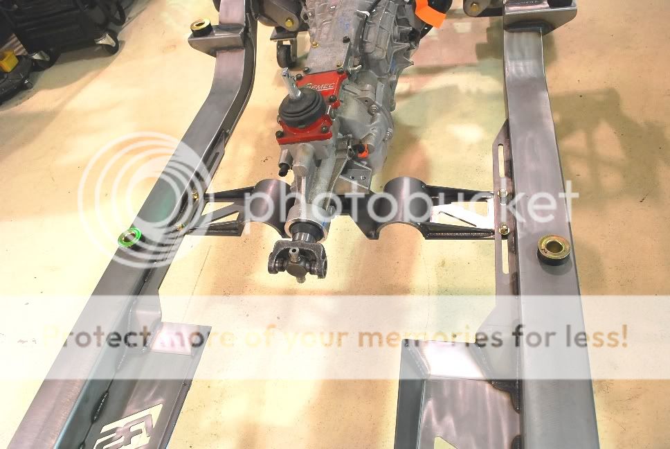

The chassis was built while we were waiting for parts to come in.
New center crossmember design that will be used on all production chassis.
New mid and side braces added in to the chassis to increase rigidity as well as add detail.

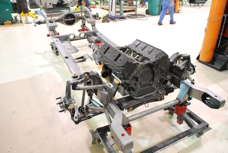

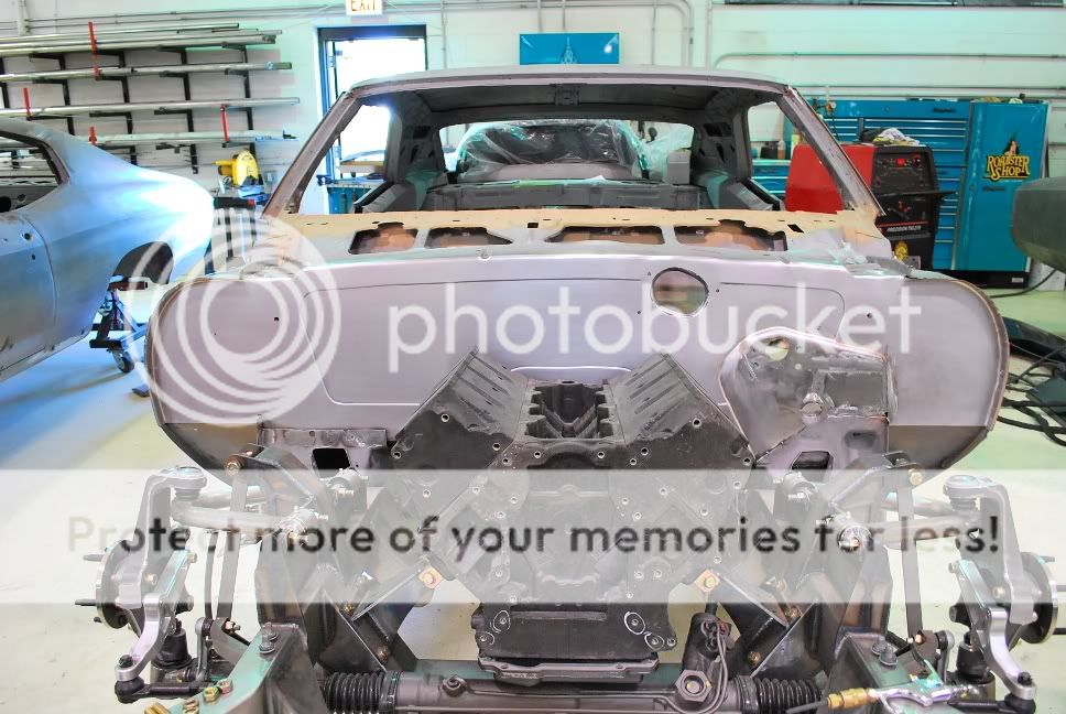

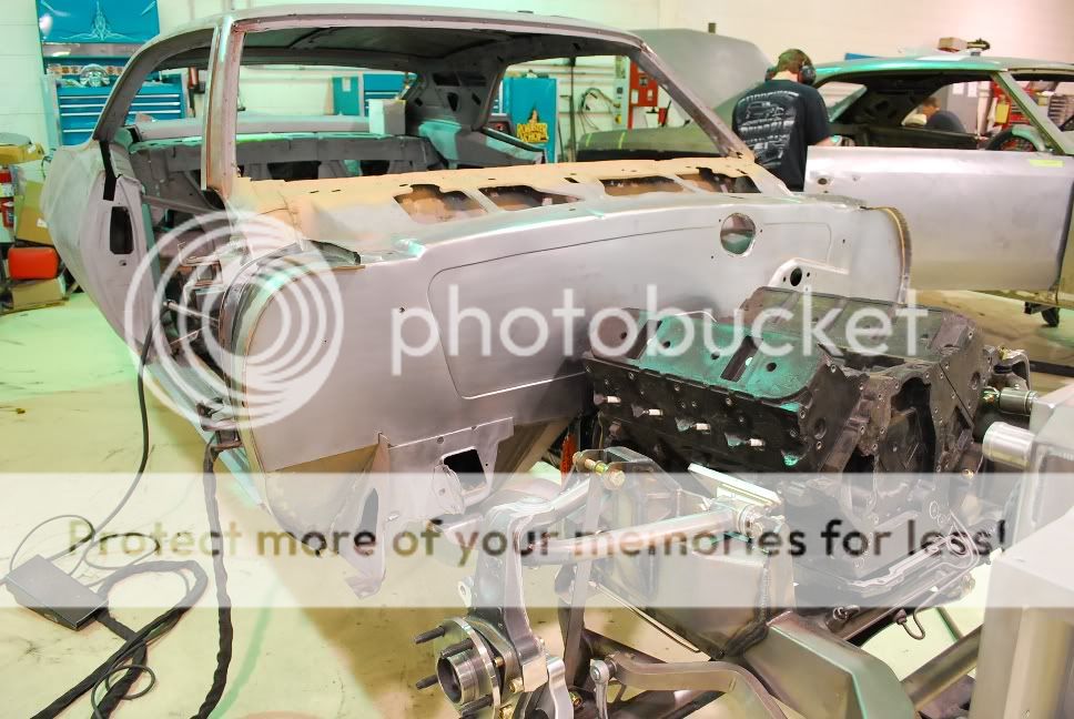

Originally Posted by garickman View Post
Would this be the same camaro I saw in the background of recently posted picture of another build? You know, the one with the Nelson Twin turbo sitting in it. Either way, I'm sure it will be another award winner.

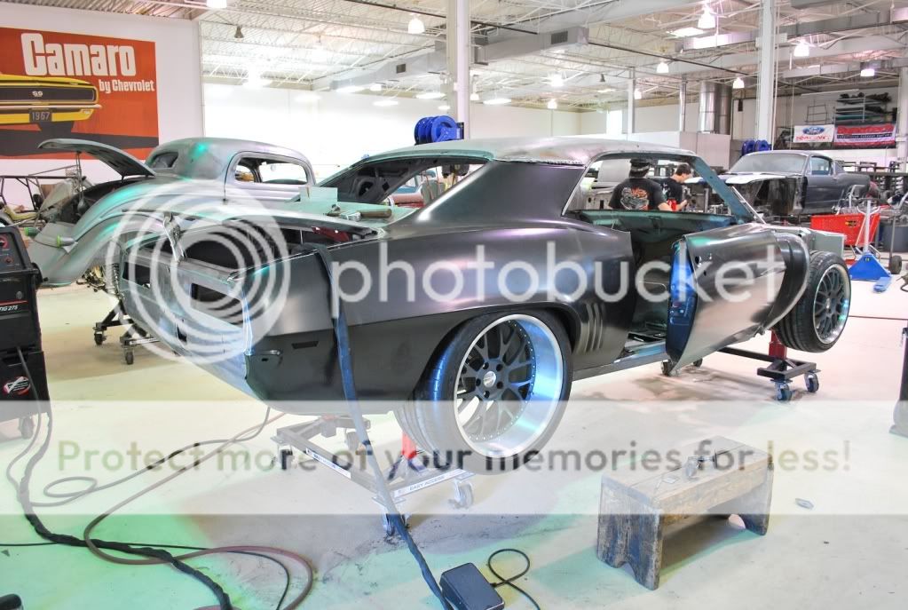

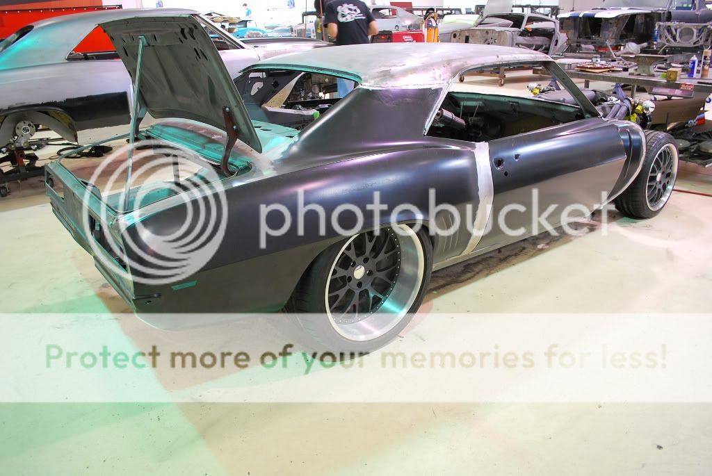

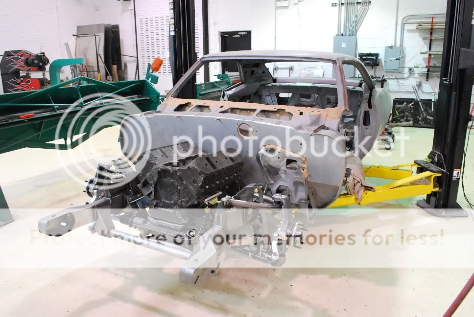

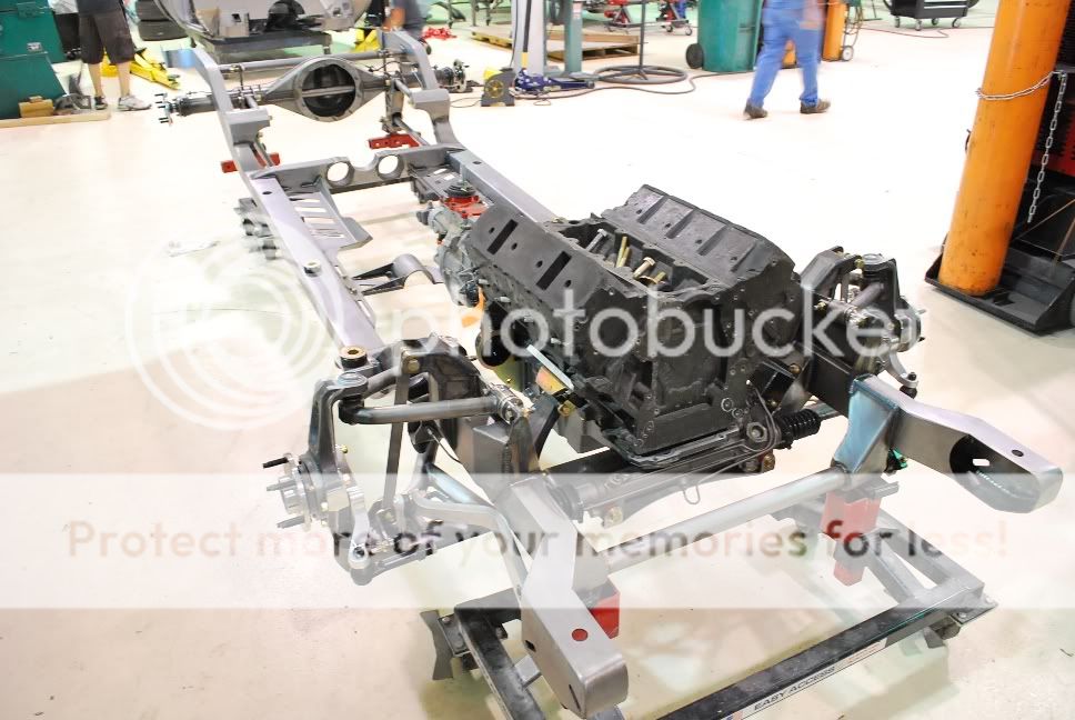

This is the same car that you saw with the Nelson motor in it. But, the motor is not actually going in this car. We are building another 69 Camaro with that 572 twin turbo Nelson motor in it. We are just starting the chassis and wanted to fit the motor in this Camaro to see if any changes would need to be made to the chassis or cross members for the motor and turbos to clear.
We also have a 1,300 + HP Nelson twin turbo small block in the show room that is going in a 2nd gen shortly.
