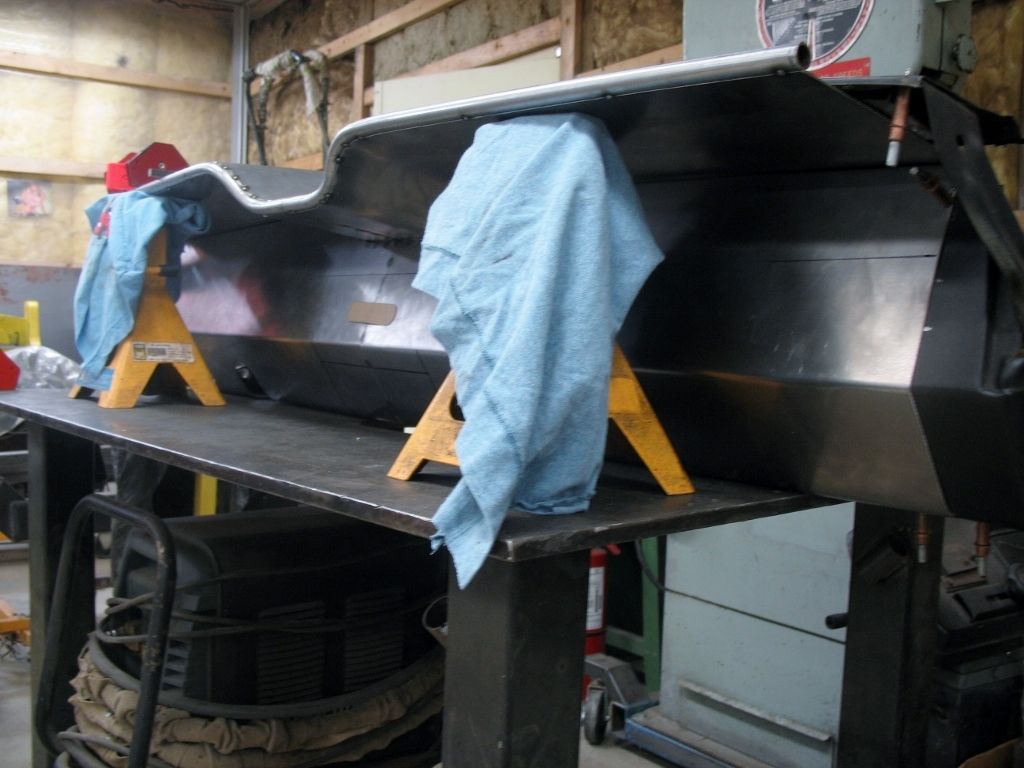

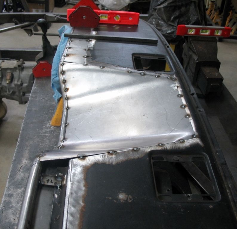

HPIcustoms 01-23-2015 11:51 AM

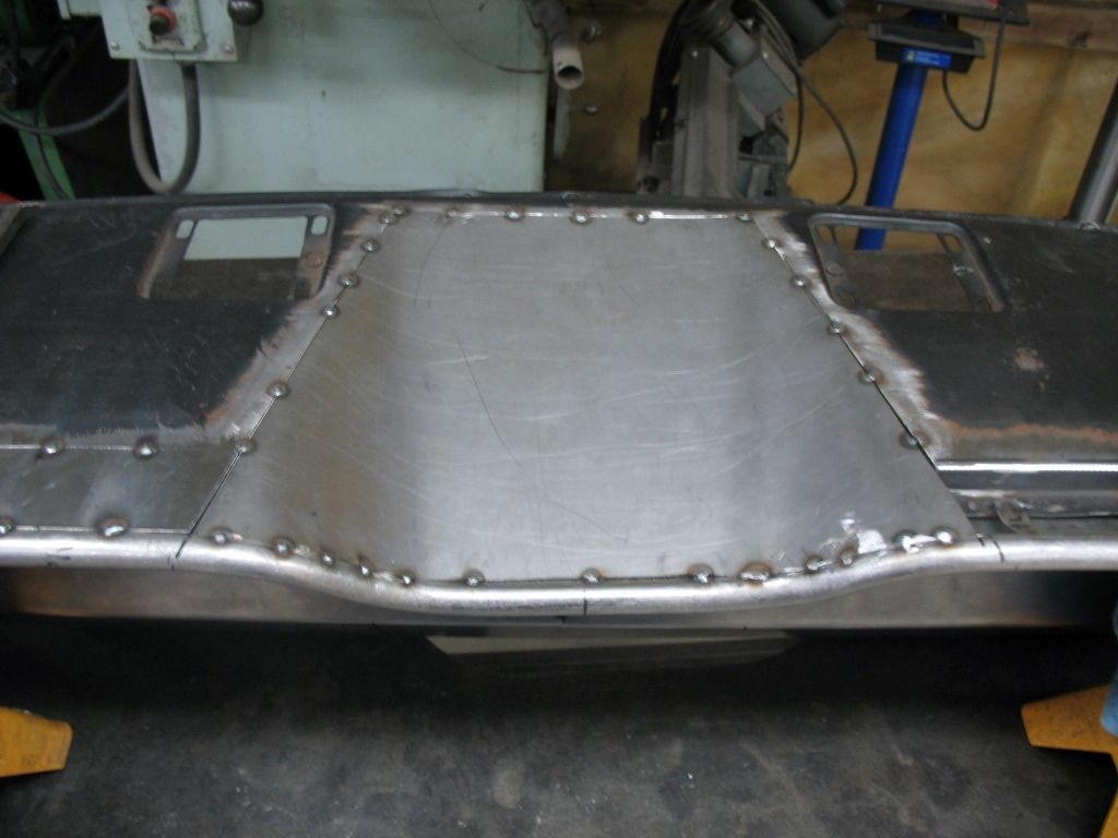

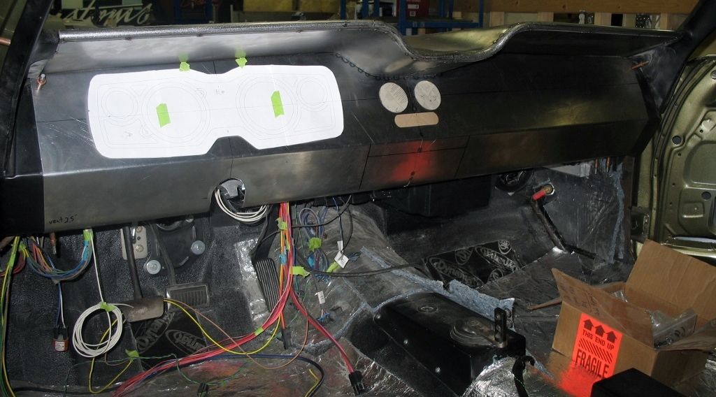

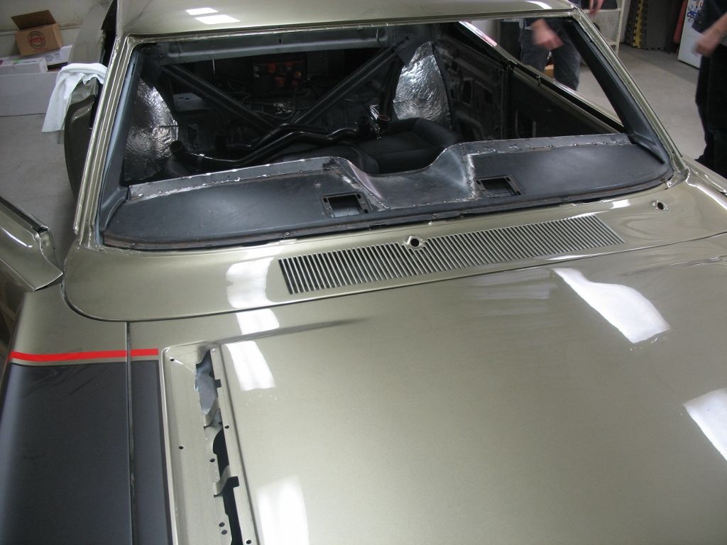

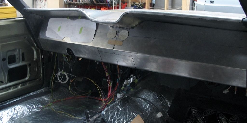

How's this for the start of a sexy dash.
http://i1204.photobucket.com/albums/...psdnwpun6h.jpg
http://i1204.photobucket.com/albums/...psb8adnbov.jpg
http://i1204.photobucket.com/albums/...psisrk5v0u.jpg
http://i1204.photobucket.com/albums/...ps8pev5xhp.jpg

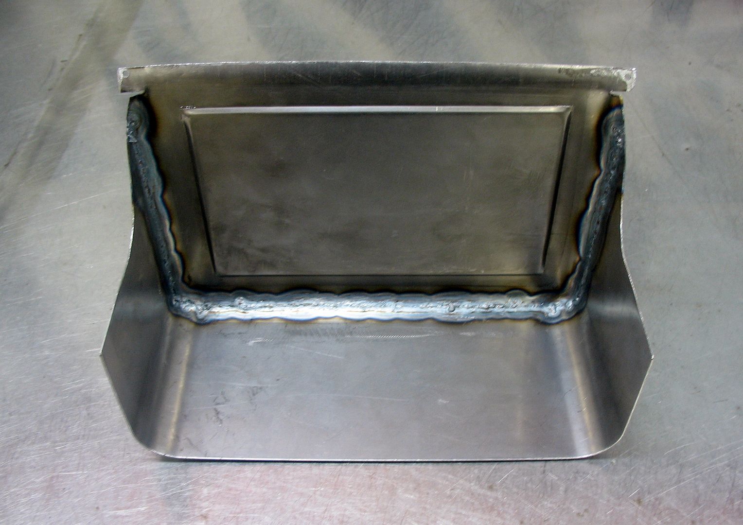

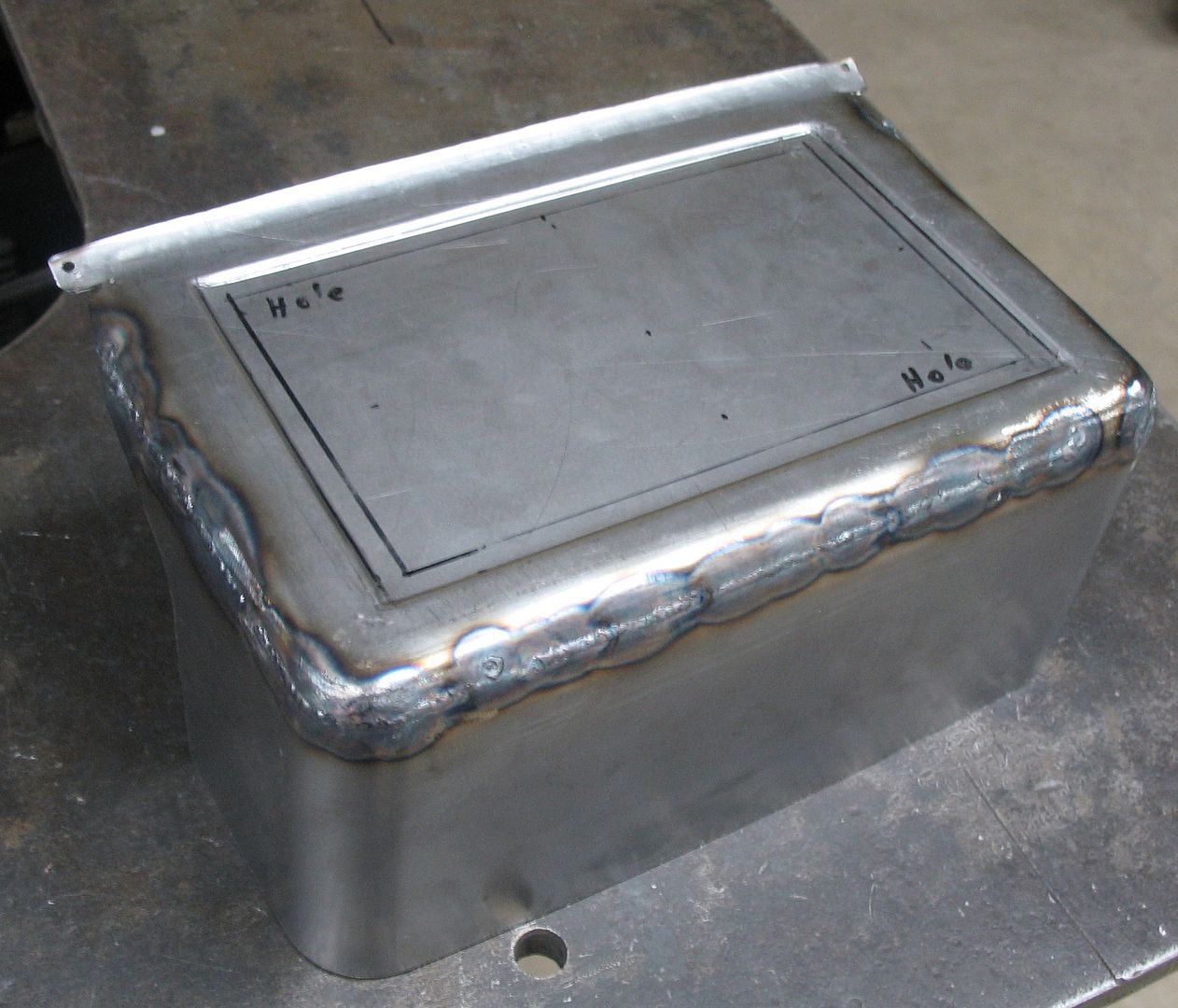

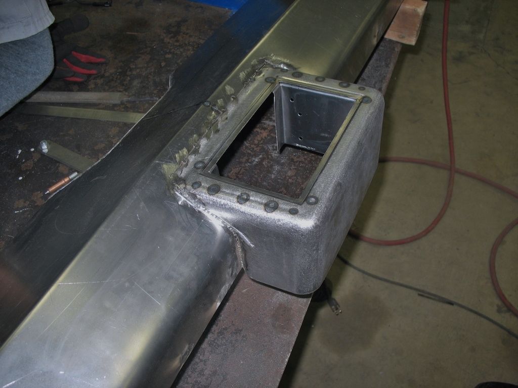

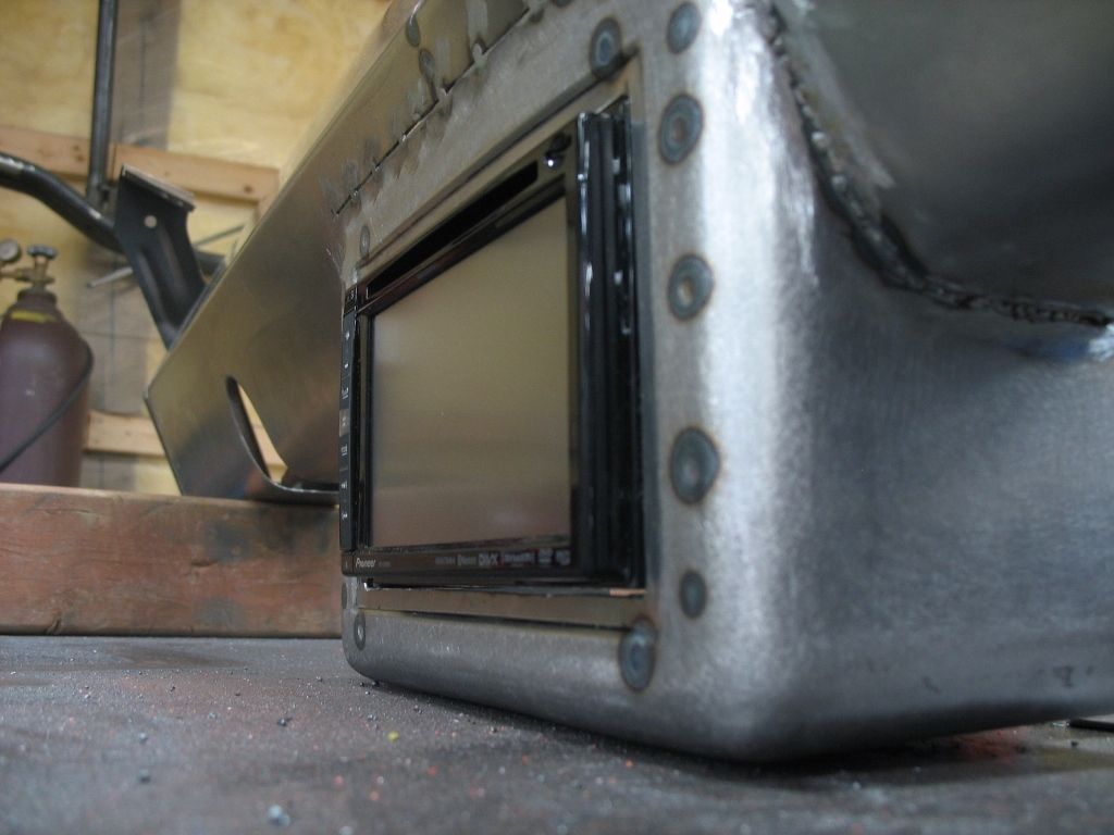

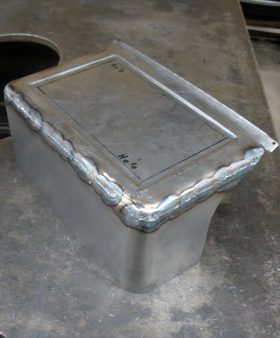

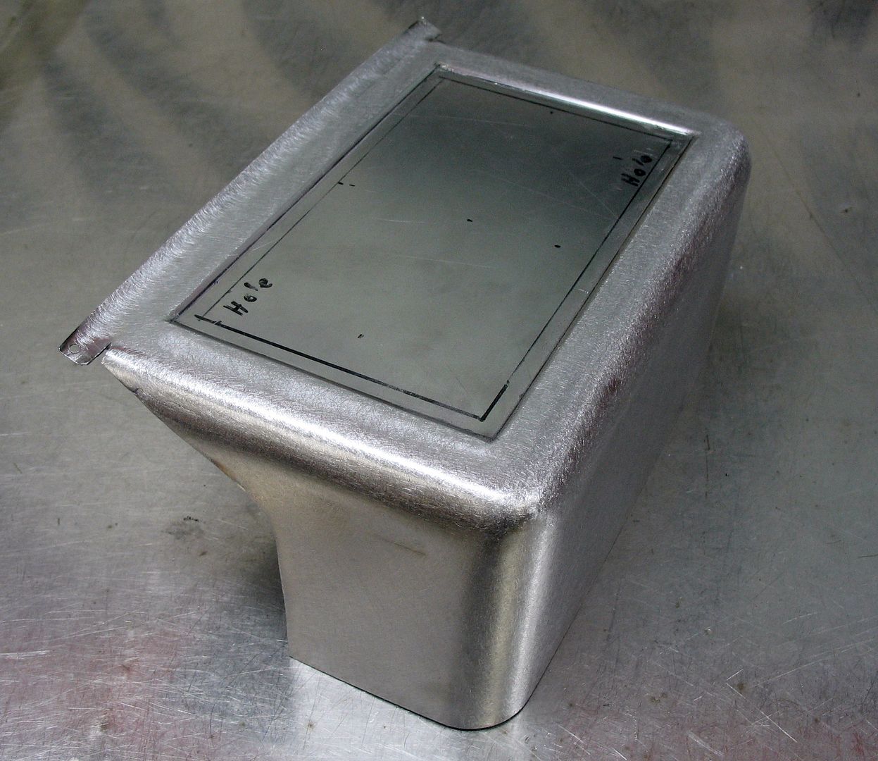

Custom fabricated box that will house the Pioneer double DIN head-unit. Made from two pieces and compound cornered 100% with the Mittler Brothers bead-roller.
http://i1204.photobucket.com/albums/...psl8wwl9ls.jpg
http://i1204.photobucket.com/albums/...psoalidhkt.jpg
http://i1204.photobucket.com/albums/...psp1vrzzna.jpg
http://i1204.photobucket.com/albums/...psxuzw3pal.jpg
http://i1204.photobucket.com/albums/...psaqi9gjyq.jpg
HPIcustoms 01-27-2015 02:48 PM

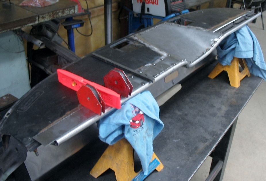

TIG welding the dash hood.
http://i1204.photobucket.com/albums/...psg7rh3qmo.jpg
Double DIN head-unit hole cut, head-unit brackets fabricated/ installed and box welded in.
http://i1204.photobucket.com/albums/...psx6ai5qbw.jpg
preston 01-27-2015 04:08 PM
I like the radio box.
>Made from two pieces and compound welded 100%
What does compound welded mean ?
I assume you formed the indent with the beadroller, then rolled the edges over with a hammer before welding it to the rest of the box. Be interested if you had some other way of forming the indent. I guess you might have also hammer formed that using some wooden die pieces or something also.
HPIcustoms 01-28-2015 07:42 AM
We love it to, looks sharp and clean, looks like it belongs there and no added as an afterthought.
And good catch, that was a multi-tasking post mistake by me.
It's a compound cornered piece out of two sheets and TIG welded together along with custom bent/ rolled brackets inside to hold the stereo in place.

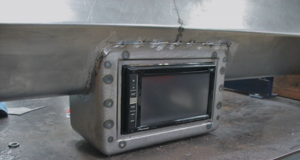

HPIcustoms 01-28-2015 07:54 AM

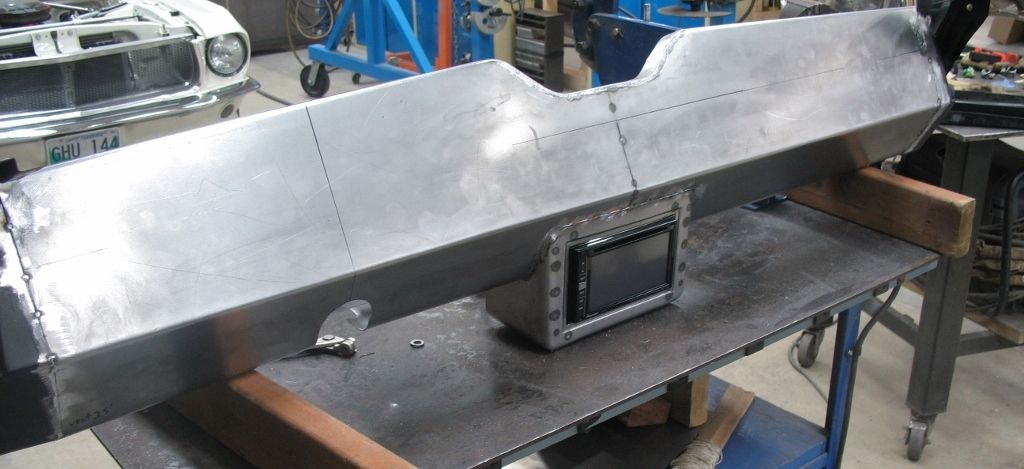

Pioneer double DIN mocked into the dash. Clean and simple.
