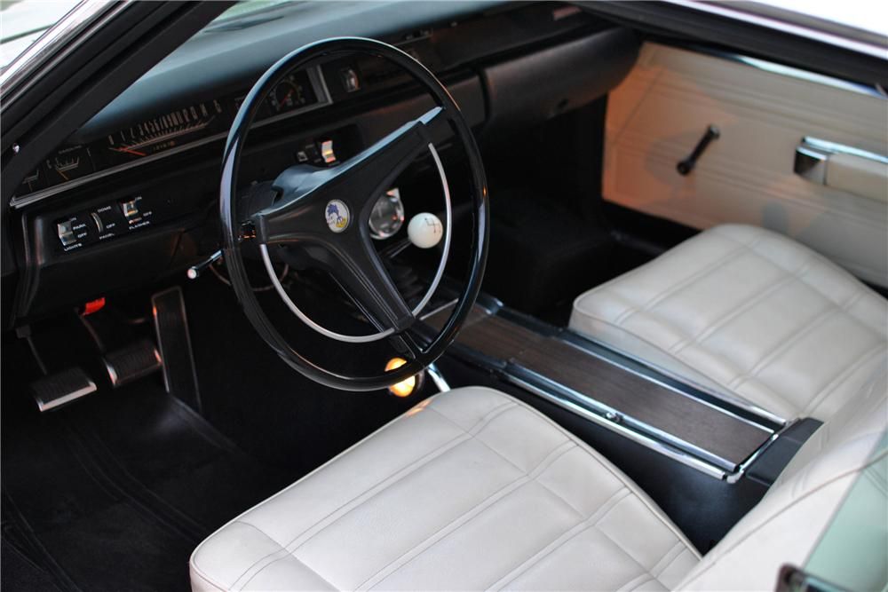

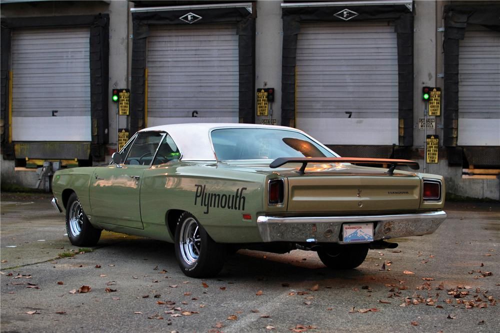

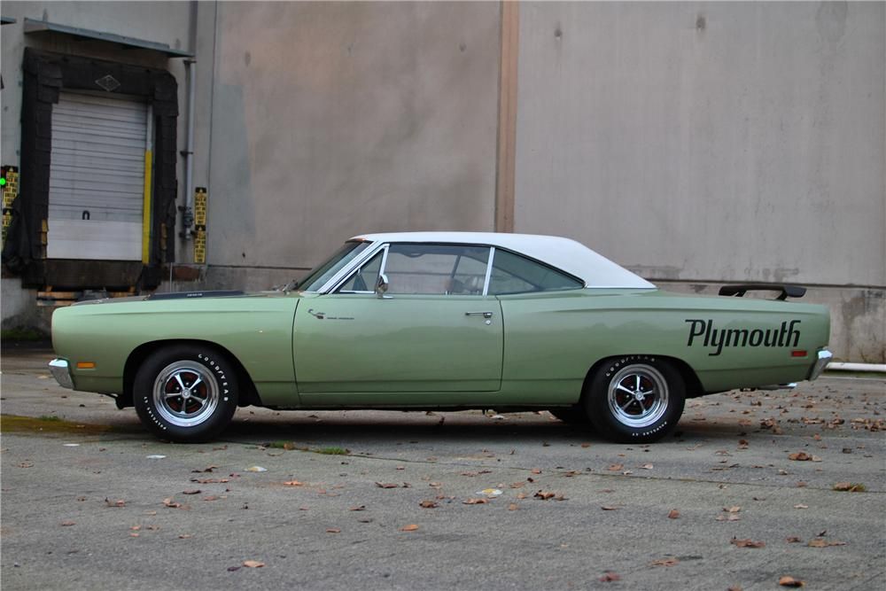

HPI Customs does a Mopar! One of our customers picked up this 69 'Runner at Barrett Jackson Scottsdale last year...... not so nice. Again.
Here is the glamor shots of when he got the car. Before we looked close.

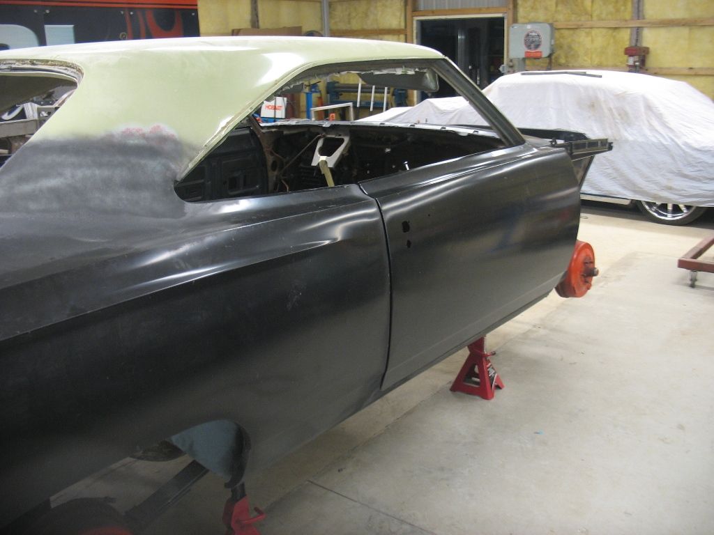

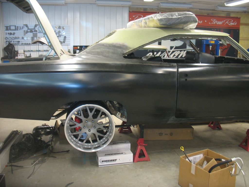

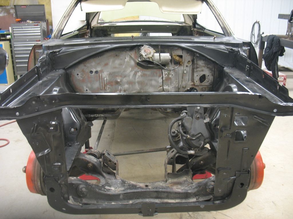

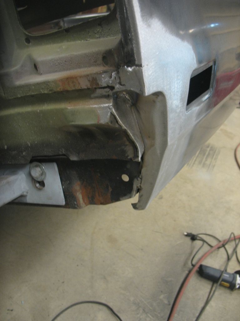

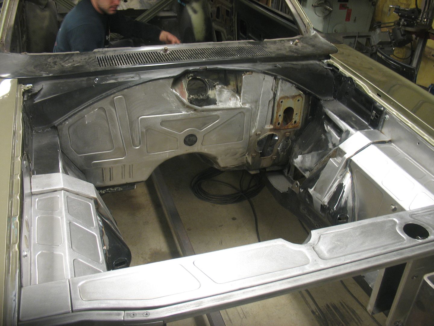

So we were pretty busy with our move and didn't have time to start rust repair for 6 months or so on this project, so he got another shop to do the panel replacement. (Long story, didn't wait for us) Unfortunately, it was a bit over their head and the job was lacking a bit, so we have to pick up the pieces there but none the less, its time for the build.
Pretty much just the roof and pillars, rear deck panel, trunk lid, and tail panel are left from what he bought. The rest is replaced. Since it will never be a perfect restoration and it was only a 383 etc, (and we are not big fans of stock) we decided to just have some fun with it!
The plan was just to do a driver, so the budget didn't let us start with renderings etc, but it has evolved since. Please excuse the messy unfinished new shop in the background of these pics.

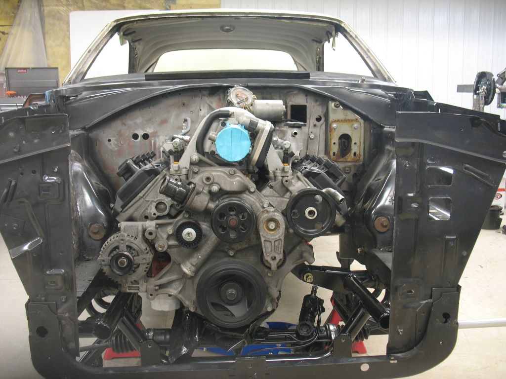

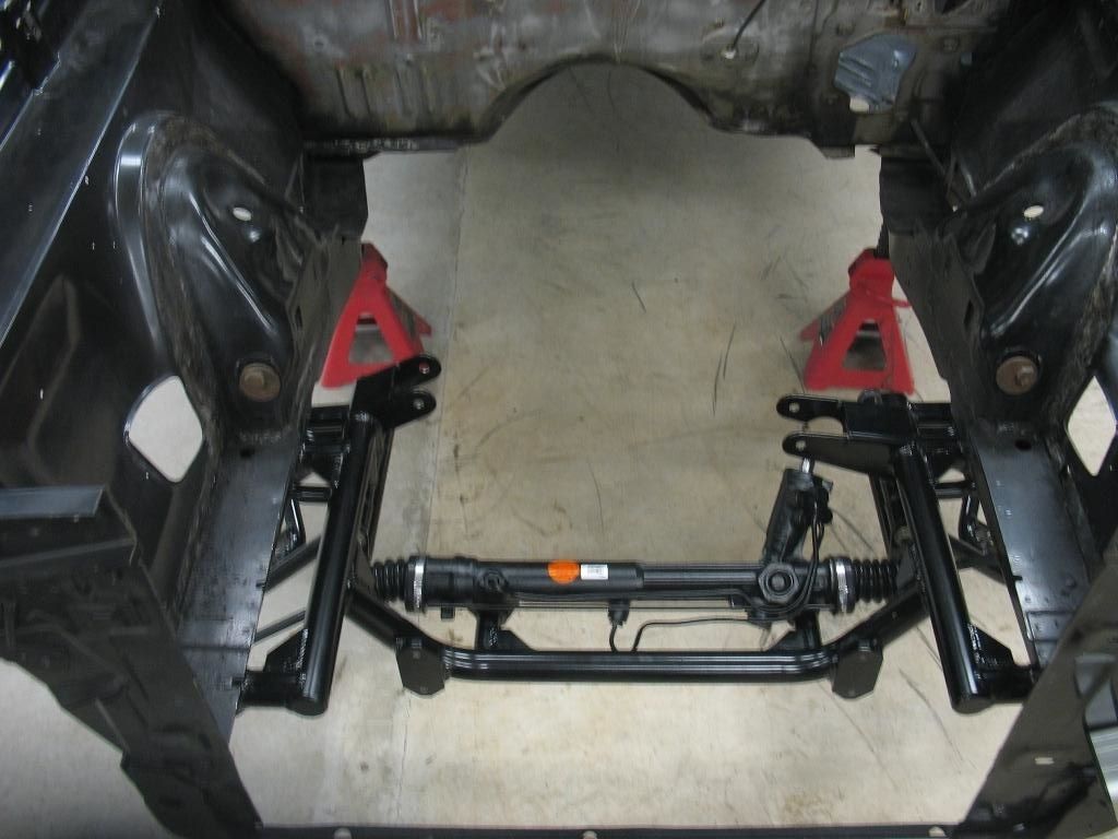

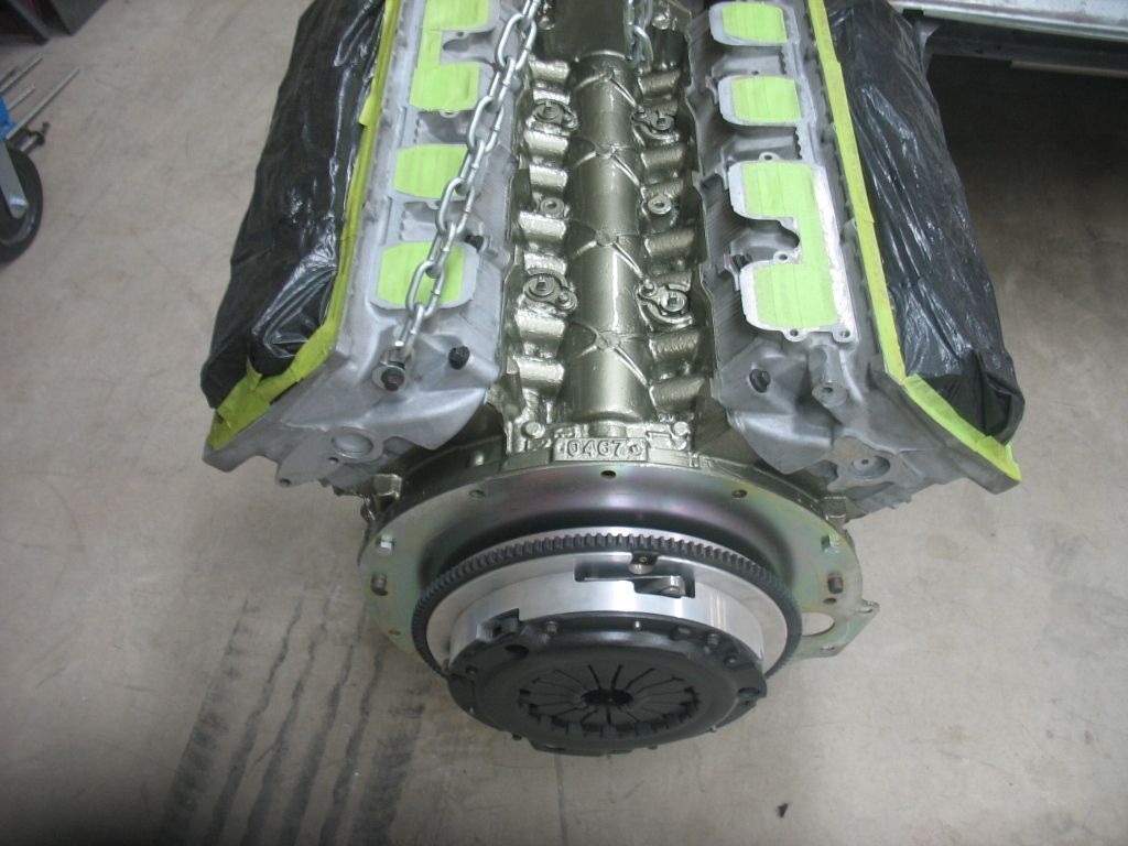

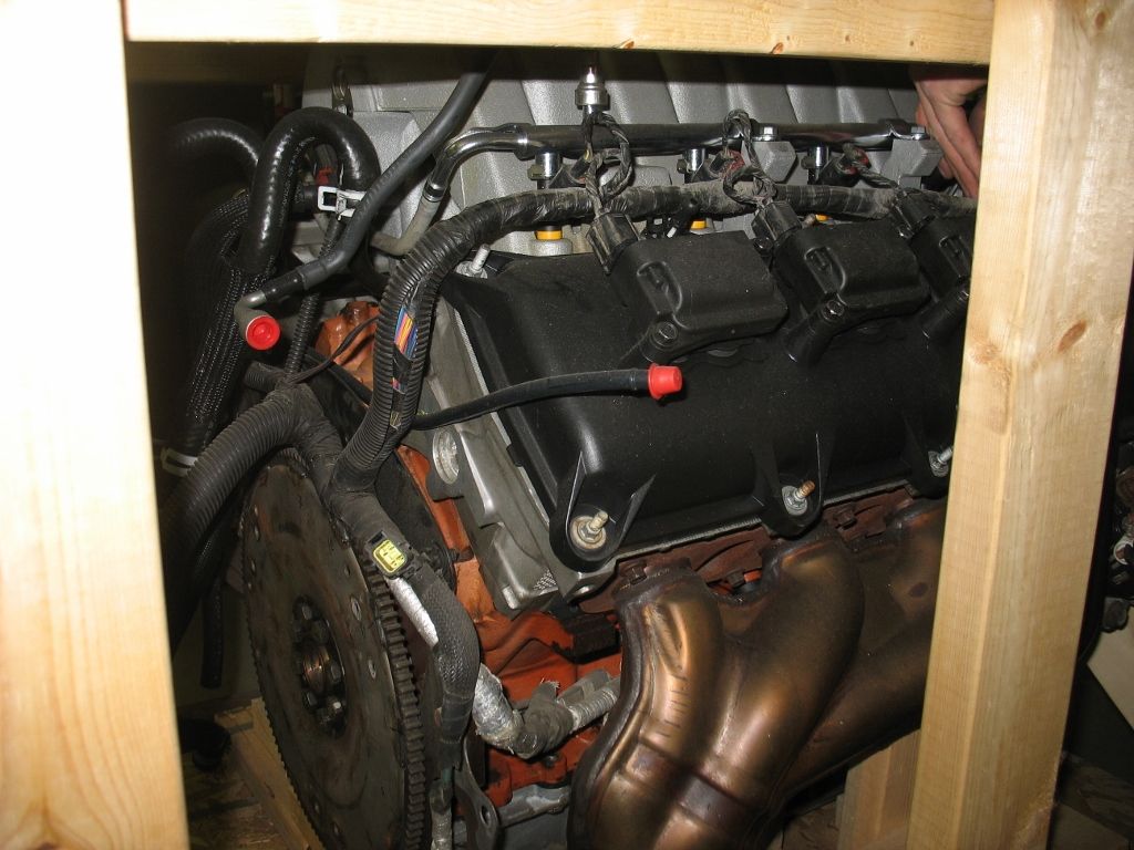

Car has now got a 6.1 Hemi, American Powertrain T56 Magnum kit, dual clutches, lightweight flywheel, oh and did I mention twin STS turbos??? Something fun we wanted to try. I know its not as glamorous as front mounted hair dryers, but still fun.

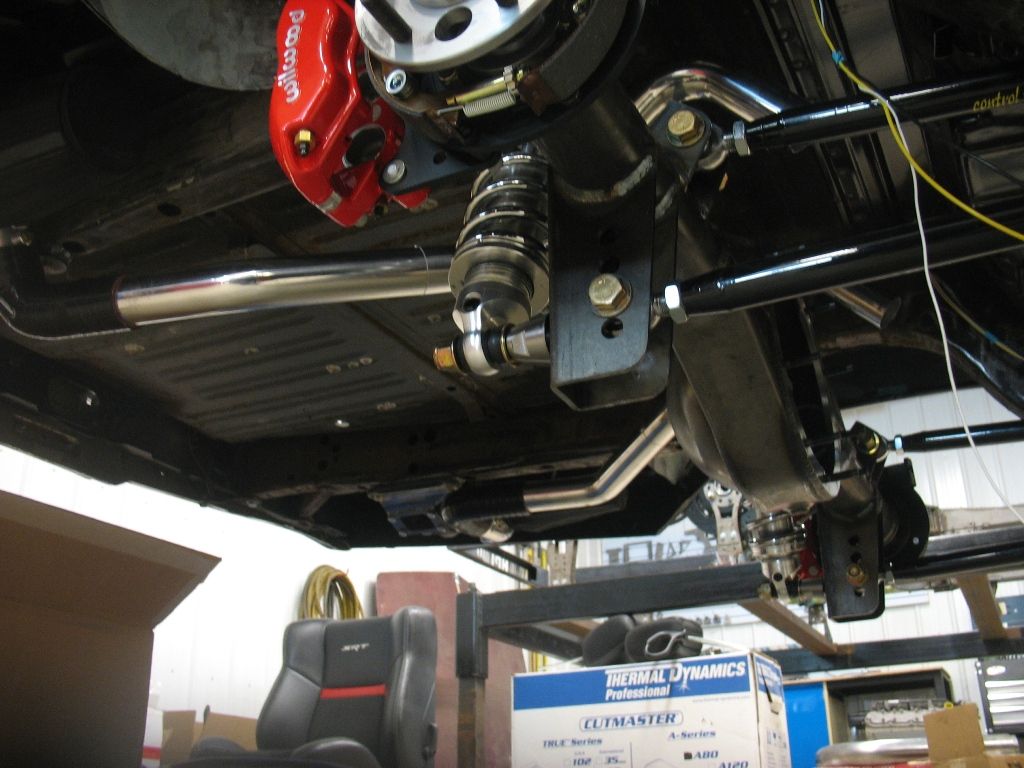

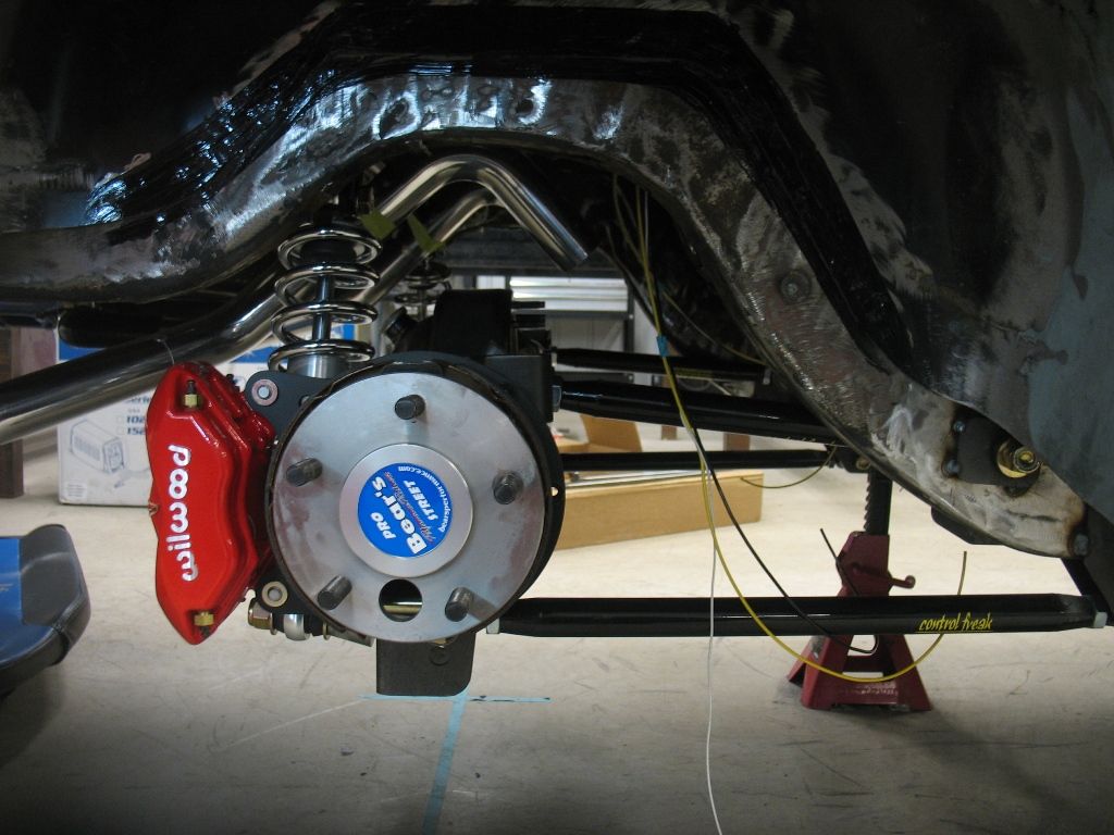

Suspension is Control Freak all around, we are now dealers for their stuff and let me tell you, if its not a GM and you need suspension, this stuff is a pretty nice option. The fit was great and they are nice to deal with.

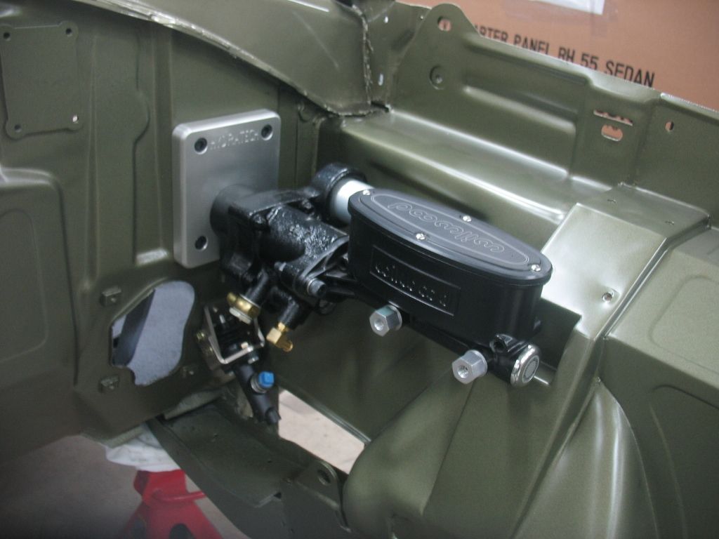

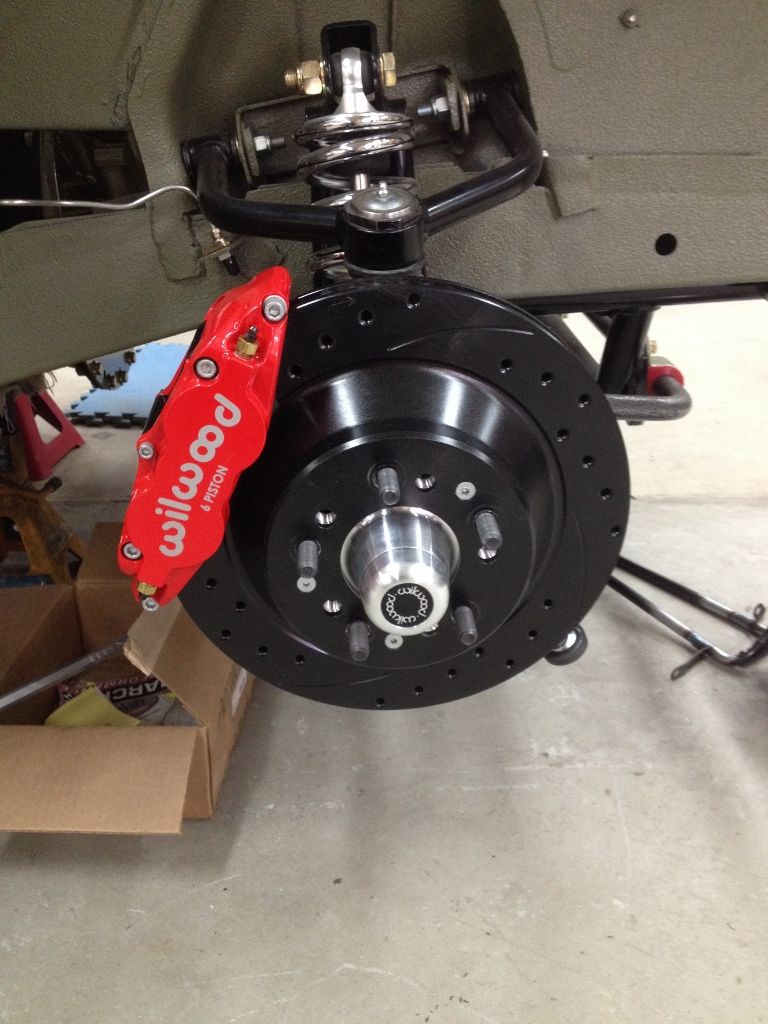

Entry level Wilwood Dynapro brakes, car will have 18 x 12s in the rear and some killer rubber.

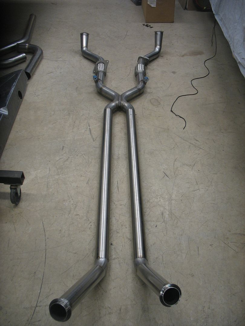

Old 01-24-2013, 09:29 PM
64pontiac 64pontiac is offline
Join Date: Apr 2008
Location: Manitoba, Canada
Posts: 631
Tyler
HPI Customs
Manitoba, Canada
www.hpicustoms.com

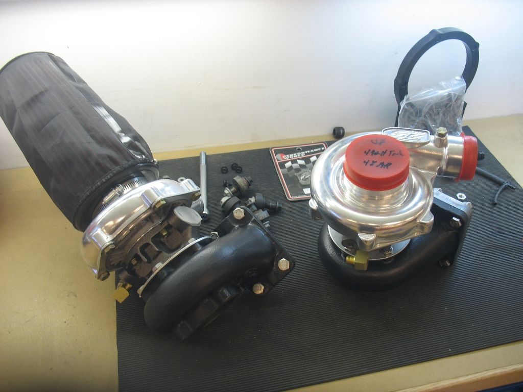

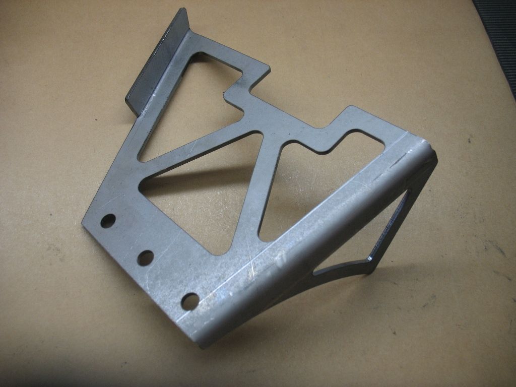

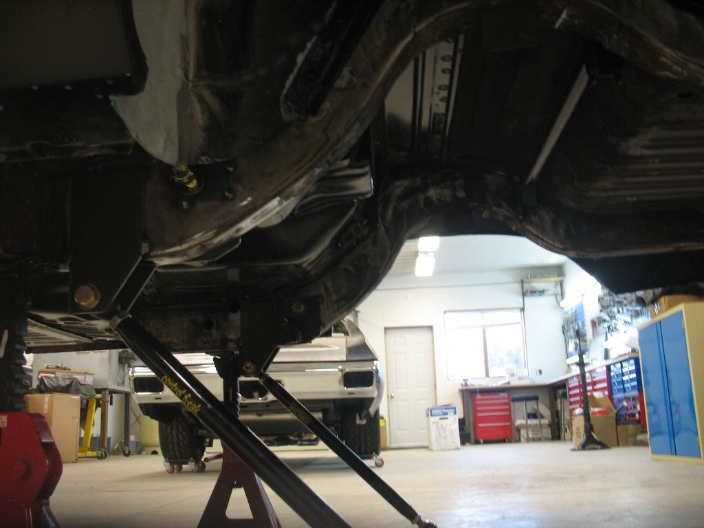

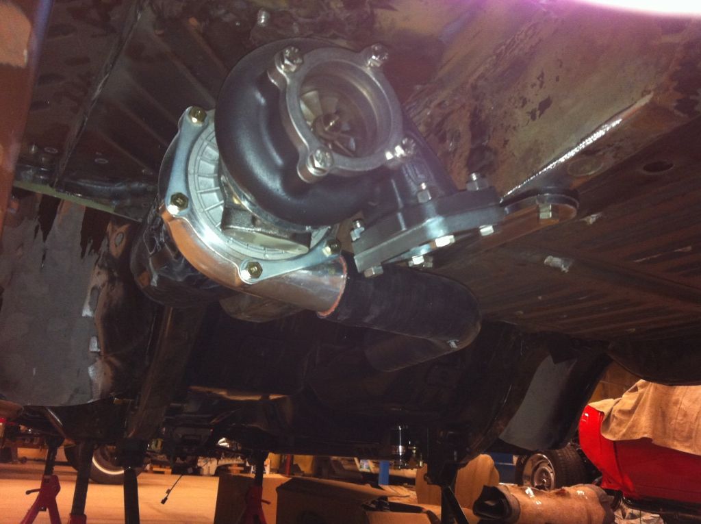

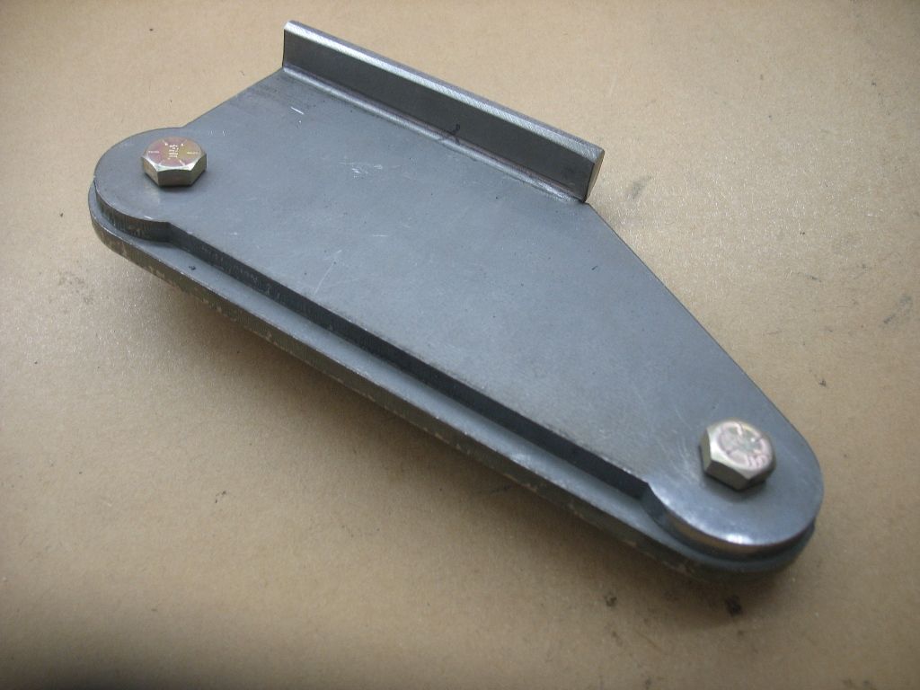

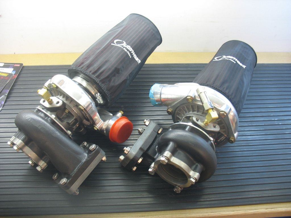

More:
Turbo mounts
Trunk braces for minitubs
our new AAW mount
Tyler
HPI Customs
Manitoba, Canada
www.hpicustoms.com

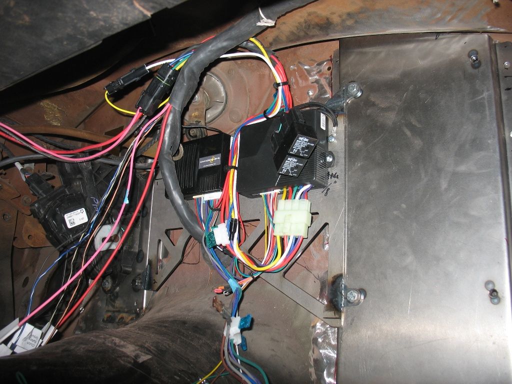

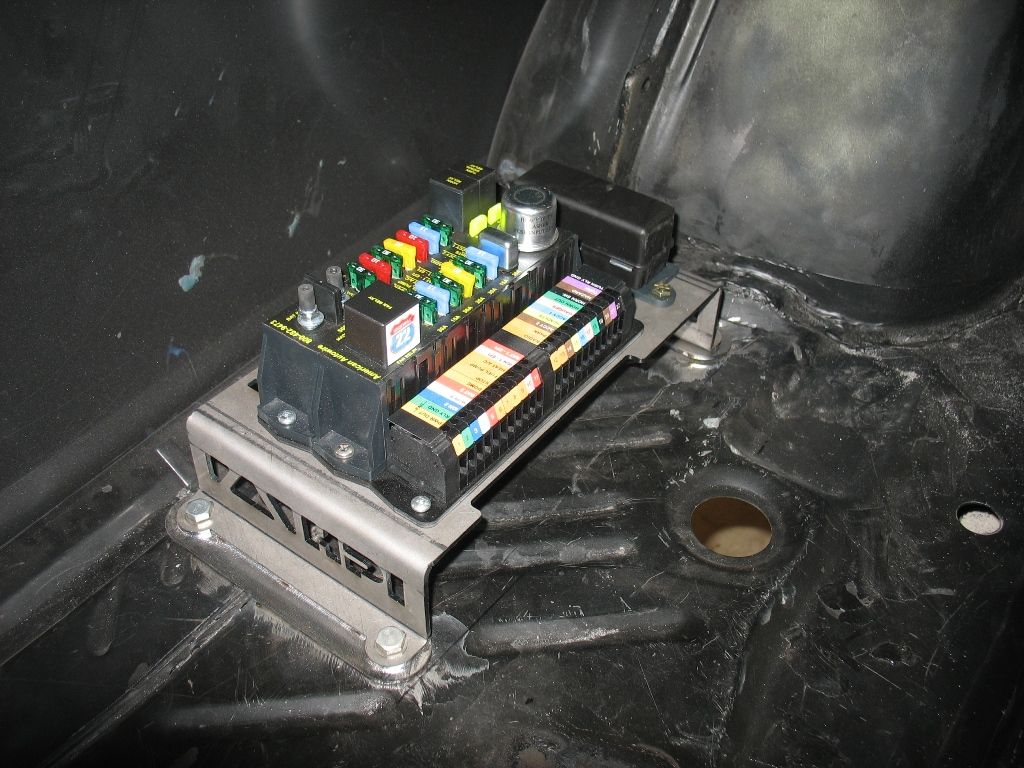

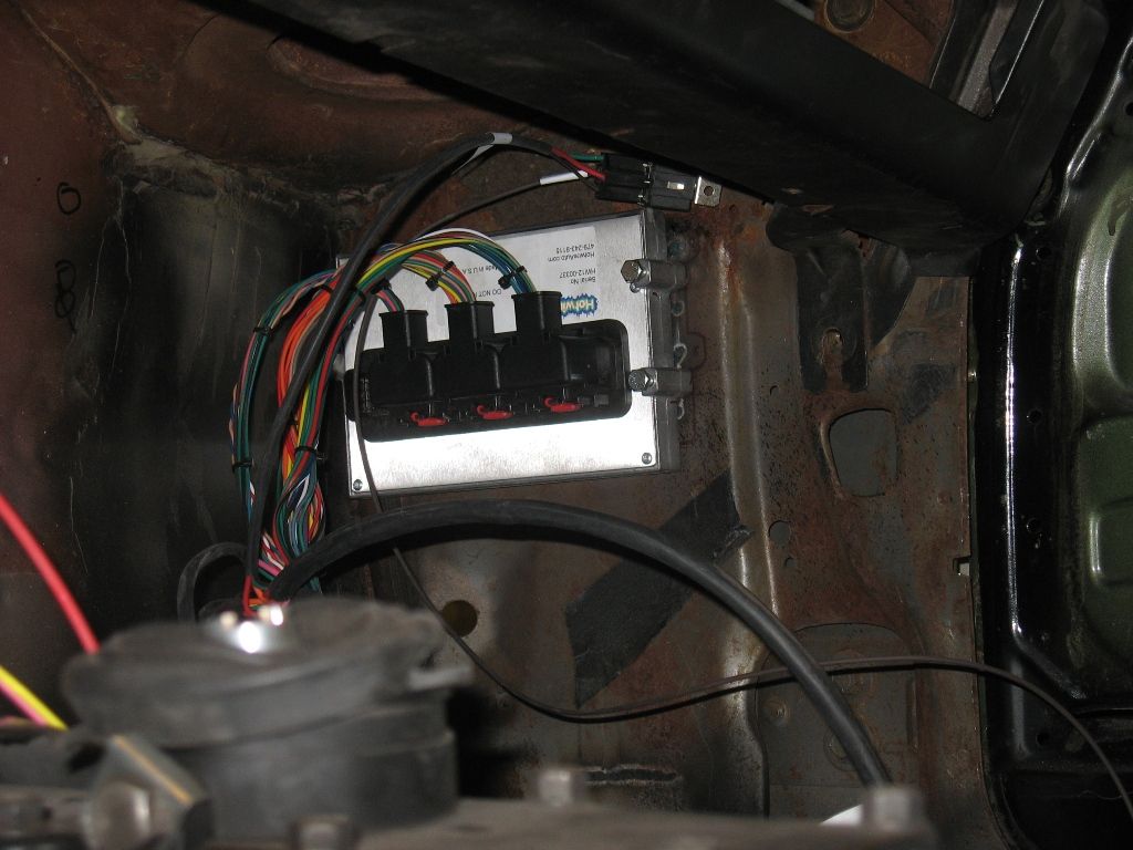

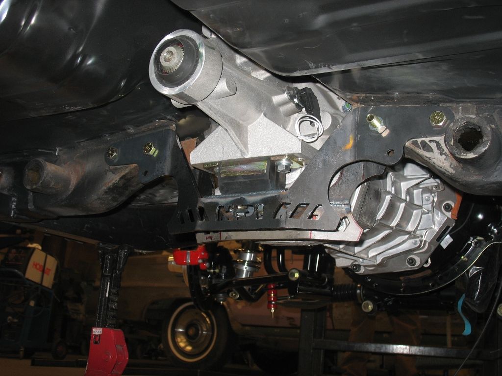

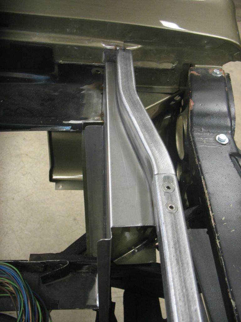

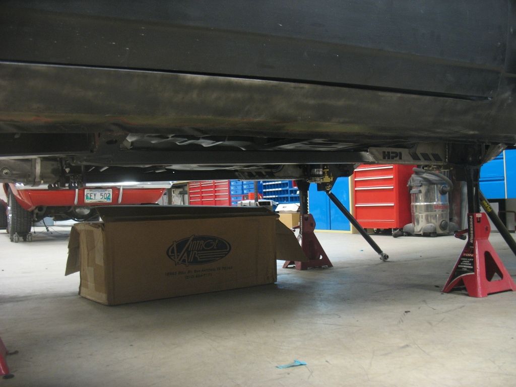

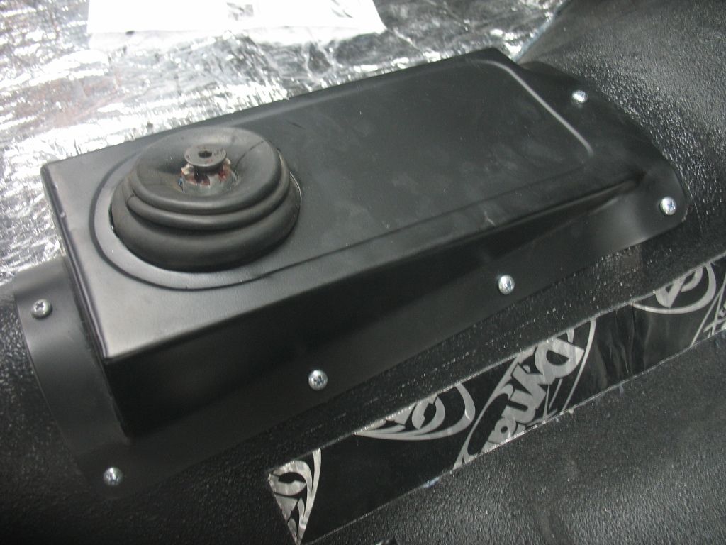

Hotwire harness and ECU
Pushbutton start and keyless entry modules, along with DBW pedal and vintage air mounts. The firewall is getting changed, so we havent fully welded our new structures in.
Our subframe connectors
T56 Magnum and crossmember

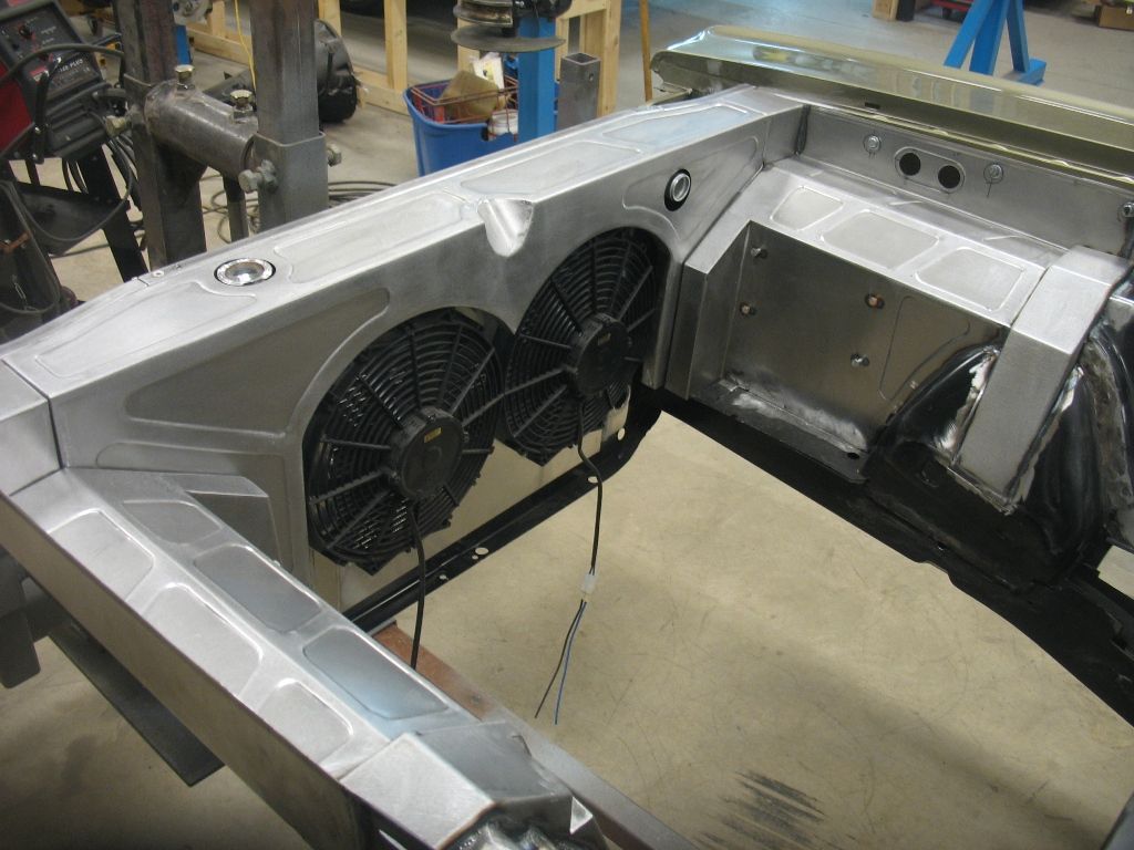

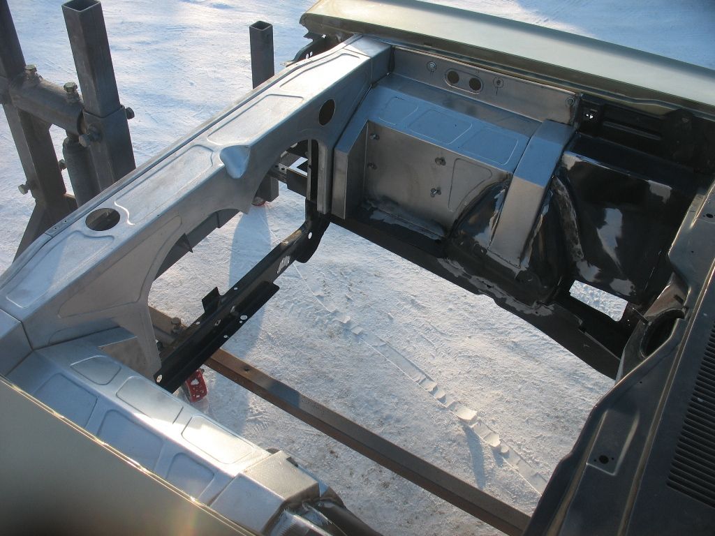

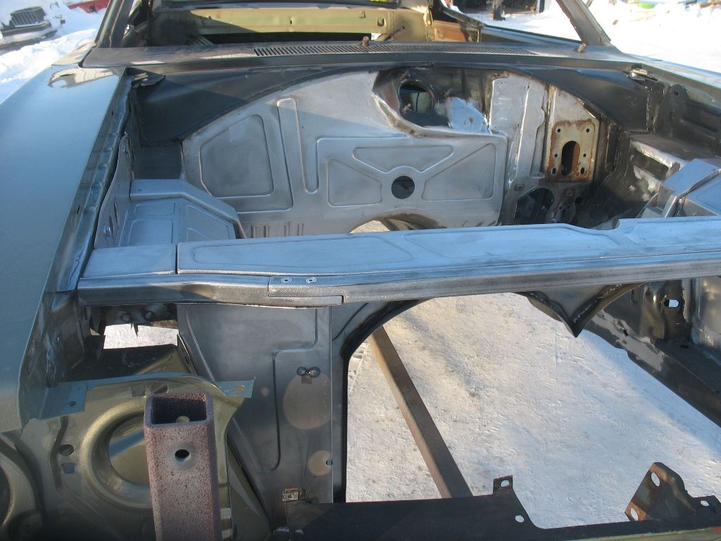

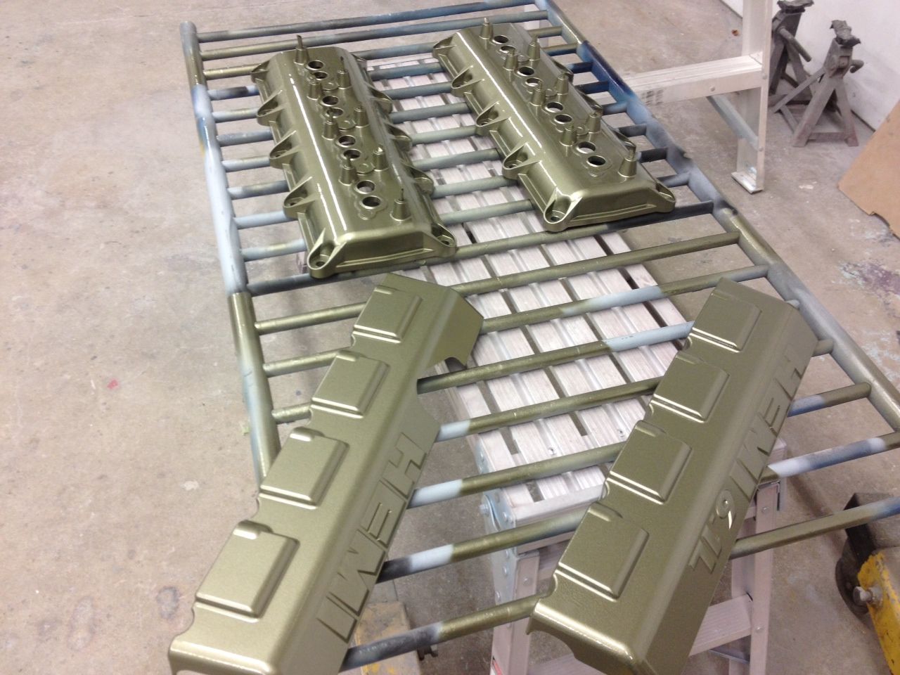

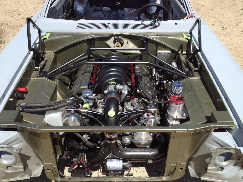

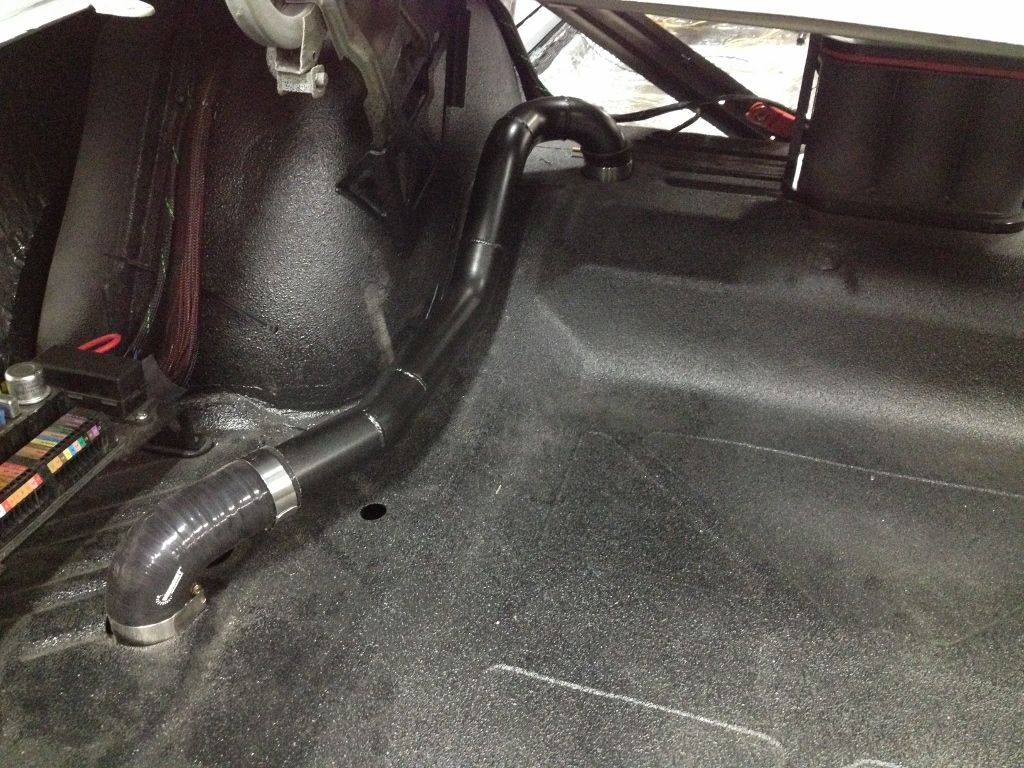

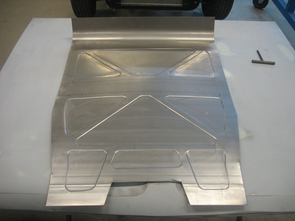

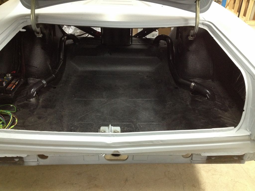

So after a bunch of time off (ya right, been busting my ass guys!) heres some updates for ya!

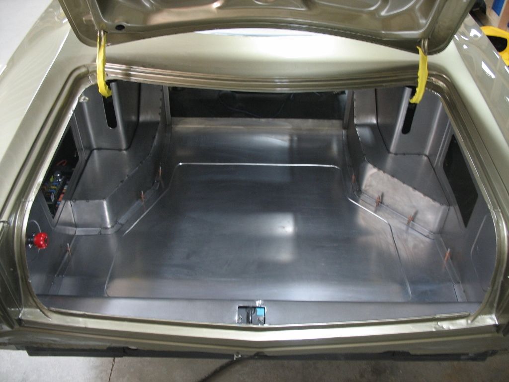

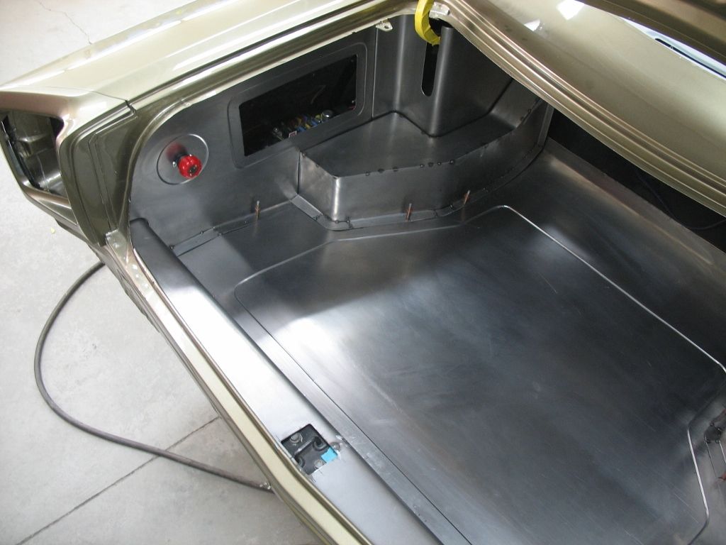

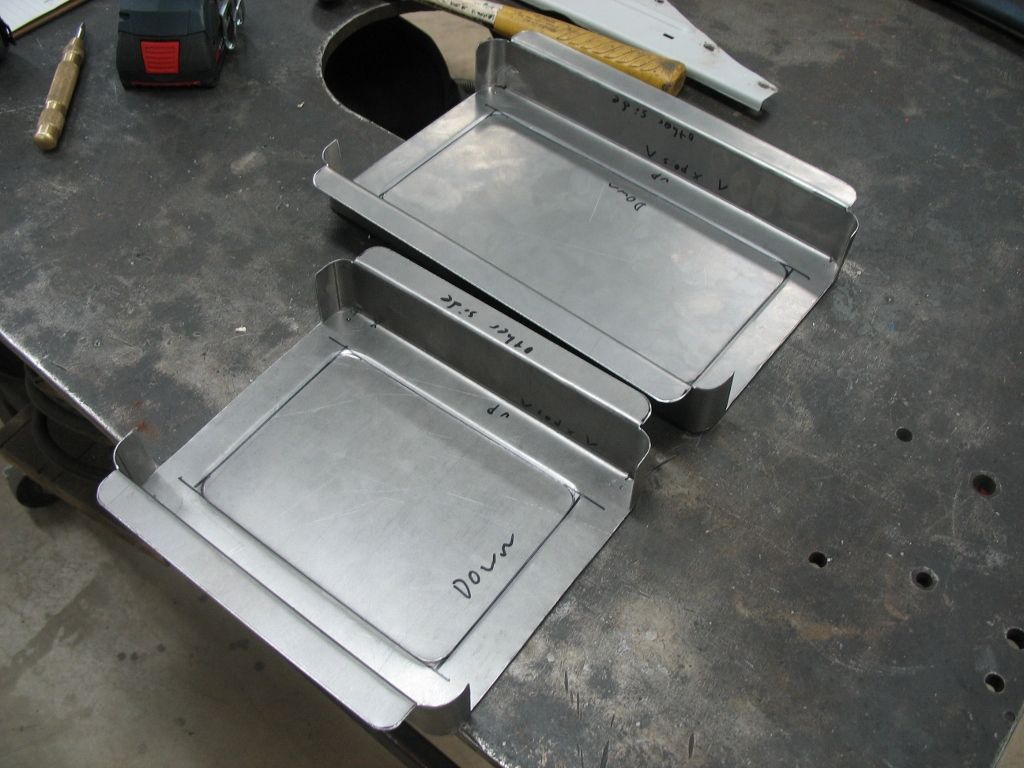

Trunk floor to give a nice backdrop for the custom Ricks Tanks

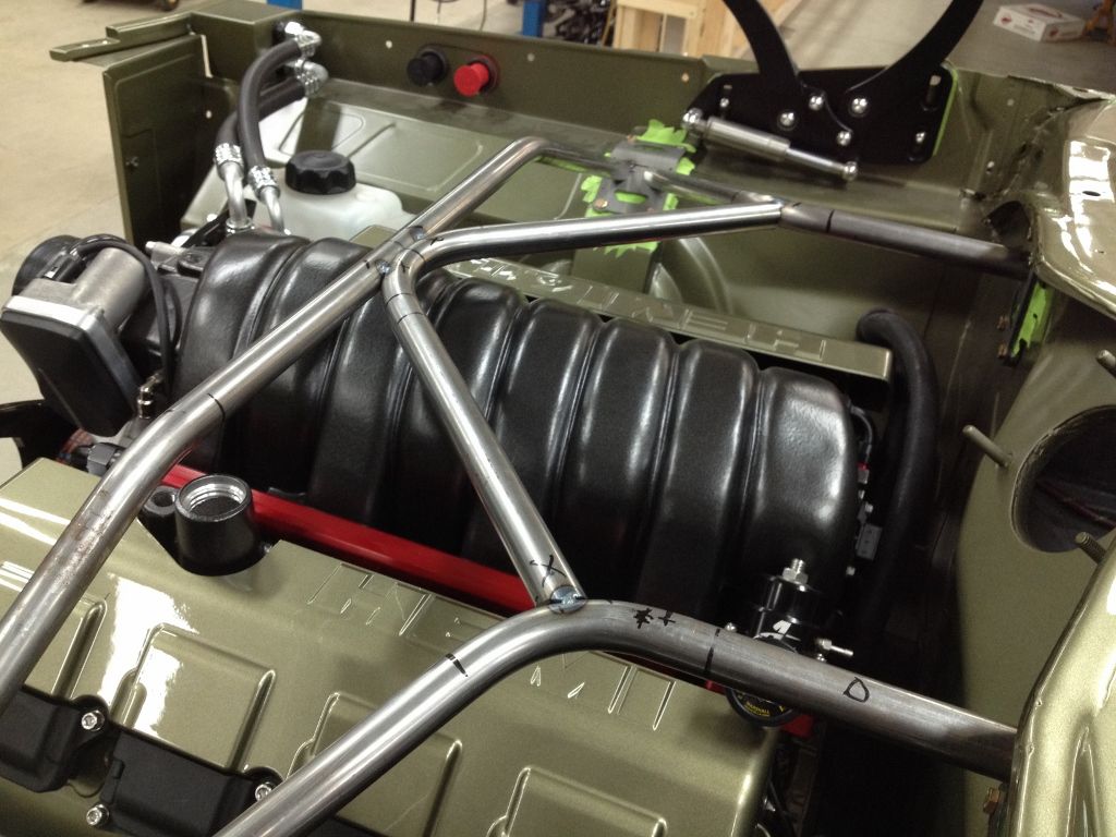

We ended up coming up with something a bit different and angular for the engine bay.
Tyler

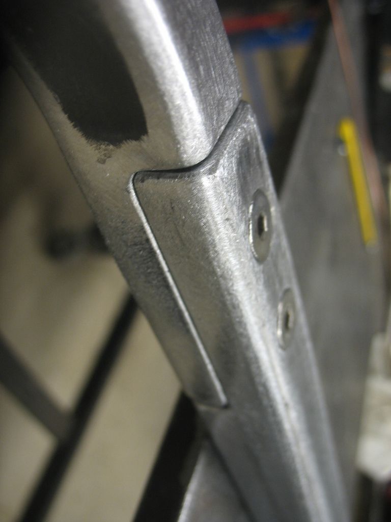

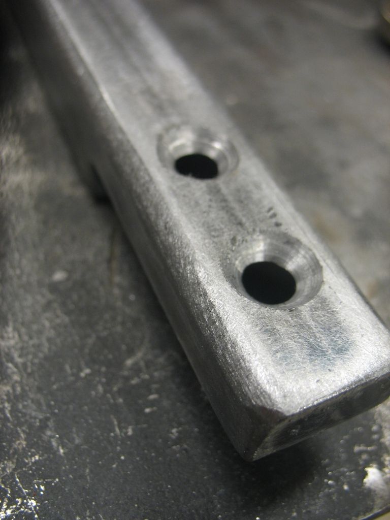

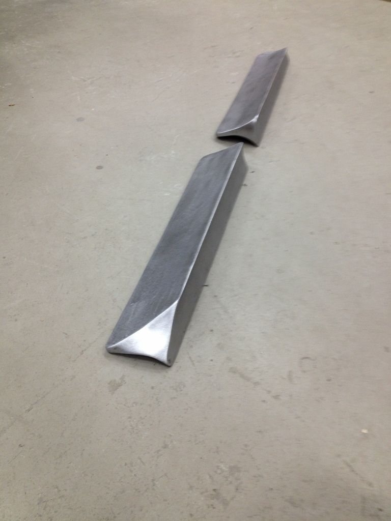

Recesses for flushed in bumpers/rear valance
